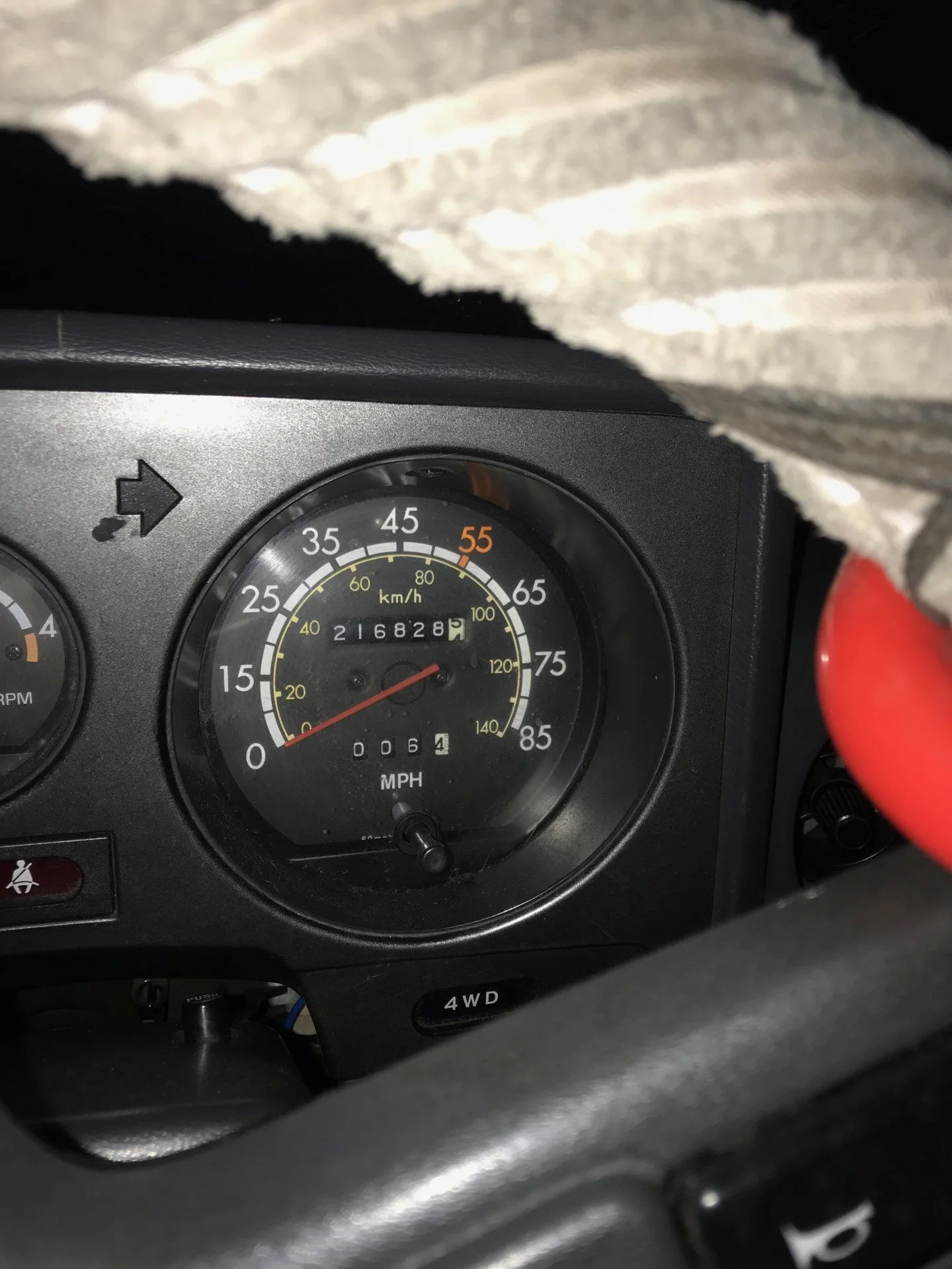

Here's where I'm at as of mileage. This pic is mostly for my reference here.

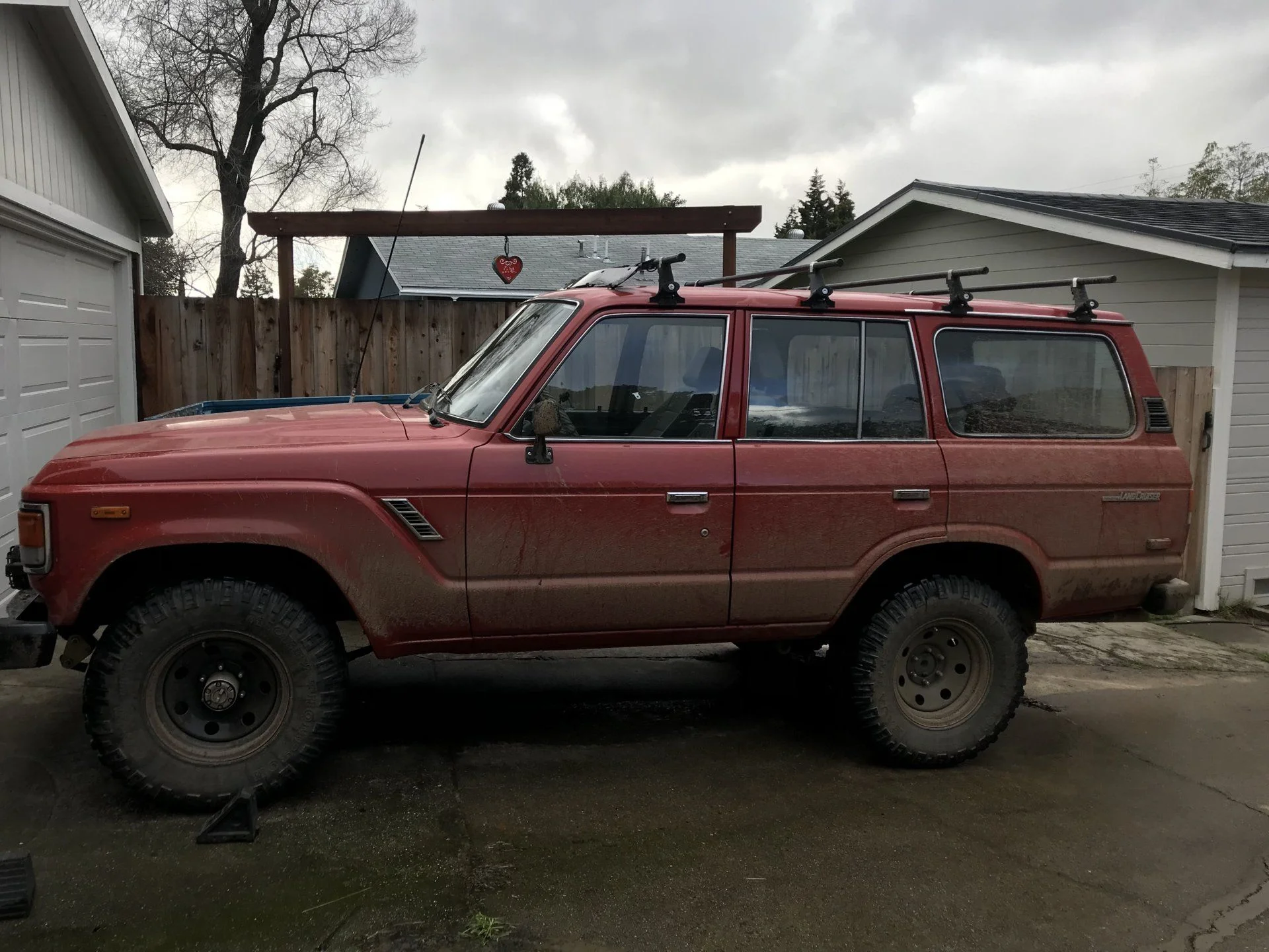

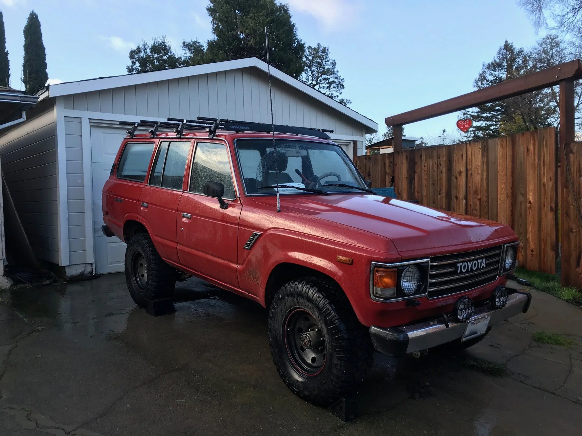

After a romp in the mud...
1906497
Driveway pose. It's still raining a lot so I haven't bothered with a wash yet. Today I just drove around the Oakland hills listening to the weather report on my CB Radio. Just Elma and I out for a stroll... I need to get to the snow but I'm still test driving... Making sure she's back to old faithful status.

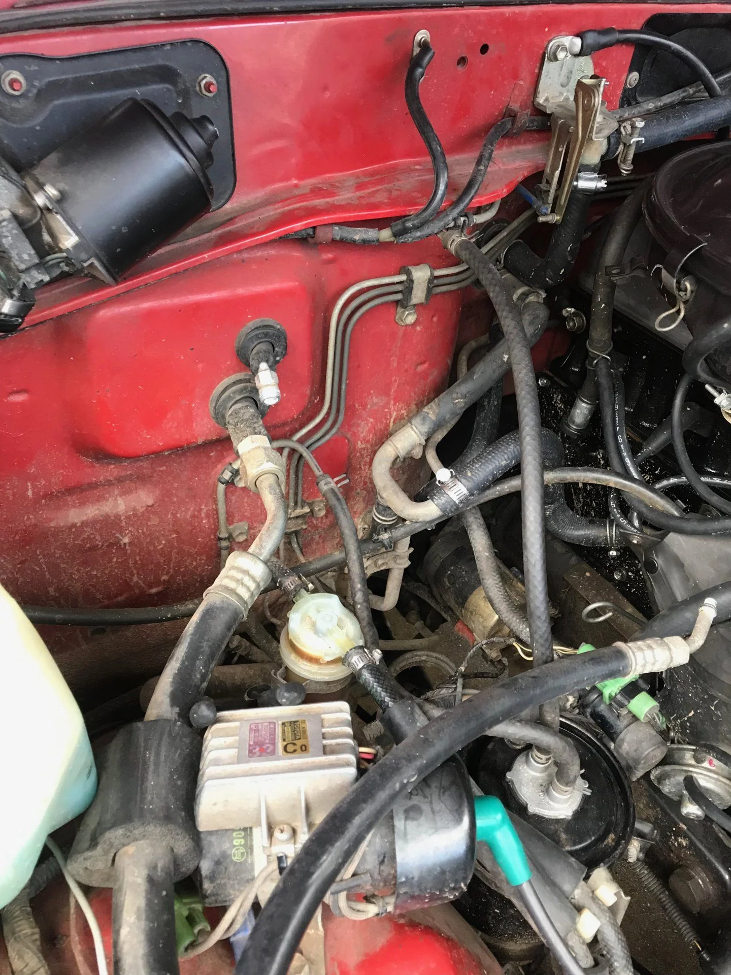

Remove these two A.C. hoses after you've safely discharged the system.
I think it's 17mm & 27mm wrench for the big hose and 14mm & 17mm for the small hose. I'll dbl check this.

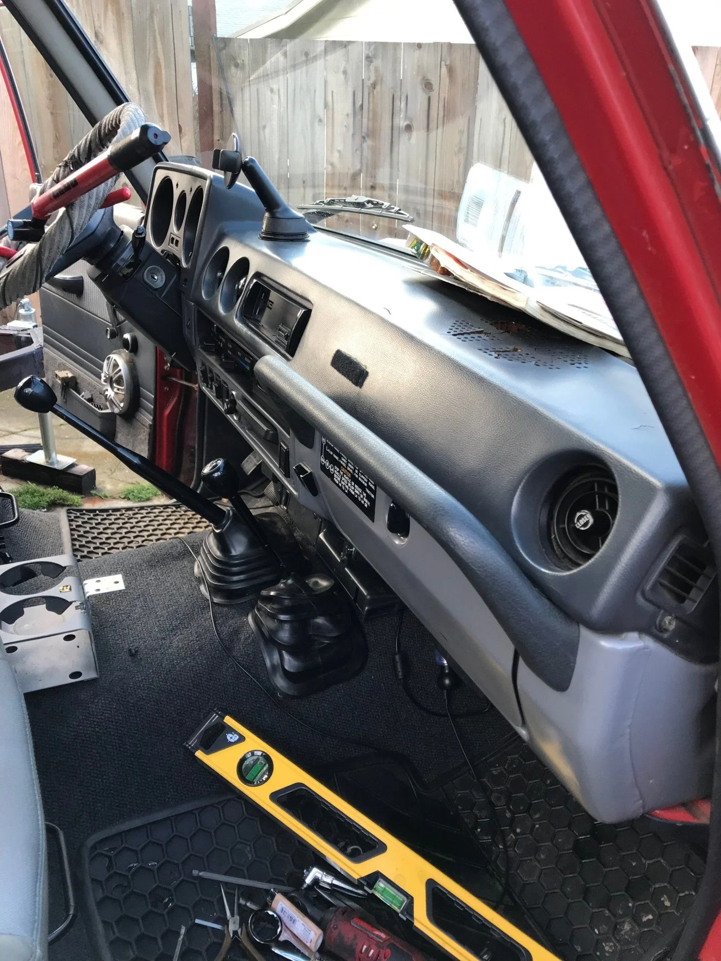

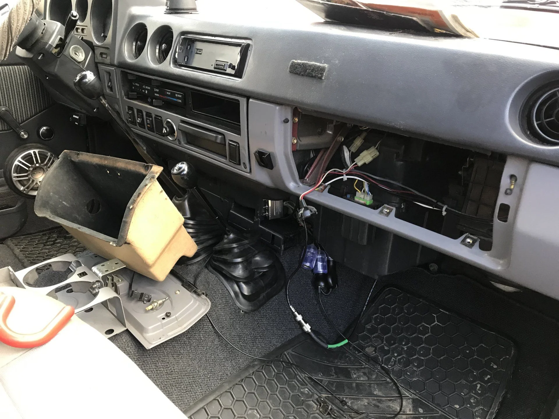

I have to tuck my clunky FM/CB antenna splitter box (scene here) up into the dash as well as my satelight radio module (not scene here). I recently bought a new radio with no CD player. It's shallower by about 3" than a standard radio with CD Player so that gives you a bit more room to shove crap behind the radio.
1906501

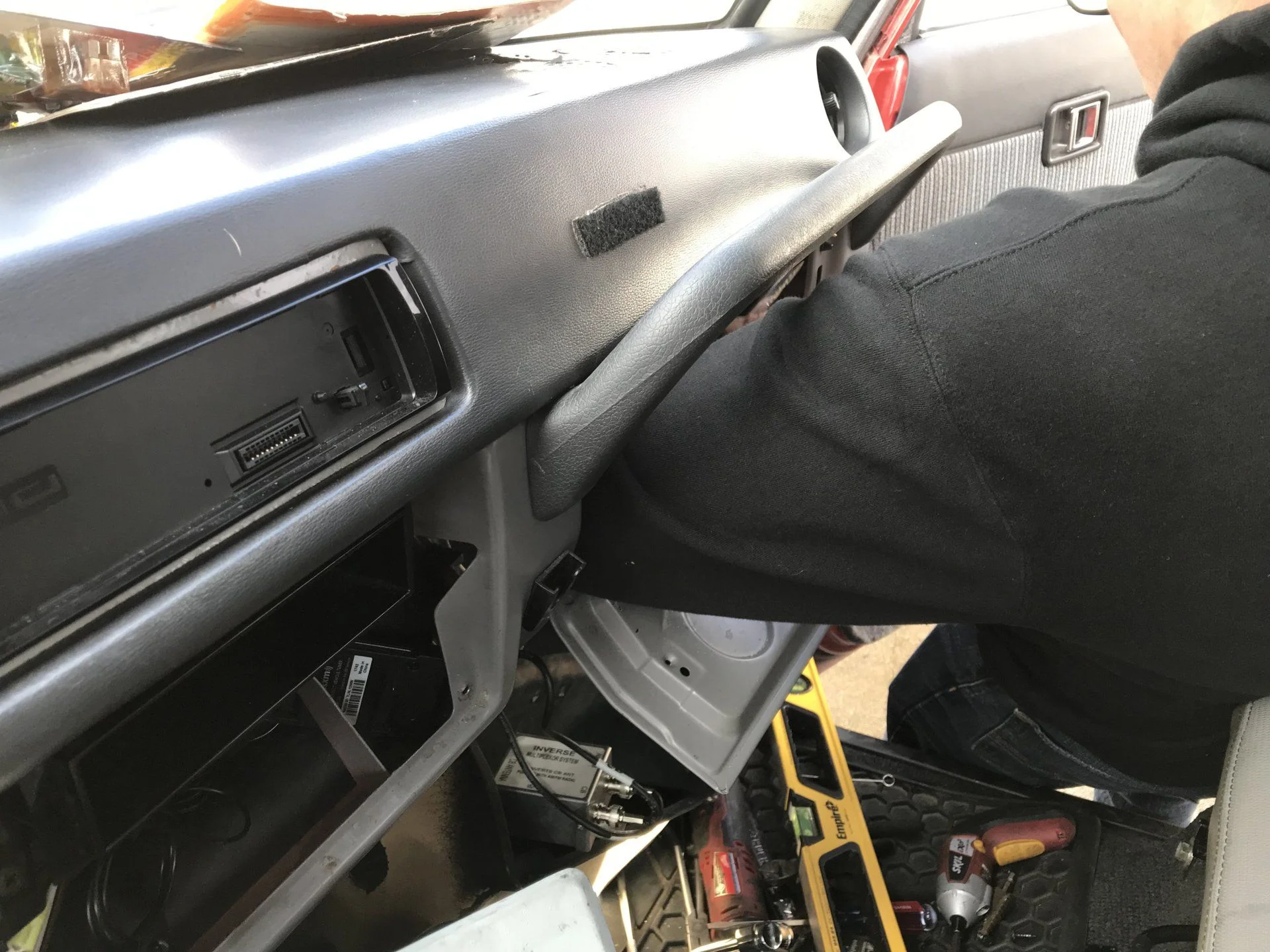

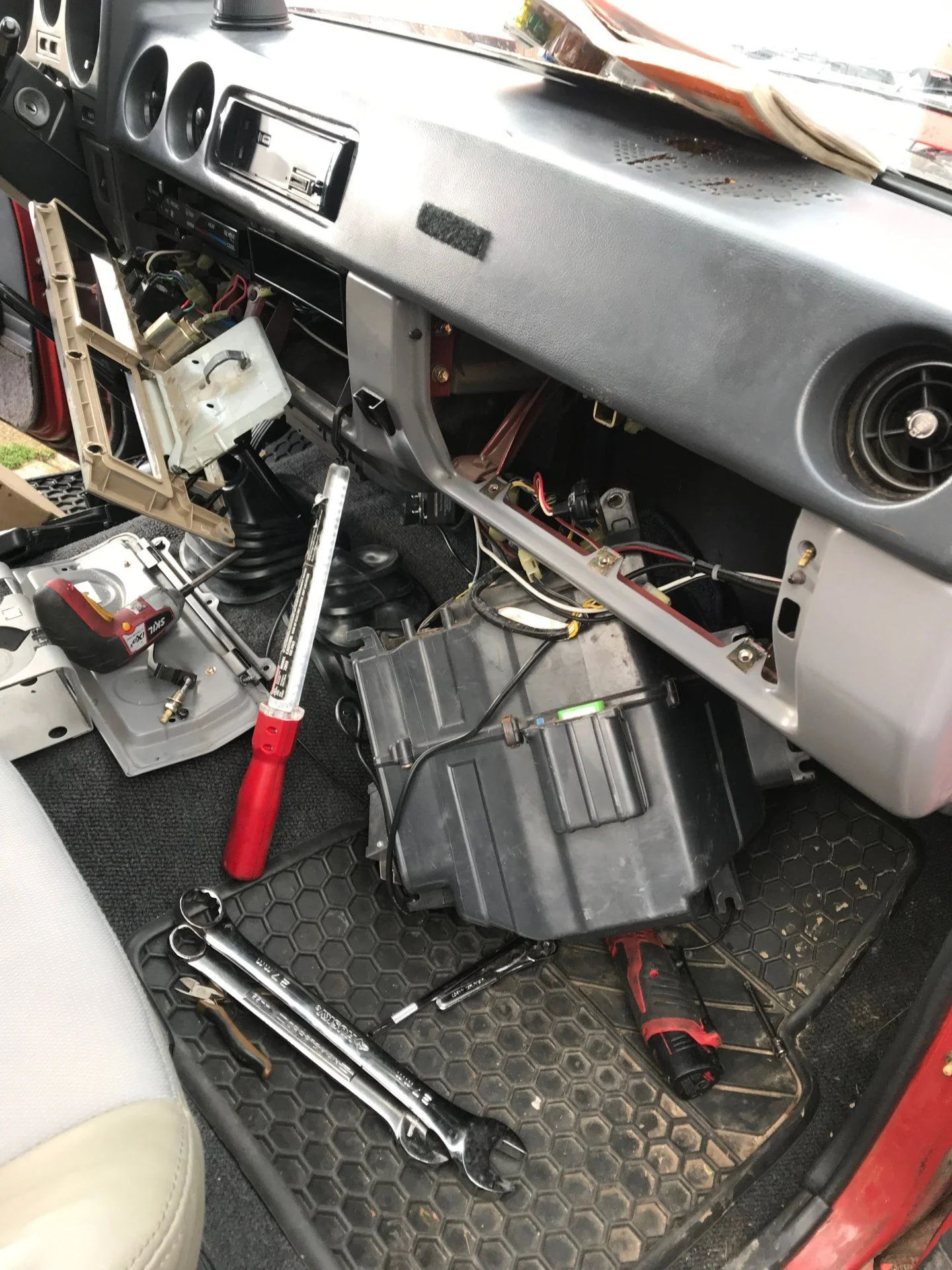

Remove the lower foot vent and the black vent tube that's right behind the ash tray. You'll need a sidewinder screw driver to get these two screws off of the vent tube.
Remove the (4) bolts with a long screwdriver or 10mm ratchet with long extension. (2) left, (2) right. Remove the (2) 10mm nuts on the top of the box. Start wigglin it out...
1906503

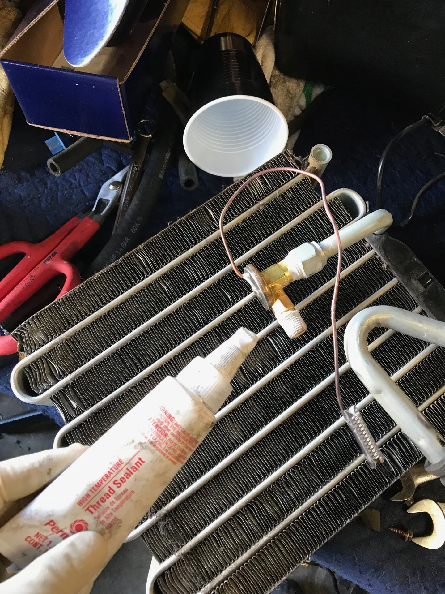

Once it's out take it to the bench and take it apart. Long screw driver/screw gun is all you need. I used my air gun to blow out debris on the unit. Be careful not to bend up the vents. I went in and un bent any of the fins that were pushed in. Un did the old valve and put the new one in.
1906505
Be careful. This pic doesn't show me using the 14mm wrench on holding the valve end. It takes two wrenches to get it off.
1906510
New one on top.
1906511
1906512
Thread sealer... Cause why not...

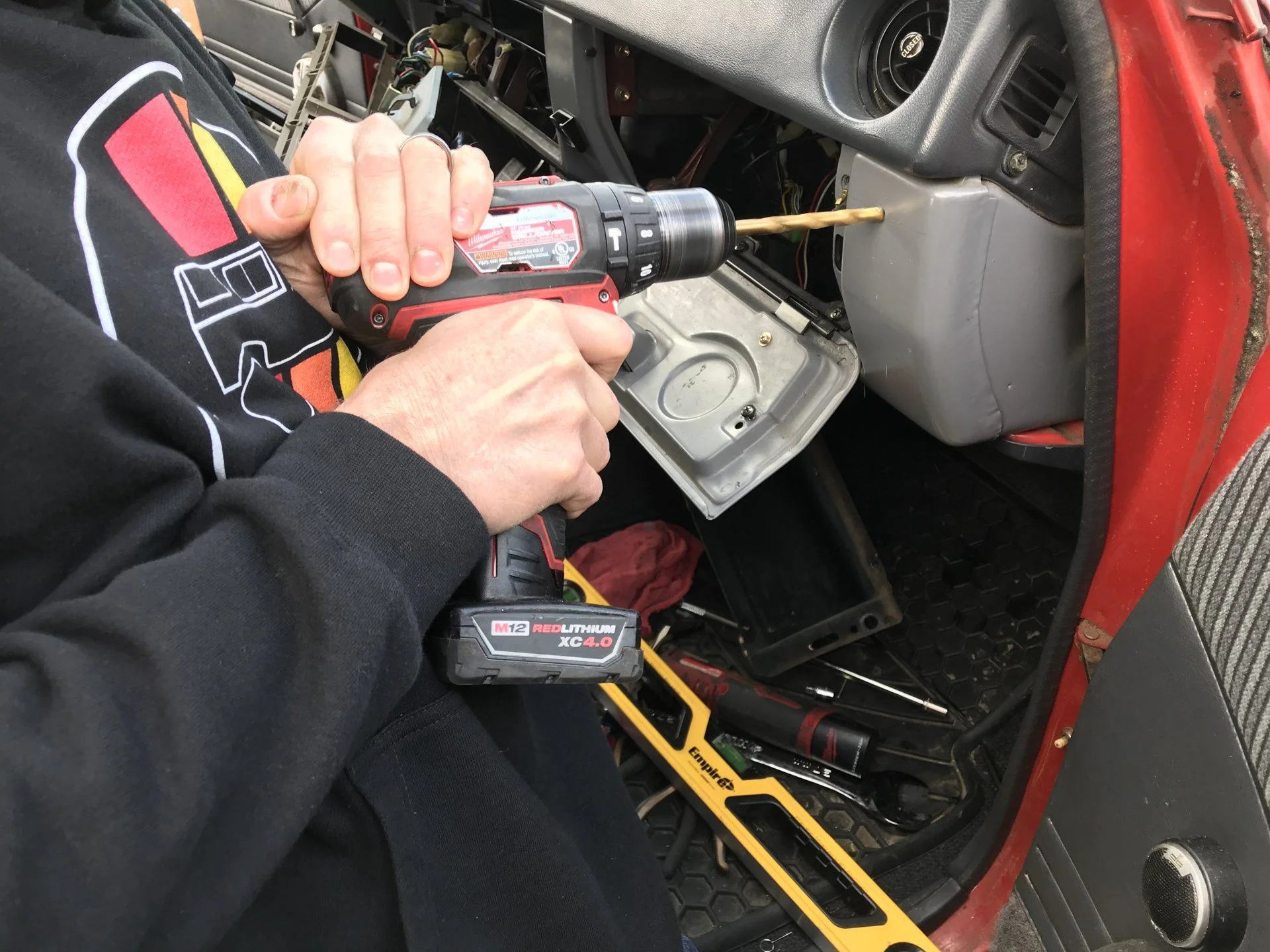

Onto the grab bar. @Chopperbobsmith stopped by as I was putting it all back together. So I was able to snap a few picks of us putting the 62 grab bar in.

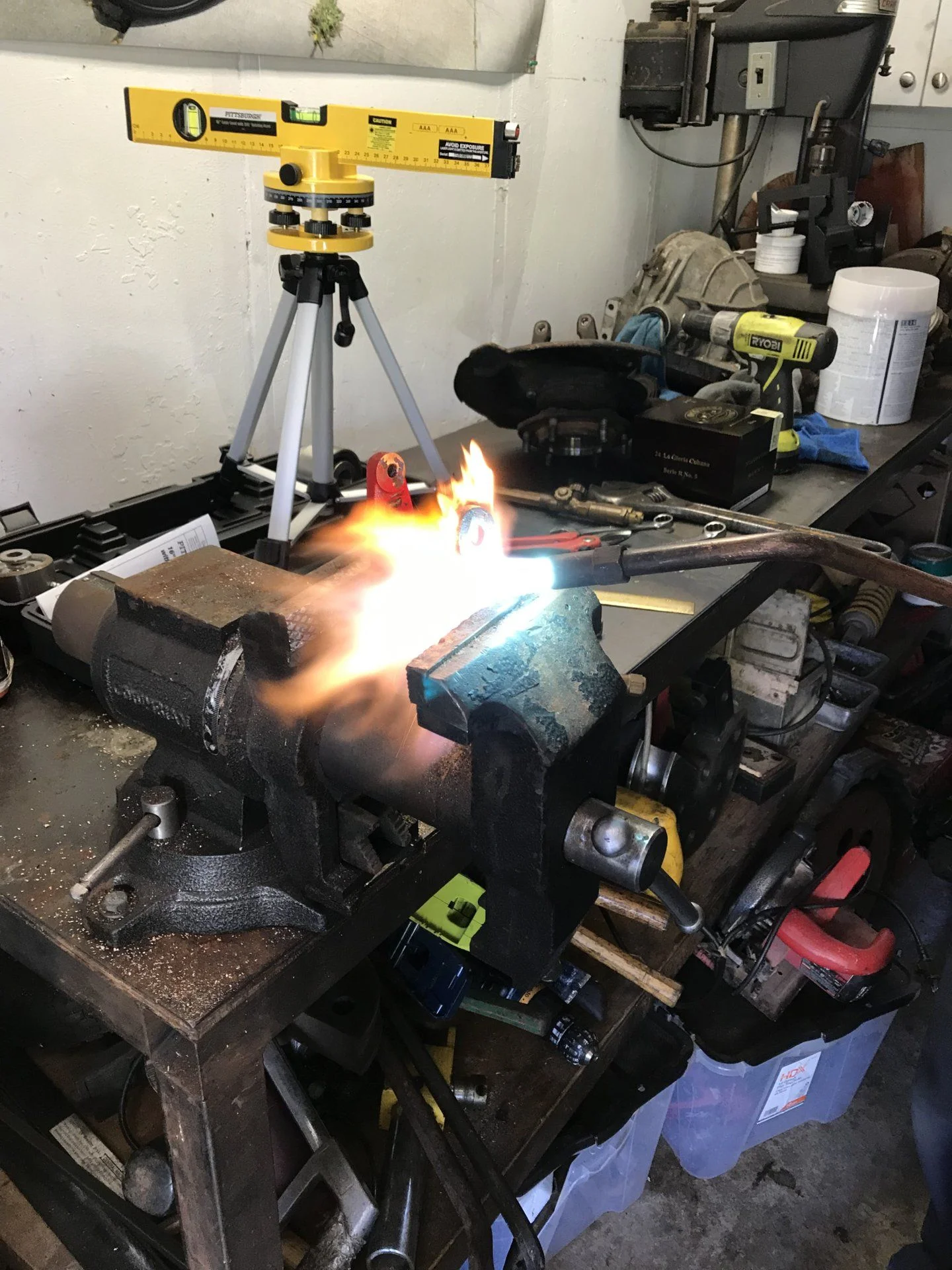

Sorta fixed my alternator bracket. It was good and bent around the ears from using the wrong size spacer/washer with my Mean Green Alternator. I seemed to get the orientation wrong when I put the alt back on and that bent the bracket a bit. This was causing the belt to run crooked and once it warmed up it would make this horrible belt howl noise. We heated it up until it was red hot and took a giant crescent wrench to it and bent it back.

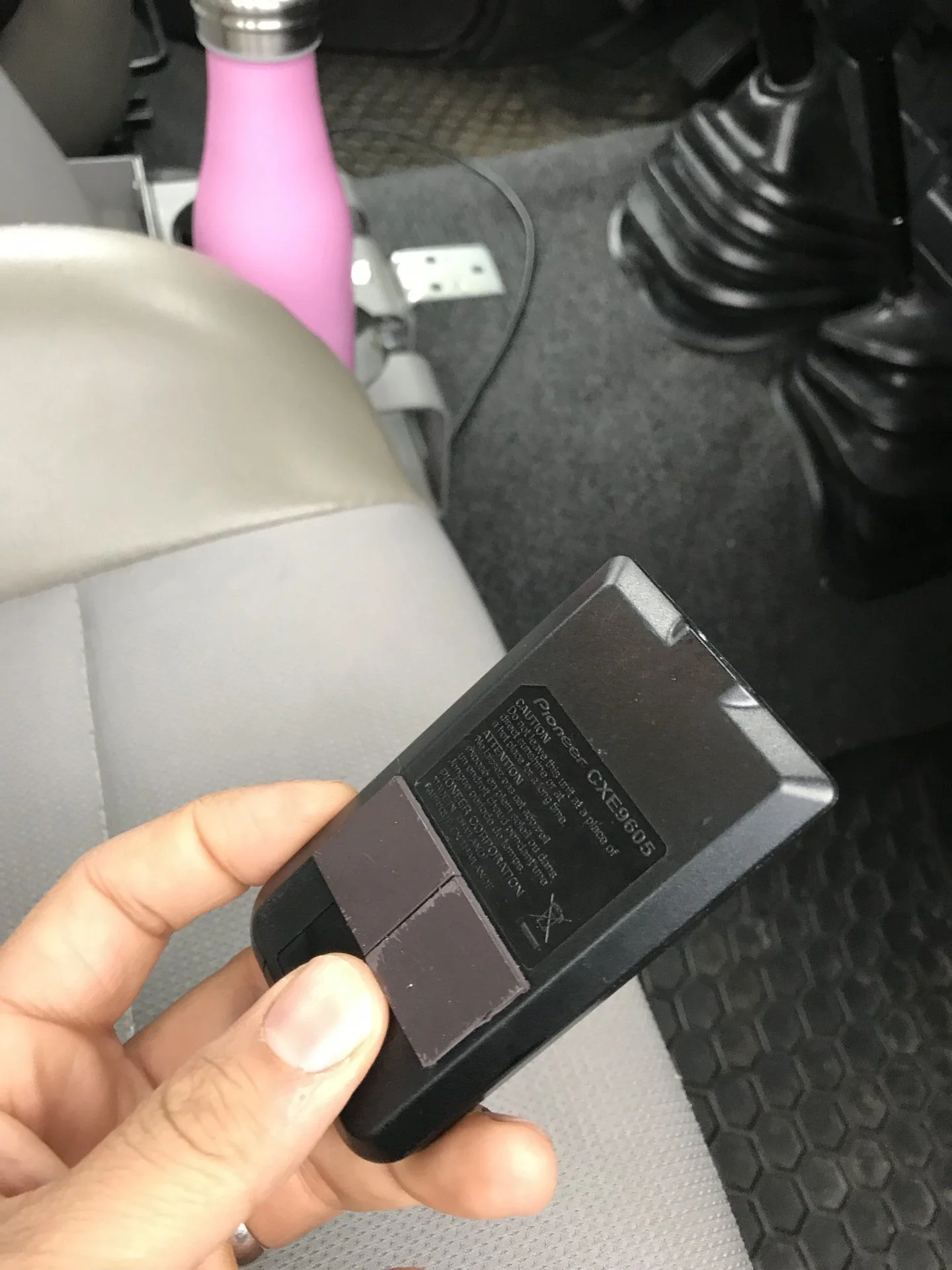

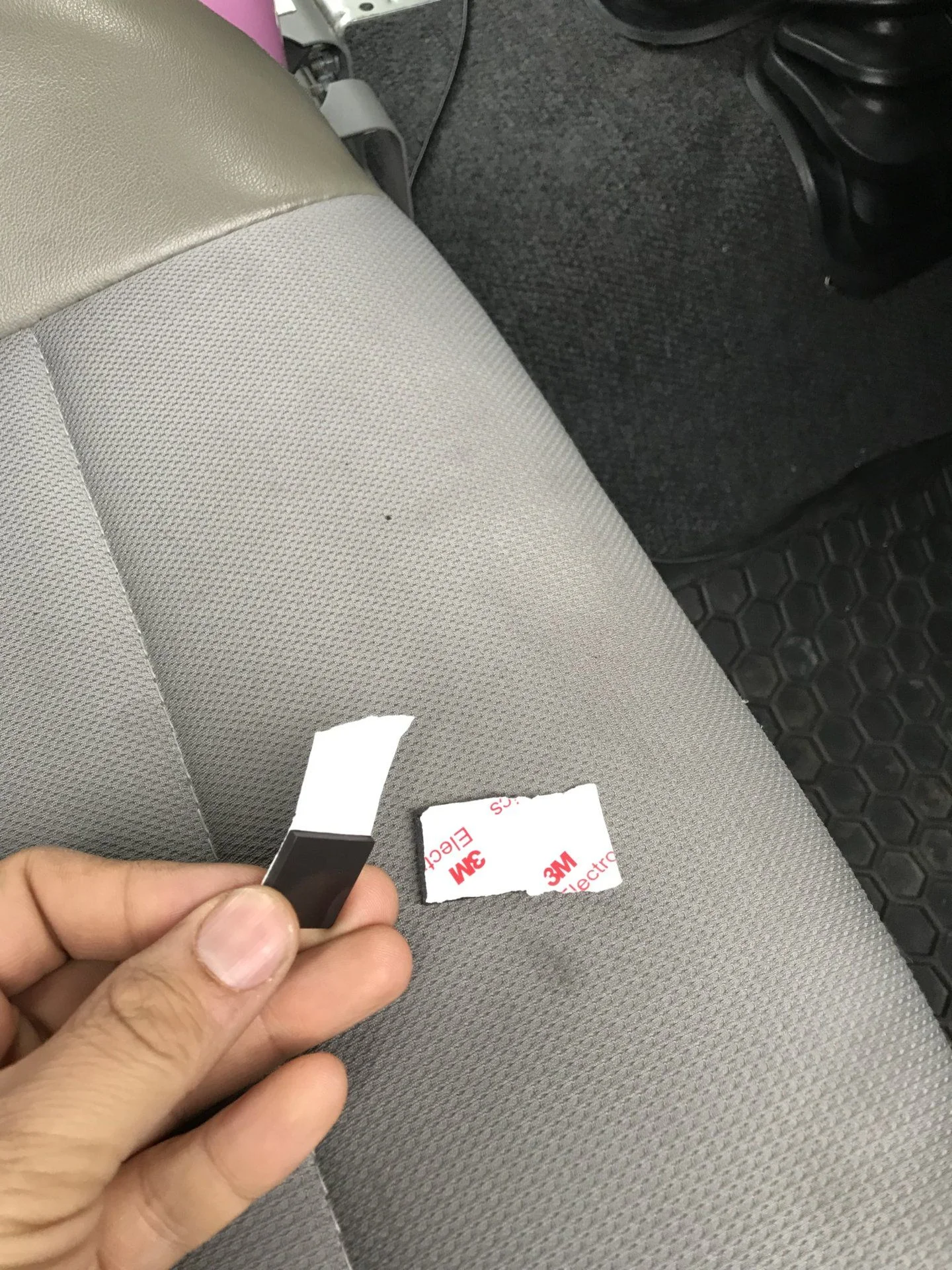

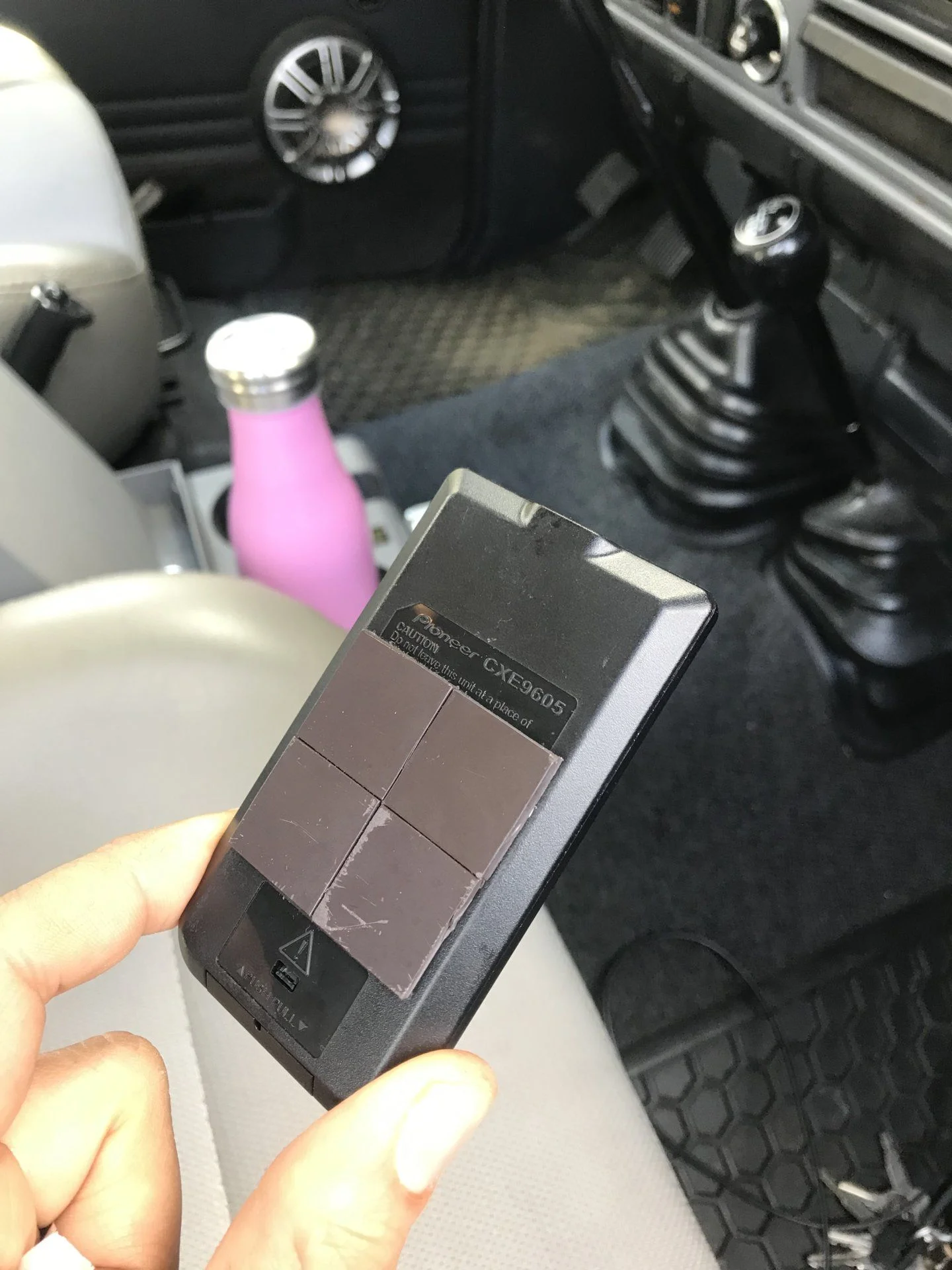

Also got around to solving my “where am I going to put my Pioneer remote” problem. I found these sticky 3M magnets at work so I ordered some. I was gonna use Velcro but this is even better. It’s the little things...
Now you can adjust everything like a mini touch pad. Saaaaweeeet. And it will stick on the side or anywhere on the Tuffy.
