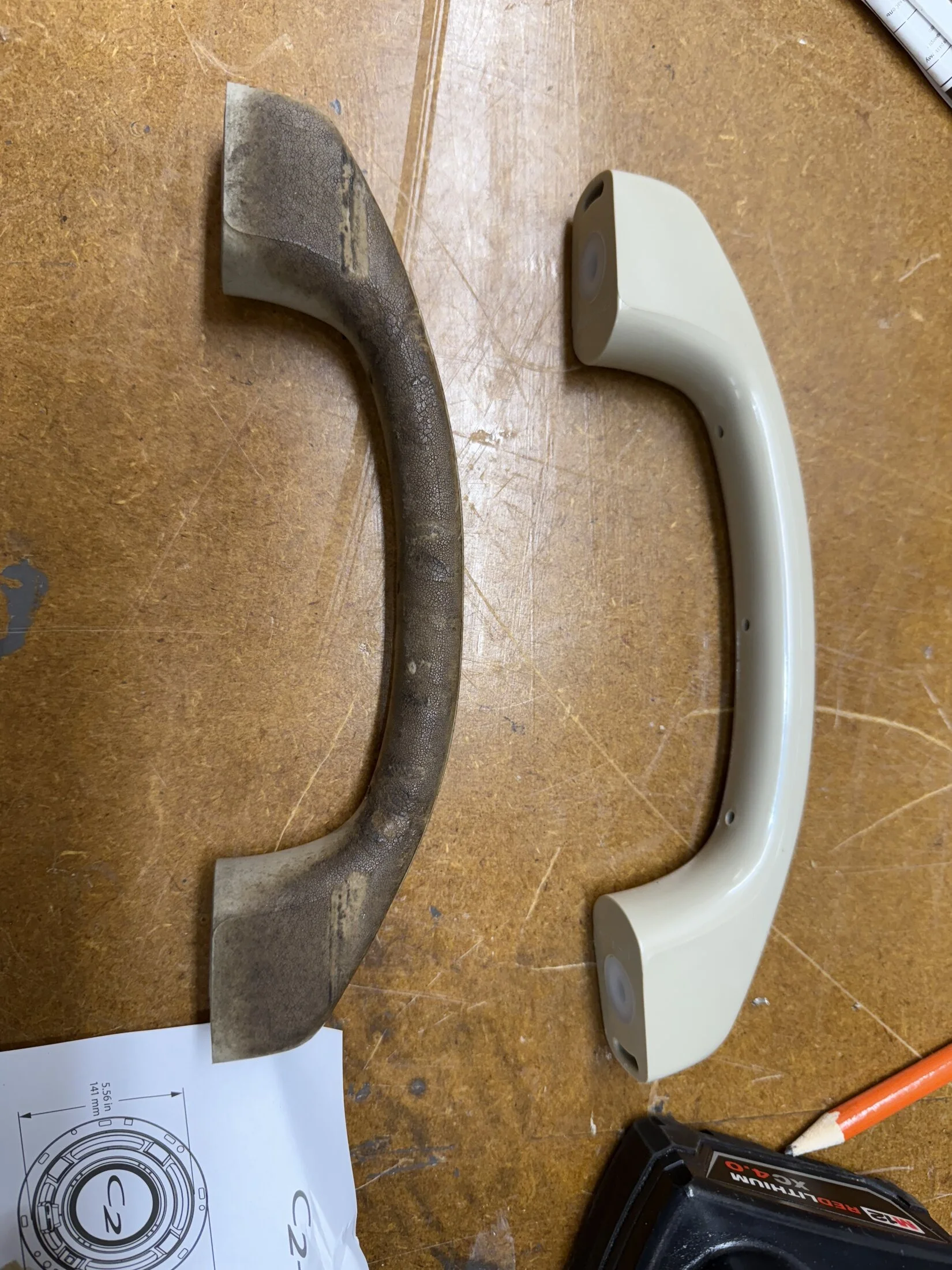

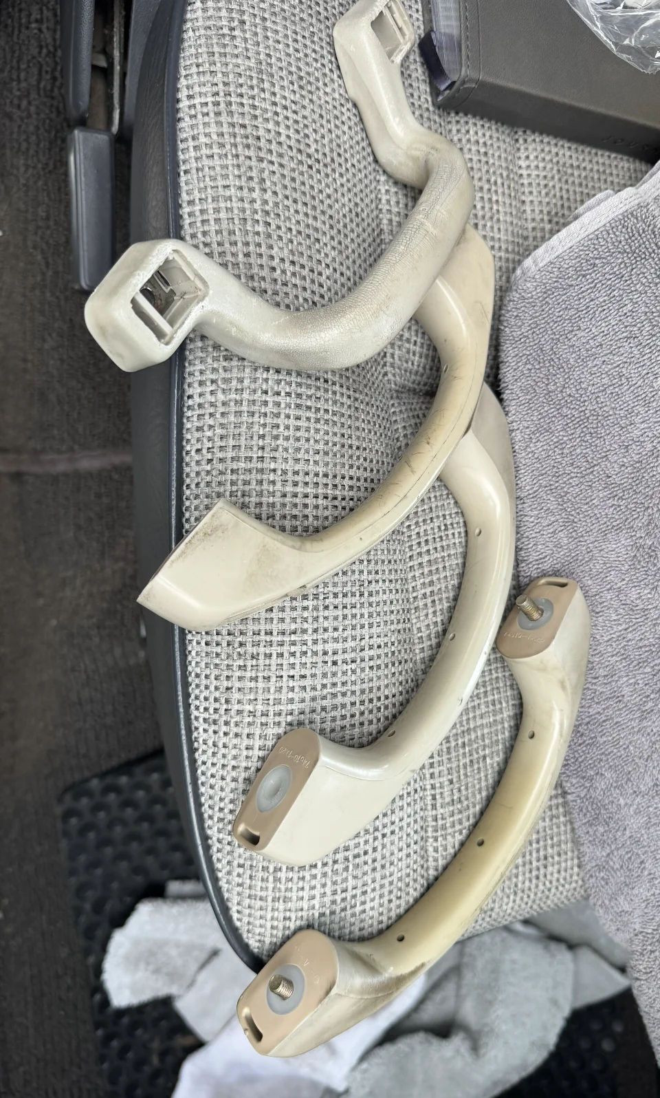

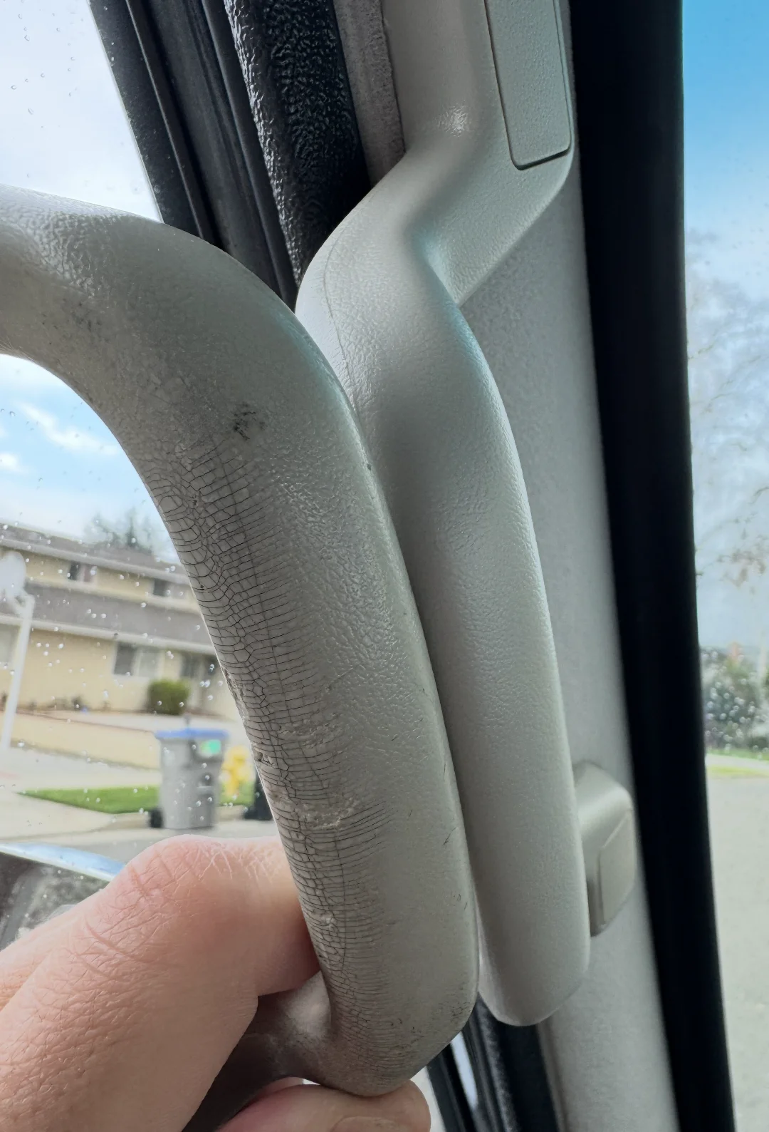

For OCD's sake I used loctite 242. My handles were the original and pretty tired. The original screw cover plugs crumbled or snapped in two when I pried them out.
Check out the new vs. old A pillar grab handle. All my other handles were similarly worn and yellowed.
