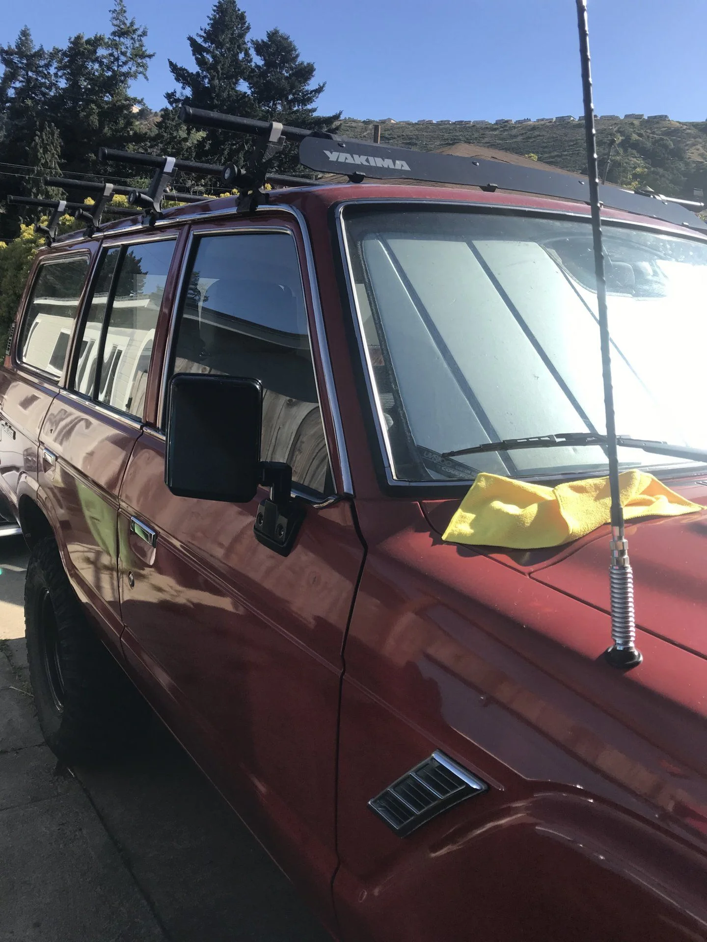

Holy crap I can see! Can’t believe I waited 10 years for these. Put the 70 mirrors on and OMG! Game changer. I’ve never been so happy to look backwards in life ever.
I got em from City Racer and they were spendy but they are nice.
They don’t have a zoom on the pass but they are great.
Are the 70 mirrors convex view? I like them
Hey Matt,
I knew there was a word for that. I said “no zoom”... lol. No, no convex. Both mirrors are the same. So much better than the stock Corolla mirrors that came on the thing though.

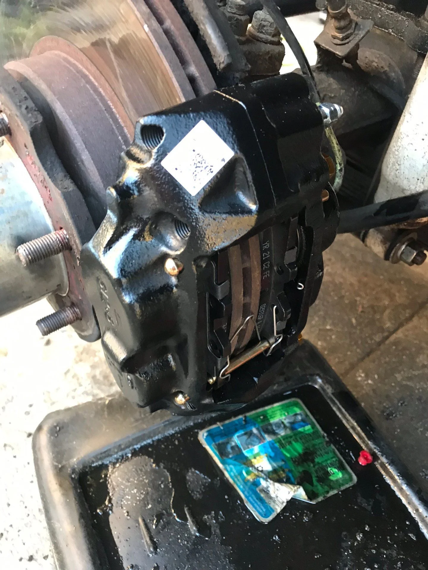

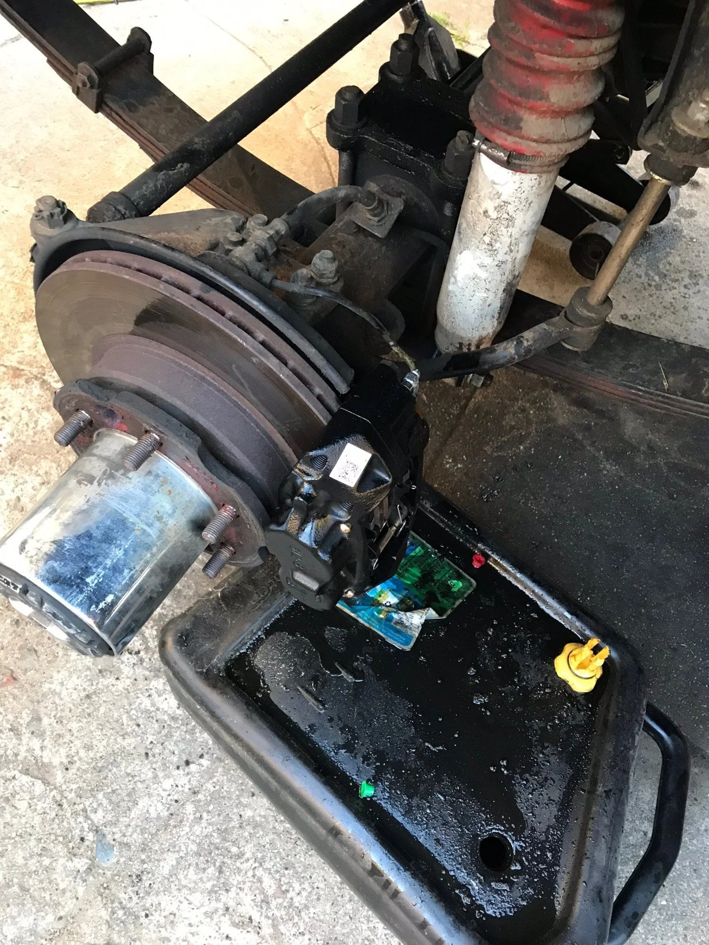

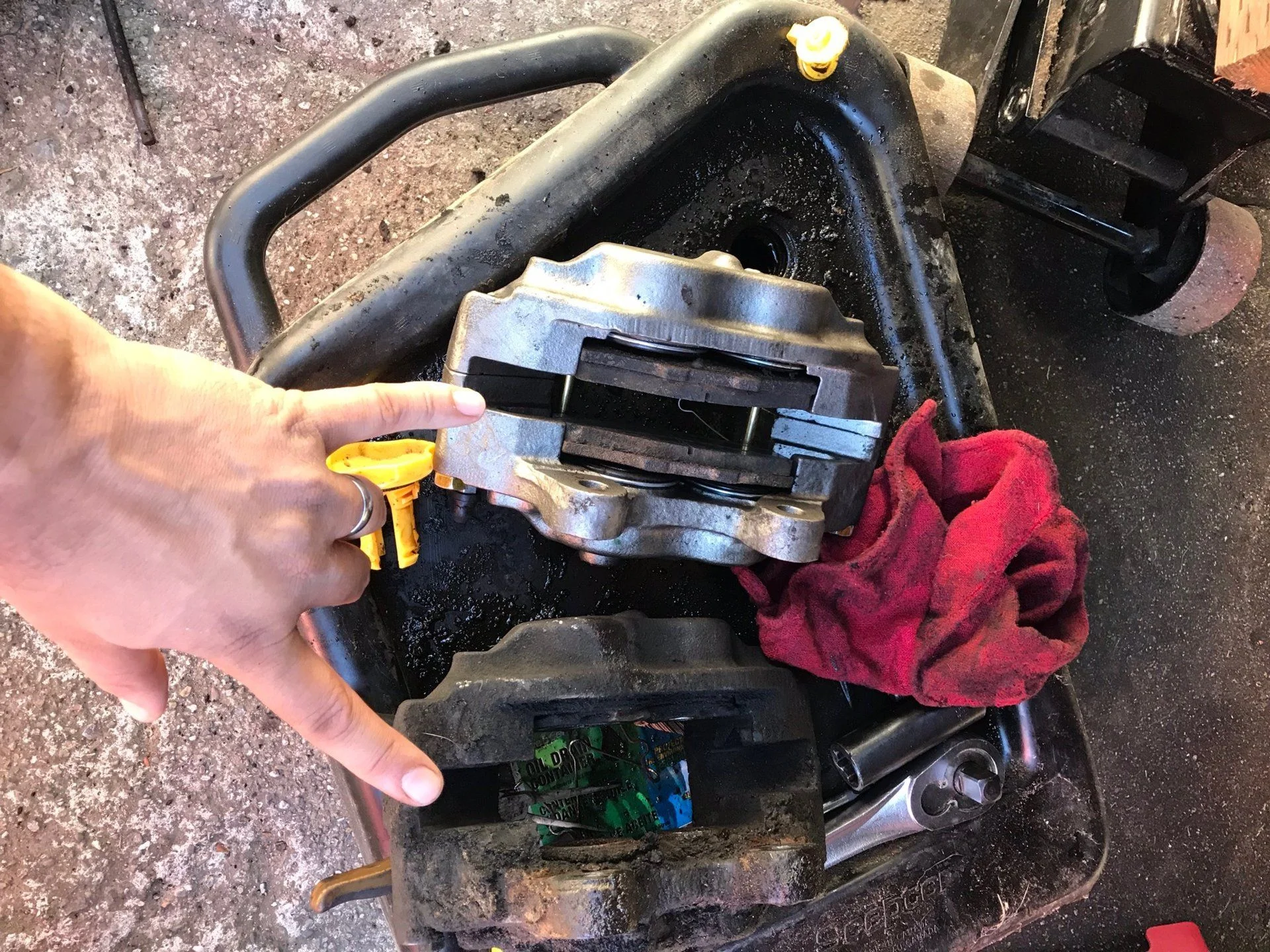

Front left brake caliper was leaking bad so I went to Napa and they had new calipers in stock. I should have turned the rotors but I’m being lazy. I’m just gonna buy some slotted rotors from Georg soon anyway.
Took about 45 minutes to swap old calipers and pads. Hardest part of the job was jacking the truck up and taking the wheel off.
Rock Auto sent me the wrong caliper. The gap wasn't wide enough to fit around the caliper.

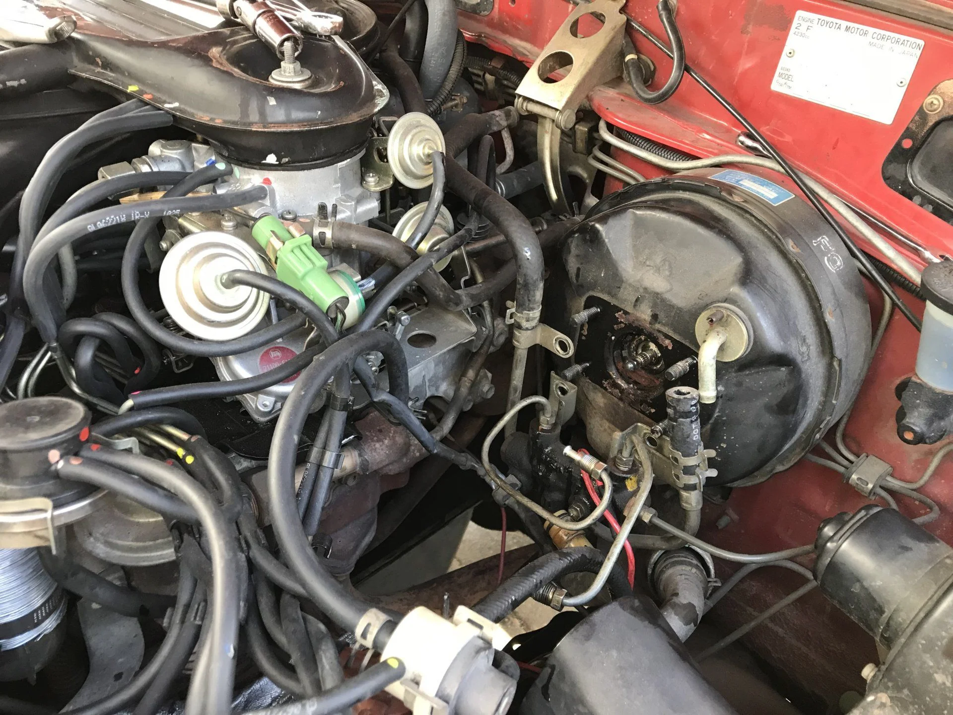

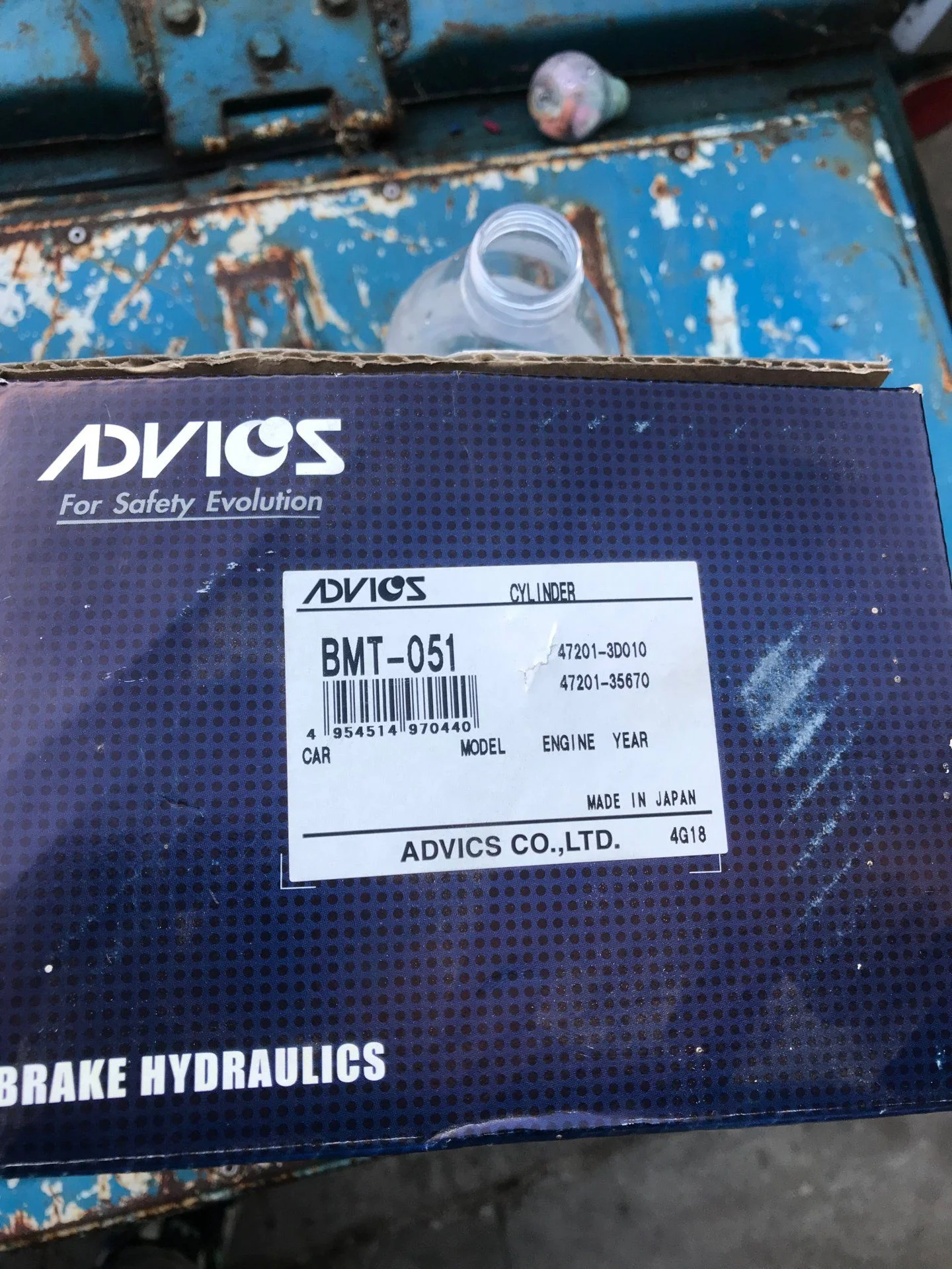

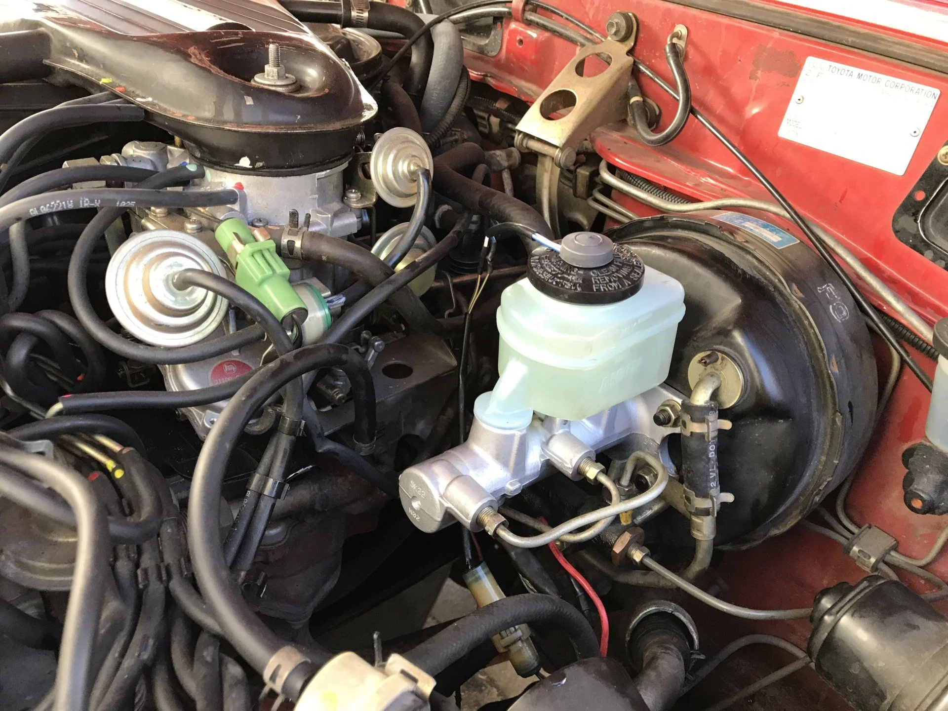

Finally got around to putting in the 80' series Master Cylinder. Mostly because I accidentally topped off my master cylinder container with power steering fluid and needed to drain it all out anyway. :doh: ! Pretty huge difference in braking power. I no longer need to pump the brake to get the thing to start stopping. Tons more pressure behind the pedal and a lot more stopping power.
This is a total "bolt on" upgrade for any one interested. The only "mod" per say is to cut the new connector off and solder on the old one in it's place. Took 5 minutes. I did have to bend the brake lines a bit to get them to fit the new configuration but no big deal at all. I'd say a :banana: job.

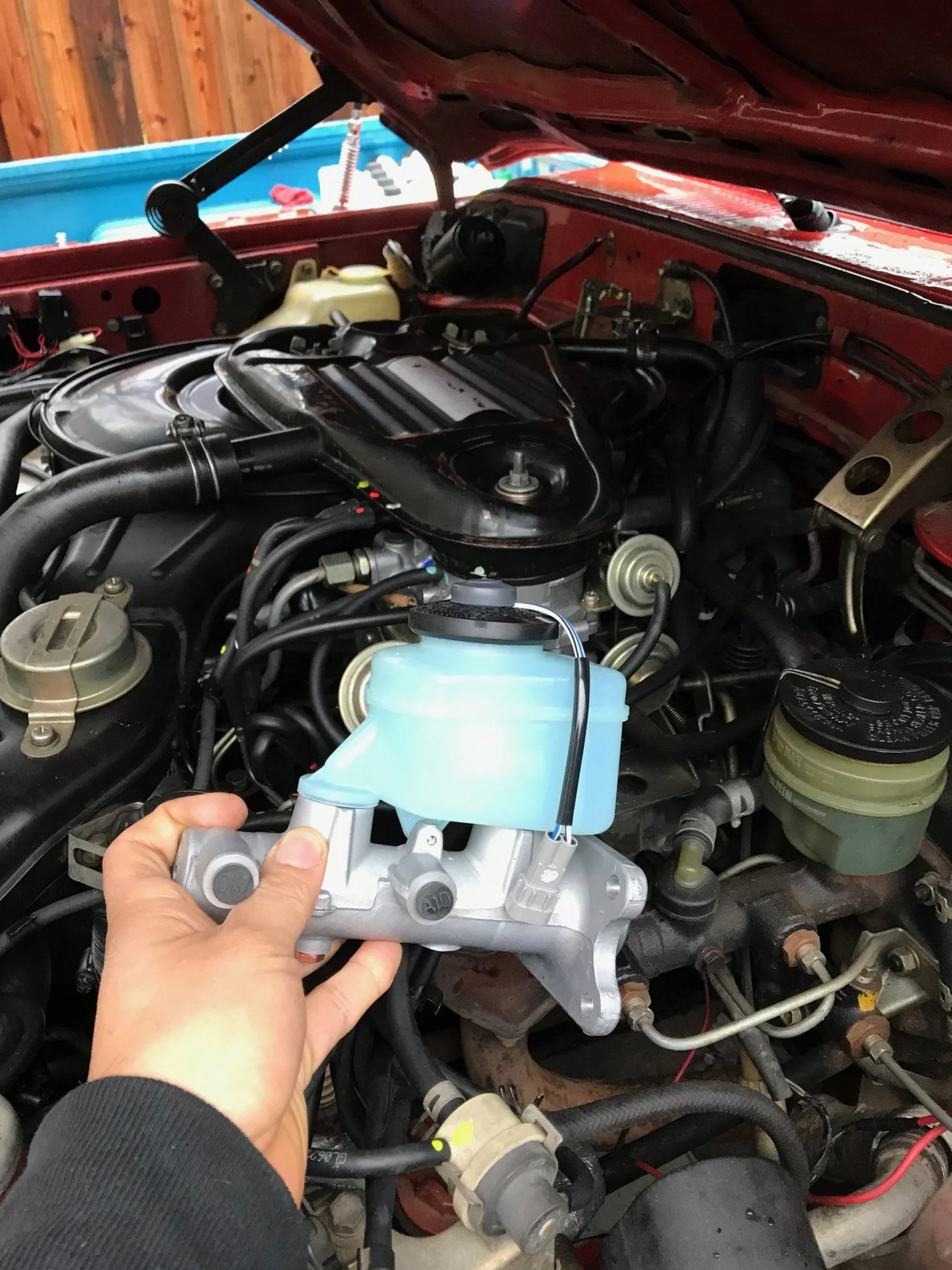

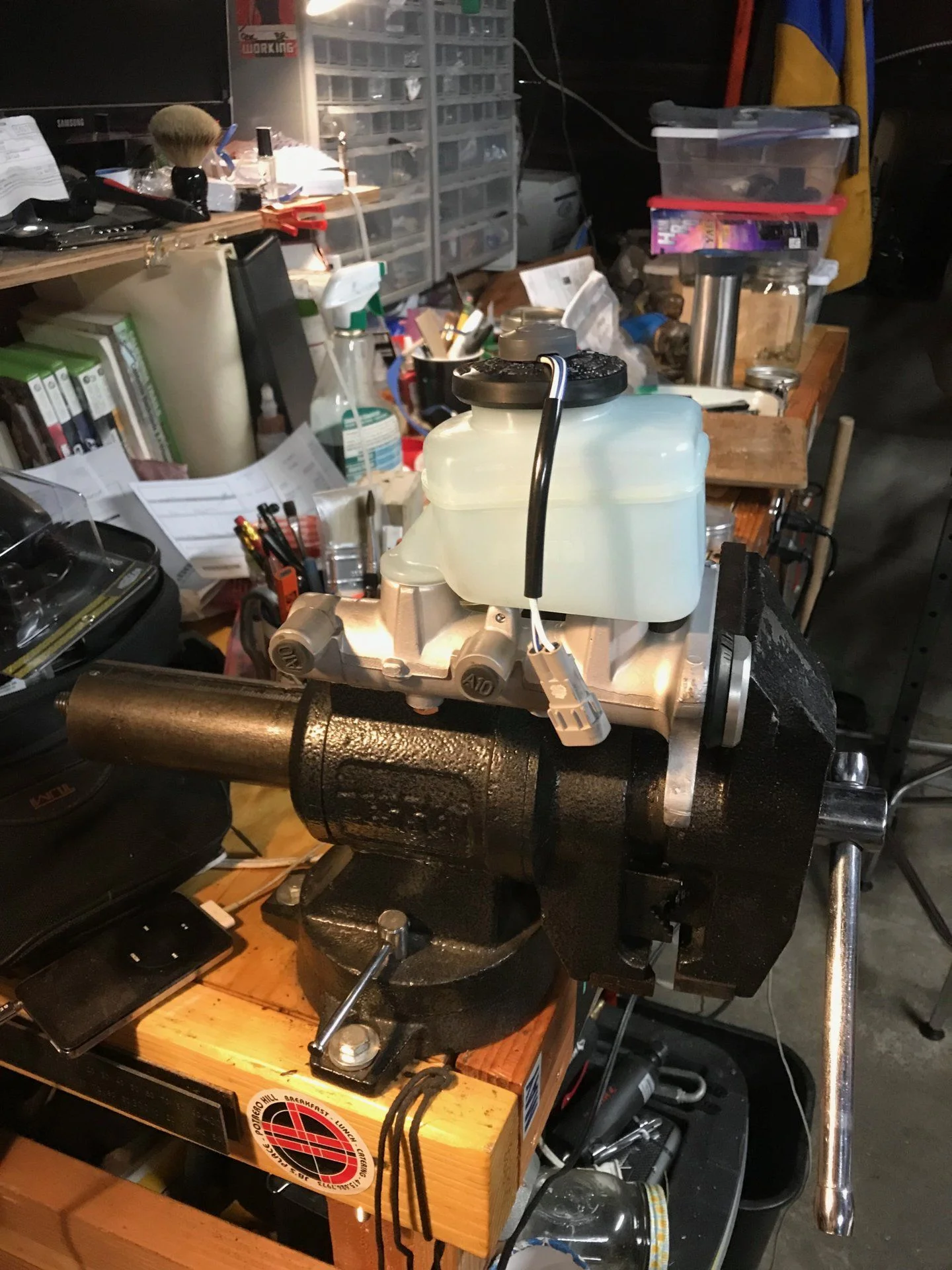

New one next to the old one.

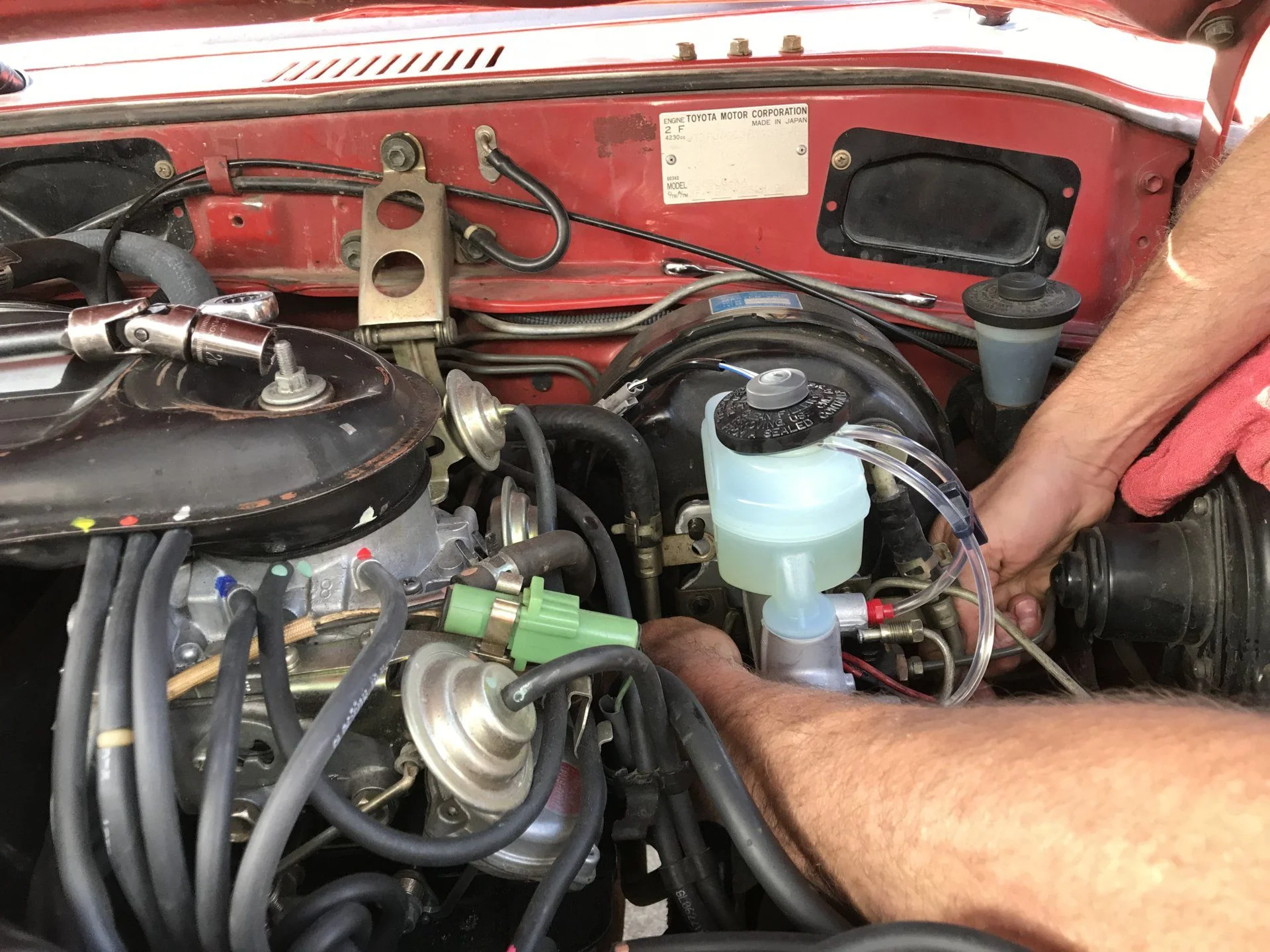

Don't forget to bench bleed the new MC. I forgot to take a pic with the bleeder lines coming out. You can see them in the next pic.
Nice job on that! I gotta do this upgrade soon.
