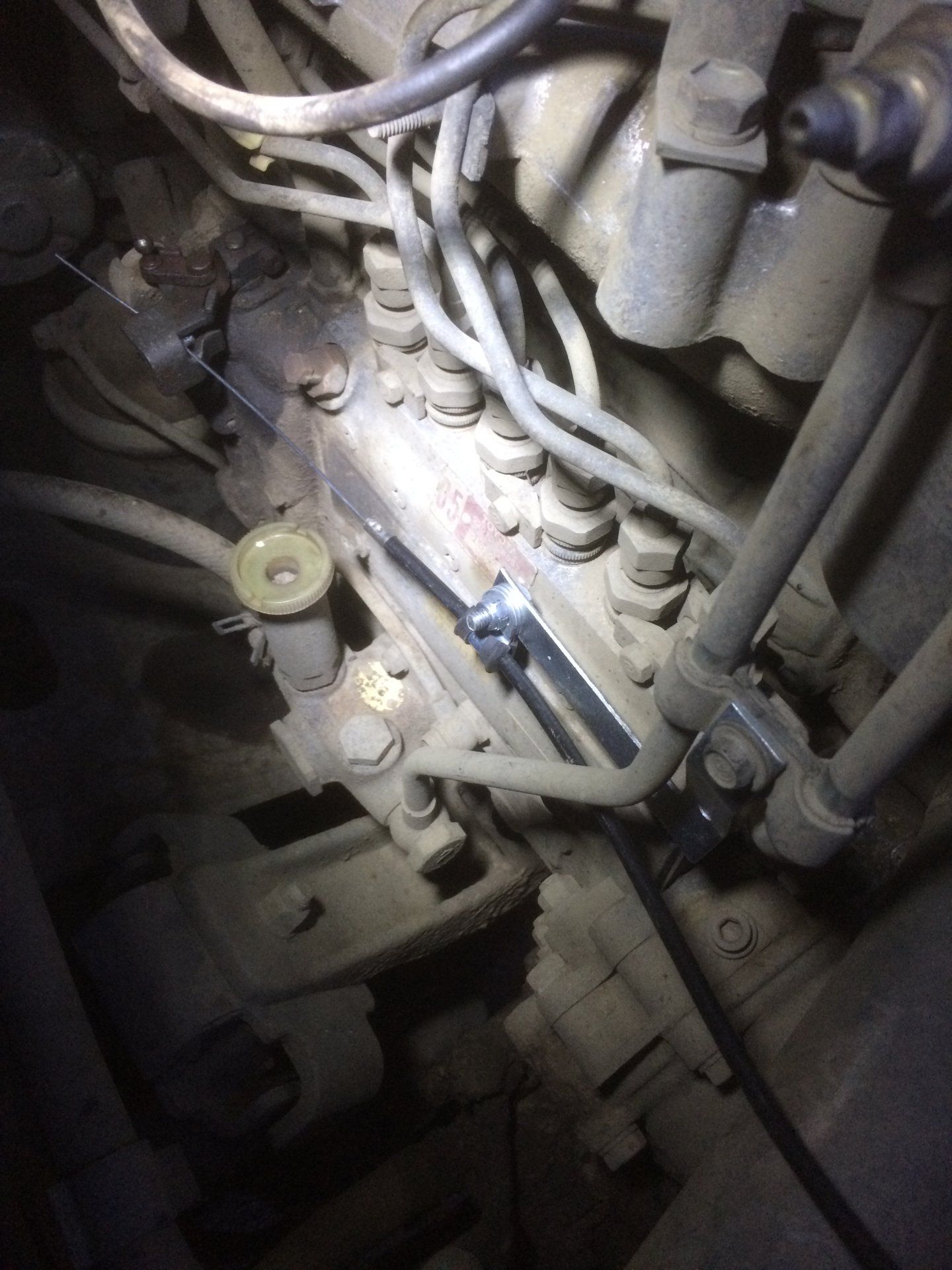

You can just run a simple stop cable.. an old choke cable, or bonnet release cable for example. Dead easy, so simple, never have a problem again.
A few images here to give you an idea: EDIC Cable
Three caveats though
  1. You do lose the automatic shutdown of the engine if oil pressure is lost - a buzzer can be used to warn the driver instead (image at link above)
  2. You are more prone to the engine starting up in reverse if you accidentally roll backwards in a forward gear - this does still happen with the EDIC fitted but generally the loss of oil pressure kills it after a few seconds
  3. You will lose the overfuel startup position - in my experience even in freezing temperatures I've never had a starting problem though, I honestly feel the overfuel position is not required.

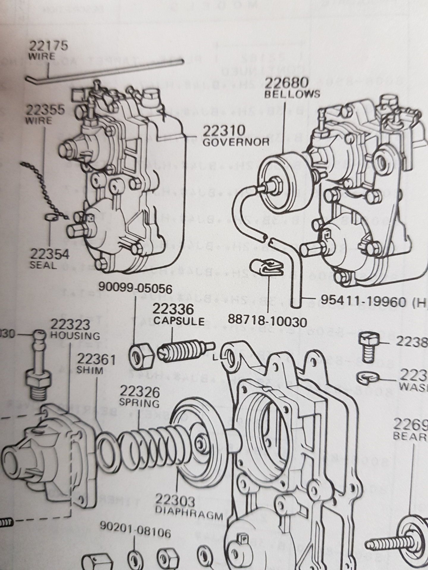

Hi when the edic pulls back to OI (or cold start) it pulls against a spring in a thing toyota calls a capsule . That spring holds the edic in run position the spring rusts out. Needs new capsule it is adjustable aswell. Cheers
Oct 20, 2009
92
N.S.W. Australia
part number 22336 68010

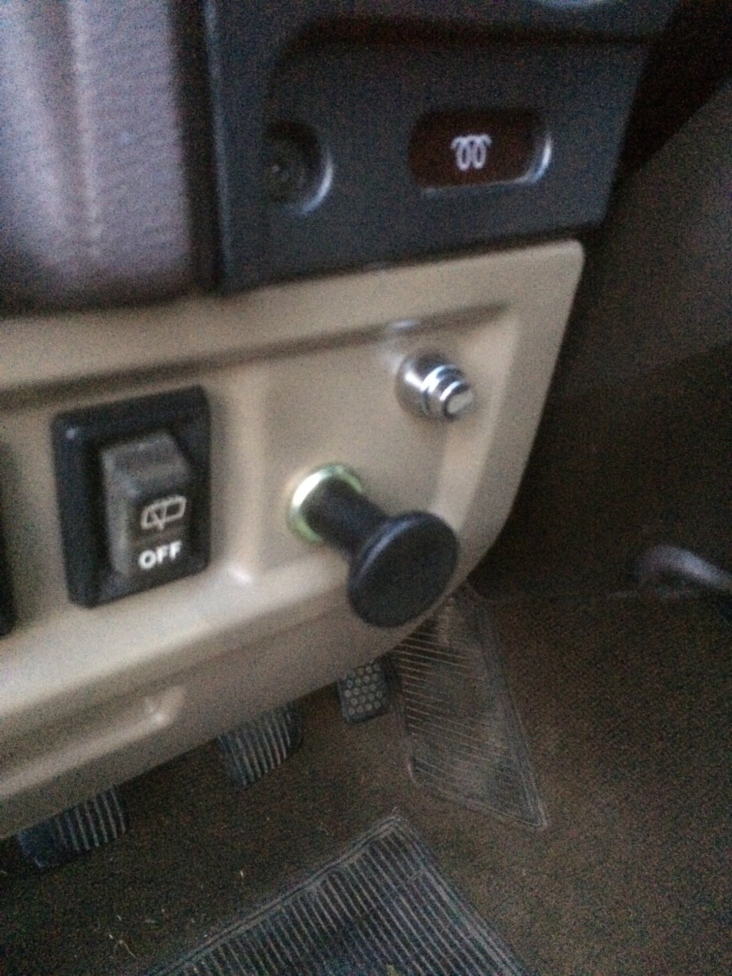

Guys, my question is not yet exactly answered, but the problem is solved! Thanks everyone for the advice!
(The button right above the motor shut down button is my manual glow, so both the glow and the EDIC controller are in the past now!)

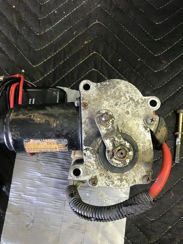

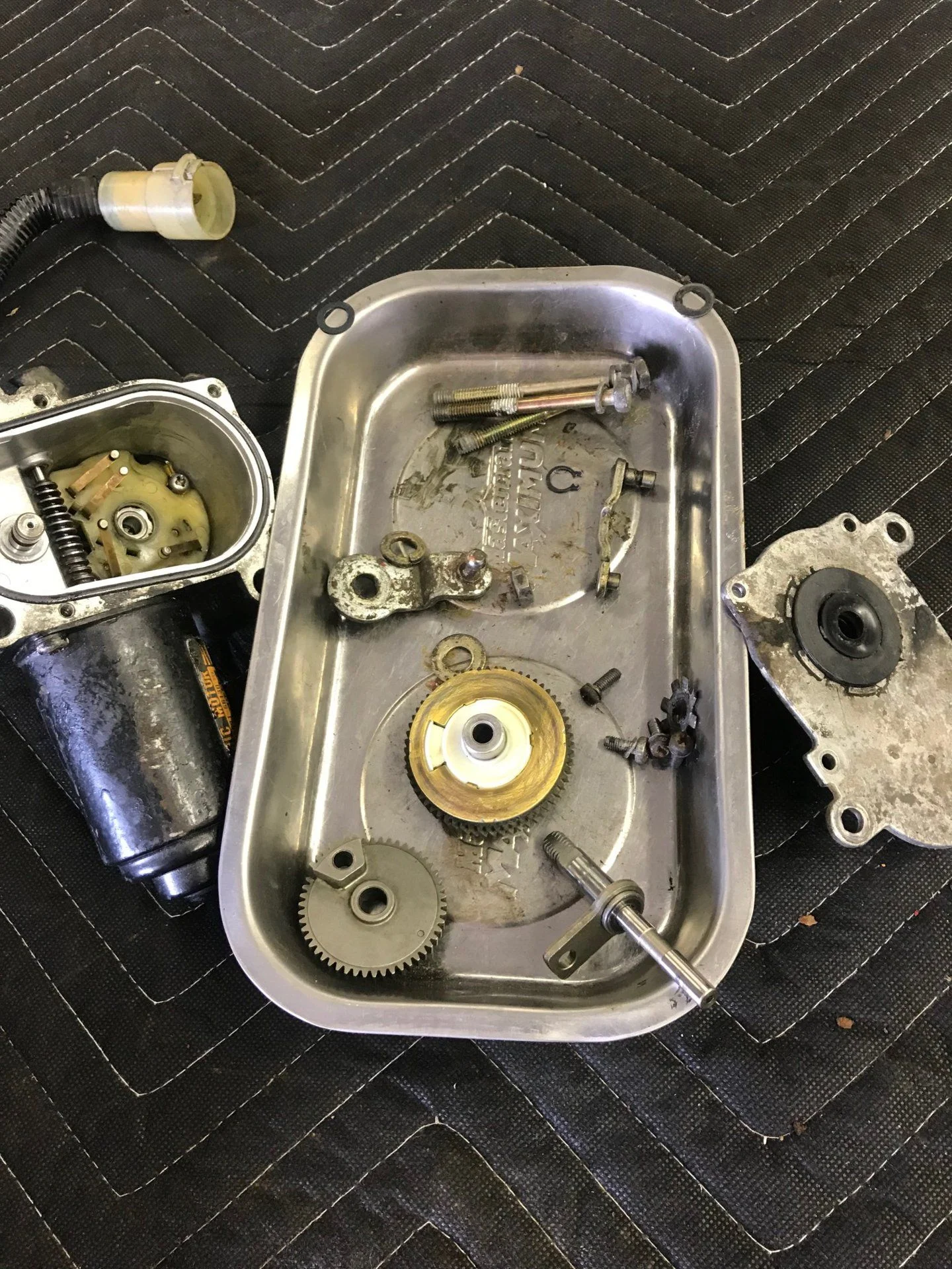

A little late to the races here and hope I am understanding your question but will post up in the case it helps in the future.
I just took my EDIC apart for what I hope is my last time in a long while. I removed all the grease from a rebuild years ago and replaced it with some Molykote 33 light. My guess was whatever grease was used years ago during the rebuild was mucking up the connection at the copper control disc, as I had been dealing with increasingly hesitant EDIC system between long periods of no use.
I took a few pictures to make sure what went back together looked like what came apart.
1st picture is of the EDIC showing the orientation of the arm that moves the fuel lever on the pump.
2nd picture is of the cover off and the orientation of the two gears and the arm between them. The two gears are indexed with a dot you should be able to see in the photos.
3rd picture is of the gears removed, as well as the contact disc (upside down in the tray) which when placed down into the bowl, creates and contact points needed for the cycle of stop, over inject to start and run positions.
I did not have to go any further this time (but have in the past...look out for the small bearings at the ends of the rotor iirc) but cleaned it all up, re-greased and put it all back together. It's been working great since then.
From what you described I would think this area is where to explore, if you're inclined to dig into it again.

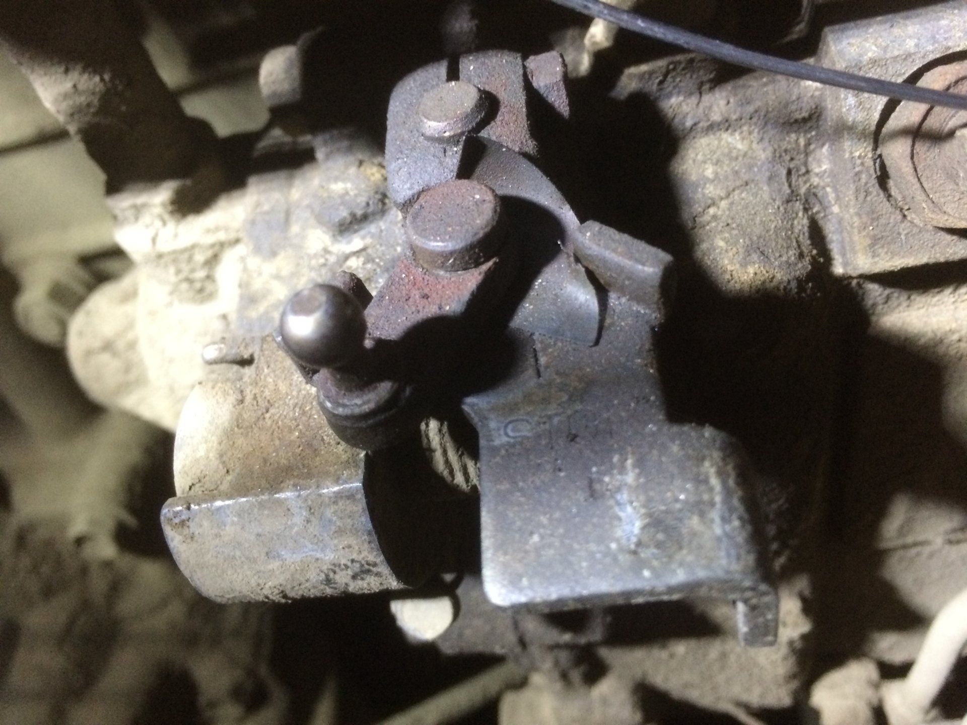

I'm thinking about engineering two cables, so that one is the shut off and the other is the overfuel for cold starts. Has anyone done that? A solid bar coming through the firewall would be ideal, but the heater is in the way on the cabin side of the firewall. A lever that would allow a bar to make it through the firewall, while allowing a overfuel plus shut off would be awesome - but I don't have the time to work it out.
Nov 22, 2008
3,186
Richmond B.C.
do you not have an idle cable already on the lower dash.
all my cruisers have this cable which controls the butterfly in the plenom (sp) so I can fast idle on cold mornings similar to a choke.
The cable is connected to the gas pedal and lock at what ever rpm you want.
Apr 2, 2018
55
Bozeman, Montana
Yeah it has one of those, I also hold the pedal down halfway to start, but figured the "overfuel" function was something different....is it just doing the same thing??
jim land
SILVER Star
Aug 6, 2007
2,176
scott quebec
All you need for the OI is a small pivot near the IP , so you can use a cable instead of a rigid rod, when you pull the cable, the lever is pushing on the " over injection "
A carburator spring can be hooked to the lever to make the pull knub spring loaded
