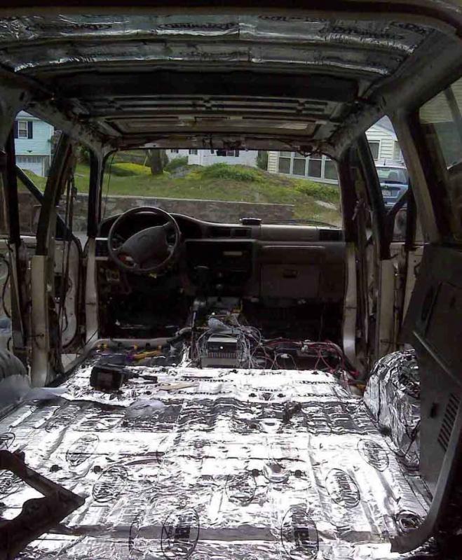

99 sq feet of raammat. I did the doors also but there not in the picture. The toughest parts was removing the factory stuff. The dry ice method worked quite well but it was still time consuming.
Willy,
How much did you use?
