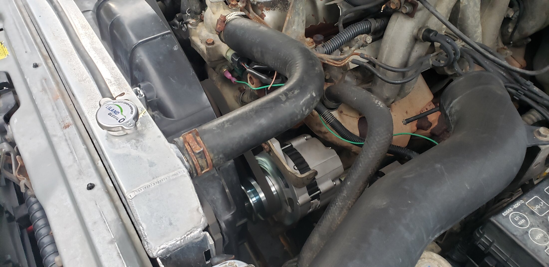

no. the bracket is different between the 80 amp and 90 amp unit. You need the 80 amp unit with the external fan.

Here are some pictures mine has the external fan 80 amp
