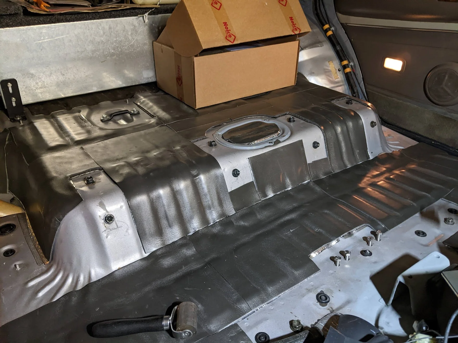

I used Noico as well. It is just foil-backed butyl rubber. Don't over do it with coverage.
You get diminishing returns with any of the adhesive matts as you get closer to panel edges, but that doesn't mean it's bad to do. The foam should be 100% coverage as it doesn't work as a mass damper.

In my 80 I did a combo of dynamat and killmat and then a layer of Noico foam. Mass loaded vinyl would have been the next step, but I was starting to have carpet fitment issues and I couldn't find a reasonably priced source of MLV at the time.

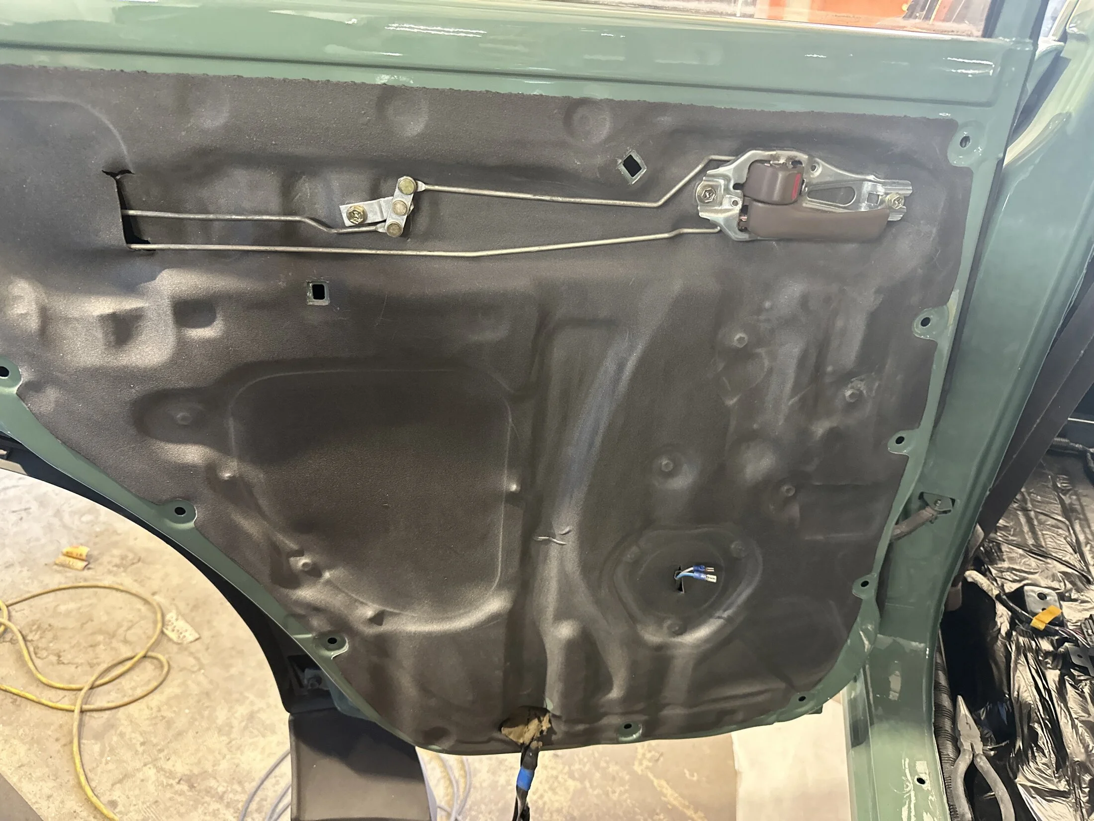

I also used Noico Foam.

Is this foam? …
