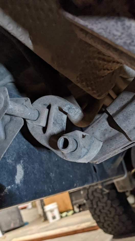

Well, I suspect I found the culprit: failed $7 part :bang:
It's amazing though that the first exhaust hanger isolator on the passenger side isn't until after the x-fer case crossmember on the frame rail under the passenger seat, downstream of the Y-pipe confluence!
Driver side has a hanger post 1st cat flange @ the beginning of the Y-pipe, pre second cat. . .
Well, while late to discover and po$t another expensive repair and downtime 9sometime) it's a relief to identify this and I guess for now I'll try the JB high heat goop, but should consider the interim fix of pulling the mani and shoring it up with welding the crack and reinforcing the area with a bracing splint. 😑🤷‍♂️
Great investigative work. I now feel the urge to go check my exhaust hanger isolators!

First things first, I replaced the problem child, split hanger isolator which caused the added stress to the manifold.

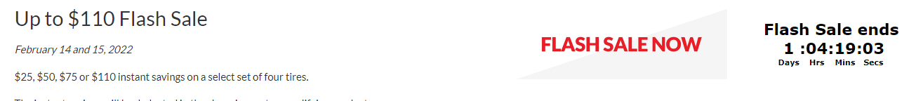

Been waiting for BFGs to show up in the Discount Tire sale emails.
Finally! At least the $110 instant savings is something. That pretty much covers tax, so why not? ;)

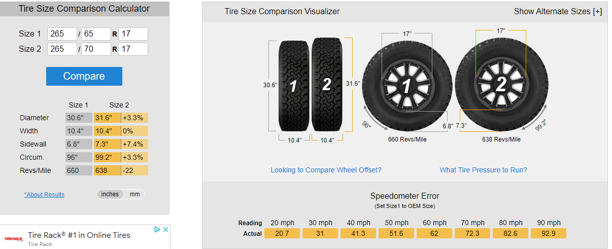

Committing to 31.6" for the next 5ish years, larger won't fit in spare (as I still have no suspension lift, no bumper with swingout, etc.).

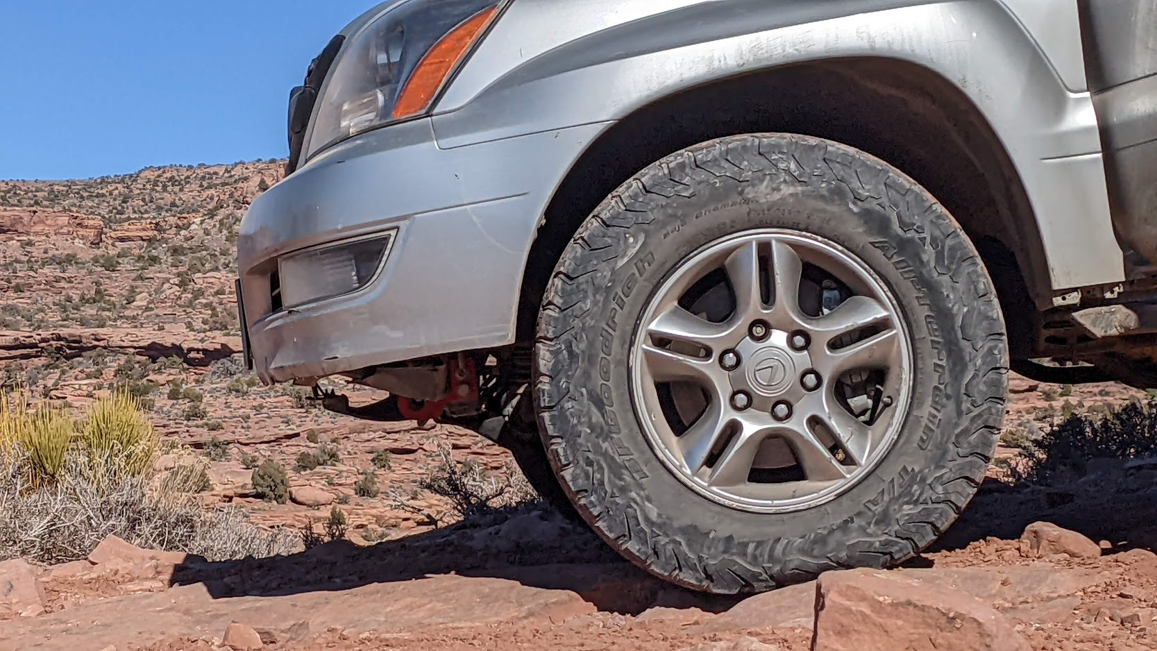

BUT, I still can't get over the awesomeness of the KO2!! Their marketing is one thing (note comparison @ 0:50 in video), their proven performance and longevity on the ground is undeniable!

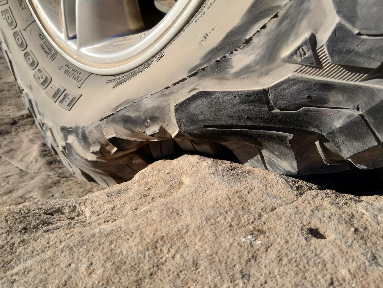

I have some decent sidewall gashes and tears and have had ZERO issues with these. LOTS of highway miles and Moab trails for nearly 5 years.
