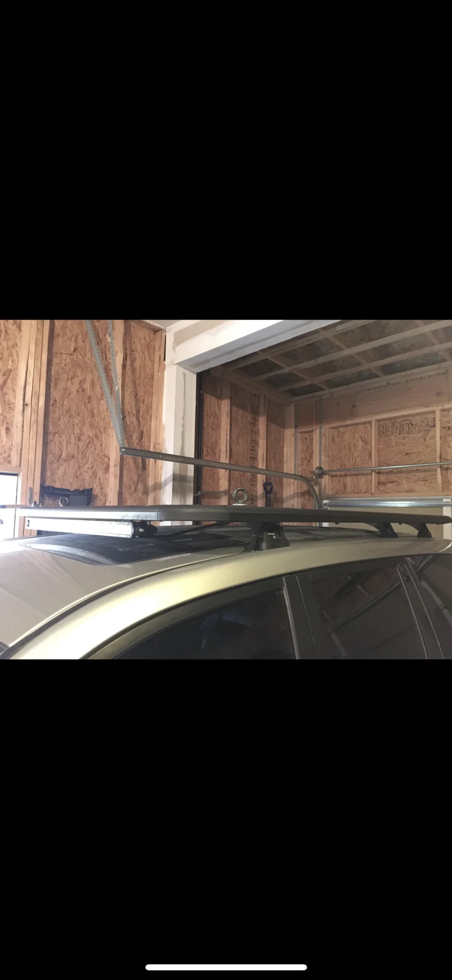

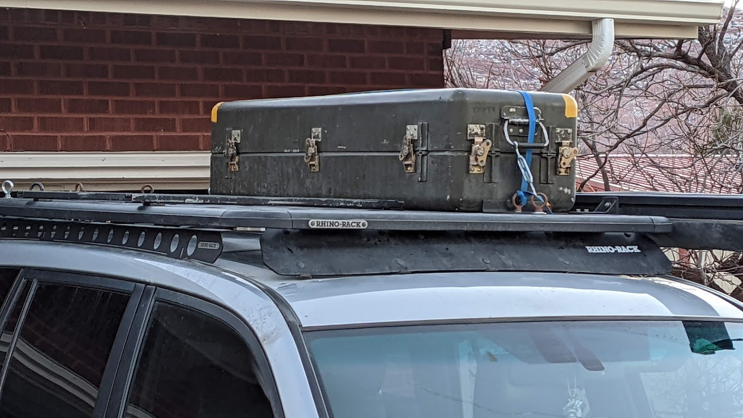

@mtwilly87 there are two 1" pressed steel (90 deg, but not angle iron) plates shoring up the ends which are fitted to the platform via my unistrut camnut discovery. Then the handles are fitted with turnbuckles to the platform on RR eye hooks. I too thought about drilling holes and fitting with camnuts to the platform slots, but didn't want to compromise the dust seal.... But hard mounting that way would allow easier entry access. As this is I have to undo everything to get in as the handles are fitted to the top of the box clamshell, which is what makes fitting handles down good. double edged sword for sure...
Its hard to see the pressed plate. It's also clearanced so the bolt which holds it to the platform is an eye hook too, that's where the cam strap is fitted to hold the box down as backup the turnbuckles.

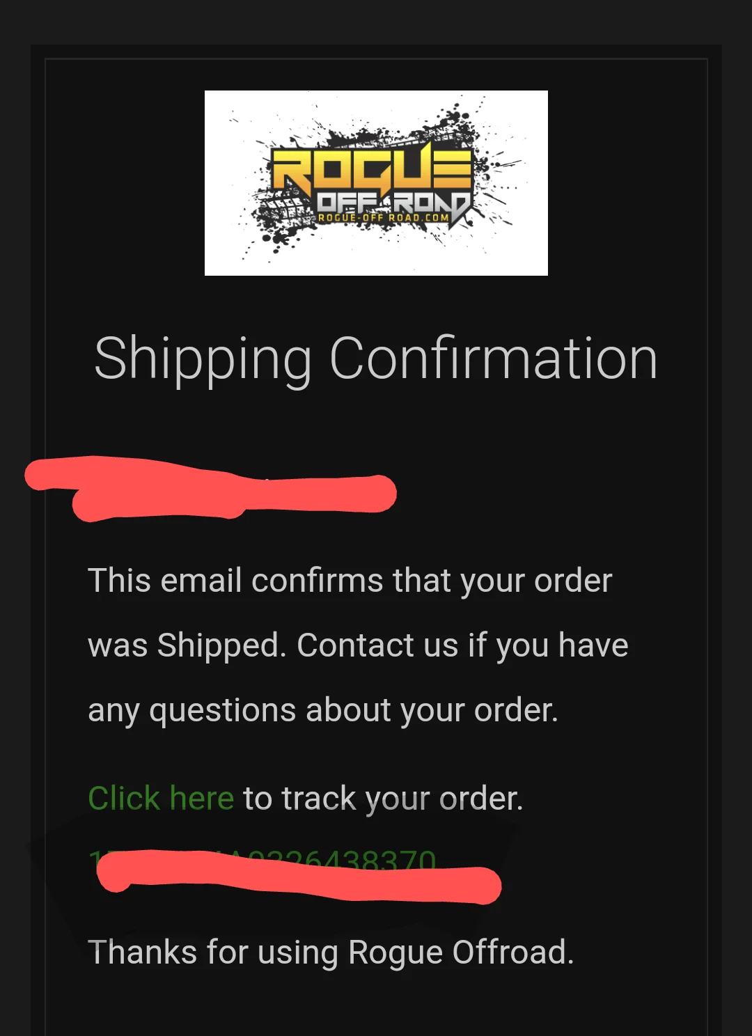

I pinged DT and Rogue off-road today, DT says, "This part number has been added to our production list and is currently being made, your order is set to ship 6/03-6/17!"
RAD! Thanks team DT, I'm psyched!!

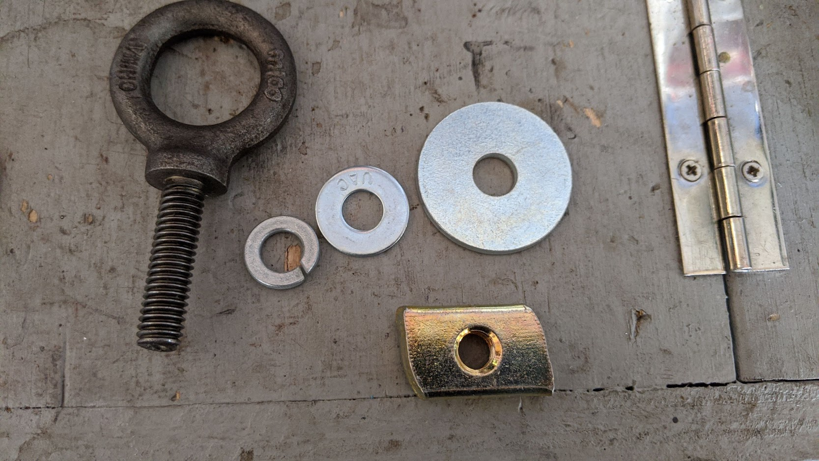

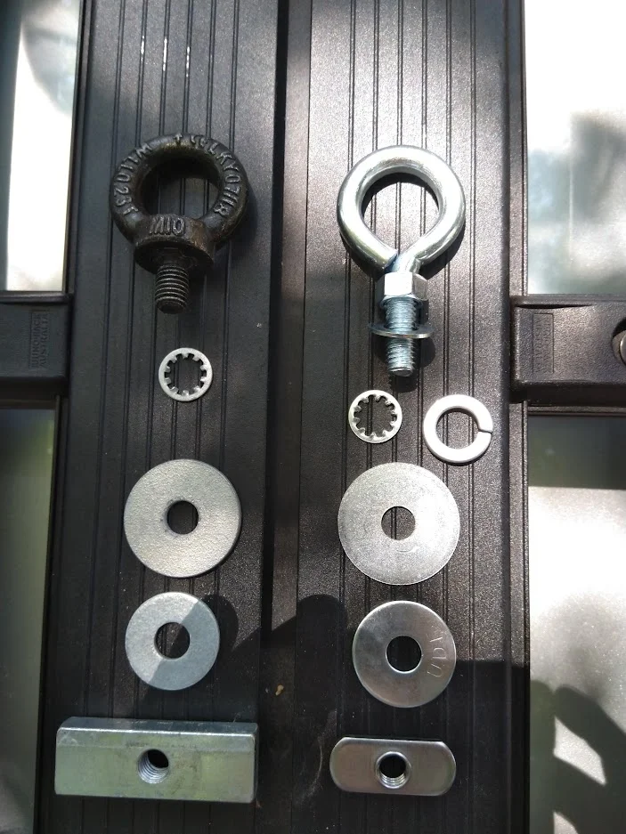

Fairly shortly after getting the RR pioneer platform and an initial set of their eye bolt kit for securing dunnage, I began modding to make my own tie downs for le$$.
first round using zinc eyes (I think I welded one shut too for giggles) and a slot nut
Version 2.0 used a 3/8 forged eye, trimmed down with a unistrut camming nut (which is a pretty good replica of their other eye bolt kit.
And now, using a scrap piece of 3/8" x 5/8" bar stock (very close to Rhino's metric 9mm x 19mm bar), cut, ground, drilled (11/32) and tapped for M10, I've created 6 more with M10 galvi eyes (came in 3 packs)! Now to get the washers and I'll be golden!
$8.69 in washers then squirted the bar stock black.
GTG ... Hmm, i guess I could squirt the eyes to match too 🤔
Relentless pursuit of perfection.
Awe heck yeah!!! 🤘😈🤘

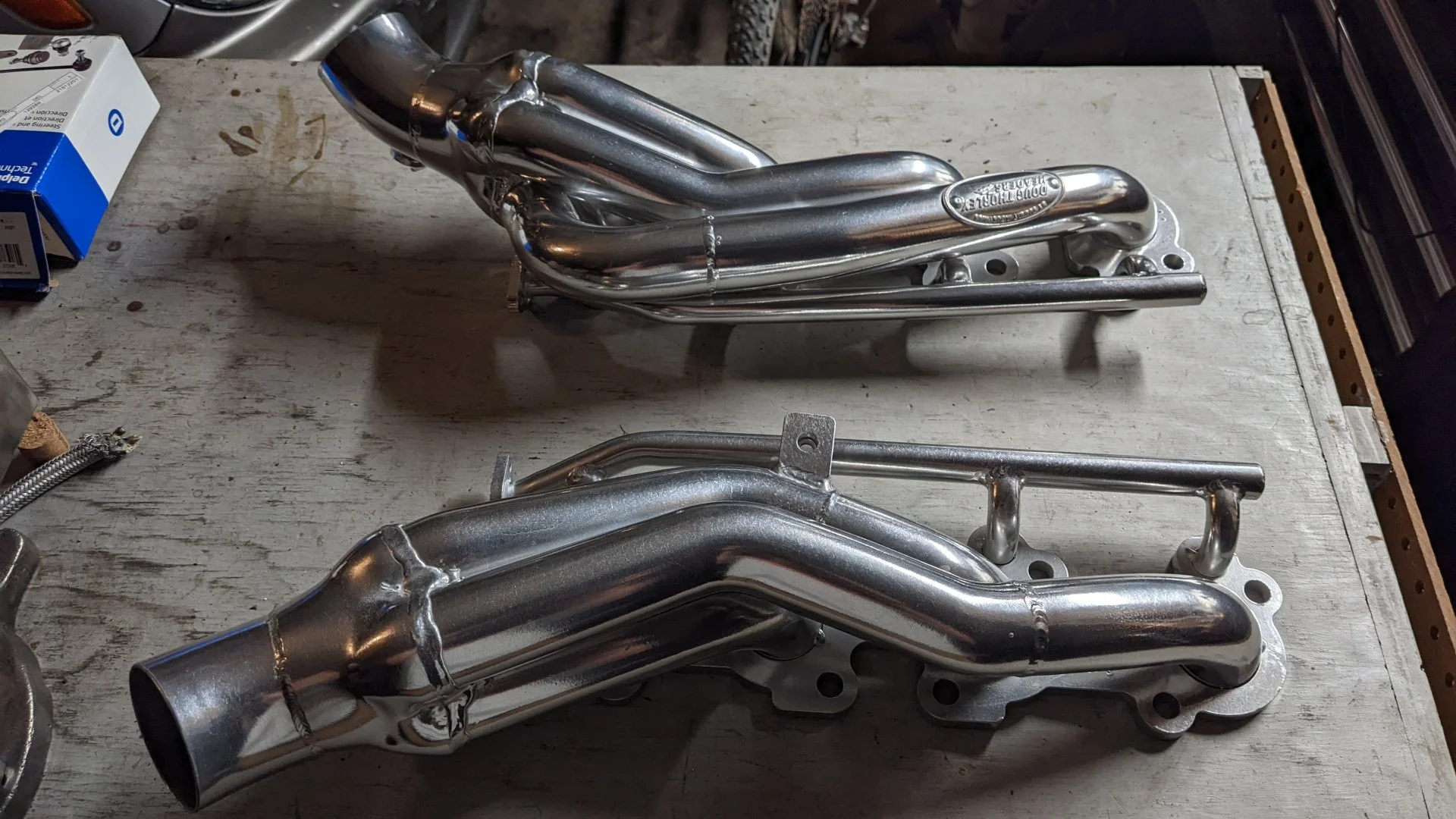

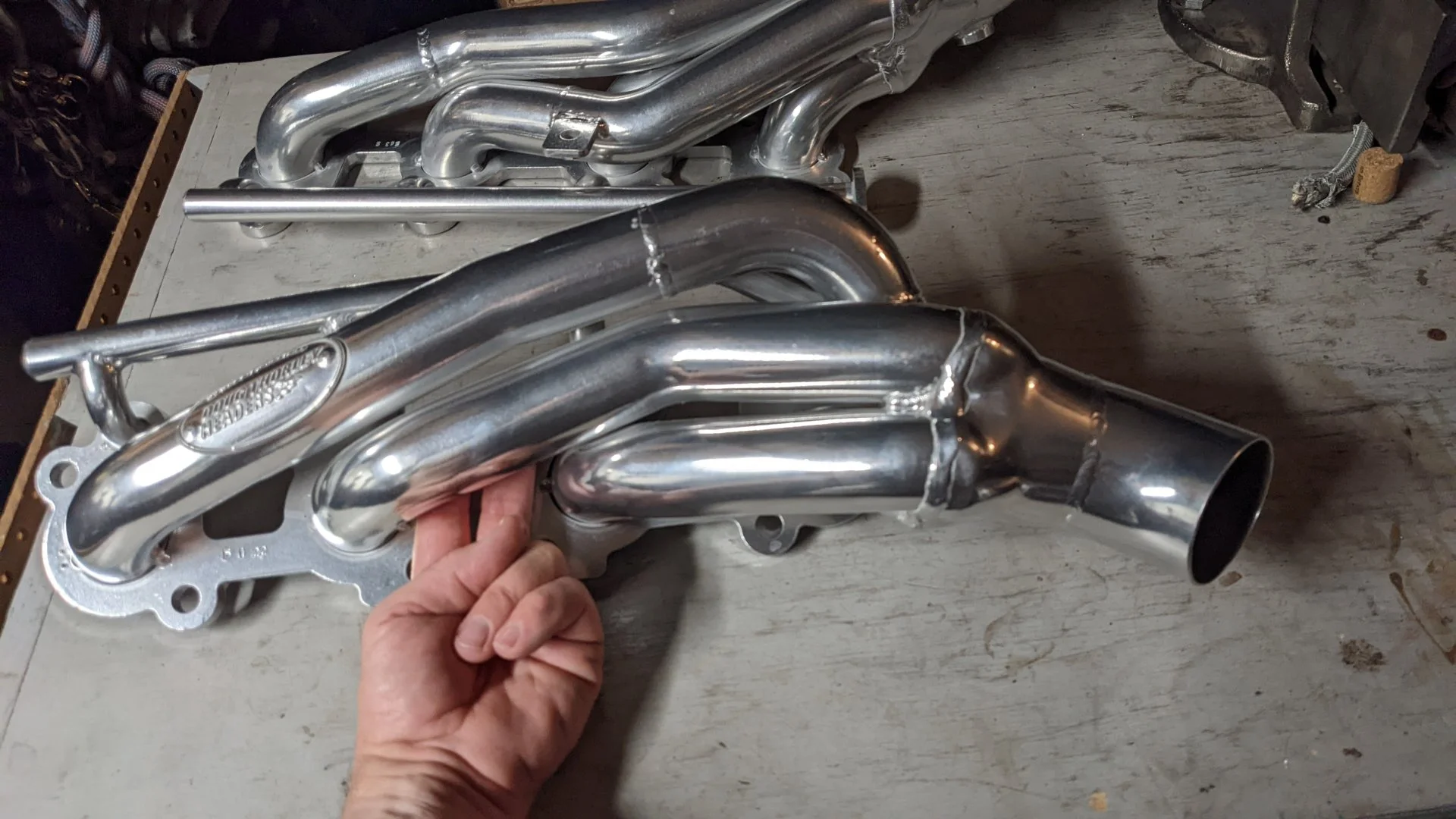

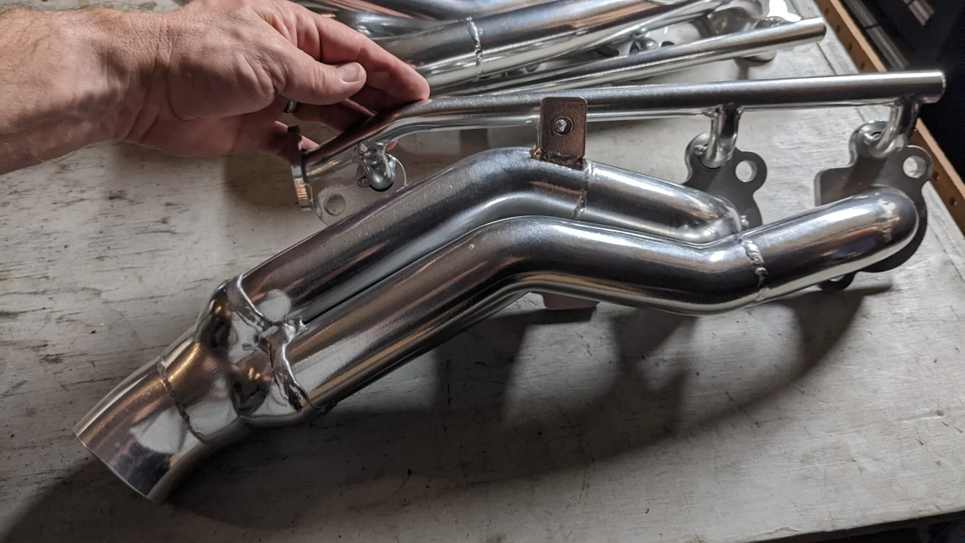

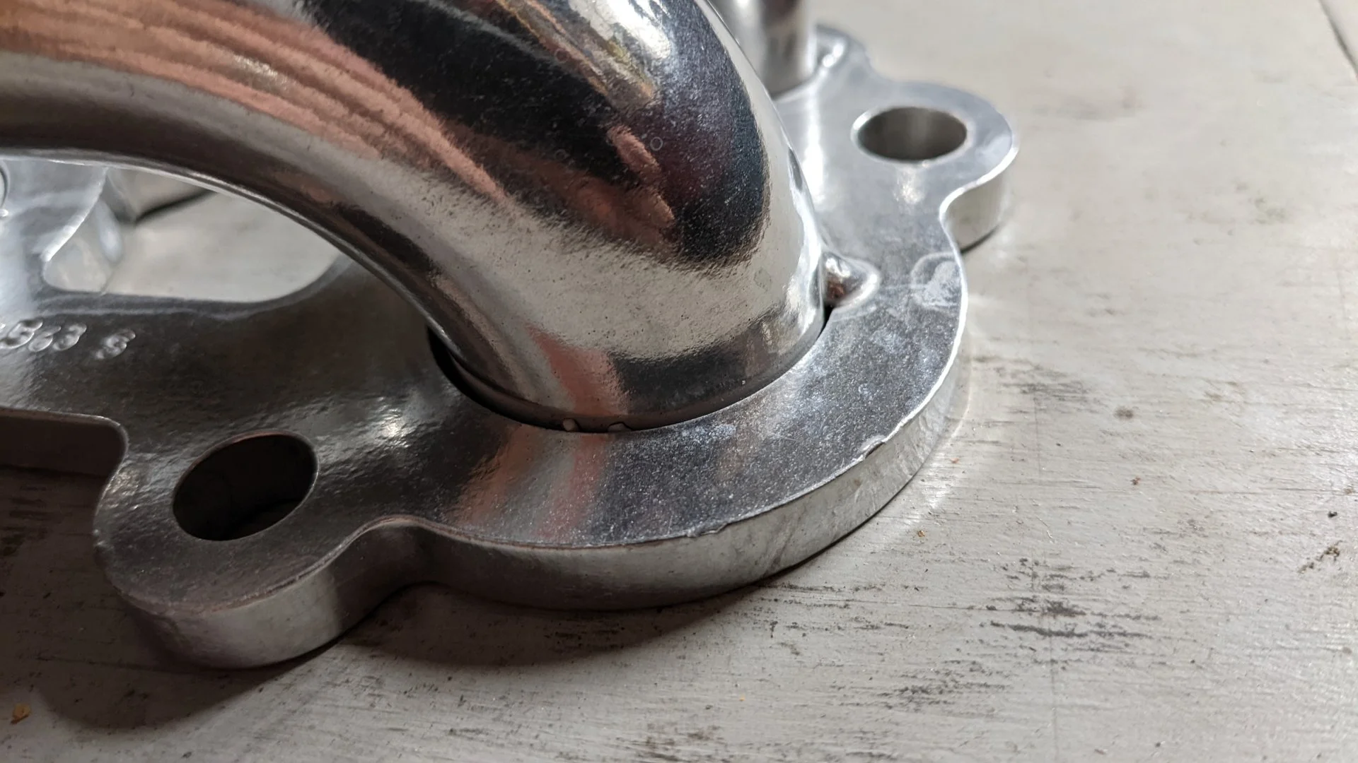

Fulfilment of trigger pulling mid-December...
Delivered today!!!
Light at the end of the tunnel!

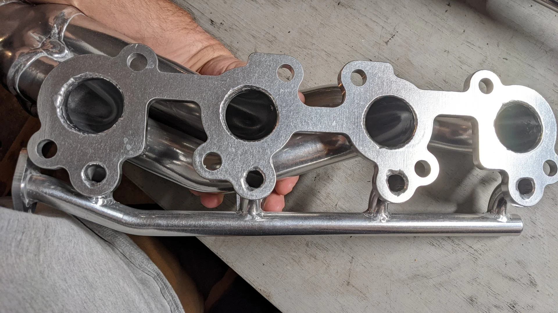

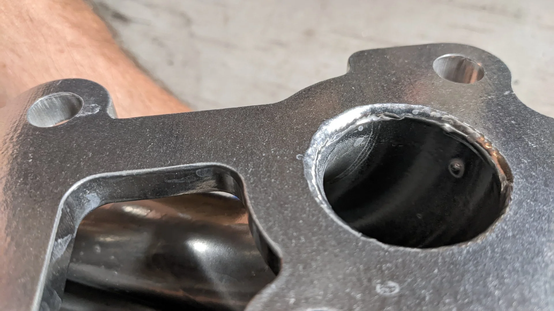

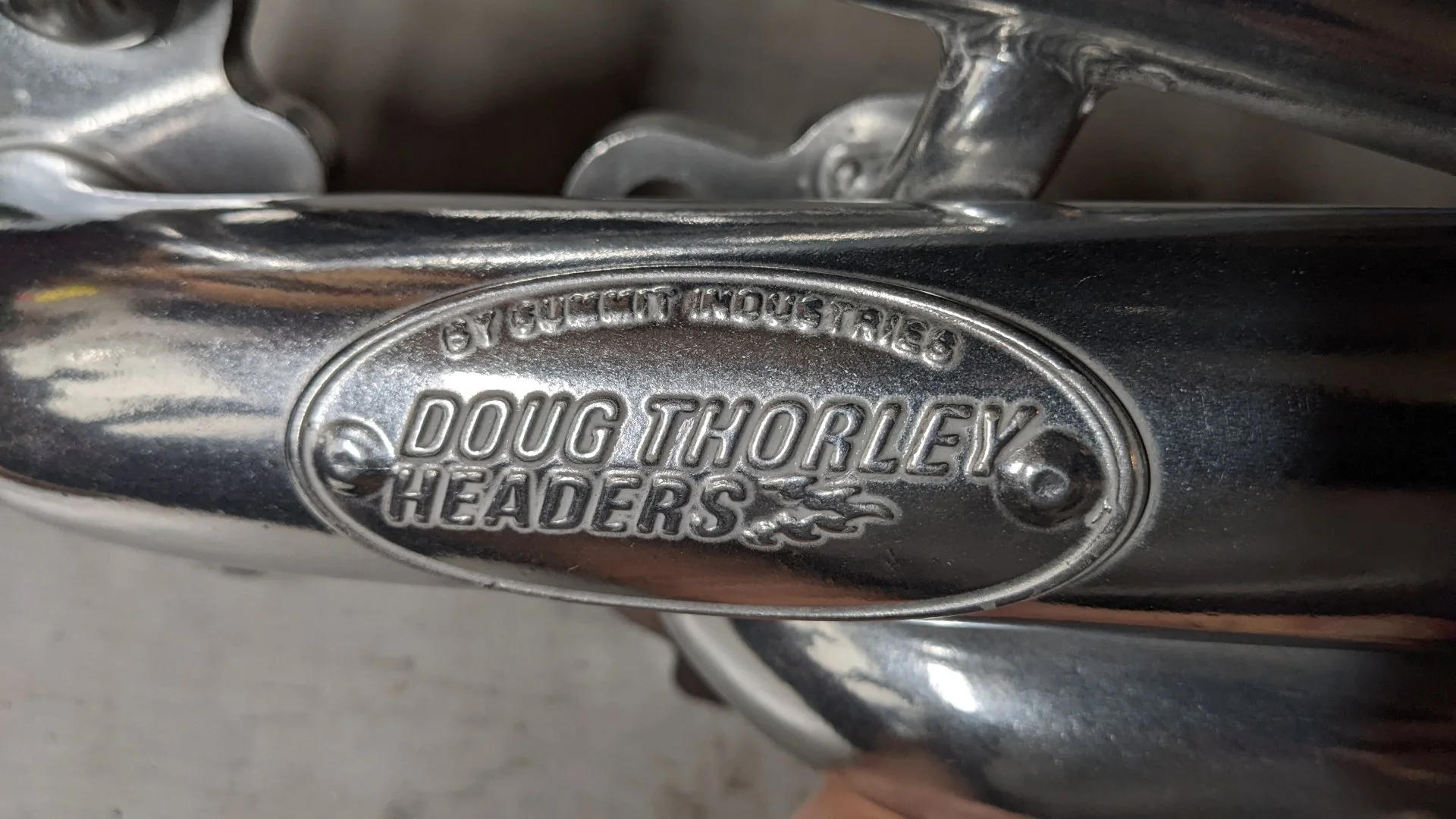

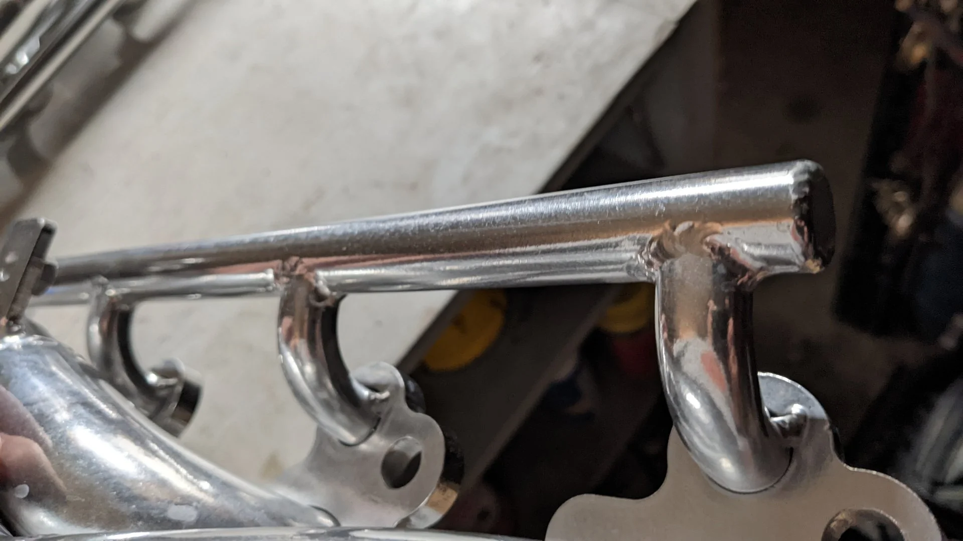

I'm sure you'll be thrilled not to have to pull a header again for some time when this job is over.

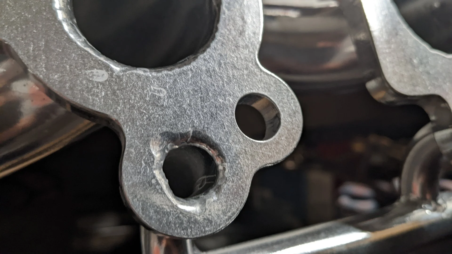

Yeah my weld job is starting to fail and a slight tic tic is back....
I'll order some engine mounts and V-bands and try to get on my buddy's schedule .... 🤞
V-bands are the way to go!
While you're doing your motor mounts you might want to look at replacing your transmission mount too.
That way your complete motor suspension system is fresh.

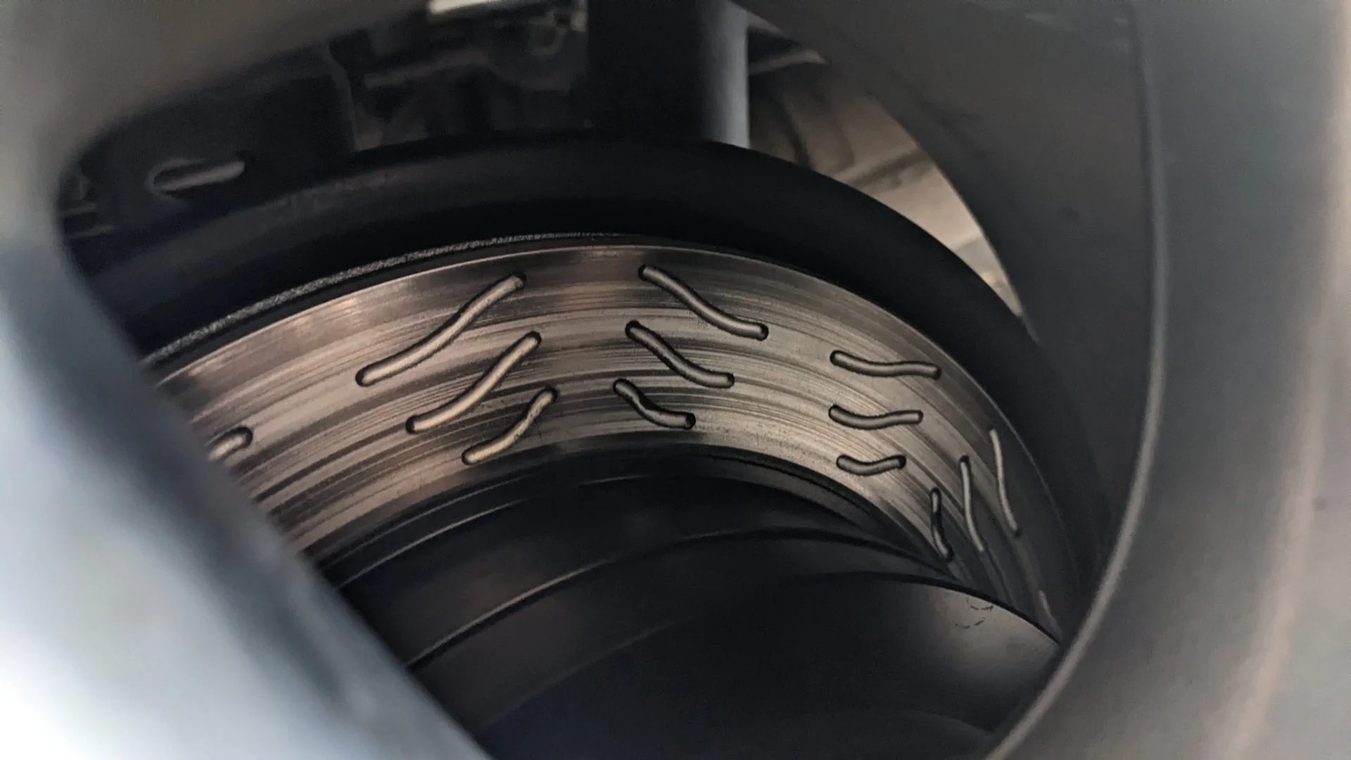

snappy brakes with new (adaptive ones) rotors! New meats smell great! Ready for the next 70K miles (and beyond)!! ;)
Adaptive rotors? What do they do?
