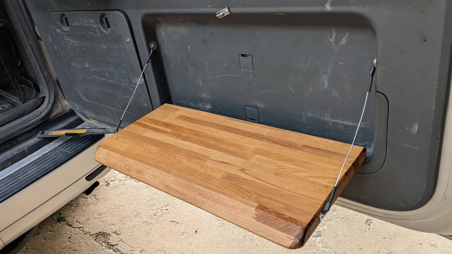

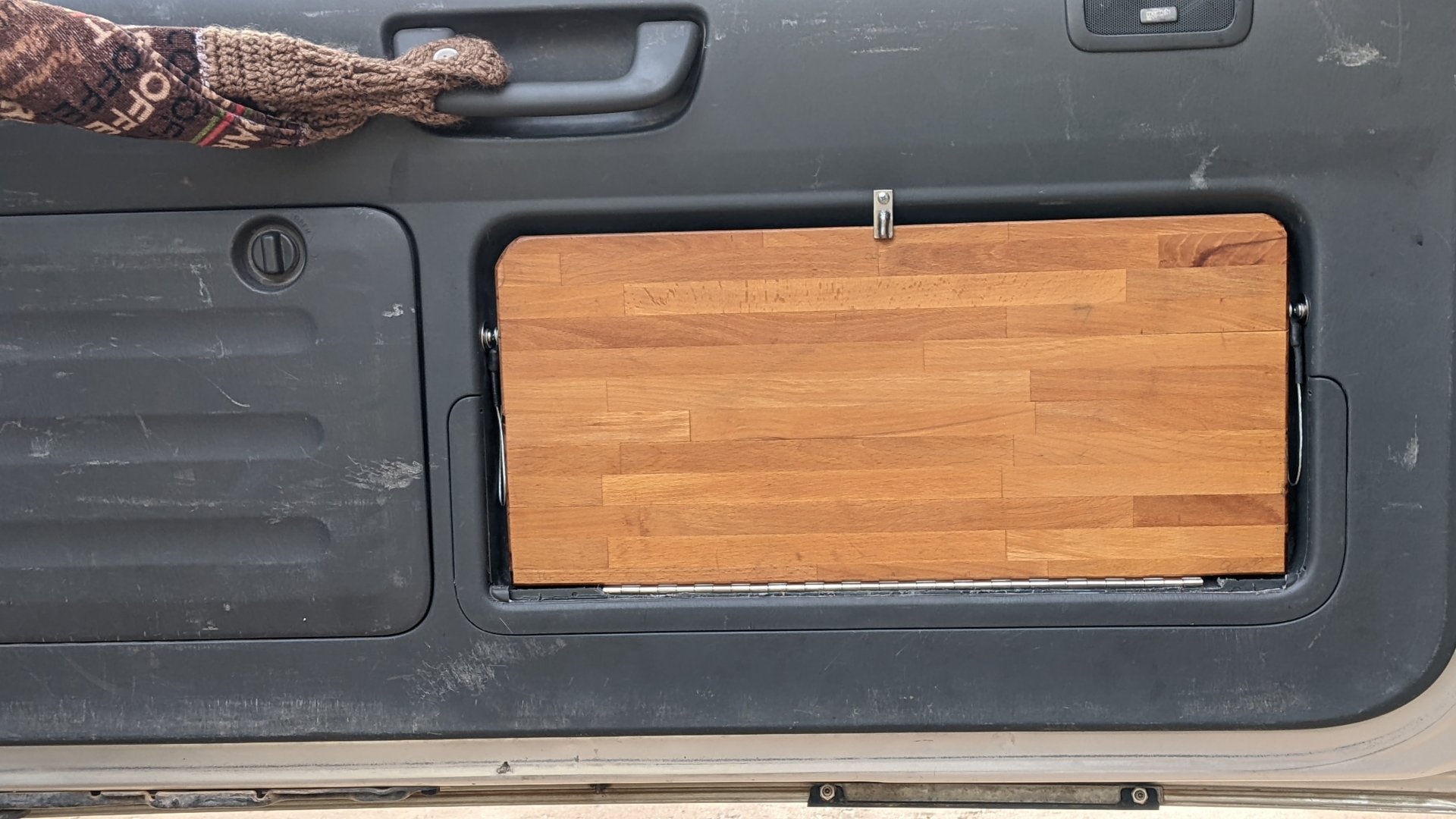

Finally built my snack table!
The frame you built around the backside bump out is just to reinforce it?
Nice job, clean install.
Yeah, I started out thinking a metal strap to mount the piano hinge to, but then just got carried away. I had thoughts of recessing magnets that might hold it shut on the beveled top, but as I kept building out the frame I figured all bits might as well Mount into a steel structure rather than anything just going into plastic.
I definitely overcomplicated a simple thing (modders motto) but I'm pleased with the results.... Although I did run into the same issue that @cosport ran into with his table back in 2019. I shoulda mathed a Little more. 🤣
My support mounts ended up interfering, I lightly planned that they wouldn't, but it was also 130am when I was finishing this up.

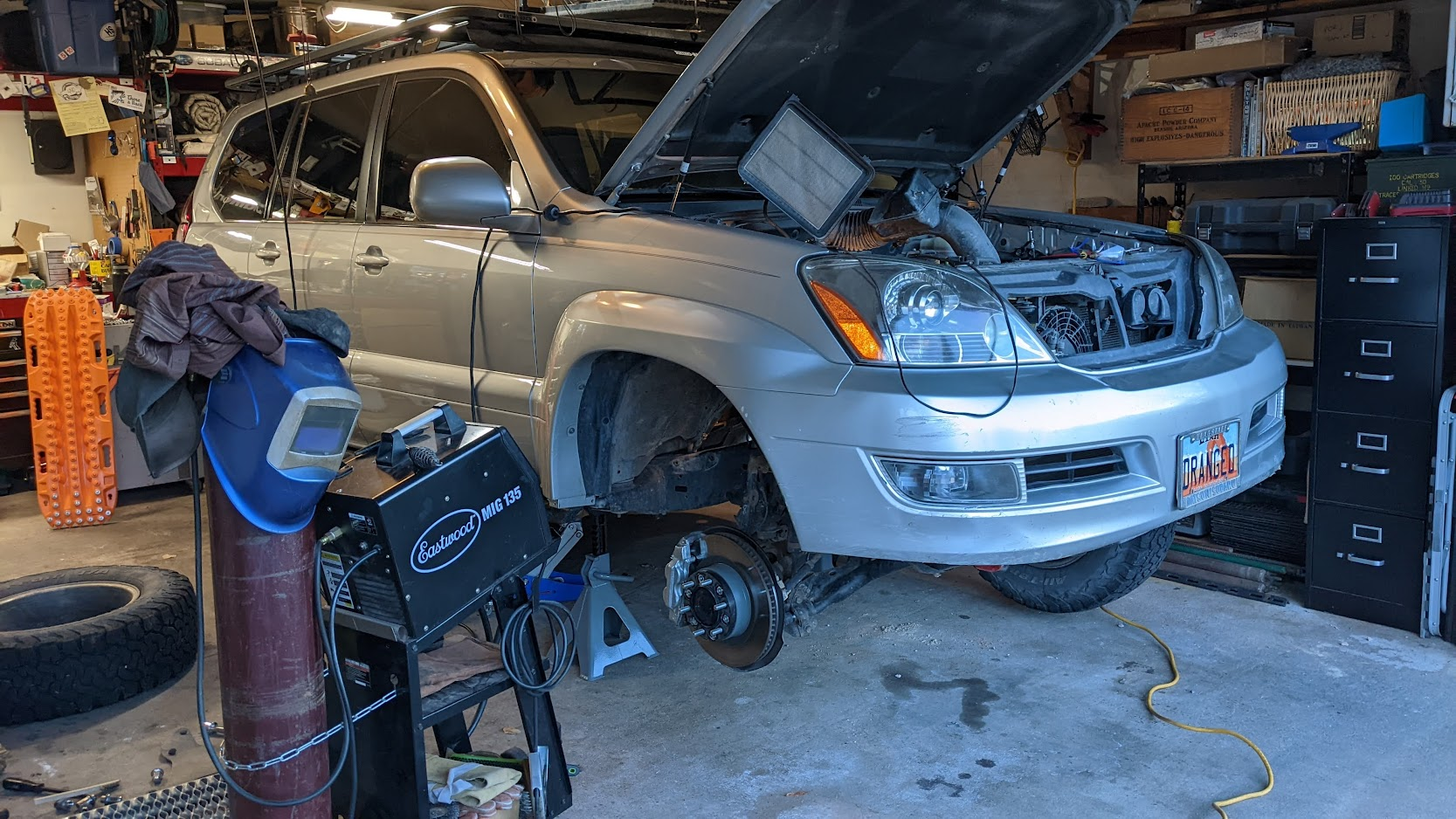

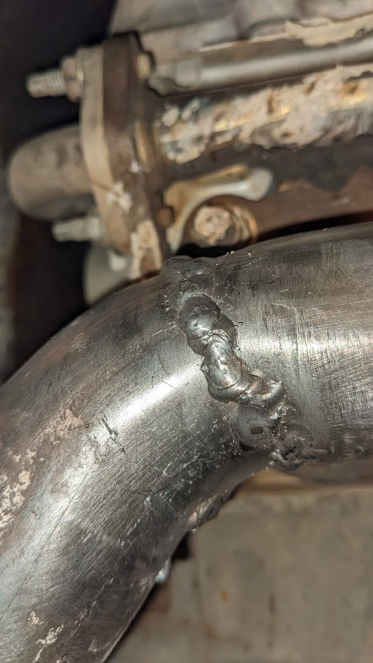

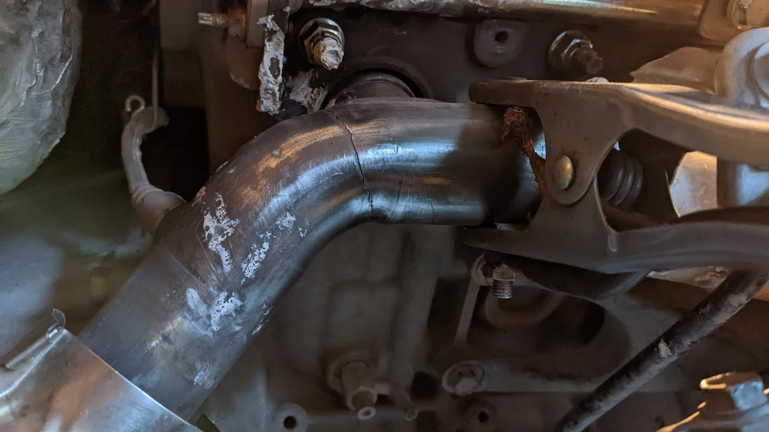

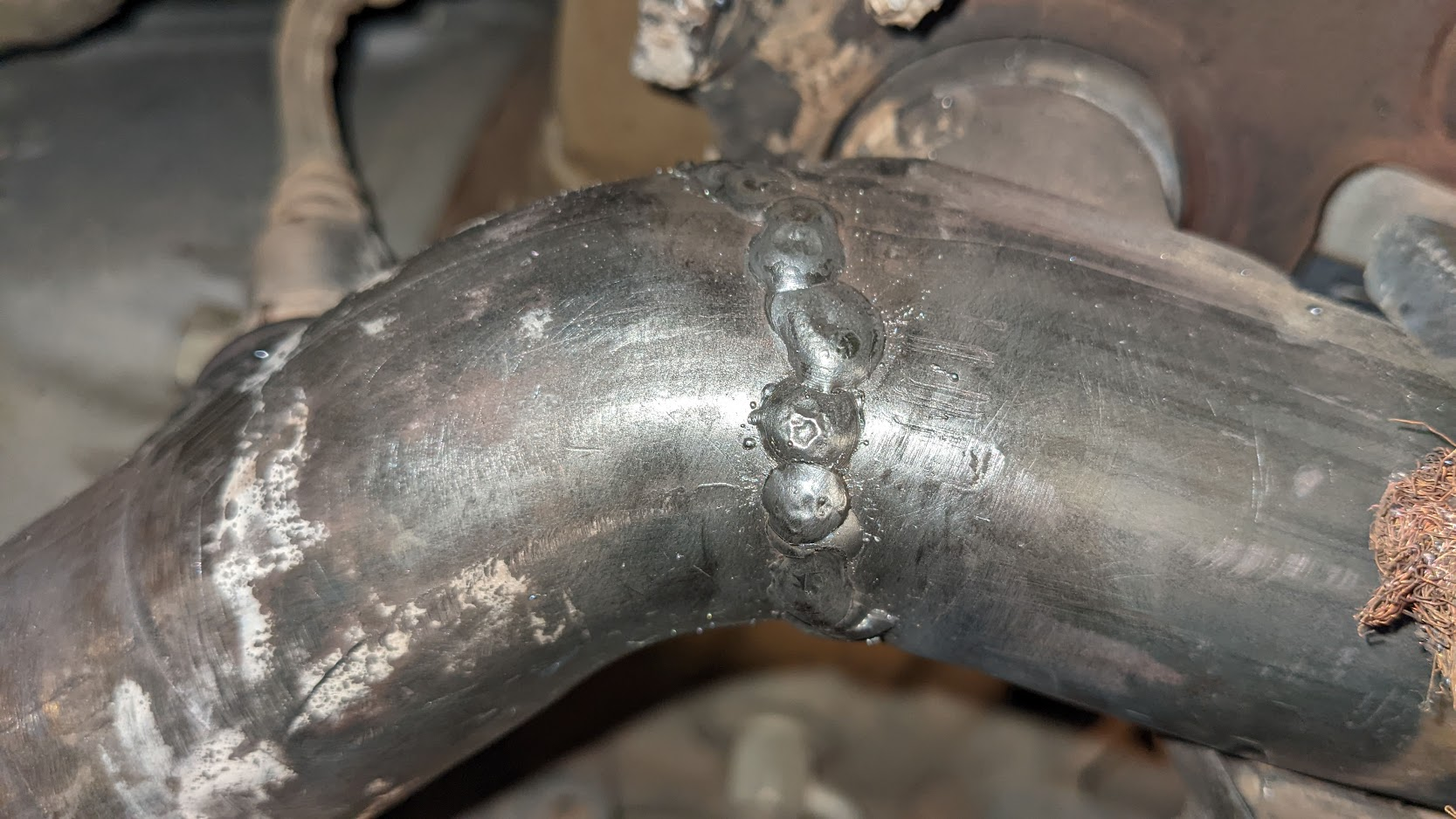

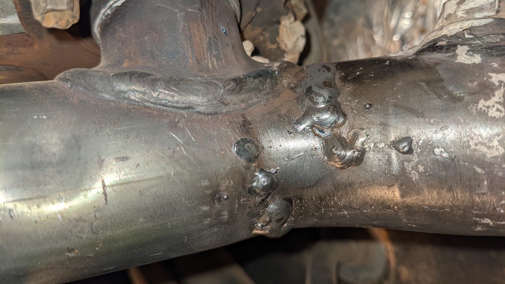

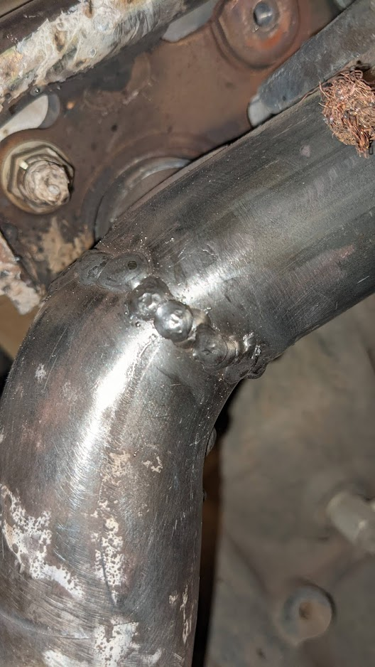

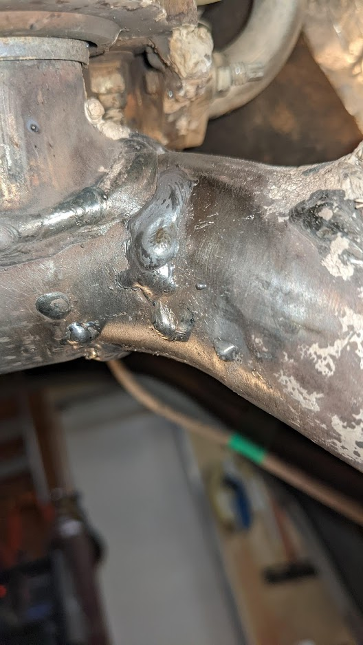

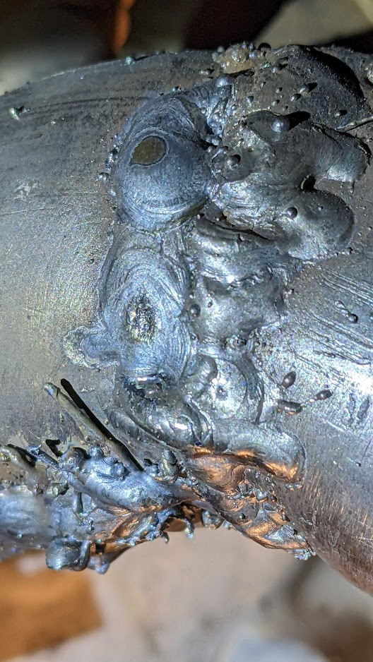

Then with more wire brushing and brake cleaner to prep the surface I set the Eastwood for 18Ga as a starting point and zapped a couple tacks to test settings
brushed the tack to see what I had, adjusted a little more heat and wire feed, a few more tacks then connected the dots.
So I zapped it up tack by tack, opposites and resting to not heat to too much.
(psst, some tater vision so as not to disappoint ;)
same round of views. Top down, side looking inboard from wheel well, down below and sort of below looking up and out.
It's certainly not as rad as buddy's TIG would've been but I think this'll be temporary enough (especially with the new exhaust hanger isolator) to see me through header delivery. Temporary-permanent enough at least.... I'll keep an eye, or rather an ear on it. Its really hard [for me] to get a good look all the way around (I don't have mirrors), I suppose I could've done a better job of 50% or so overlapping tacks and I think there are a couple tiny seams of crack not covered (particularly inboard along the weld from the cylinder port to the manifold collector tube), but I think this should be okay for a while...

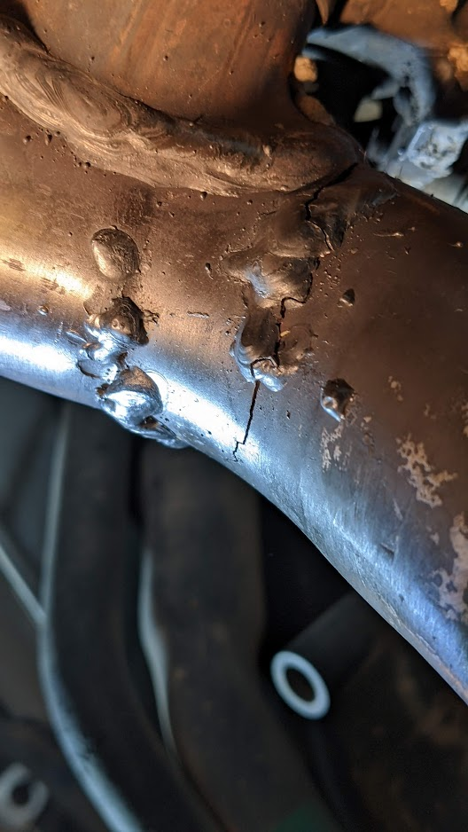

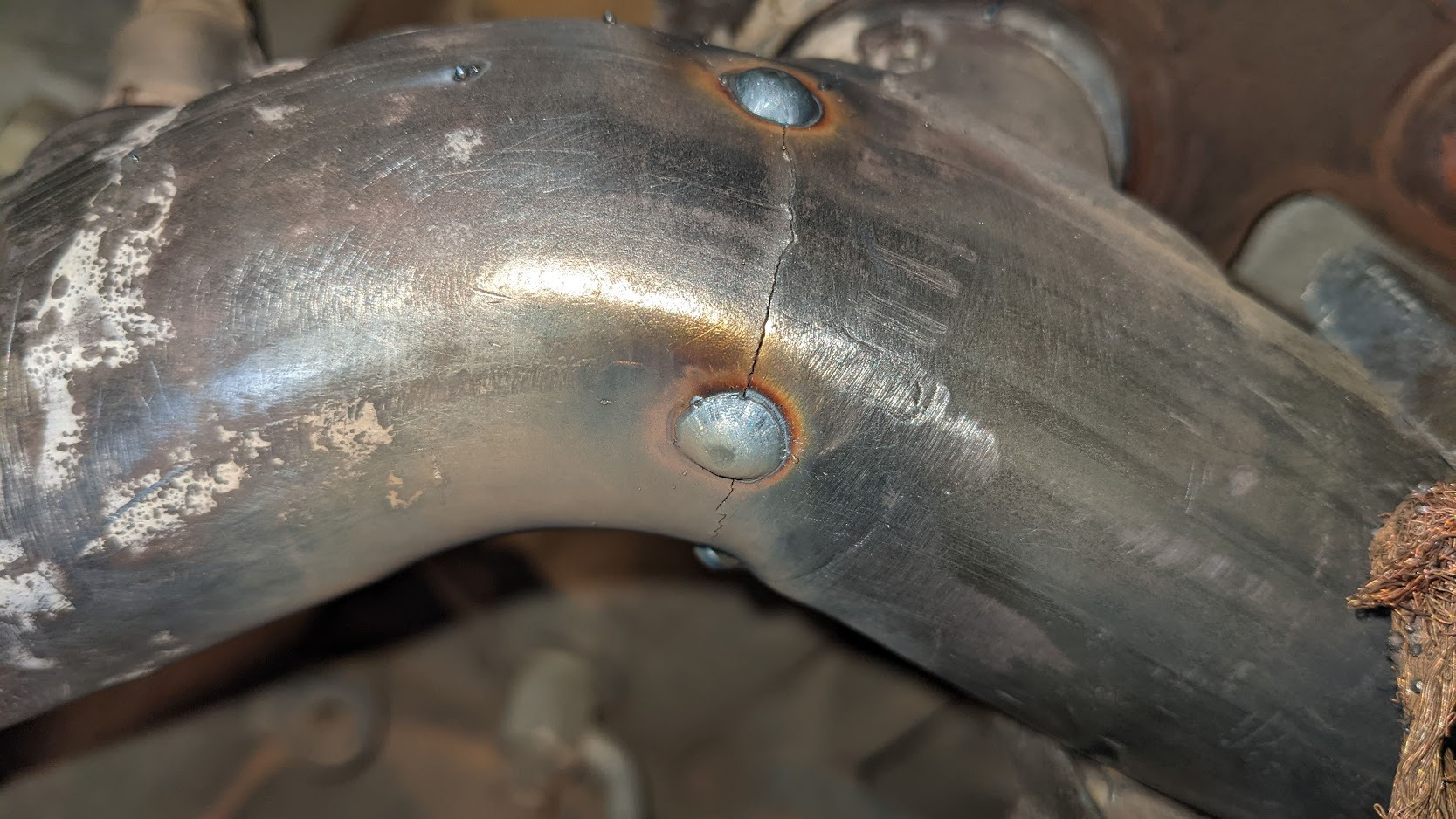

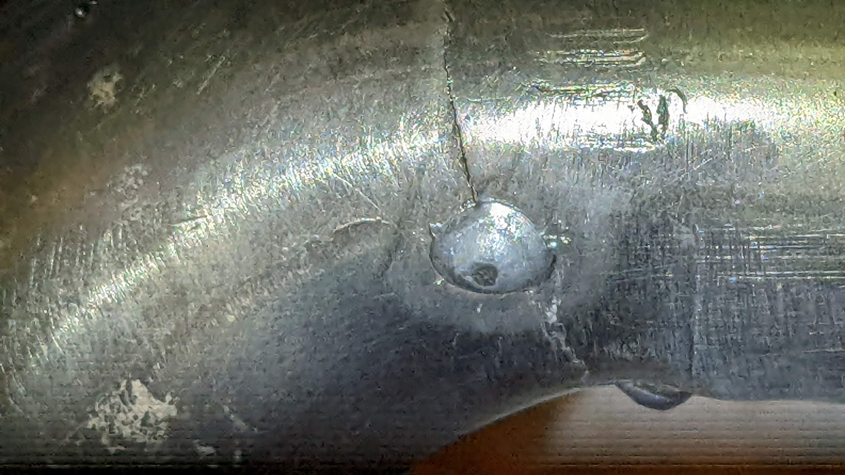

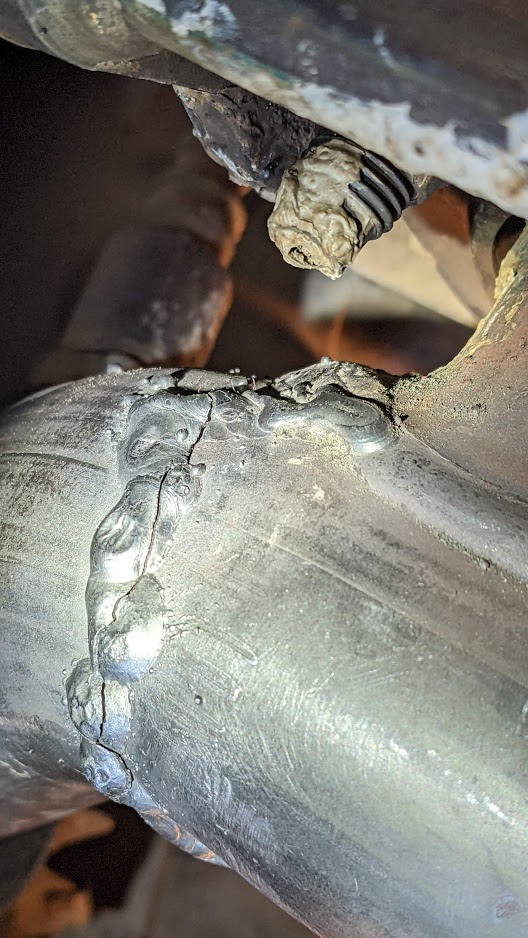

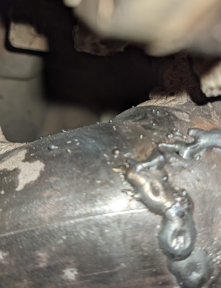

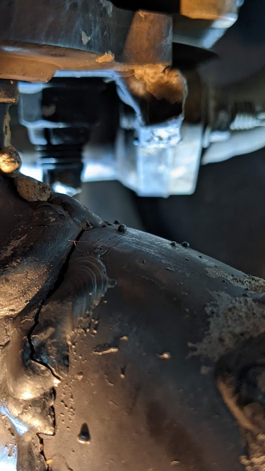

So... the 3K mile summer road trip (and > $1K in gas o_O:hillbilly:) surely helped foster the failure so here we go again. 🥸😐
initial light tacks welds lasted like six months... 🥳
But Crack/leak has returned.
looks to have re-initiated from the top (where I can't get the nozzle to drop a decent bead

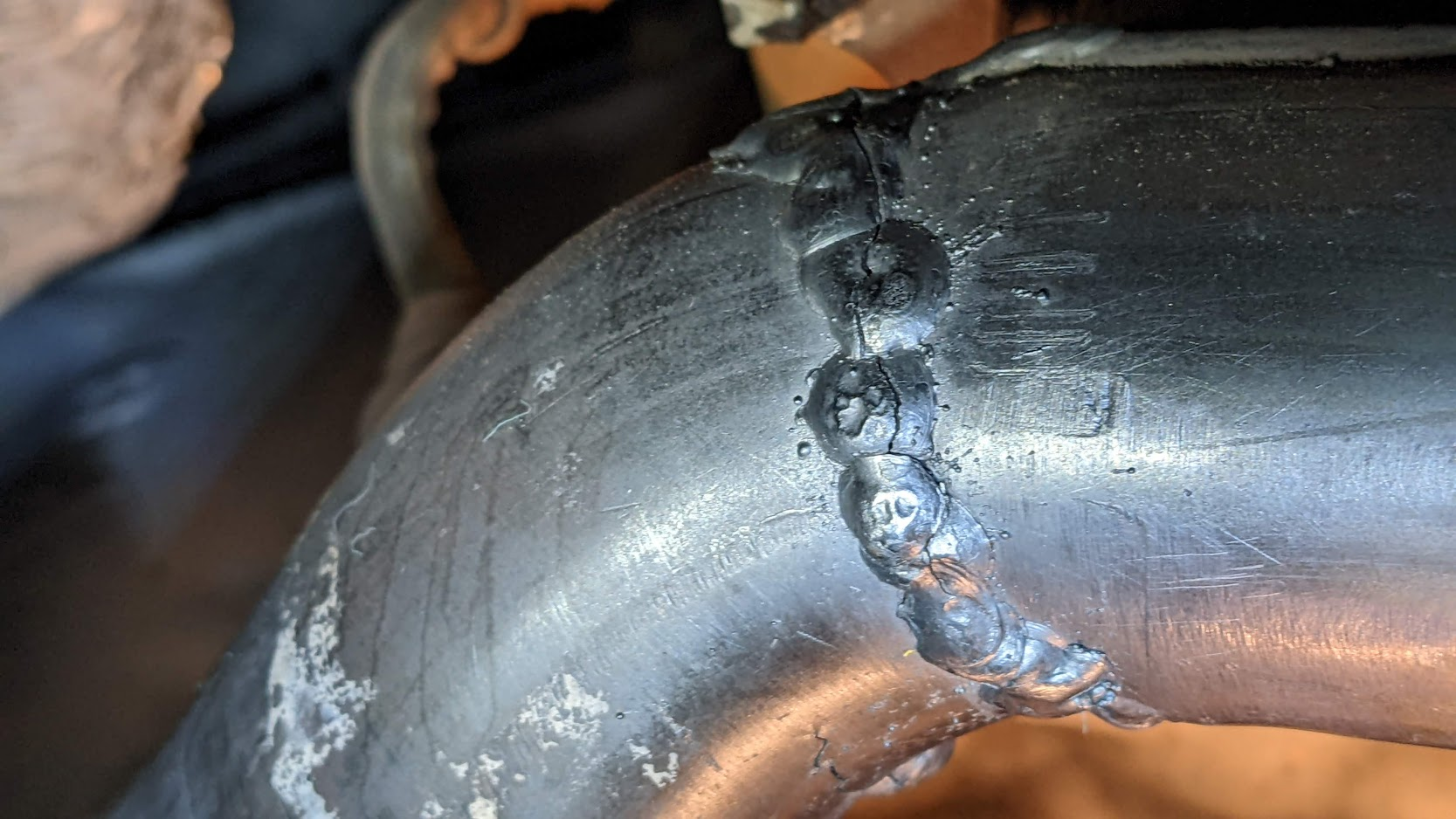

bottom looking up
so... 3.5 hour project begun @ 09PM left some coverage, but the weak spot is still the top.
Reaching up in left poor beads, but, the bigger the glob, the better the job! :flipoff2:
Here's hoping I can get the DTs on within 3-6 months. . . . 🤞
View attachment 3074378View attachment 3074379
bottom looking up
I thought I was looking at modern art!
I like this design! When I was doing mine I did a lot of searching around & I don't think I saw anything like this!
I still like my wider table (near full door width), but this tucks in nicely if a smaller table works for you!!!

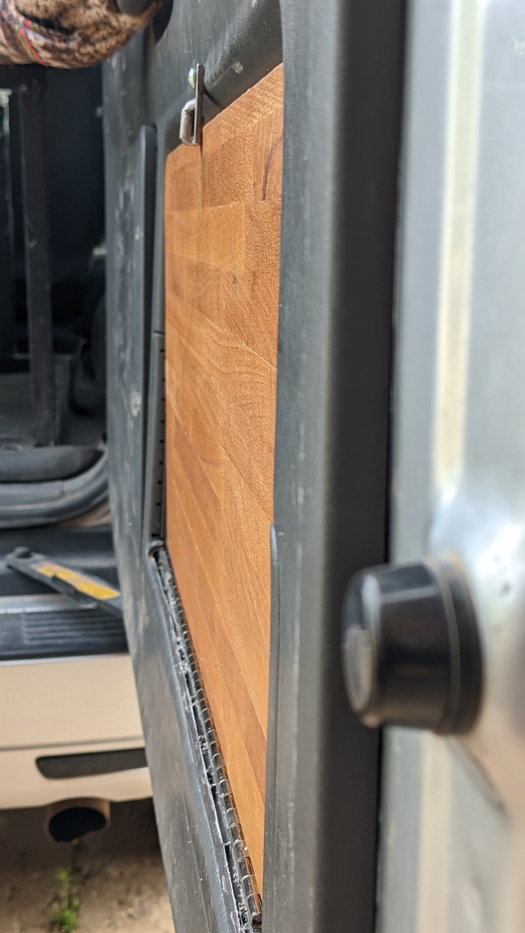

First and second deployment
I got direct props and overheard props with the PB&Js.
Refining the latch.... the ground washer doesn't provide enough support and the latch is a bit soft.
I pulled the cover off again and welded some scrapbits and tacked a nyloc nut onto that, and round off the top corners too...
Gave the knob a little rounding and a pad
rookie mistake and melted the plastic a little.... even tacks are a ton of heat :p
Not that there's ANY moisture where I live, but I coated it all with some paint because, whynot? ;)

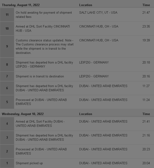

Parts ordered. . . . (ouch)
BqwpPqOIueFzelmnf1iVOapOEfdl3yWD7AatwwfZynCbW509n4Kj0BBPABf2V42CVU8C_oPAObanKS0NEKm06gb_sE-OS6ootoUGYy1vqV2NM7IcsbqwWyaIlIZu1CixmXijUa3yD33e-WdO4q9lYhI
+ $38 in duties
WHOA, shipping update! Ordered 8/6, in SLC 8/11!! o_O
As the bits are trickle in, anticipation begins to mount. . .
All bits in!

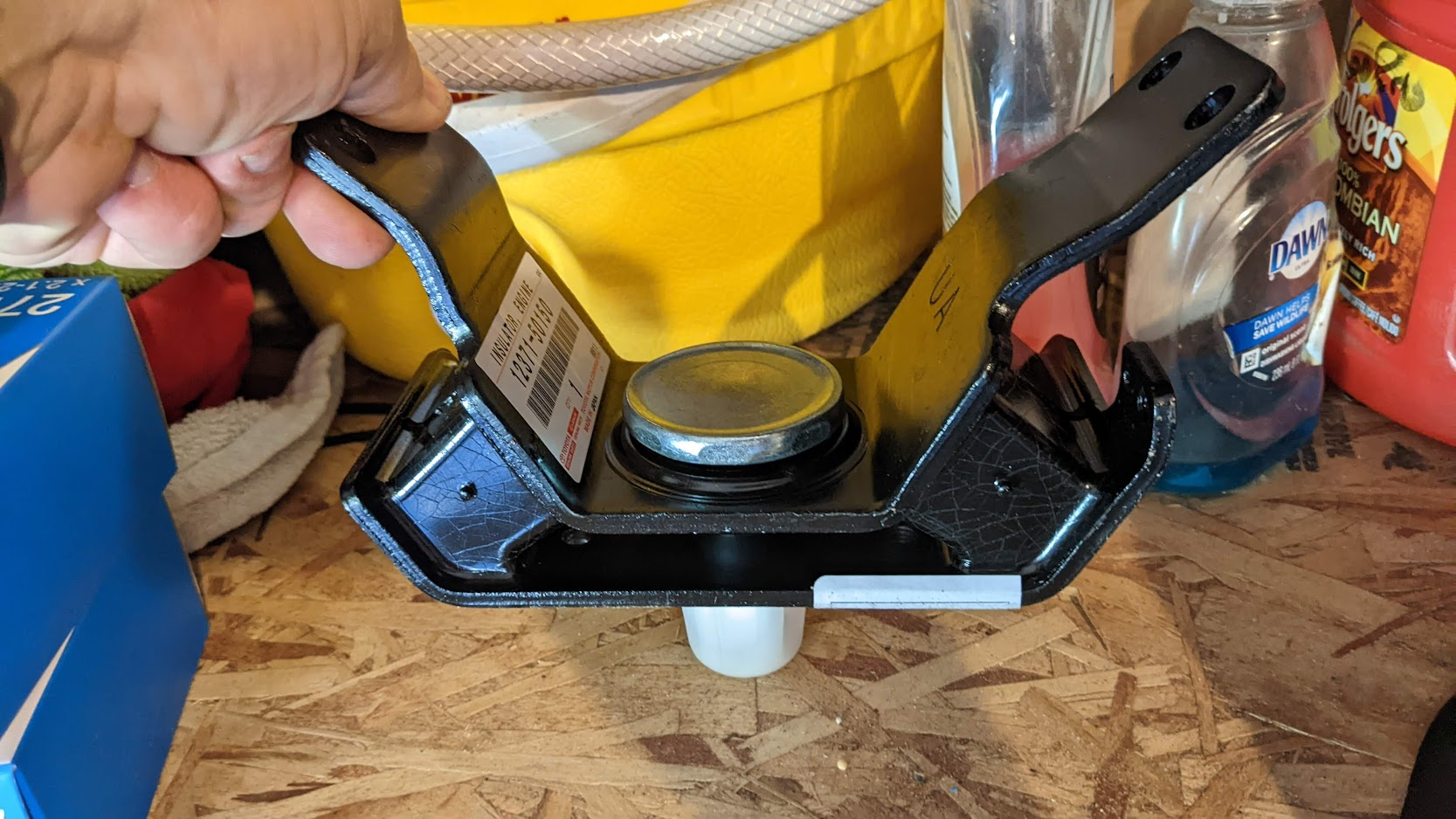

Just a suggestion, check your engine mount. the one with rubber.
I got cracked on my cat both side near manifold. welded twice, replace brand new both side and the passenger crack again (new).
Then I replace the two engine rubber mount. It works for past 4 months now.

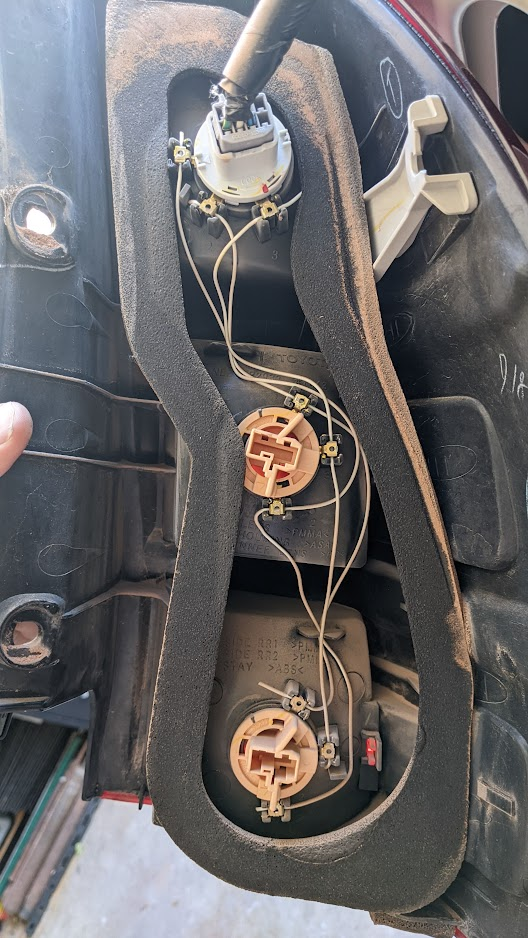

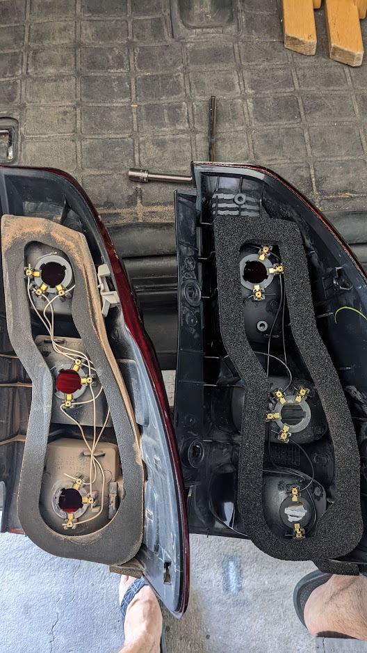

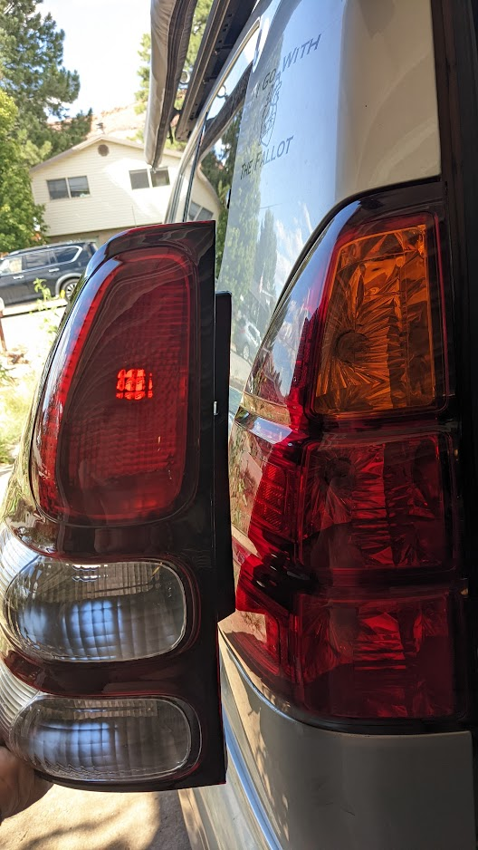

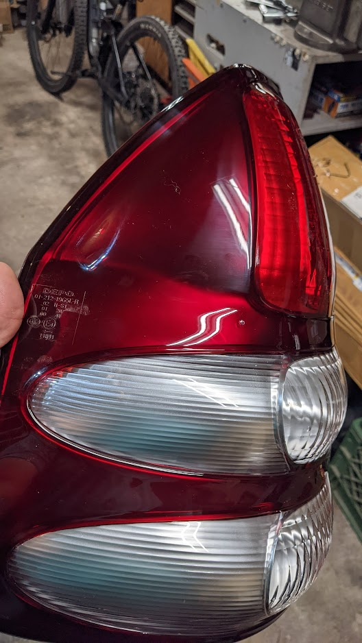

Uncharacteristically, I'm scoping before just diving in. :)
As such, I'll need a couple more bits. The GX sockets don't fit in the the Prado tails and these were new aftermarket Prado tails don't have the bulb inserts.... I know the locations have different functions (given layout and as evidenced by the different contact patterns on the housing) so I need the sockets and the master harness for the body-side harness mate
Moar researches provideth socket beta below.
and Prado 120 tail sockets from Aliexpress:
These are just sockets as the wiring per socket is on the taillight, not contacts on the socket. Some aftermarket wire harnesses wire each socket.
Re: moar researches…
That’s part of the fun figuring things out! Although, sometimes it takes way too much “moar researches…”
Im like binge researching and my GF just says take it to the mechanic!
I think I'm gunna need a couple more bits, The GX sockets don't fit in the the Prado tails and these were new aftermarket Prado tails don't have the bulb inserts.... I know they locations have different functions (also as evidenced by the different contact patterns on the housing) but now I need the sockets and the master harness for the top (park/brake) socket
K, back to moar researches...
View attachment 3086470View attachment 3086473
View attachment 3086474View attachment 3086475
be aware that wiring also different. your signal and brake light wire have to be swapped. At least in my case it was that way. (OEM prado from Japan)

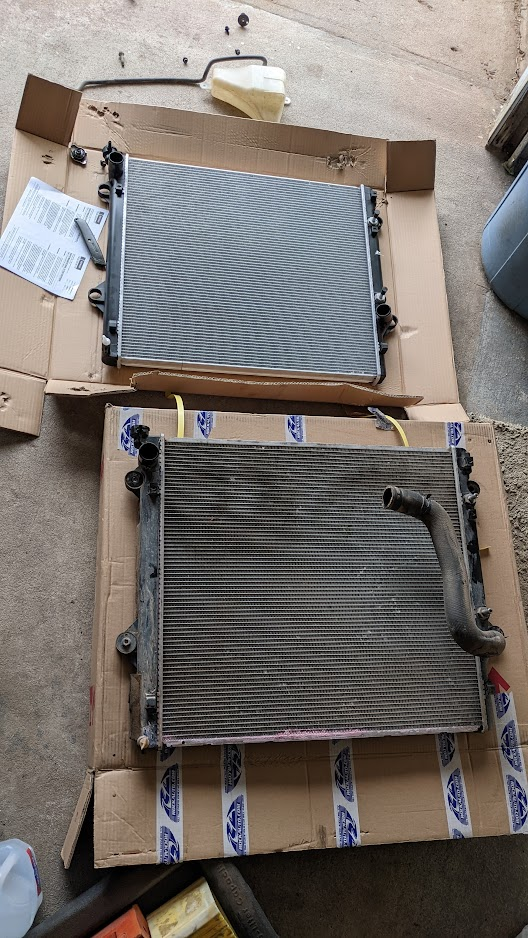

Circa 230K miles, my radiator cracked the sad.
After some Mud consult, consensus deemed Denso 221-3125 the OE replacement. Sure it's plastic side tanks and such but for the effectively $200ish replacement (formerly more like $150ish) that's the route I went. To be expected, there are some mixed opinions/experiences for sure and the all aluminum aftermarket certainly takes the cake for longevity, durability and no plastic, but entering @ $350+ (likely higher now with inflationary procing and post-COVID supply chain conundrums) I'm not the audience for rad of a rad, given my needs/purposes with this vehicle.
Rock Auto $206
stock RA (reported lighter ga Al top tray

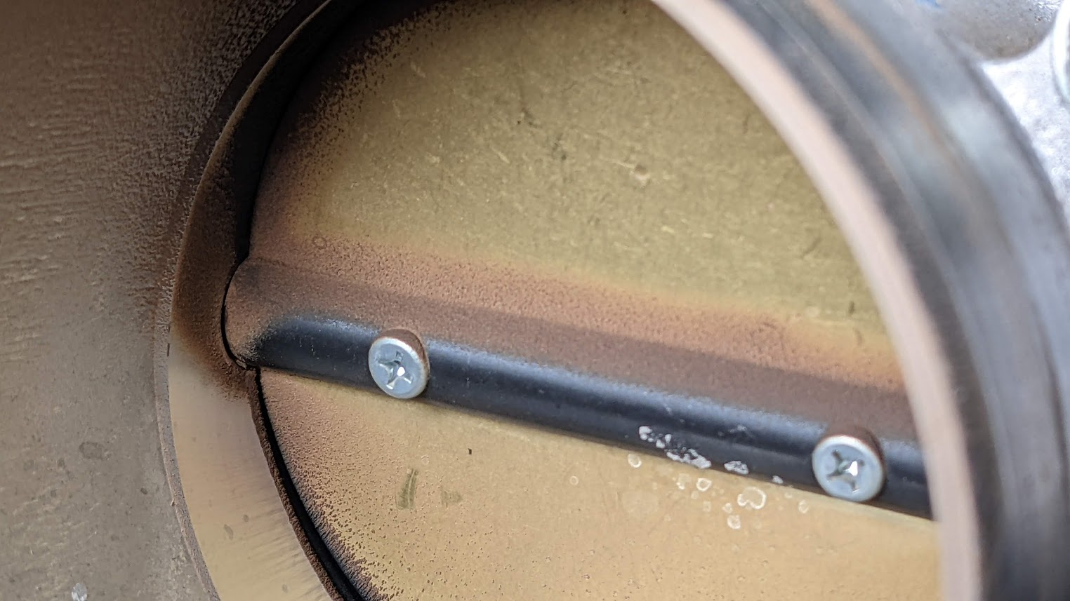

While in for the radiator, I noticed a lil grime buildup in the TB intake...
ugh, dirty-filthy, dusty desert air! GAH, you'd think there were a K&N in there (but not in this car... I've past that experience)
Got the TB cleaner and squirted it, Q-tipped and rag-wiped the flapper and port a bit>... Not perfect but definitely better (no after pix)!

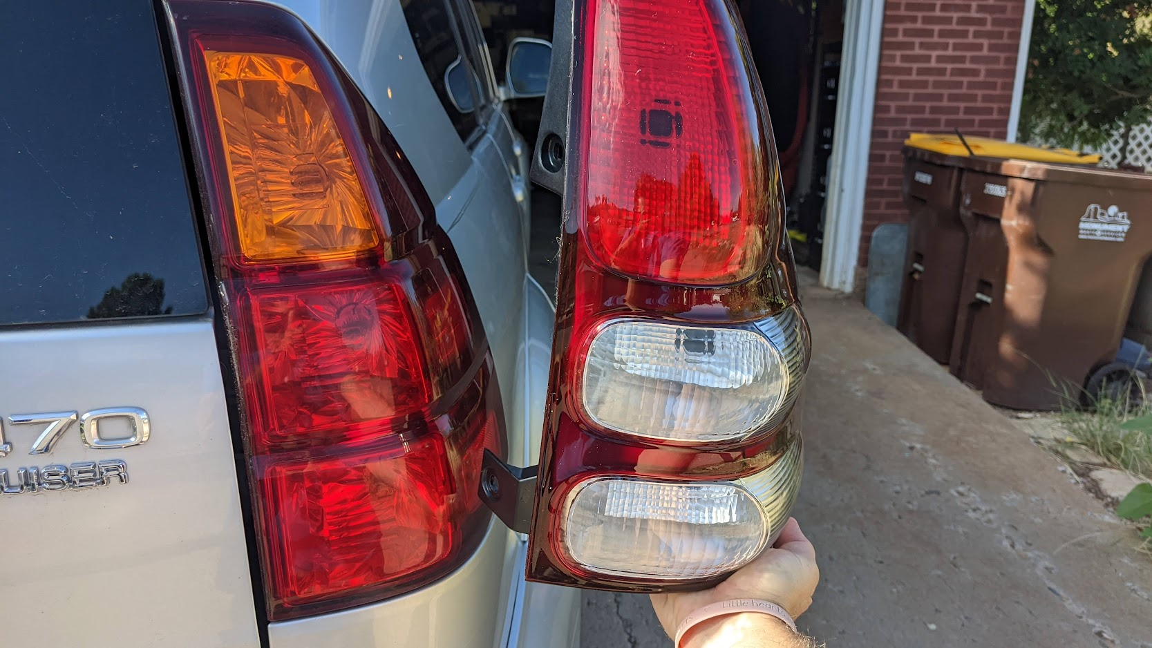

RE: Prado 120 tails...
@DeathMetalTony (or anyone??) How to make A look like B?!!
A:
B:
Did you bake them open and spray them? It looks like the outer plastic is red. Do they come apart like headlights? Are those grey/silver ones a special Euro option...unobtanium?
