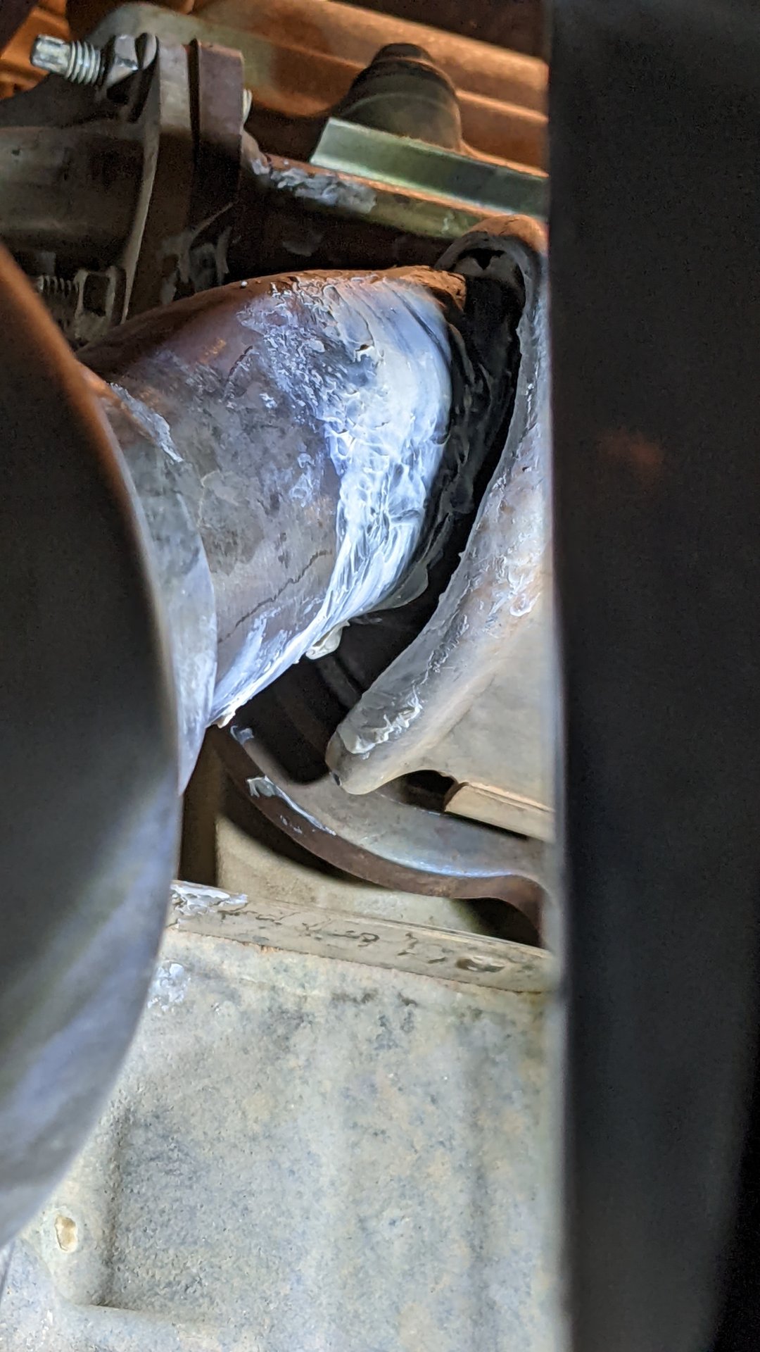

Temporary fix until the DT shorties.arrive (maybe by spring break 🤷‍♂️)

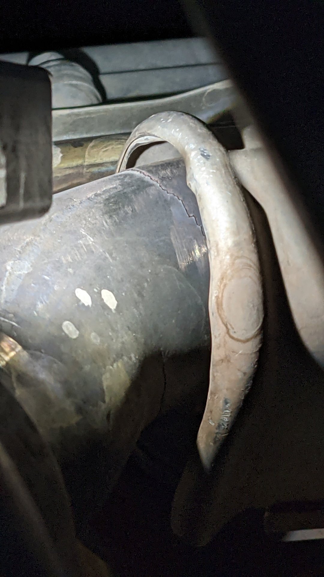

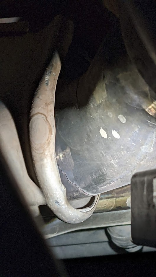

Recall here for round two of Mani crack adventure...
2 layers of exhaust seal goop applied a day apart, second layer 'pretty' thick. Maybe used 1/3 of the tube..?
Challenging access, but I'm trying something 🤷
From engine bay.looking down on aft Mani bend towards 1st cat.

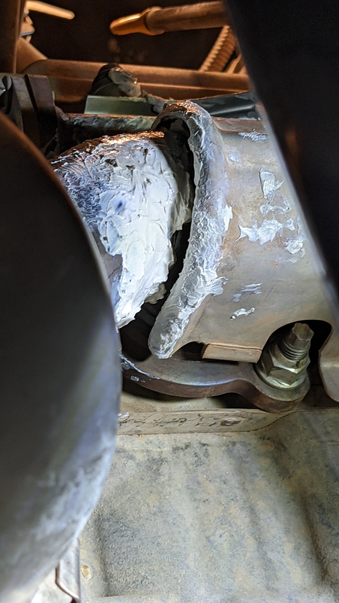

I have some Stainless steel zip ties if it will help. That exhaust putty lasts about as long as it takes to apply it. Also, my friend has a 110 gas welder. The fee is usually a 12 pack and having to drink it.
Only 12?
Effing eff!
Yeah. It lasted for a trip to the mts, I think I could hear a slight tick on the ride back into town.

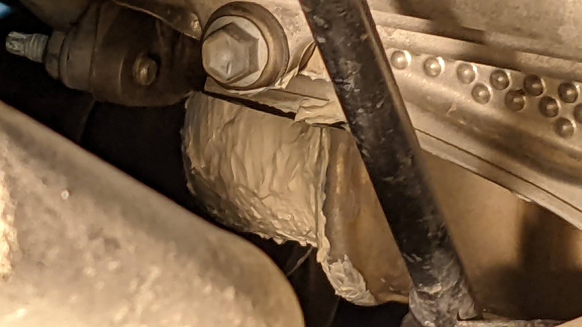

The putty didn't last (as @MoaByte predicted), in fact it flaked off readily tonight as I brushed it to inspect. I won't have time to get the JB extreme temp stuff and apply it, PLUS tomorrow.. er.. today's x-mas so everyone (ergo napa and CQ here) will be closed.
DAMN, this is a show-stopper??
Looking at my photos above, the current crack looks as bad as the original, nearly entirely around the whole tube...
And you can see the exhaust leak staining on the block behind the O2 sensor
Ugh. So I guess we're dusting off the impreza for this trip. This ride is going to suck, but the MPG! I don't have mt. snowflake tires on that car so I'll have to get chains somewhere, all the roads and passes up there are in winter conditions with chains/traction tires required.
I would go for it. It’s just a annoyance if anything. It’s far enough from the head it’s not going to burn a valve or anything.

I was thinking in terms of what’s the worst it can happen if it continues to crack.
My 80-Series cats were once attempted to be stolen 10 years ago and they left them hanging due to a couple of pesky bolts. The 80 sounded like a motorcycle but they had completely disconnected one of the cats. Also loss of power from a disconnected cat.
I got under the 80 at the metro train parking lot where the attempted theft happened and pushed the cats back in place and drove home. The cats were aligned with the pipe but had missing bolts. The motorcycle sound and power loss mostly disappeared just by aligning The cat back in place.
The next day I went to Home Depot and bought the missing bolts to tighten them back to normal.
So, based on my experience on the 80 with loose cats, I think @aztoytec is right. Just annoying noises since I doubt your pipe will detach completely.
3M makes a exhaust tape repair that might quiet it down some too.

Was going to go for it, till I woke up @ 1.30 and looked at things.... Looked and my photos closer and noticed the crack is nearly full circumference. Worried about heat cycling and highway speed (2k rpm or whatever) for like 10 hours today. Heat, lost back pressure, venting CO into the cabin (wife's mentioned smelling exhaust in the cabin), what if tube fully severed, engine codes from cats, etc. Could that foster engine damage? Dunno.
