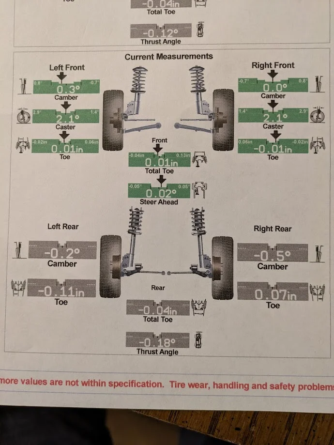

I did a shakeout run and forgot to retorque everything back down.

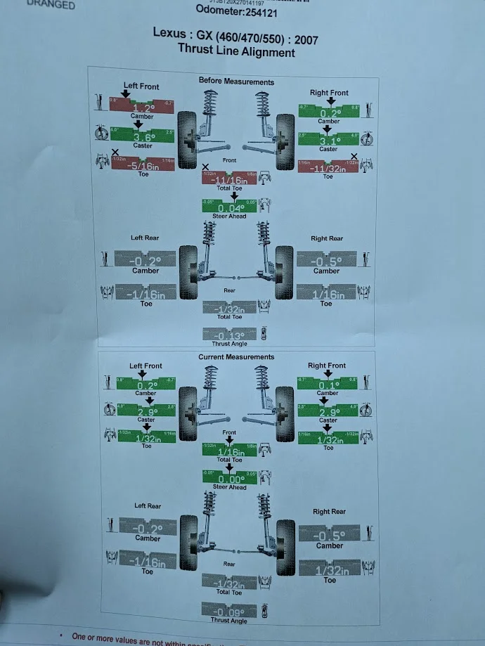

Off to alignment shop this morning, I'll pick it up tomorrow!!

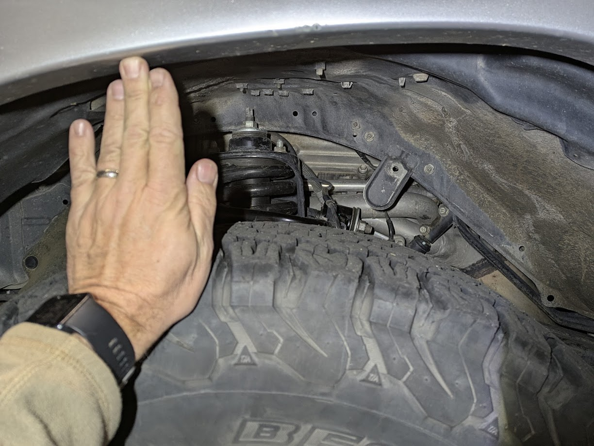

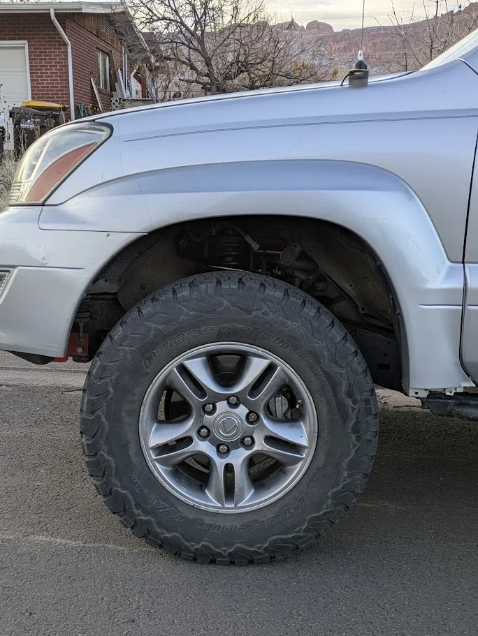

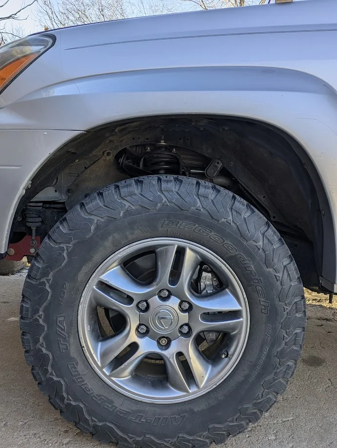

I finished it up yesterday, put the Tundy coils in the 5100's lowest spring perch to assess. I buttoned it up w/o the FSB dropped it on the ground to settle the springs. It looked like a little over 1" lift over stock, so a little lower than the levellers I had, BUT with real travel and 5100's longer travel vs repositioned stock travel.
put it back on the stands, pulled out the struts and bumped up to the second circlip setting (circa 0.86" lift), slapped it back together and wrestled with the KDSS FSB and new bushes after 11PM, but torqued everything on the ground with new cotters after the new cotters from round one ;P
Stance is good, drives (the 12 block town tour @ 1AM :P ) well, and i didn't hear aberrant noises.

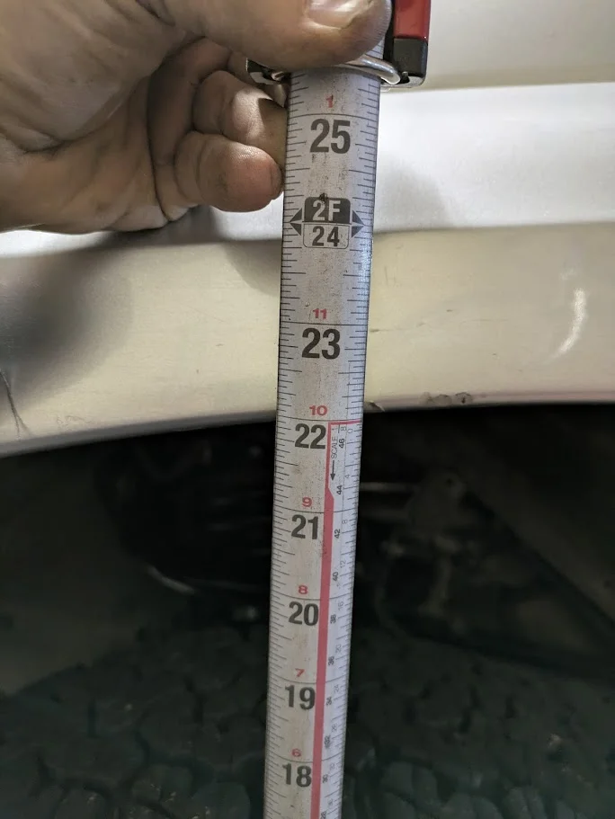

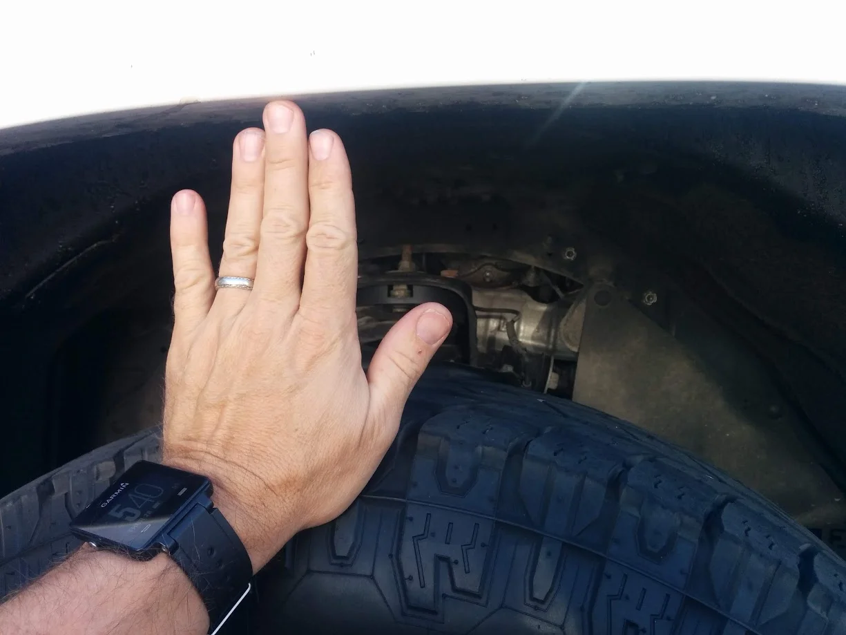

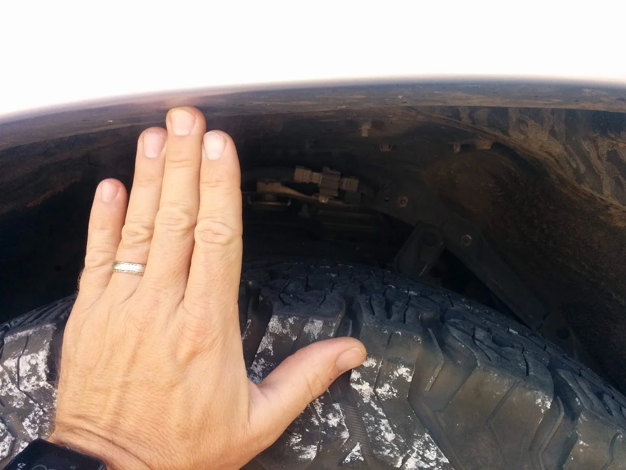

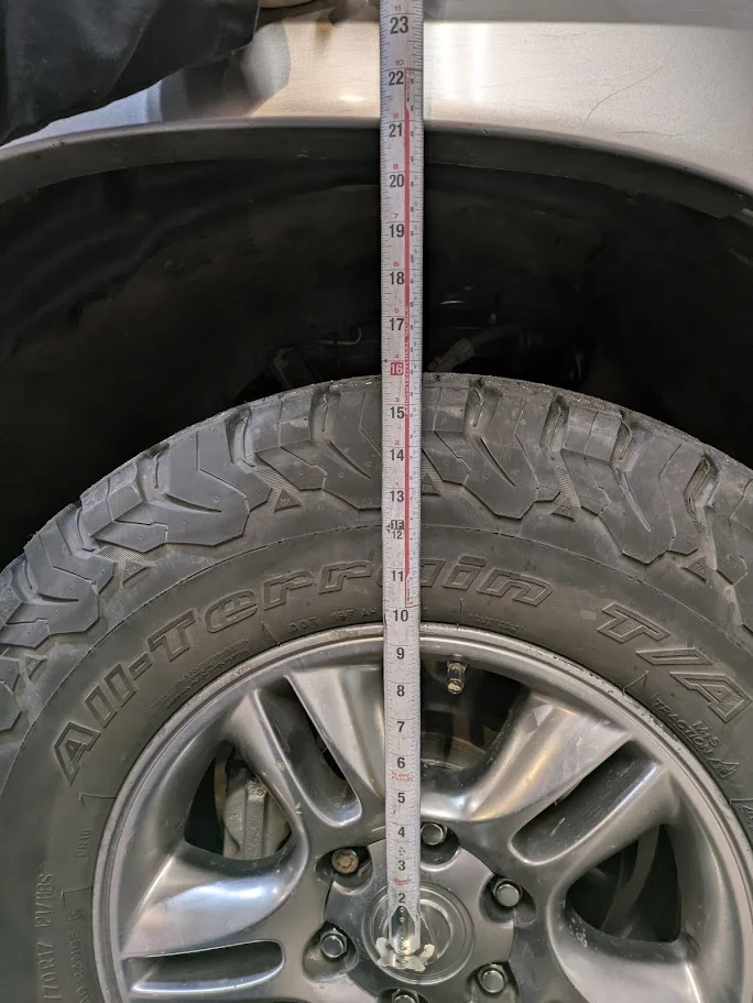

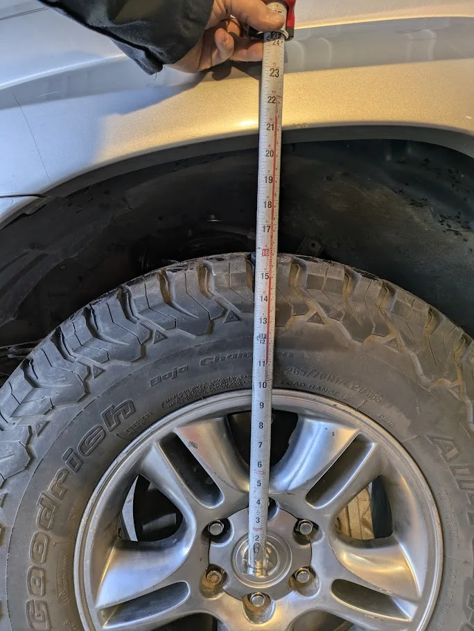

Seems to spec about 21.5(pass) -22 (dr) hub to fender which is about where it was on the stock struts and 0/75" spacer (1.5" lift). BUT I think it's actually a little higher.
That's a better wheel gap and coils showing above the UCA (kinda My quick glance at a suspension upgrade "across the room assessment" ;)

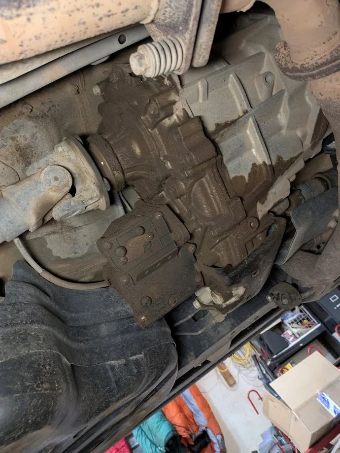

I bet an ounce of two of AT-205 would dry that right up :)
You would add an ounce of AT-205 into the transfer case? Have you had experience doing that and did it work? I've used AT-205 before or rubber boots bushings before but stopped because it was a huge mess and I wasn't sure it actually helped all that much.
I've added it to my 2UZ to slow down the rear main seal leak, and it does work. If the leak is occurring from from a seal, the AT-205 should be able to improve the performance and slow down the leak, at a much lower level of effort than pulling/replacing the seals.
My TC has a bit of a seep and I'll add in the AT-205 next time I change the fluid.

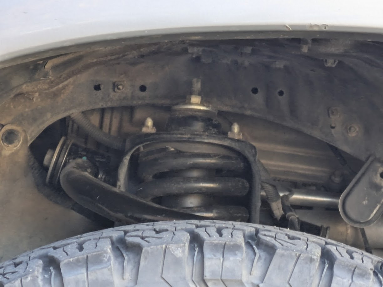

Update on the front end and modified Bilstein 5100 with Tundra coils (specs listed above):

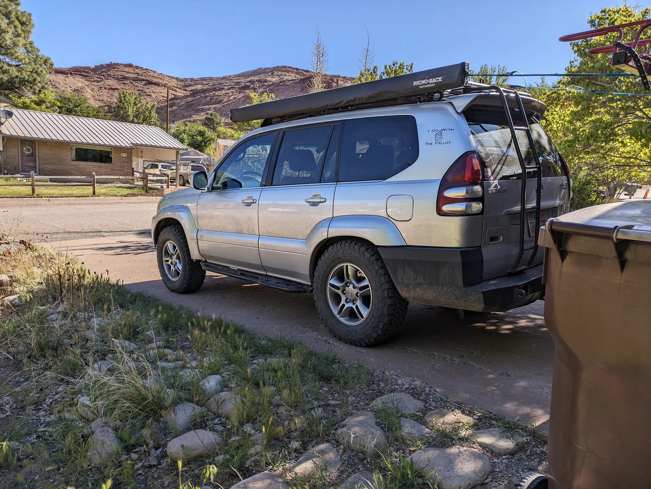

I think overall as of this writing the front sits about 2" over stock and the rear 1" higher by using airbag sensor spacer, this will probably tax the stock-travel AVS shocks if I use it to full articulation on trail, so I have ideas for a real 1" rear lift with the newly replaced Arnott air springs and probably Bilstein 5160s, b/c I like the idea of their added travel and a remote reservoir over the 5100 rear shock. but $300ish each vs $100ish each.
My evolution was:
Stock, then stock on 265x70 17" BFG, AT/KO2
Then 0/75" strut top spacer (levelling spacer). I daily drove and wheeled this configuration for 6.5 years.

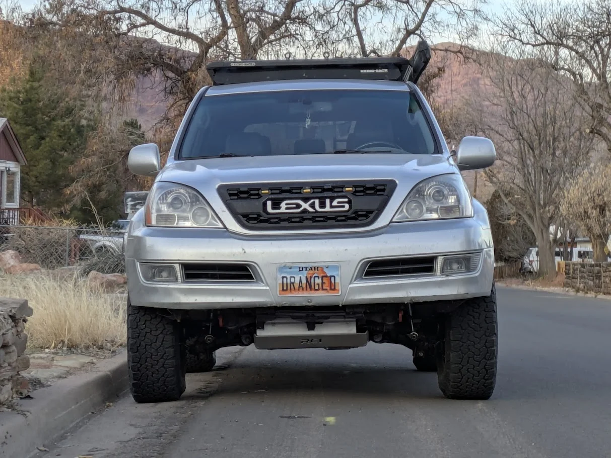

Then with the recent front end refresh (UCAs, LCAs, Pass CV, outer tie rod ends, hubs and bearings, FSB bushes), and Bilstein 5100s on 2006 Tundra SR5 4x4 crew cab front coils, I think I'm around 2" over stock.
Initially, with coils in the 5100s at lowest spring perch setting, I think it was about 1.2" over stock, so about 0.25" lower than the strut top spacer lift.
spacer only (w/ bike rack (thanks auto-levelling air springs!)
So I pulled the 5100 struts and moved the lower spring perch to the second setting, 0.86" lift, with the Tundra coil, and I think this configuration yields about 2" front lift.
I mentioned elsewhere, that whenever I see a lifted GX or 4R, I always look under the fender and whenever I see coils above the UCA, that gives me a clue what kind of suspension lift it has...
So this makes me happy, with 5100s and 'stock Toyota' coils... 2" functional increased travel lift on a budget!

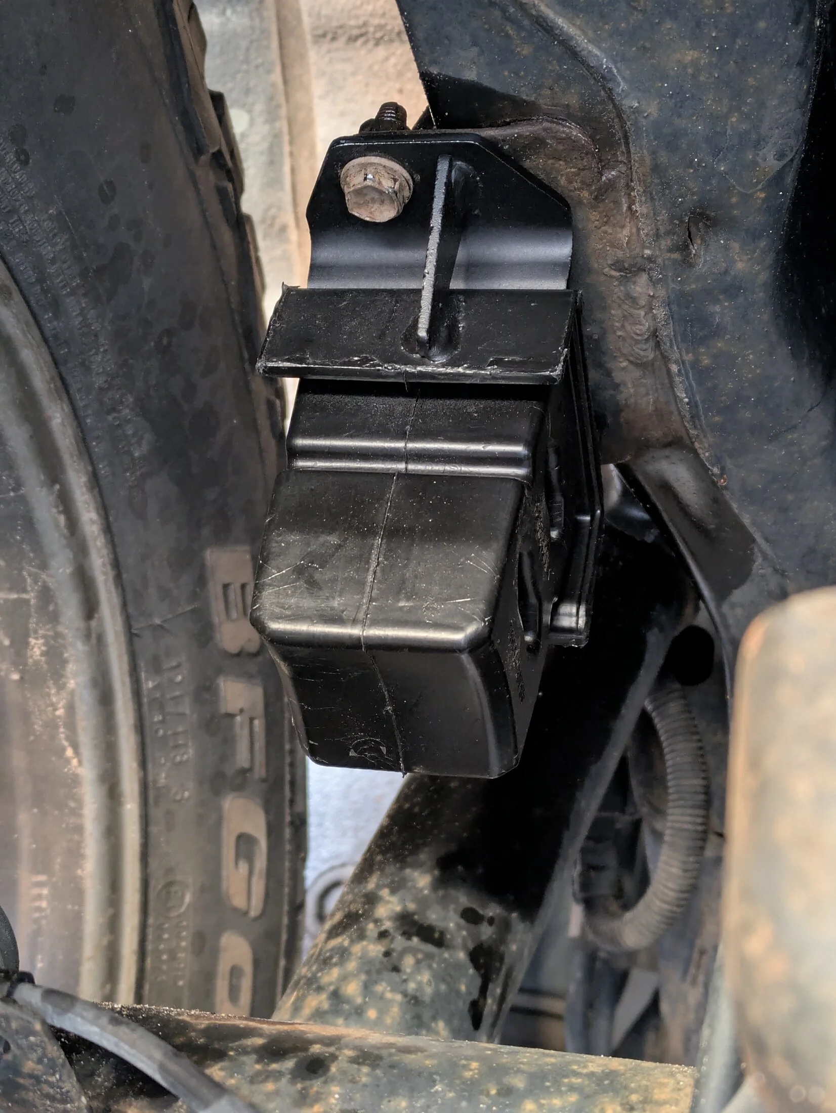

FINALLY got some replacement bump stops!
Possible Timbren bump stop hookup may not be happening. 😭 🤷‍♂️
But Amazon $30, with stock PNs is a good compromise to the packed out blown stocker!
Driving, loaded, on blown airbags will do that to bump stops. 🤷‍♀️

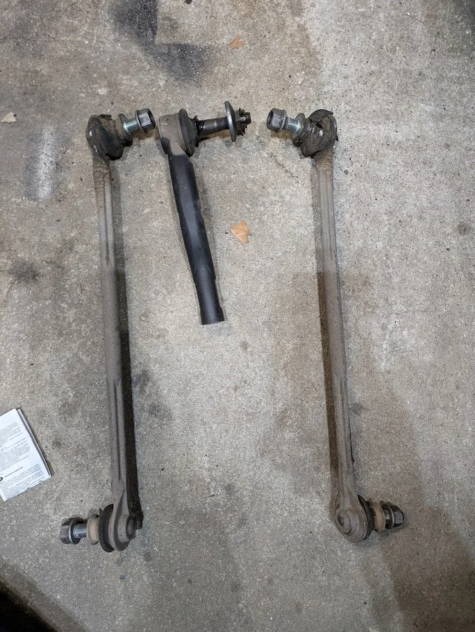

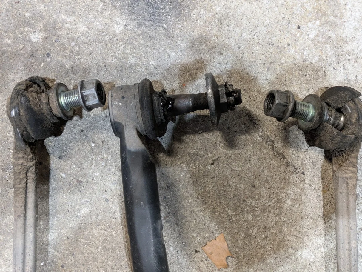

AND first repair!
FSB links and an outer tie rod.
There was a yucky clunk when purchased (PO provided full set of tie rods w/ car!), clunk's gone now! :cool:
Aligned!

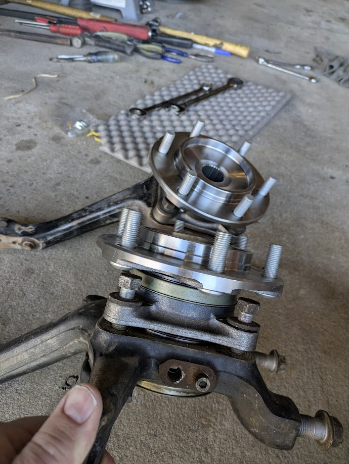

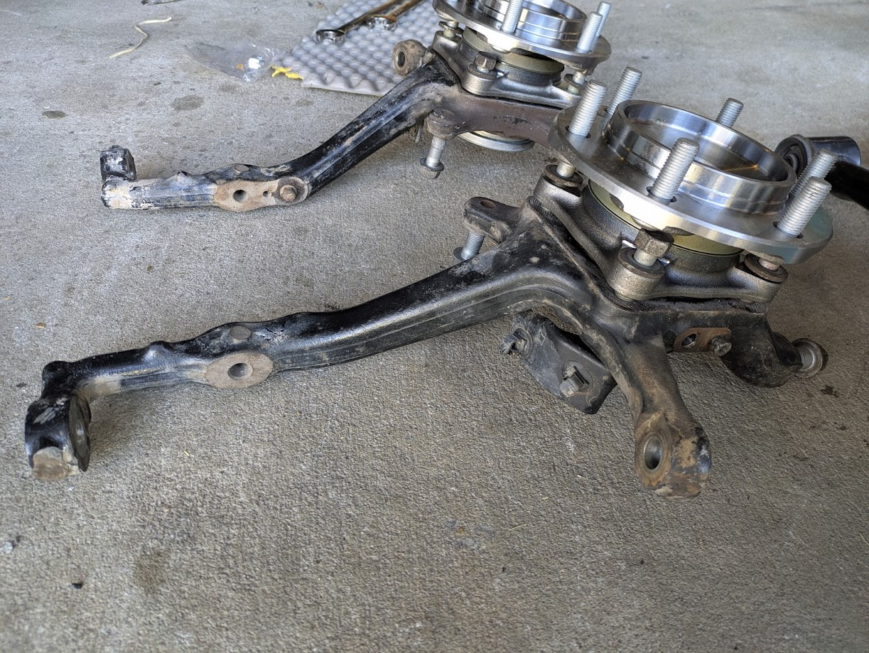

Alright, I got the hubs pressed into the Toyota bearings

BIG shout out to Rich a new mobile mechanic in Moab!!! When in Moab, hit him up for repairs and i guess even some trail recovery work.

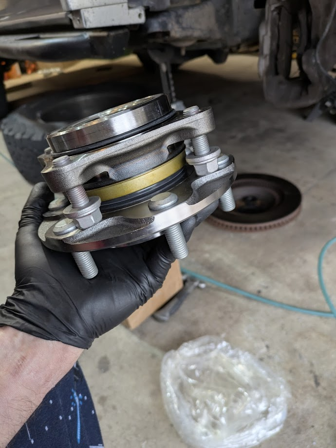

But!

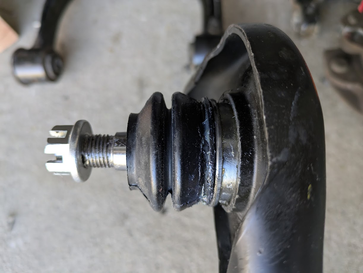

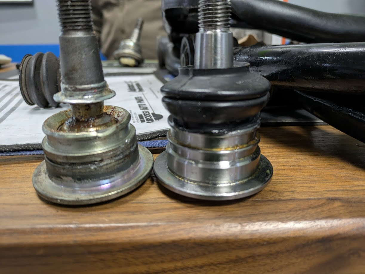

While employing the 'ballistics-shield' creeper while hanging off the 20 ton shop press handle to seat those 555s into the UCA... NO-GO!!!
The 555 upper ball joints did NOT fit into the 2019 Taco UCAs....
So there's something more than just the shaft taper and length difference across those ball joints.
(Don't ask why we didn't caliper the 555 vs the taco UCA opening first 🤦)
*EDIT*
Mic'd, the diameter of the taco ball joint is 1mm less than the 555 spec'd ball joint for the GX 470...
So there's yer answer! 😫🤦

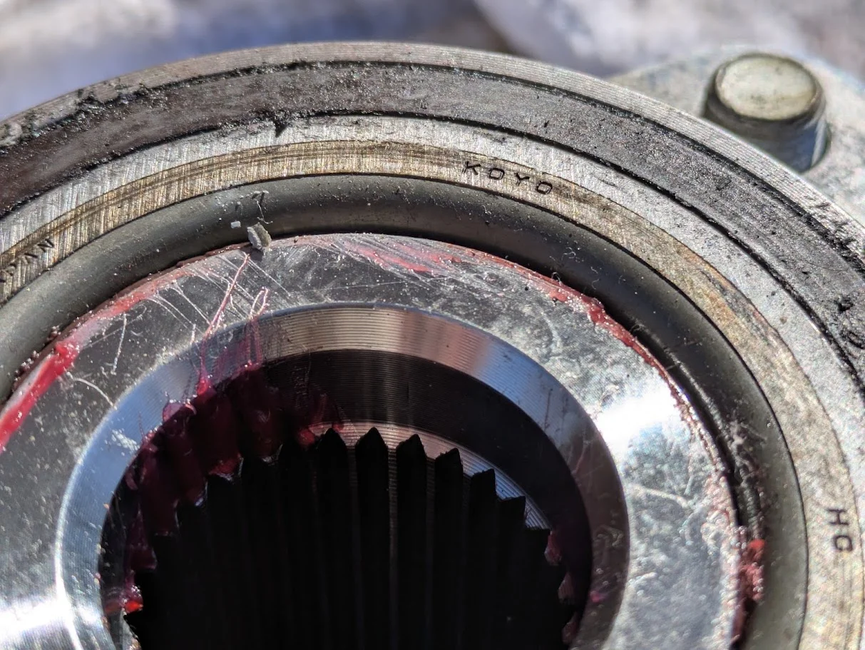

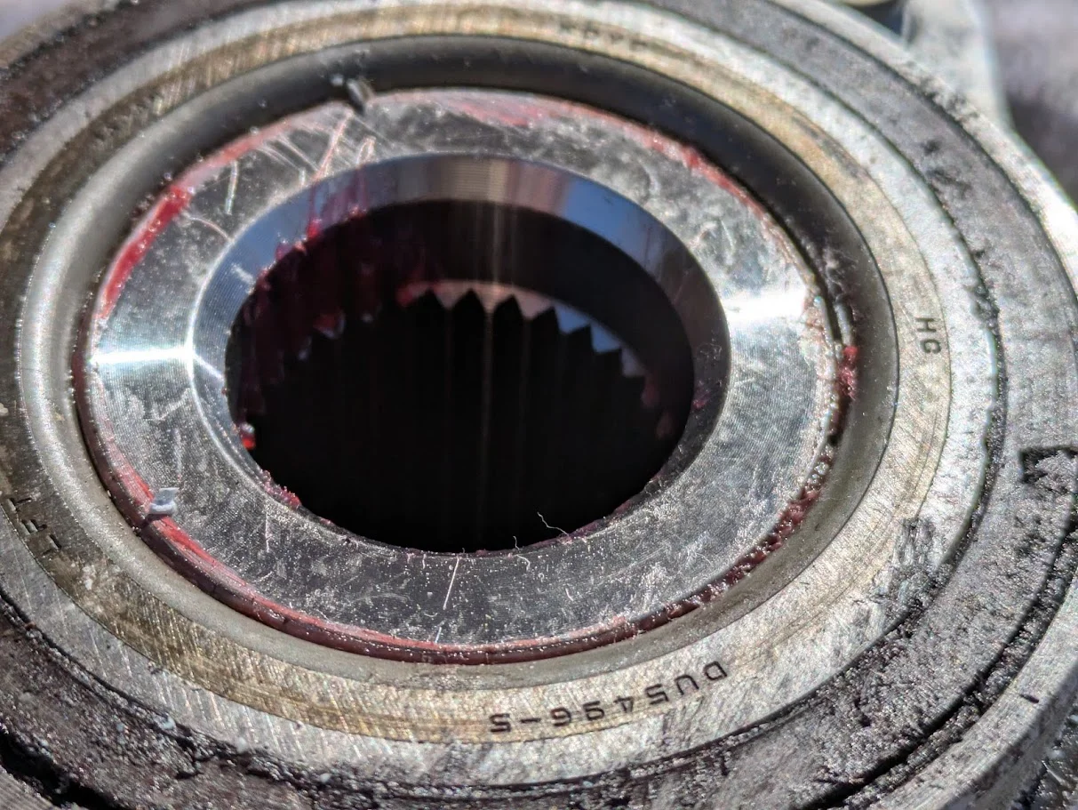

Notes to self RE: wheel bearings... (b/c i just learned my Rt one is wobbly and toast... :confused: ... described as fall out bad)
3 months later I need to reference yota and quality bearings.
Again, The B!+9# of it I installed a Lexus wheel bearing from Mylparts.com, KOYO, in November, 2024.
😳 watch---> YIPES, that's scary!! <---watch 😳
We drove to death valley and back on that!

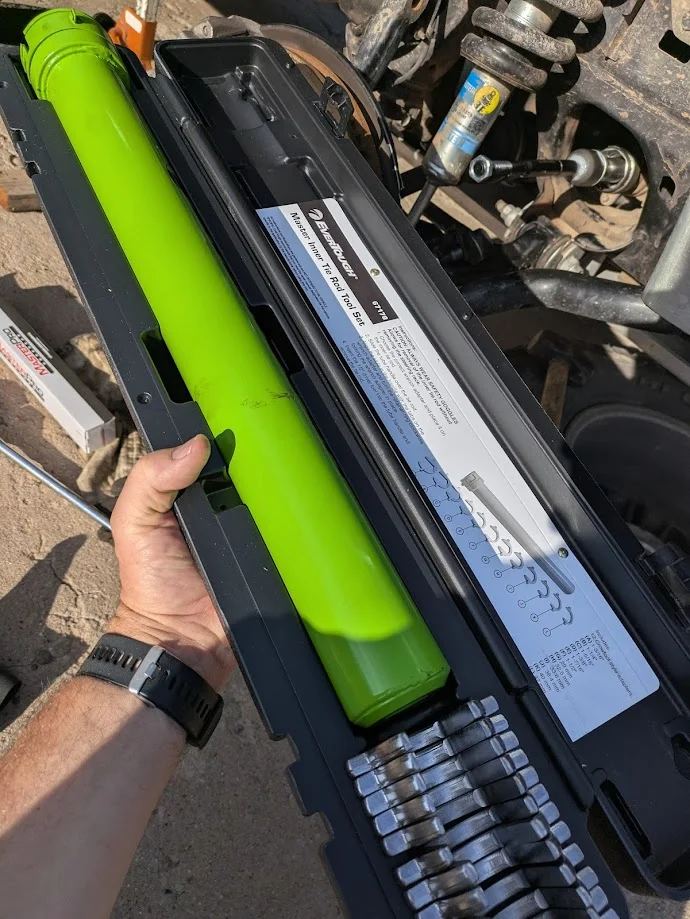

Inner tie rod (woulda-shoulda done it with the rest, while you're in there...) 😖
but got to break in and scratch a brand new tool, thanks O'Reiley!
