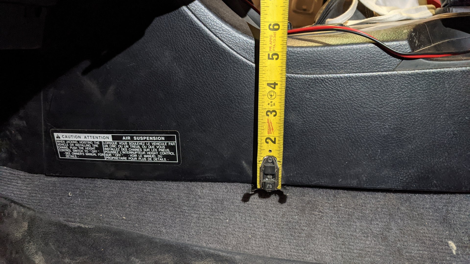

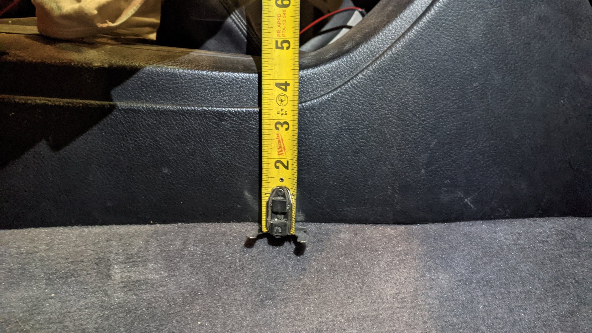

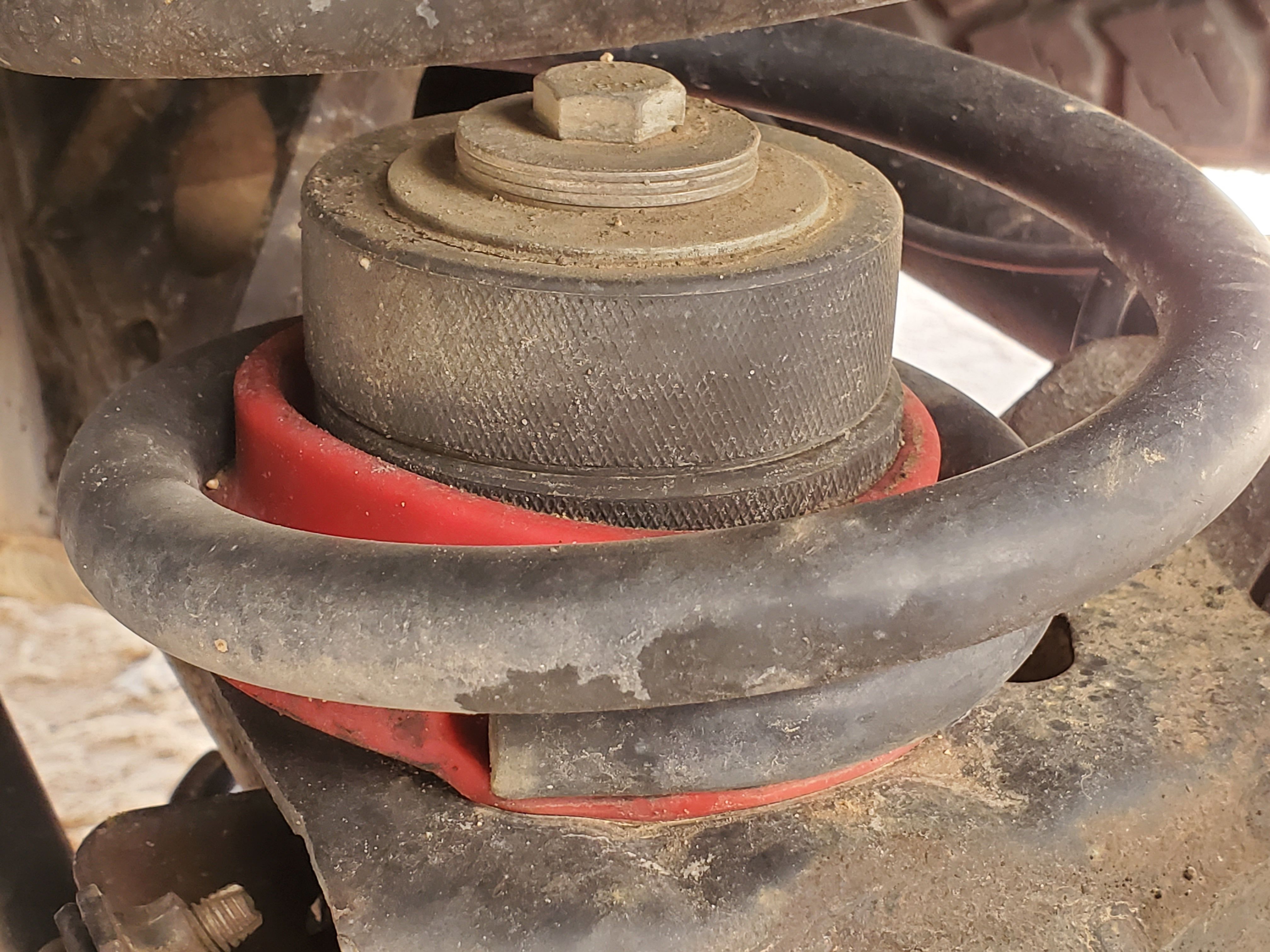

1/4" airbag spacer rear
And 0.75" strut top front
(still retains airbag hi)
This'll probably facilitate more rapid airbag failure to my anomalously reliable bags. 🤣🤣🤙
Lo
Normal
Hi
A few :

Yeah, that's an interesting build. I think I ran across that video last week or two weeks ago from another post. The BP 51s are pretty high dollar setup to curiously stay with airbags. But he's not wrong with respect to flexibility of airbag suspension in the rear which is why I'm having a hard time getting away from it. Auto levelling is huge especially when you run as a daily driver but also do 1,000 lb loads for multi-day trips WHILE retaining ability to lift another 1.6" when wheeling.
The airbag spacer setup just seems like a relocate on top of the suspension not too unlike the spacer lift on top of a strut. It's interesting to maintain the airbag functionality with a 2 inch lift, thus the ome shocks in back too....
*EDIT* timbrens: yeah, those are cool! A buddy in town got them for his xterra, and lives them. Might be good insurance Rae: airbag failure.... 🤔👌
I do have two pairs of other people's take off airbags as spares when mine fail So I think this Band-Aid will kick my can down the road months or years longer....
I do seem to chew up kdss bushings however. Minor toast and need to be changed again and I think would be the second pair that I've installed in read in my four years of ownership. 🤷
I dunno... I guess I use all the articulations. 😂

I liked my air suspension. It was very handy. I started piecing my suspension kit together a while back and just told myself once I have all the pieces I'd install it. doing it slow and finding deals I was able to do it much cheaper than anyone else I know. I miss the springs sometimes...sometimes.
I replaced front ball joints and bushings on the LCA, JBA Upper control arms, Eibach front springs and shocks and Fox rear shocks with OME springs. My rear spring conversion kit was DIY hockey puck. Total costs....??? maybe $500. Rear, remote resi, fox shocks were given to me and had to be rebuilt, add $300..?
