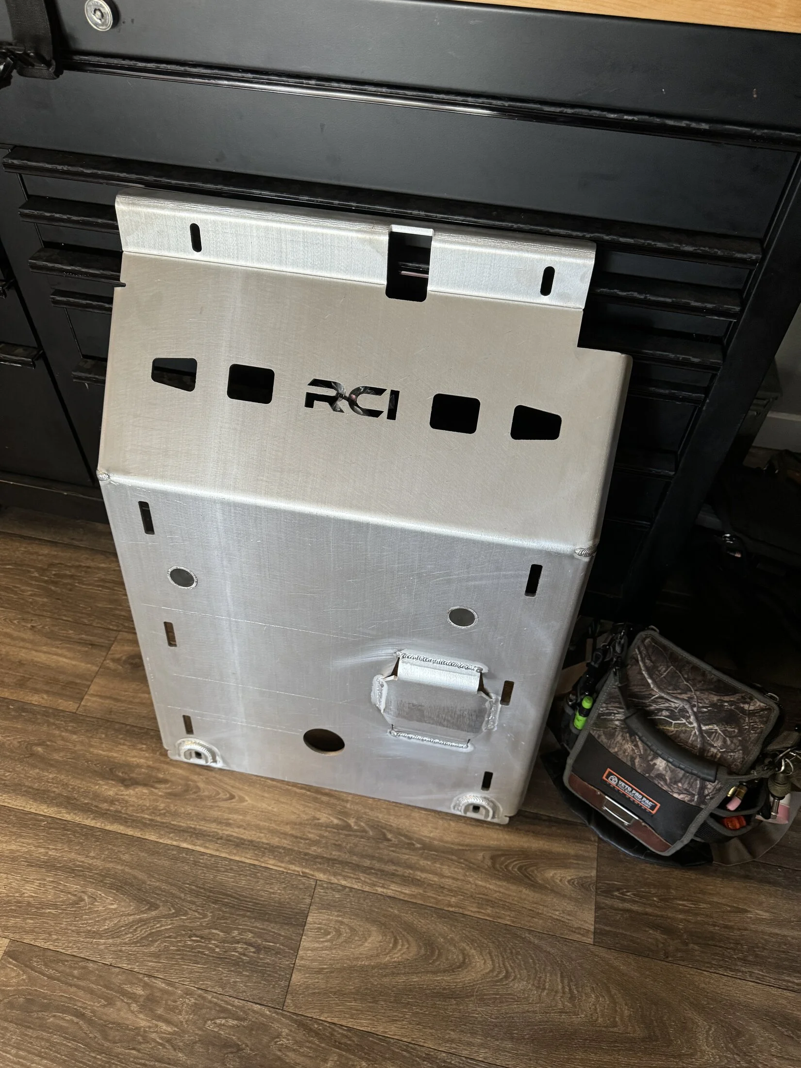

The timing belt job took a couple days but gave me the opportunity to replace the coolant, water pump, all the idler pulleys, belt tensioner and the serpentine belt. I went ahead and changed there oil while I was at it. I noticed the factory skid plate was fairly crusty while removing it and decided to replace it with an aftermarket aluminum plate. RCI happened to be running a great deal at the time and I opted to pick up their plate. Couldn't have been happier with that choice!

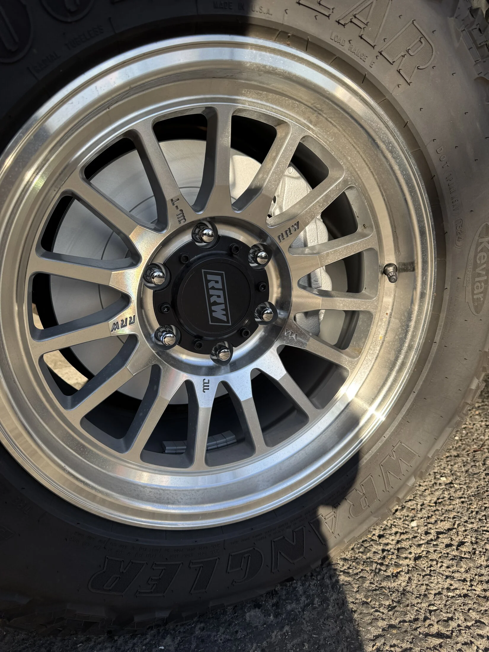

Next on the maintenance list was tires and brake pads/rotors. The brakes were in good shape but I prefer a ceramic pad and wanted to go with a geomet coated rotor to compliment the new wheels I chose to go with the new tires. I went with some machined RRW RR7-S wheels in 17x8.5+0. Wrapped them in 265/70/17 Goodyear Duratrac RTs and installed some powerstop geometry coated rotors and ceramic pads. I opted to paint the calipers while everything was apart and I think the silver looks nice with the white paint and machined wheels.

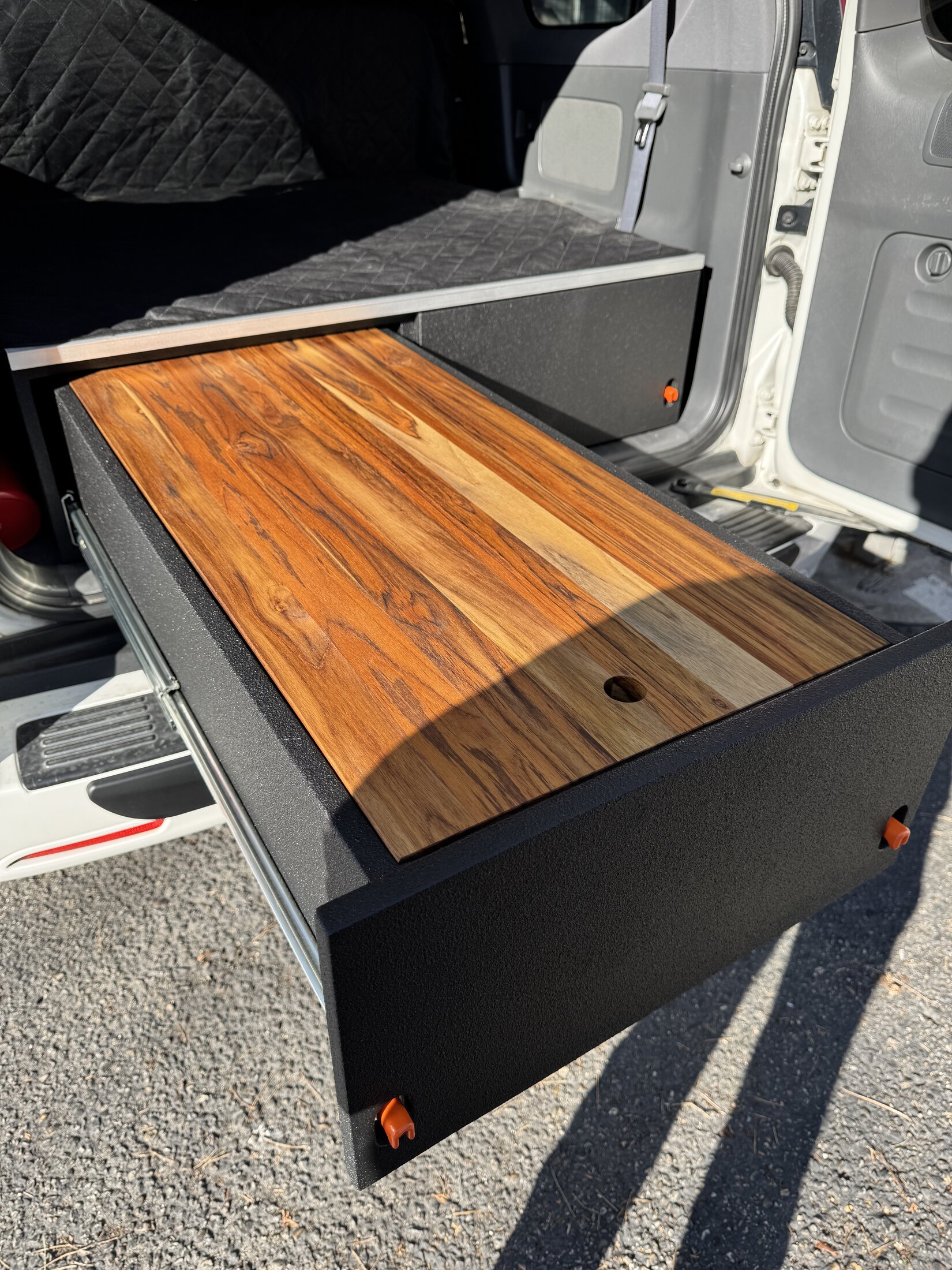

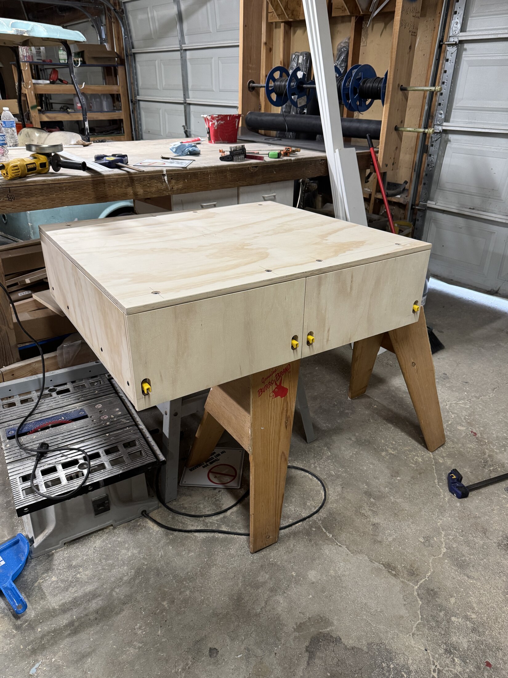

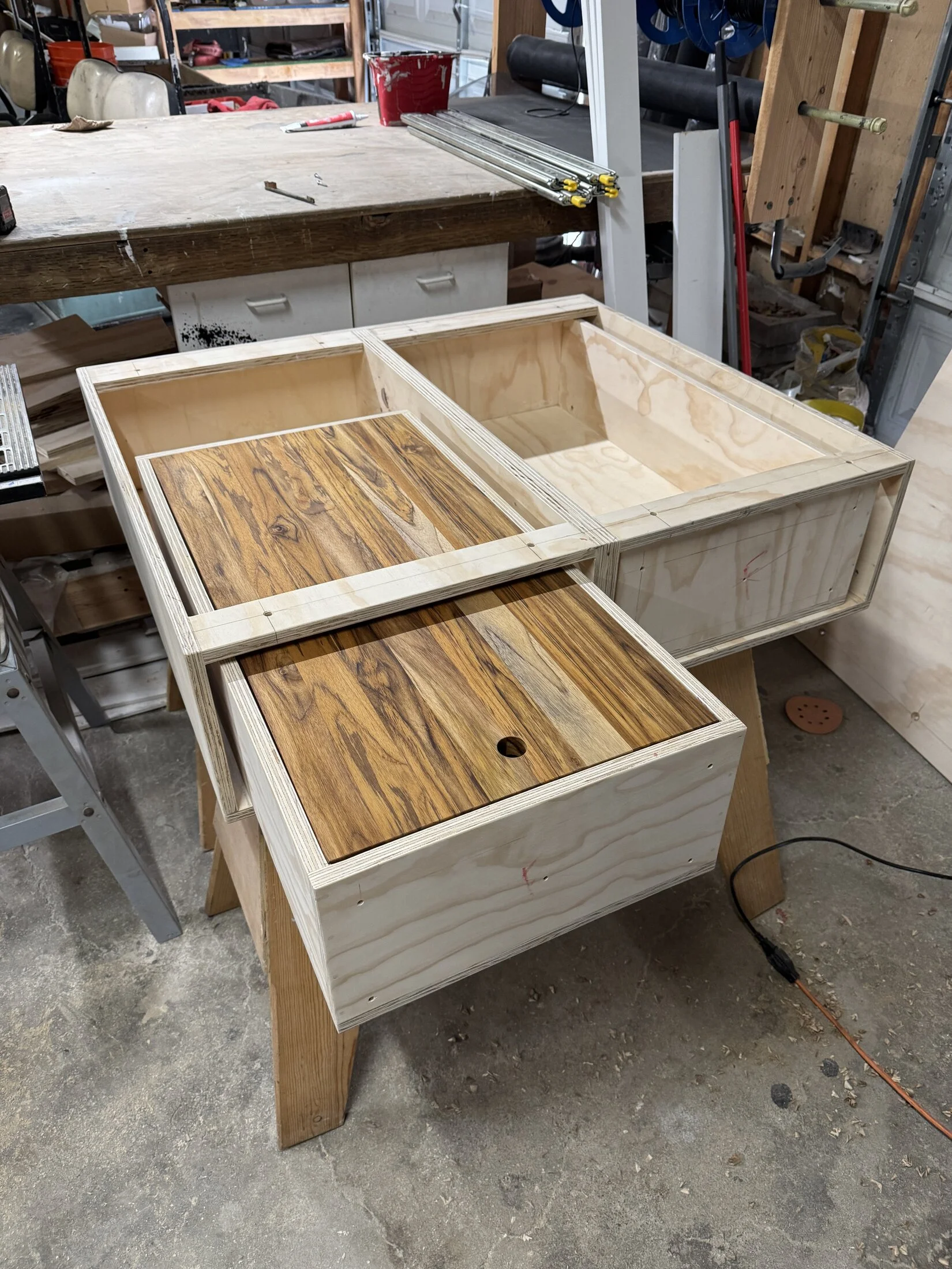

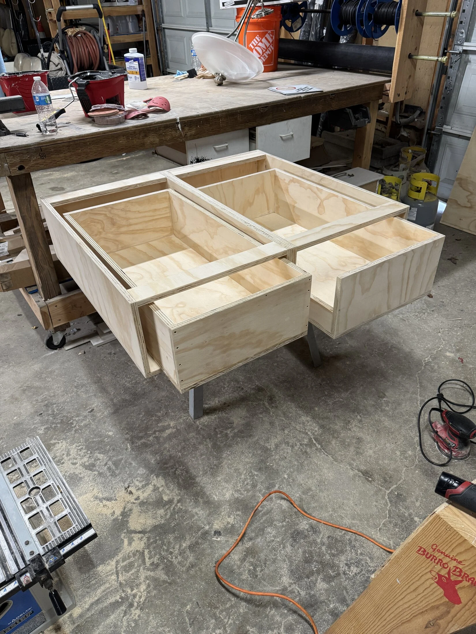

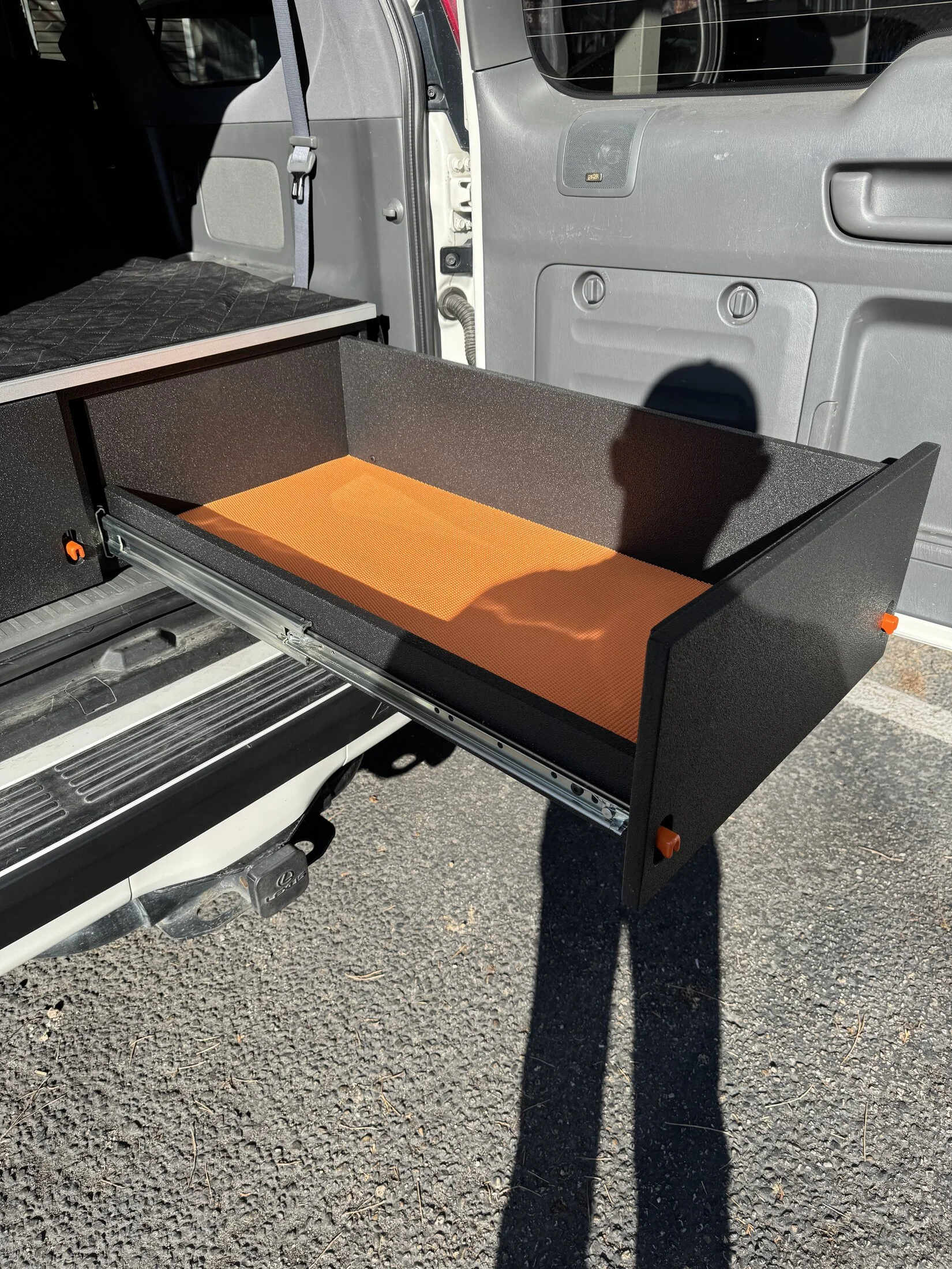

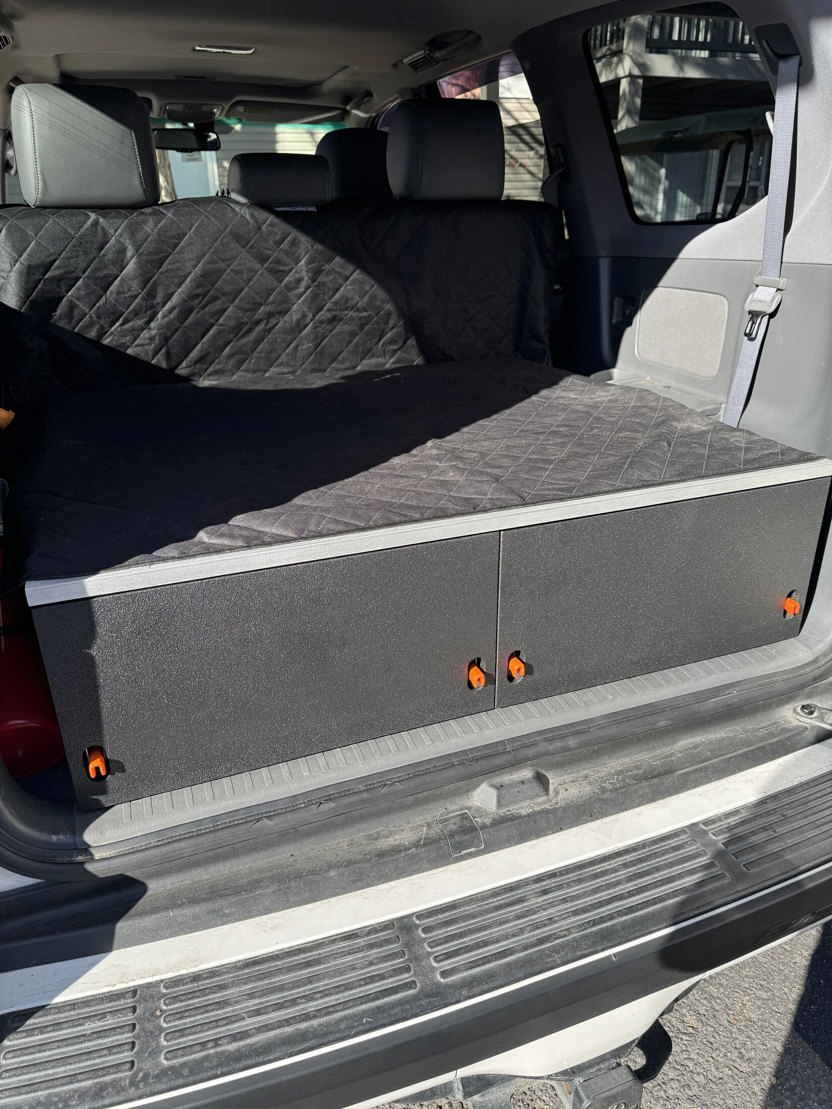

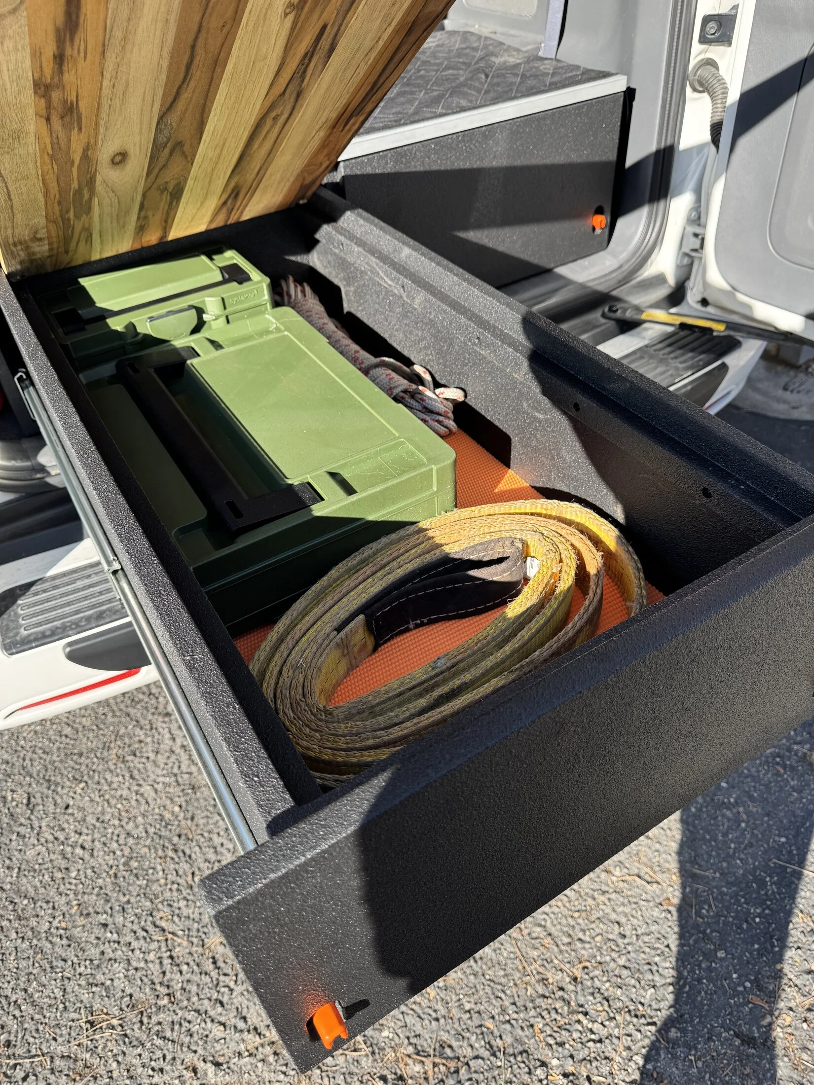

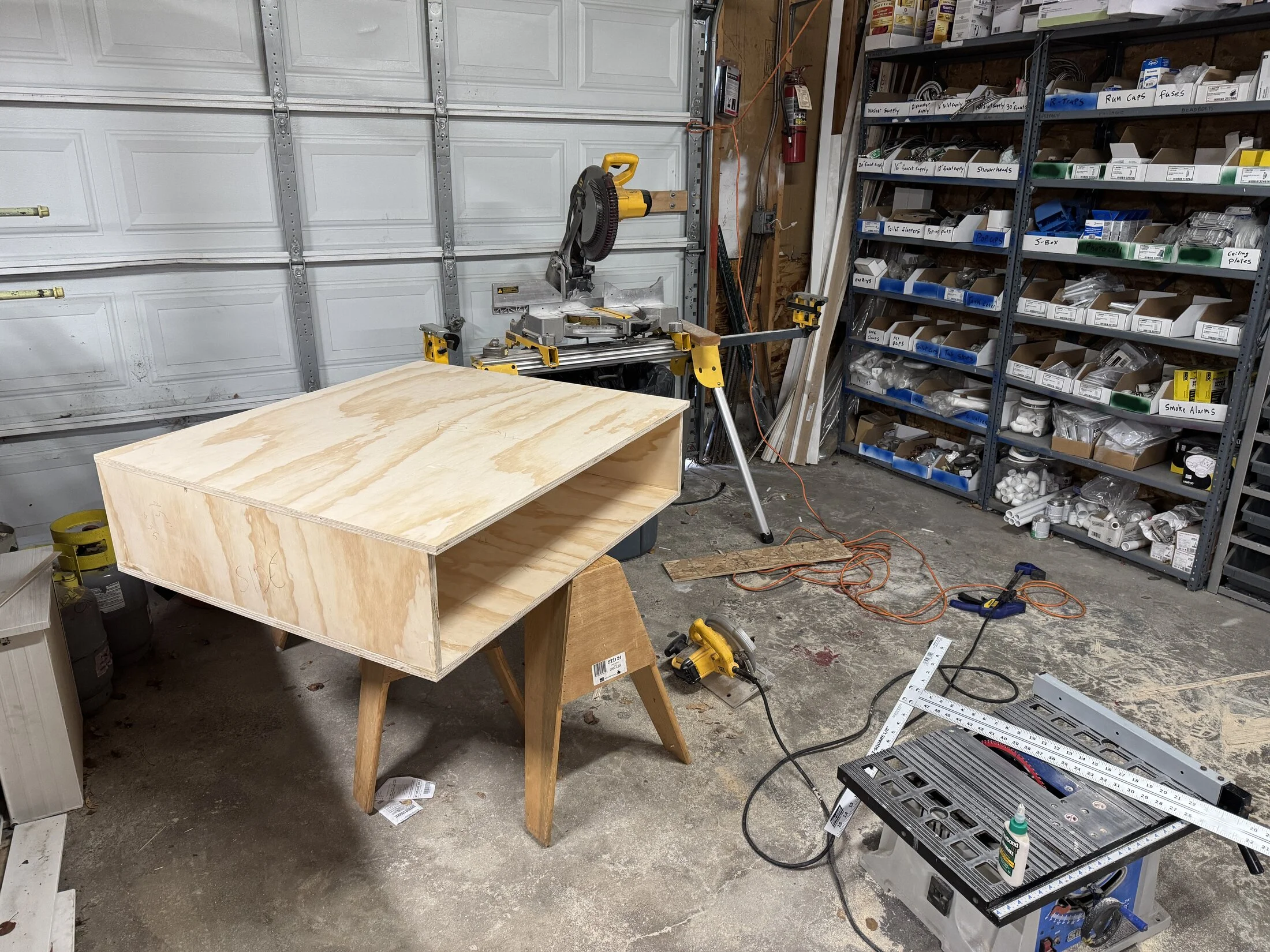

Wanting to get out and do some day trips mushroom hunting and enjoying the outdoors, I decided I needed to build some drawers. I ended up designing a two drawer system approximately 36"x41"x11" and began building it out of 3/4 plywood,

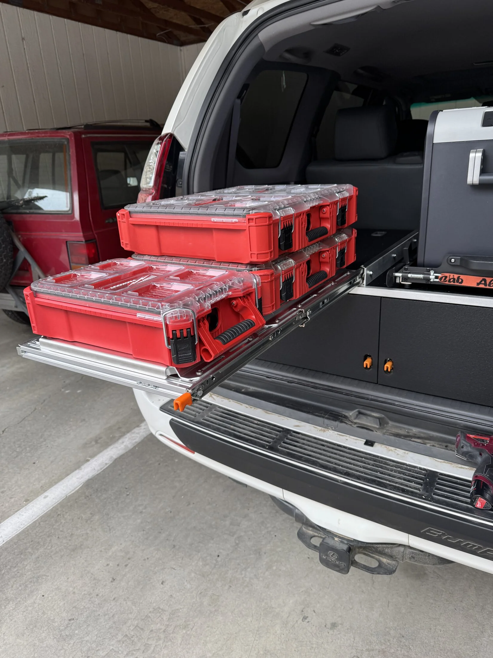

the drawers were built around the popular 250 pound slides and I opted to make the top removable for easy servicing and future modifications. The left drawer includes a butcher block table top and the right drawer has a half height side to make it a little easier to get storage containers in and out. In hindsight, I think this allowed the drawer to twist slightly and I probably wouldn't recommend it.

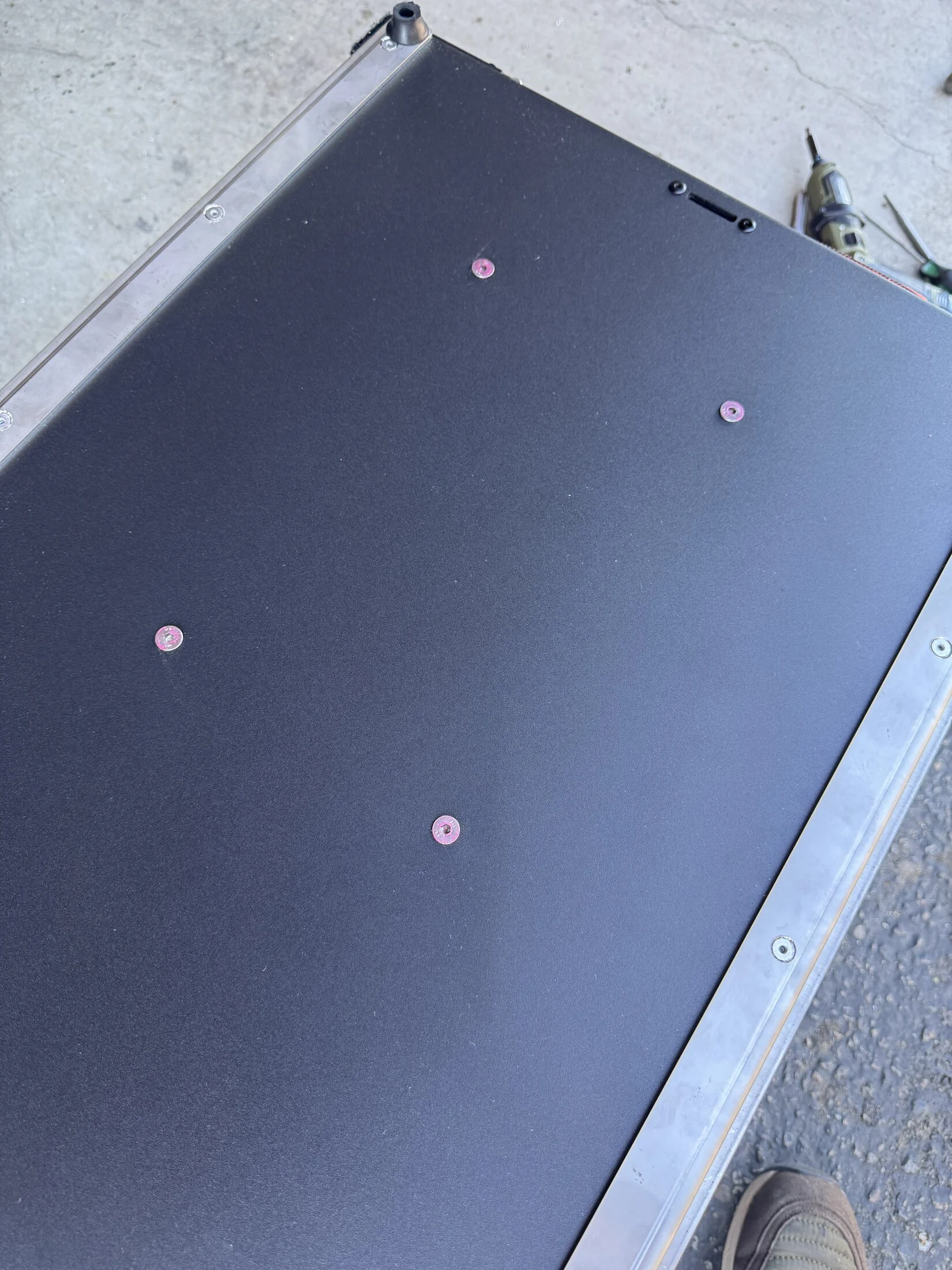

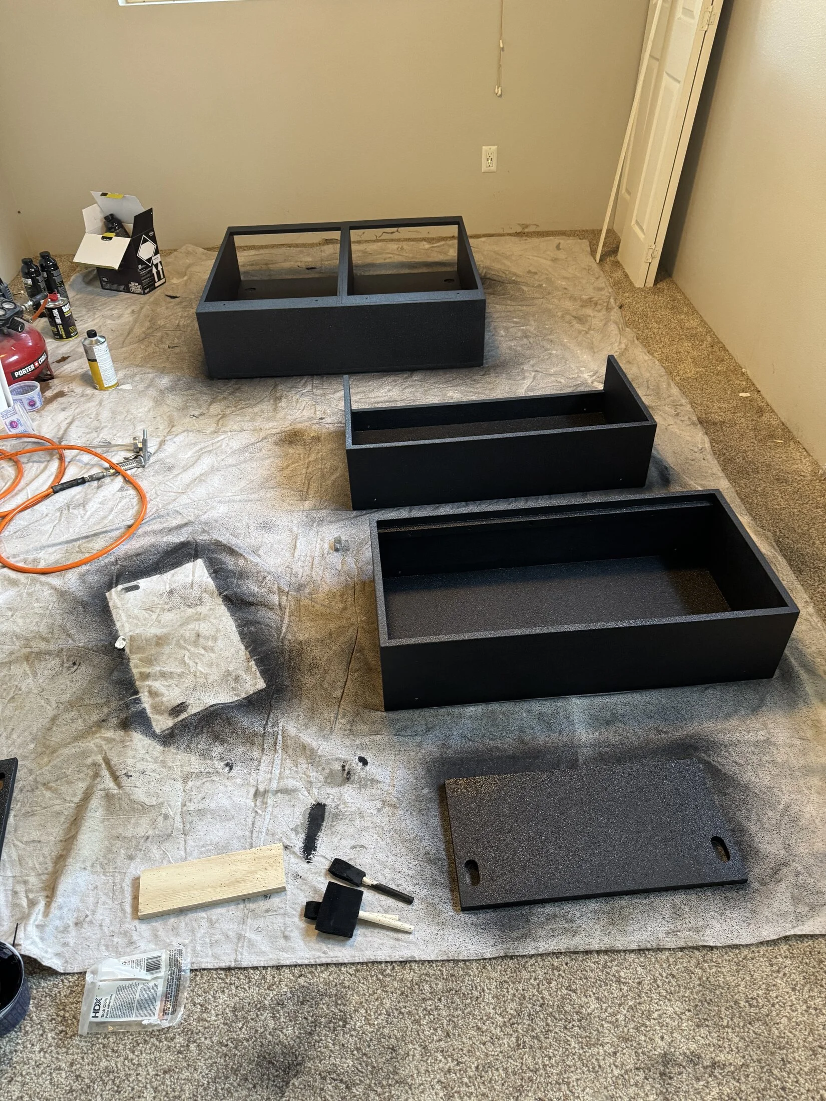

Next up was finishing and I opted to shoot it with some Raptor Liner. Ive sprayed gallons of the stuff in the past and really love the product. I rolled on the fist coat reduced slightly for coverage and sprayed the other three bottles through the included gun. (the garage was too cold so got to spray in an apartment that was being renovated :D)

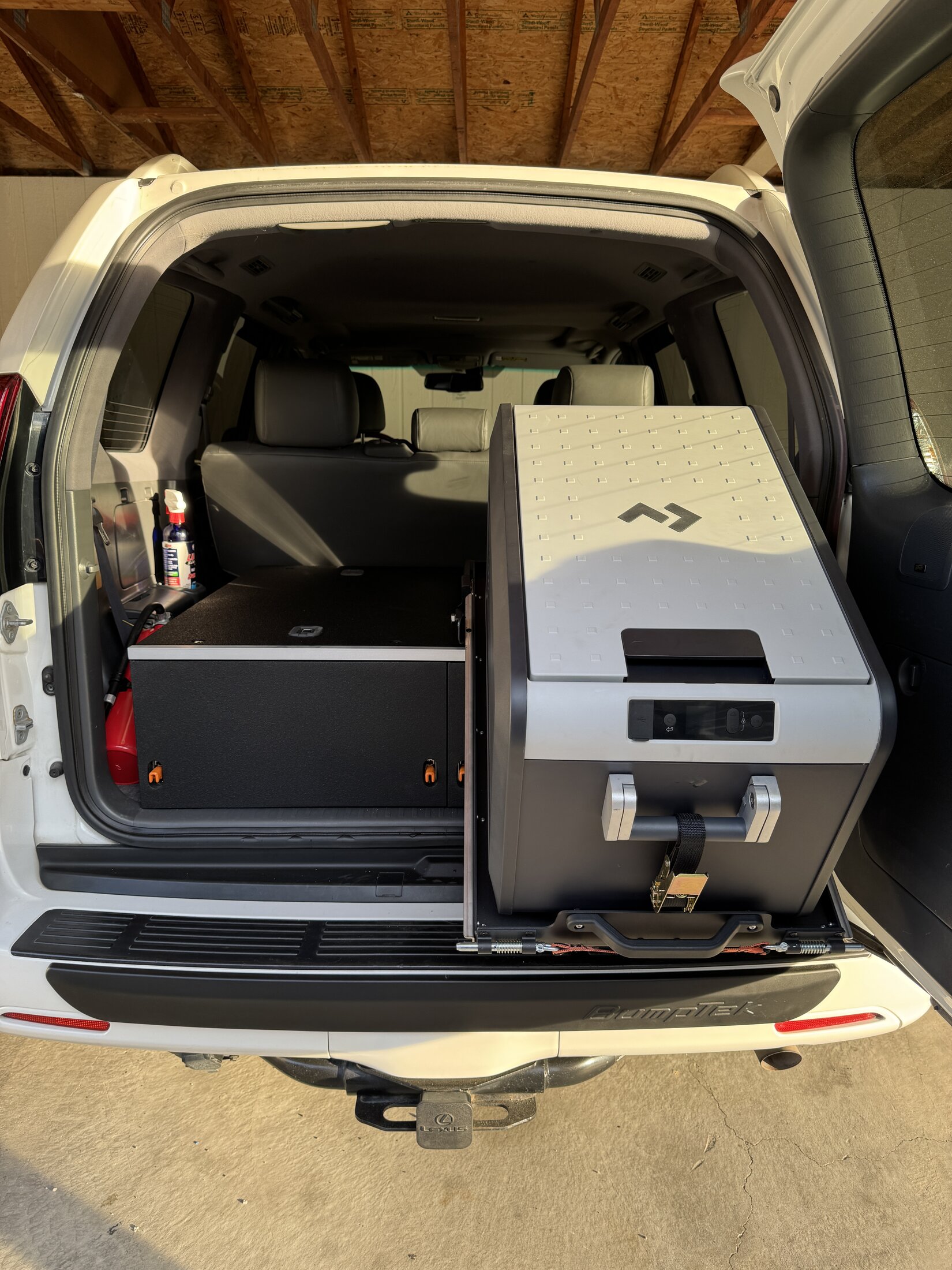

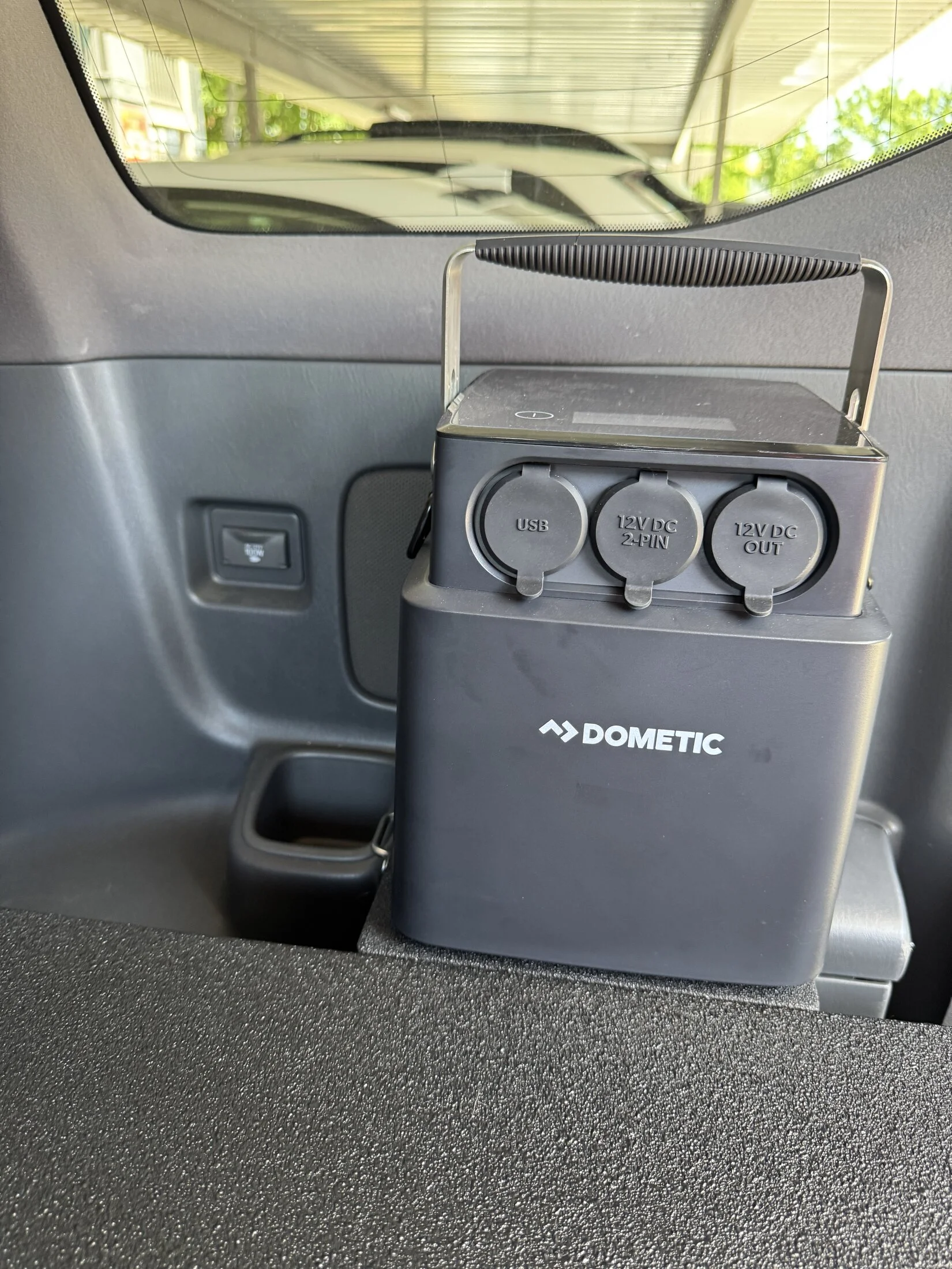

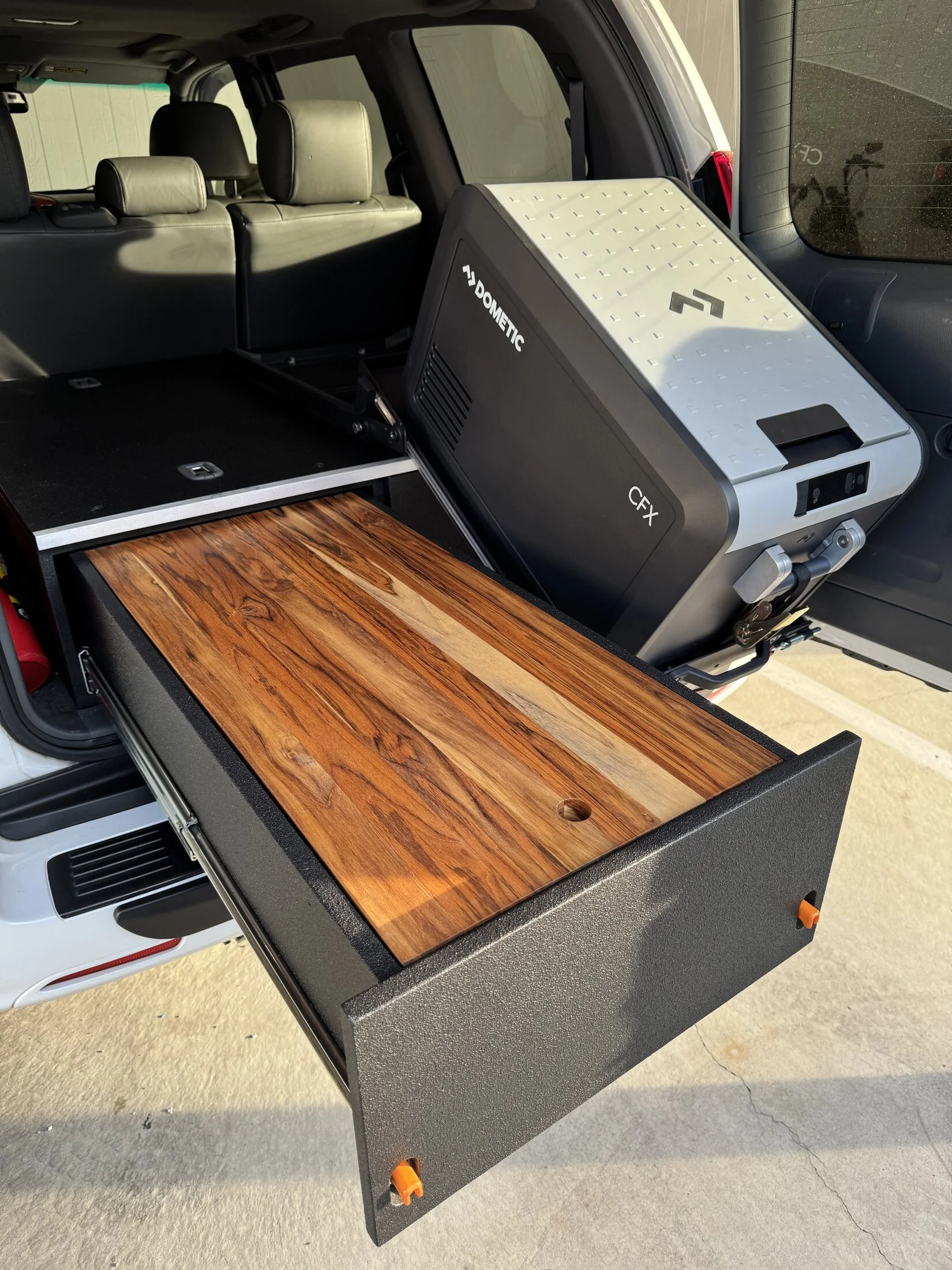

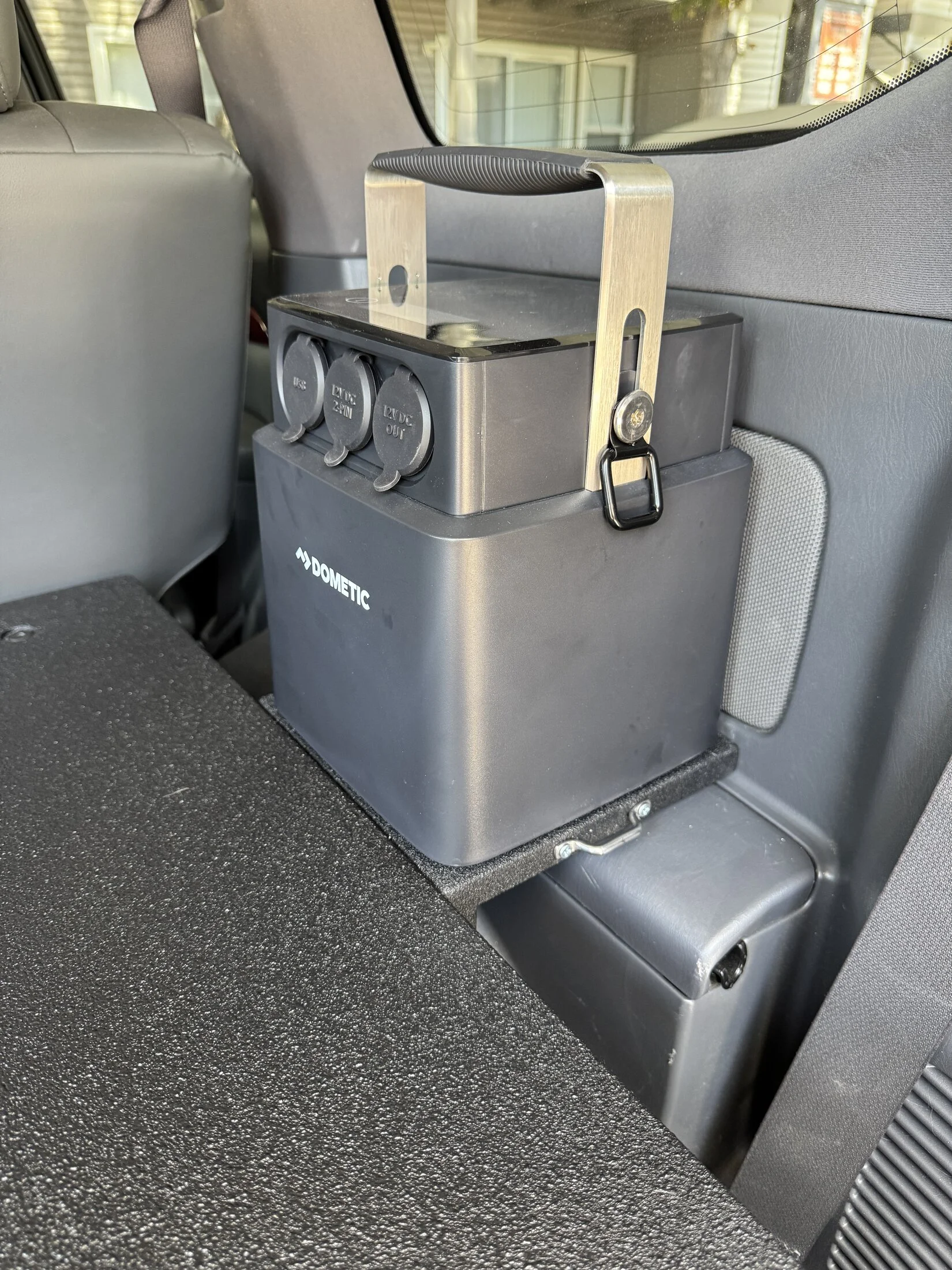

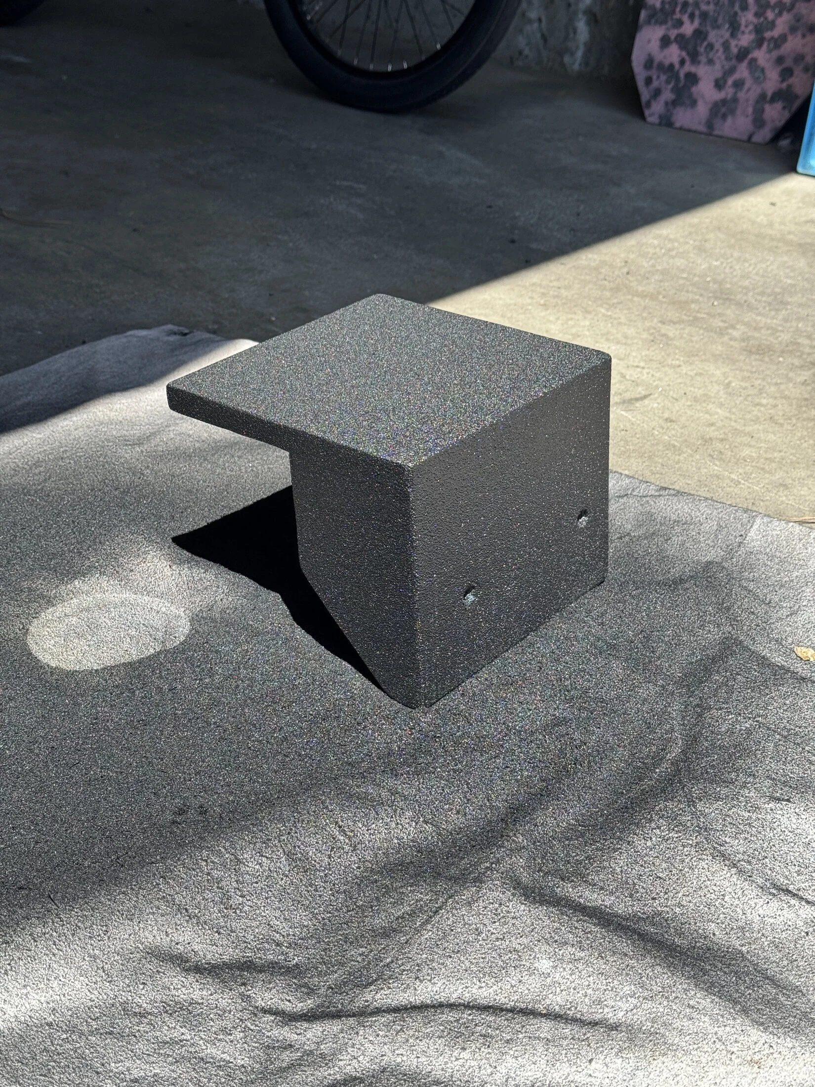

I opted for the Dometic CFX3 35 and figured id run it off the PLB40. Figured it would charge alright off the factory inverter so wanted to build a mount for it near that location.

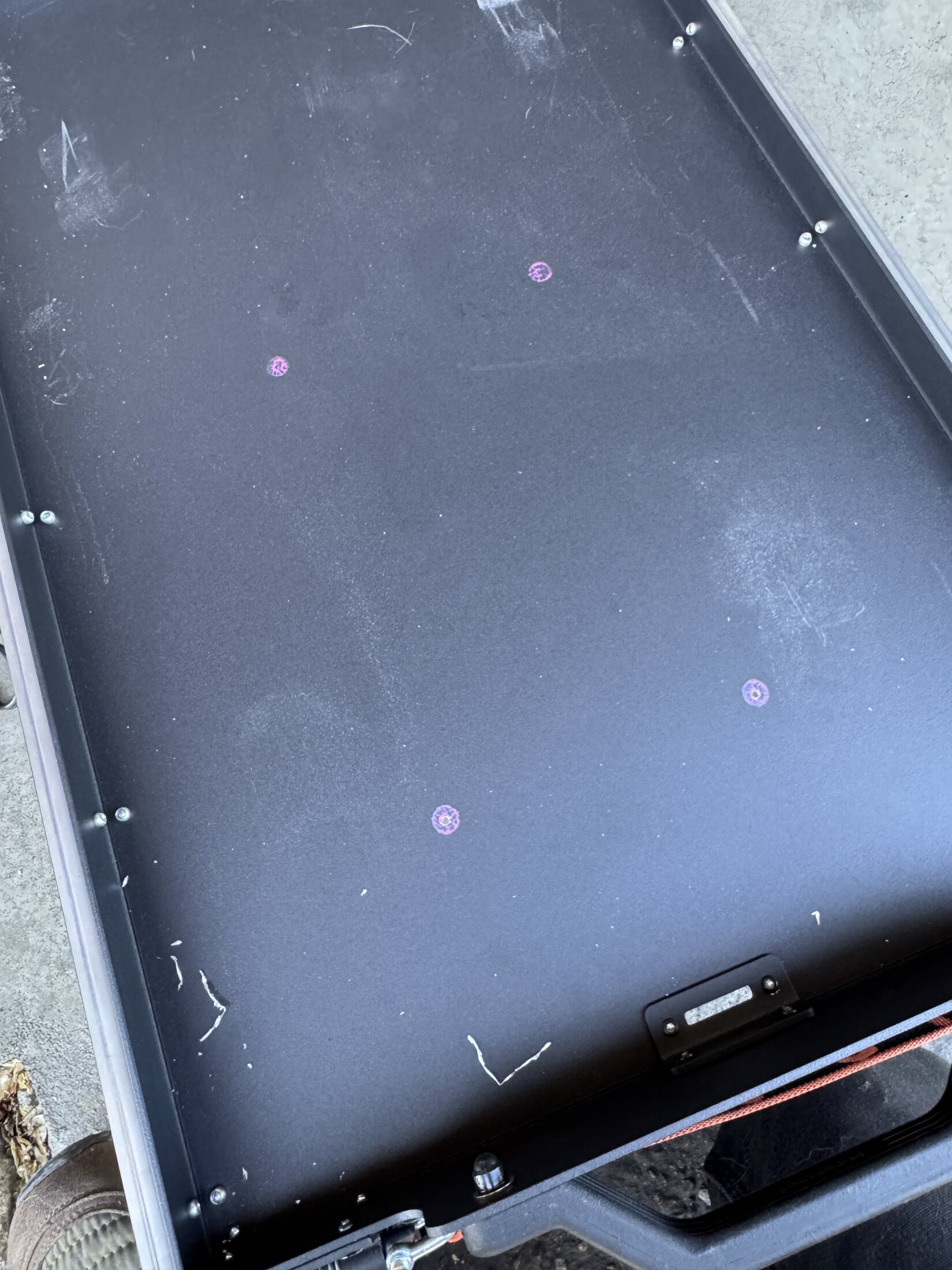

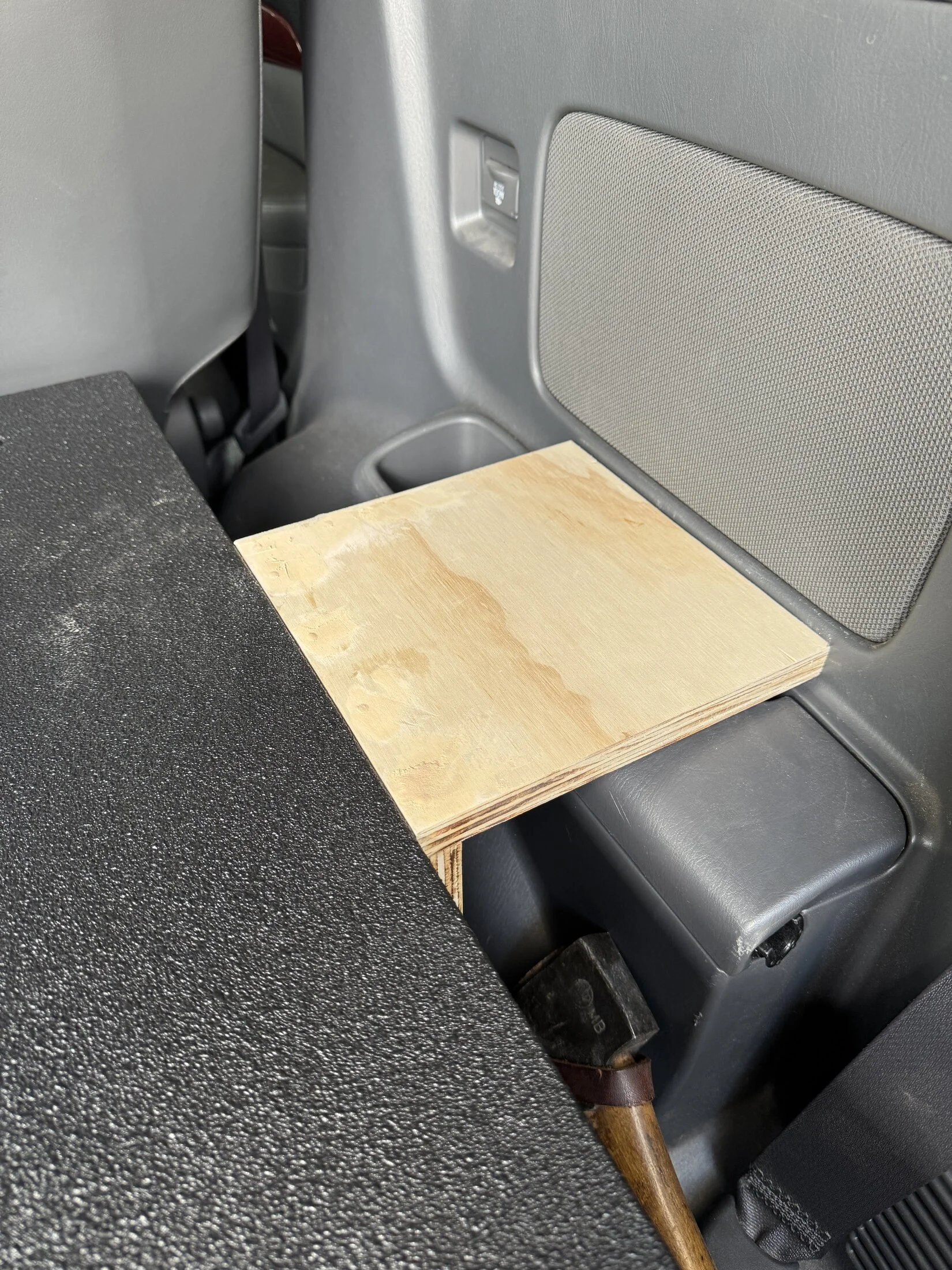

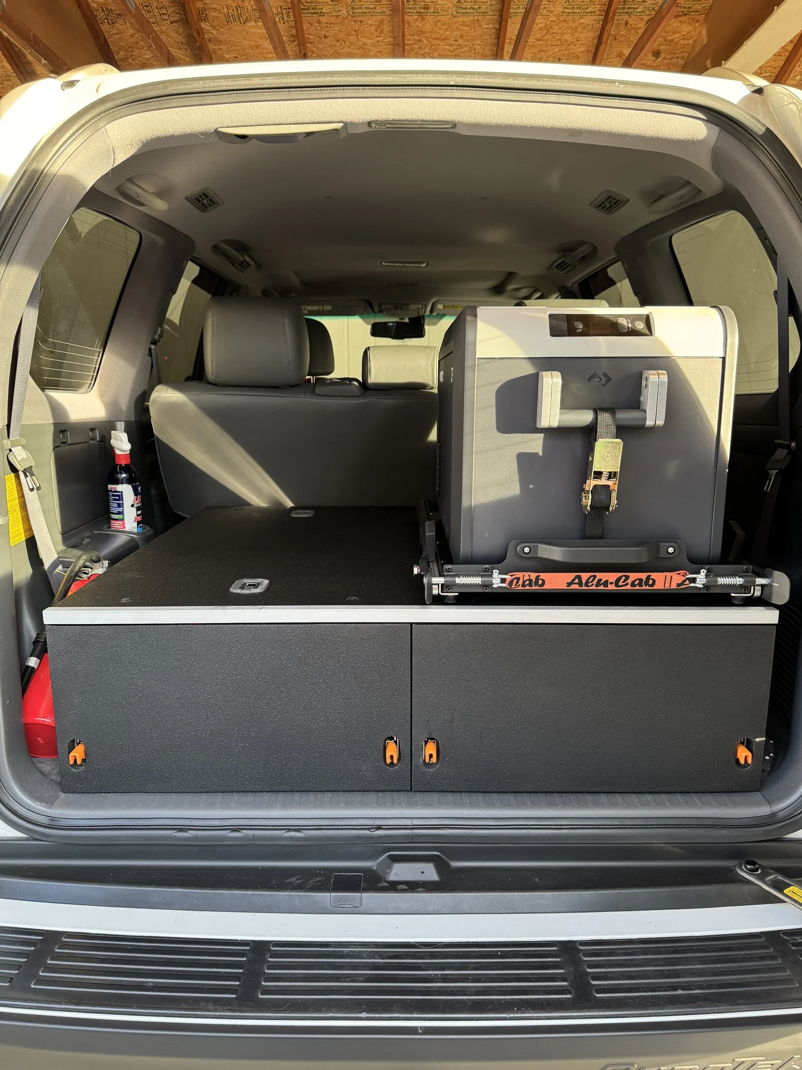

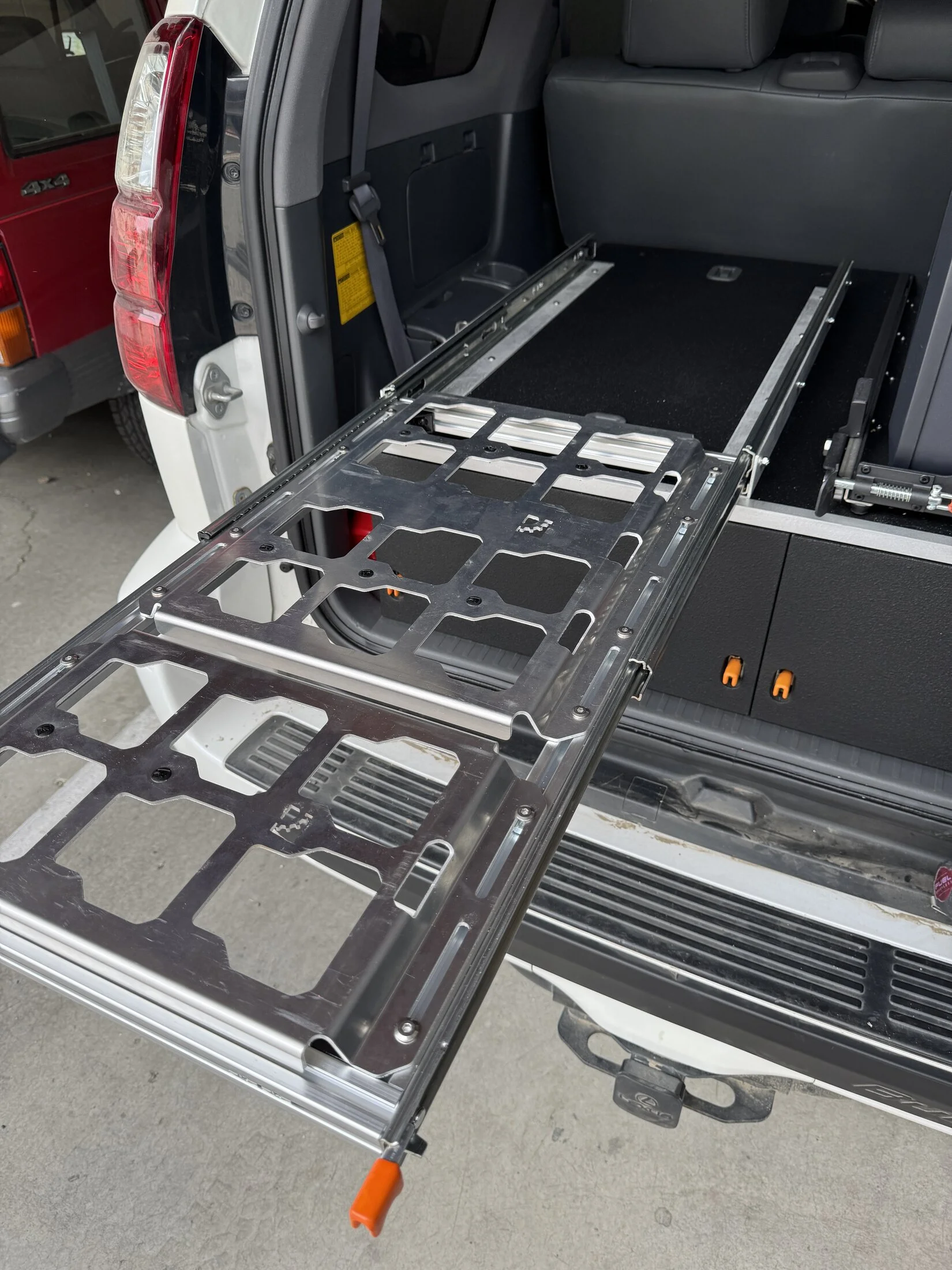

Went out morel hunting to test the fridge and slide. Worked pretty well overall but had an issue with strapping the fridge to the slide. When strapped tightly enough to not slide, the strap spreads the fridge enough for the lid not to latch. I pulled the fridge off the slide to figure out a solution and realized there was threaded holes on the bottom of the fridge. Ended up just drilling holes in the slide and bolting it down. Much better.

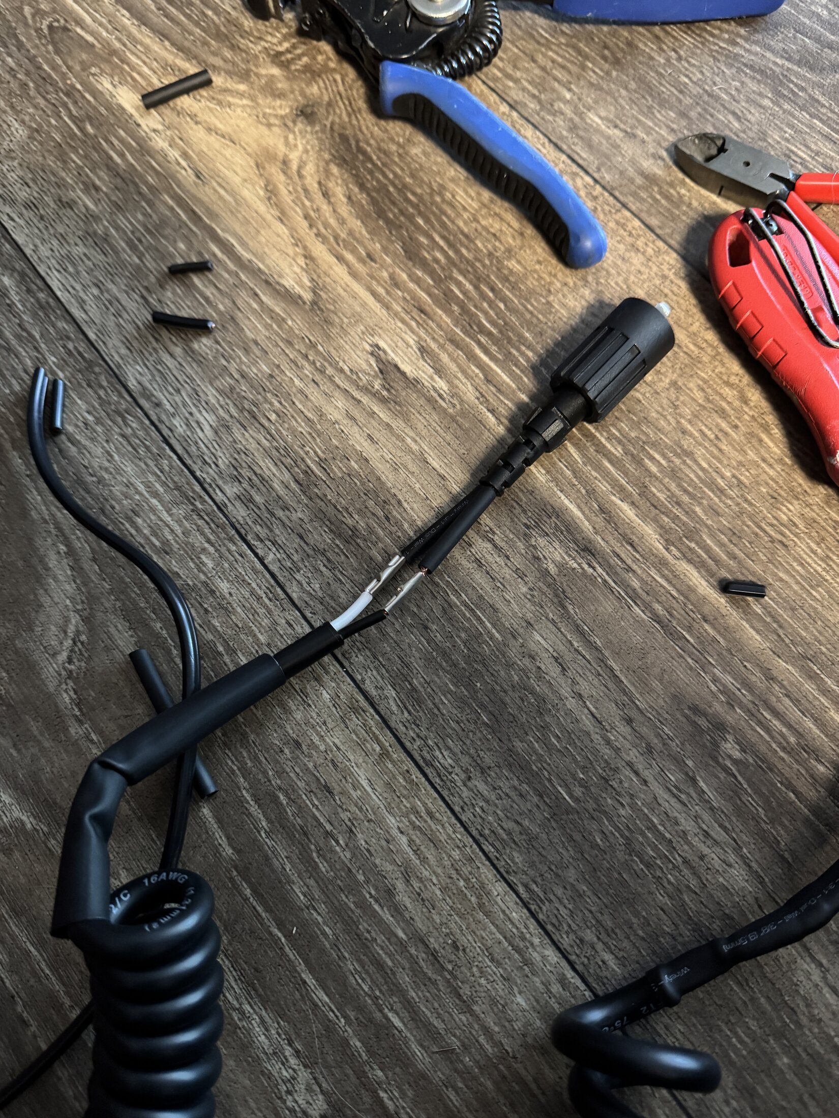

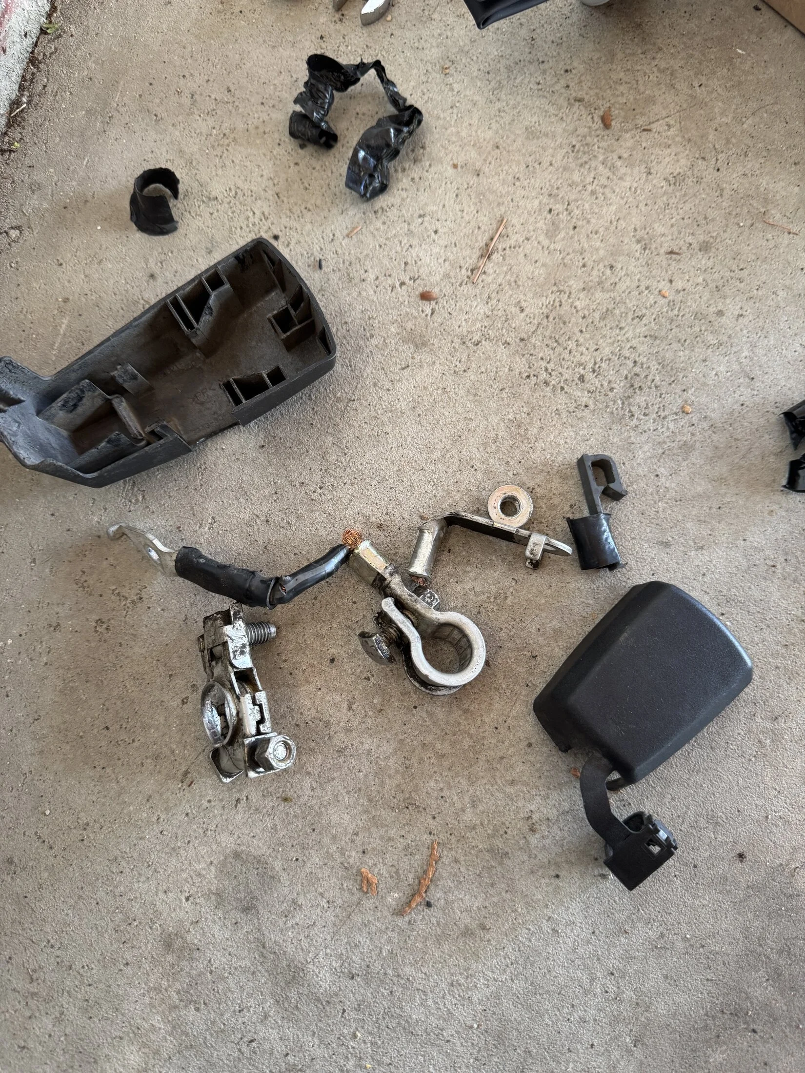

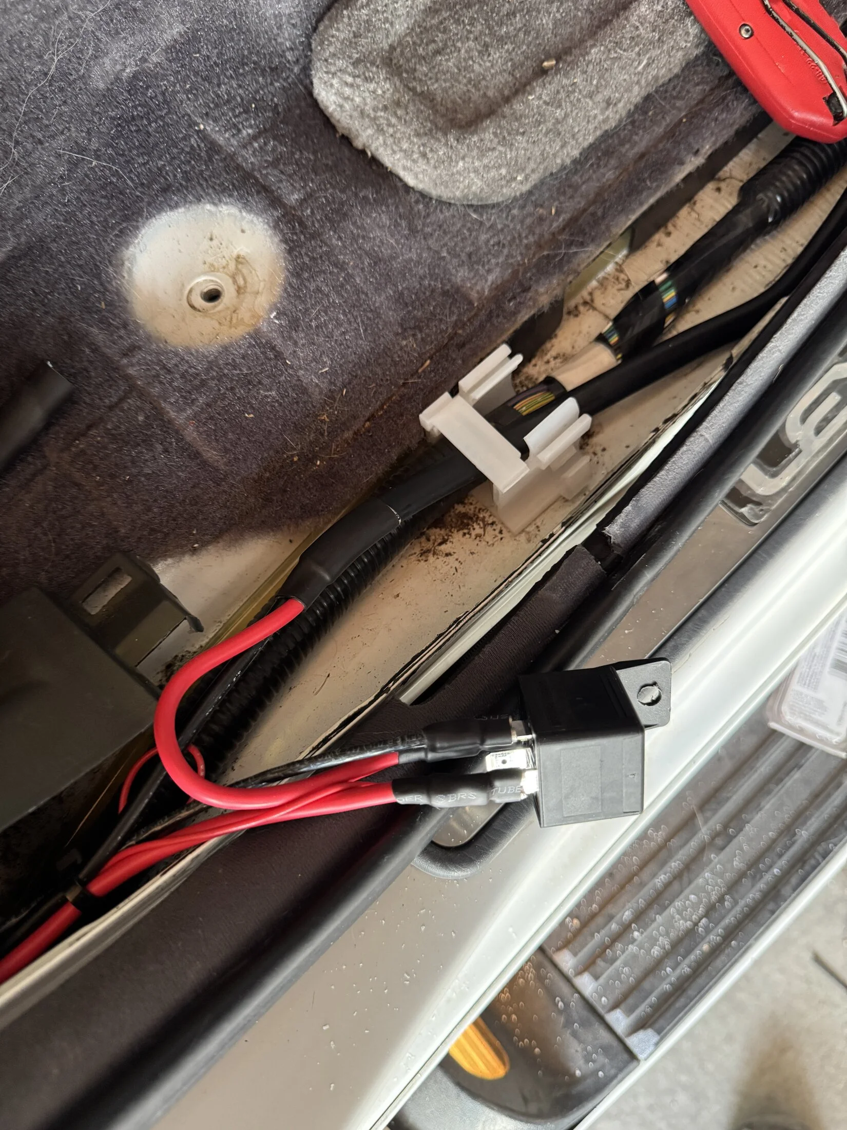

The built in inverter wasn’t cutting it with the fridge. Decided to install the dometic fridge wiring kit to better charge the PLB40. I only wanted the PLB40 to charge with the ignition on so decided to wire it up with a relay triggered by the switch for the inverter outlet.

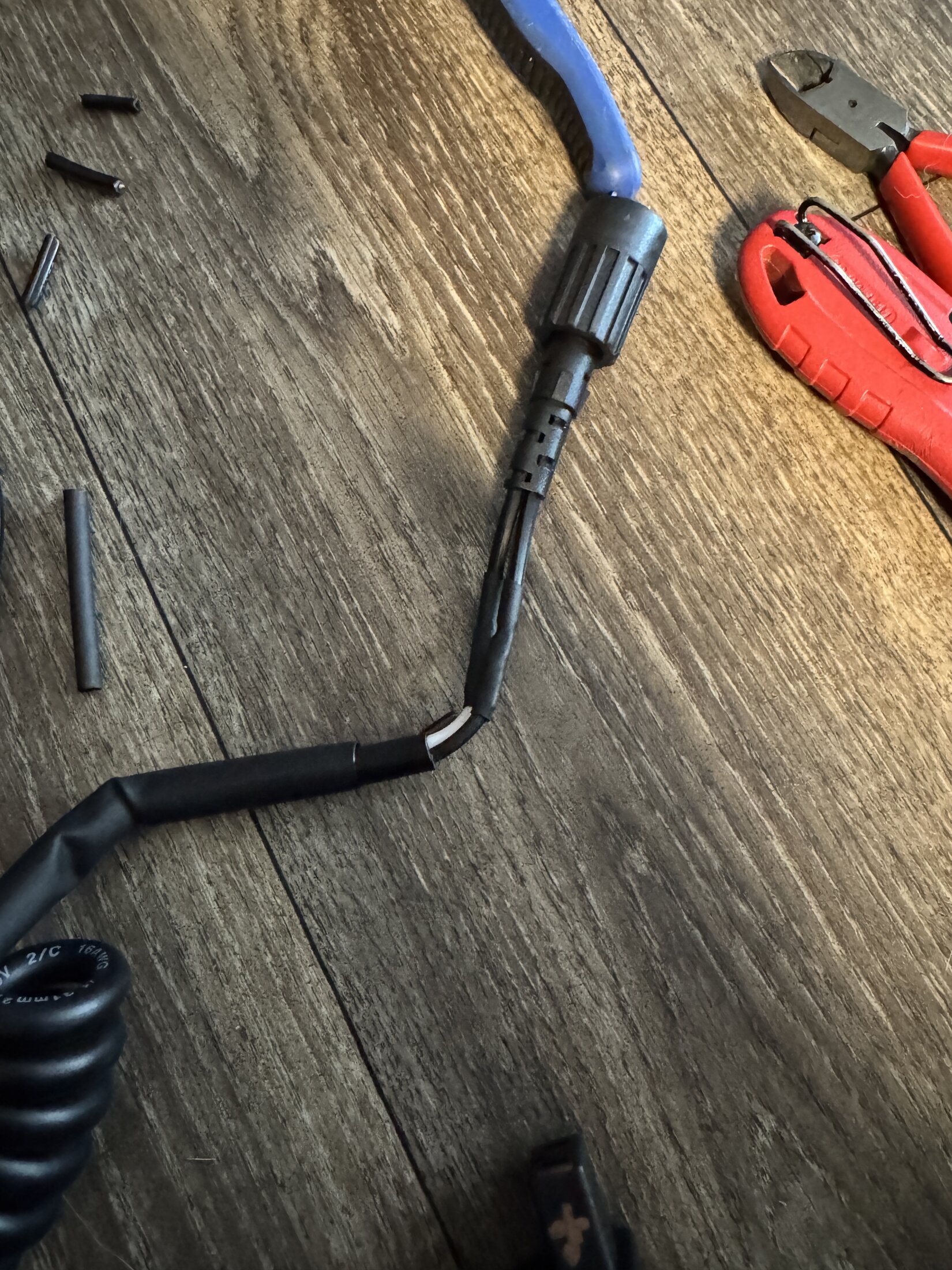

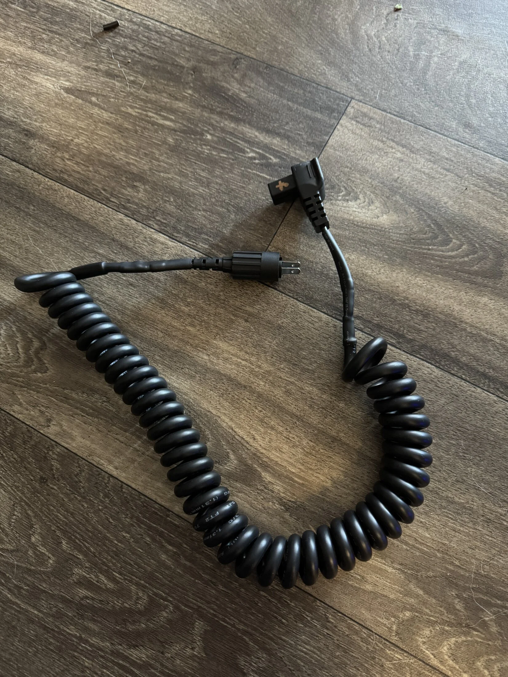

I also decided to modify the dometic fridge cable to a coiled type. Ends are a little ugly but it works well and was much cheaper than buying one.

Is any sort of primer recommended and/or required for the Raptor liner adhesion on plywood?

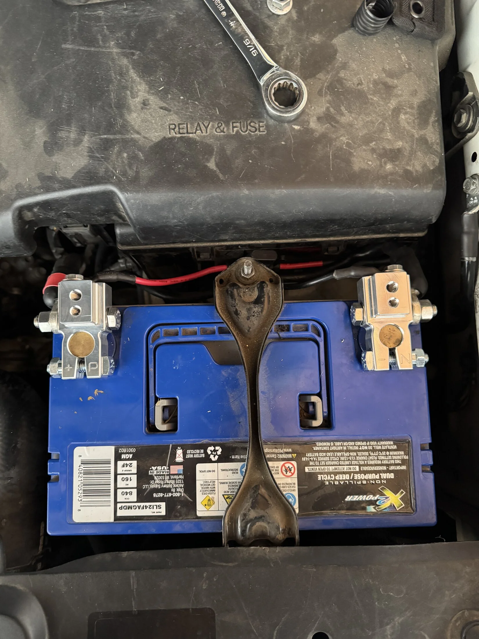

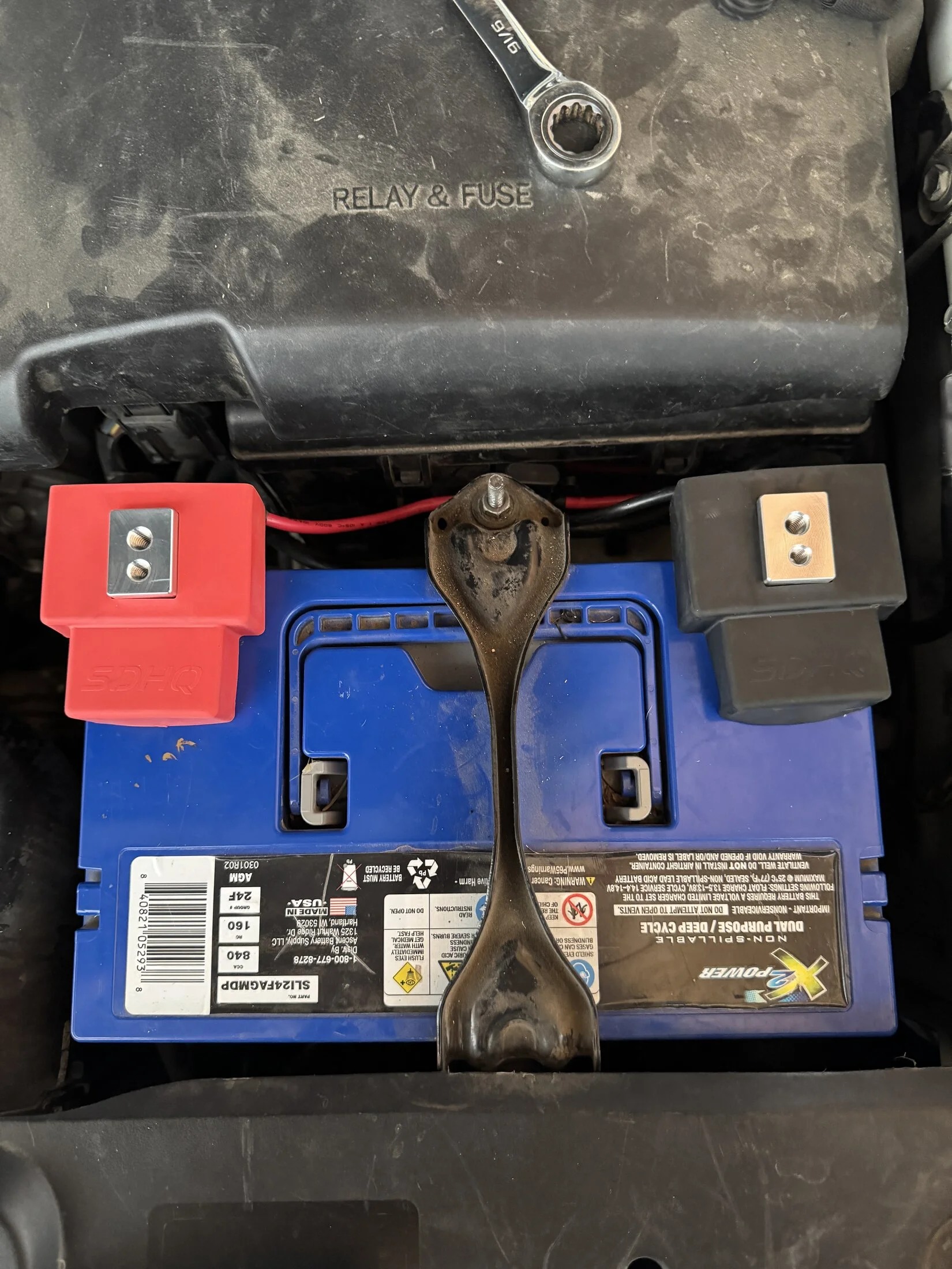

Those SDHQ battery terminals look really nice, but doesn't that introduce a whole mess of dissimilar metal action? I think of all the crap electricians go through in a house where some wiring is aluminum and some is copper.

I didn’t prime the plywood. I did reduce my first coat about 20% and rolled it on with a 4” roller. Think that helped it soak into the wood.
I’m not educated enough on dissimilar metal corrosion to be able to answer your question on that. Time will tell but I haven’t heard any complaints about billet terminals.
