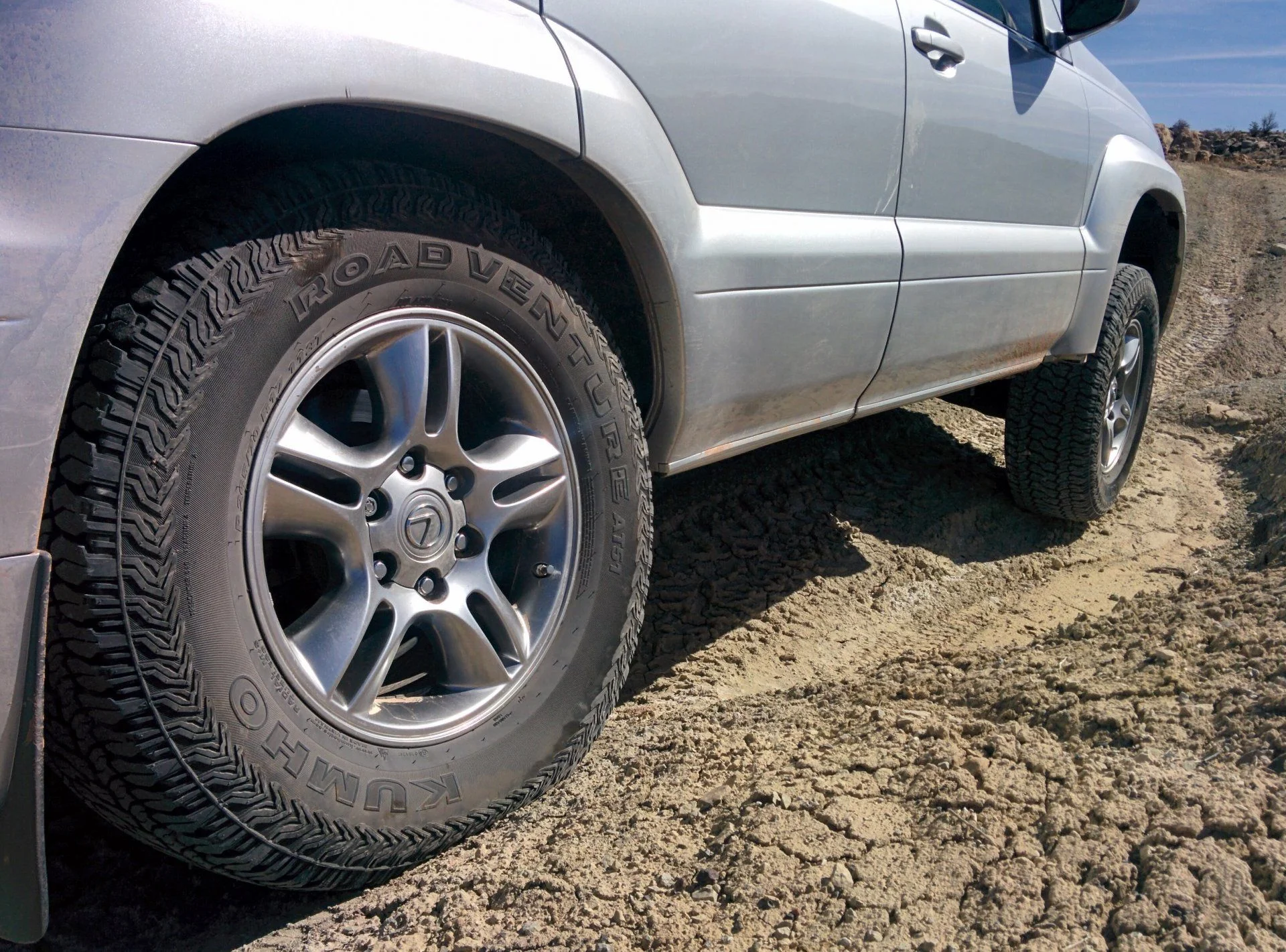

Welcome! How do you like those Kuhmos?
thanks.
They're fine, came on the rig. they grip sandstone fine, but so does bald rubber ;) and they're snow handling is pretty good. On road manners are quiet and confident as well. IIRC they're a size up from stock (they're 265-70 17).

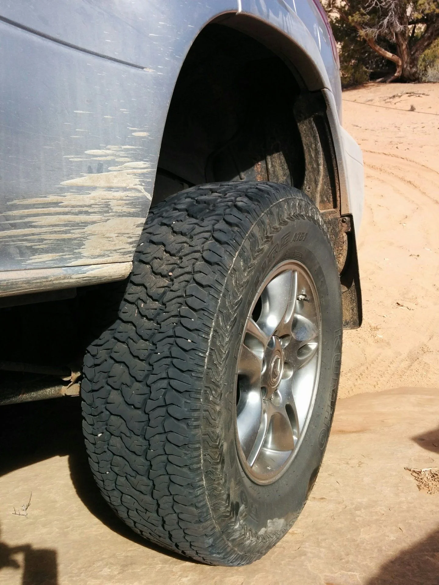

Beautiful truck. I'm new to this thread so this question is a bit late. It looks like you did quite alot of off-roading with the stock suspension. Is that true? Are you considering adding a lift or modifying the suspension?
I did this trip on stock suspension. It does better than one might expect.
hey,
Stock is fine for me for this rig for now and a while. I will pull off the runningboards and eventually add rock sliders, but beyond that heavy mods to this rig aren't priority. It does VERY well stock and for my and my family needs, moding isn't high priority, logevity, comfort, capability and reliability are, all of which are well met as is.

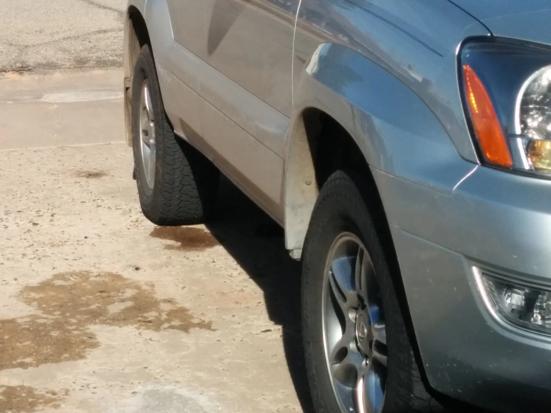

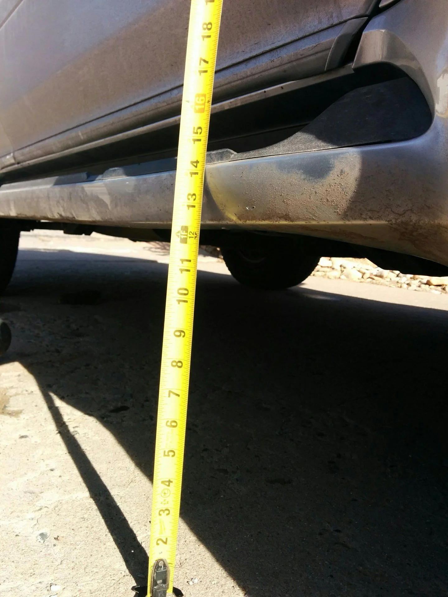

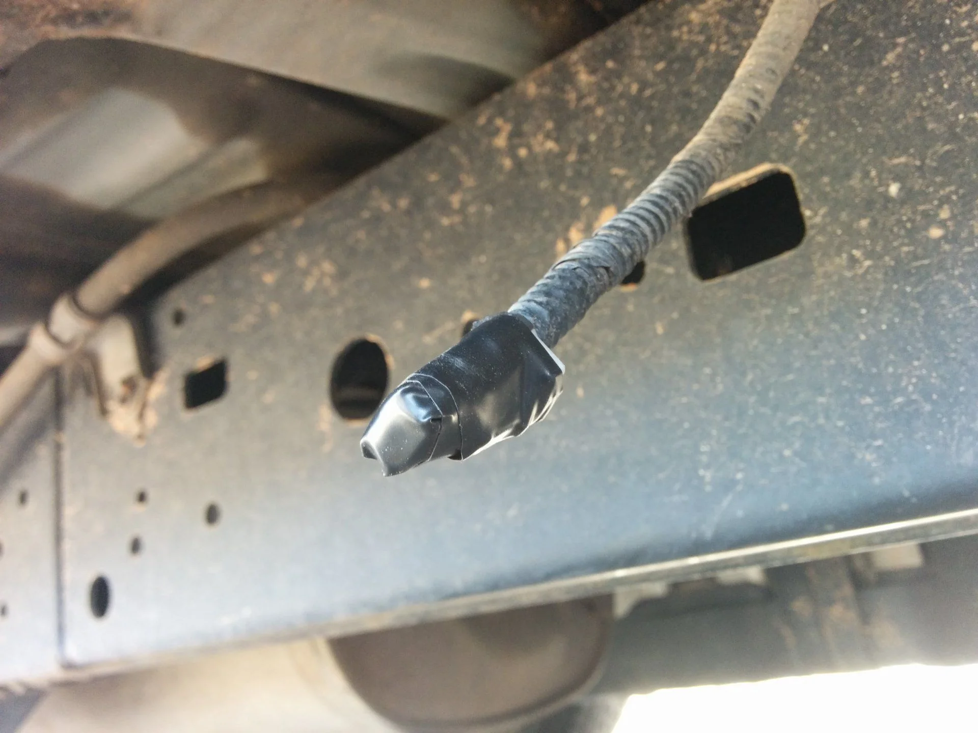

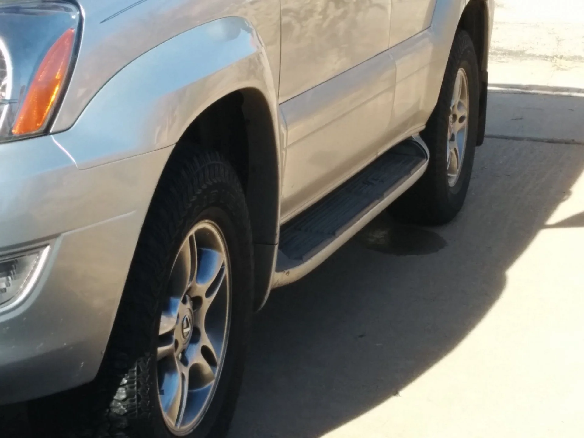

Today saw a running board delete.

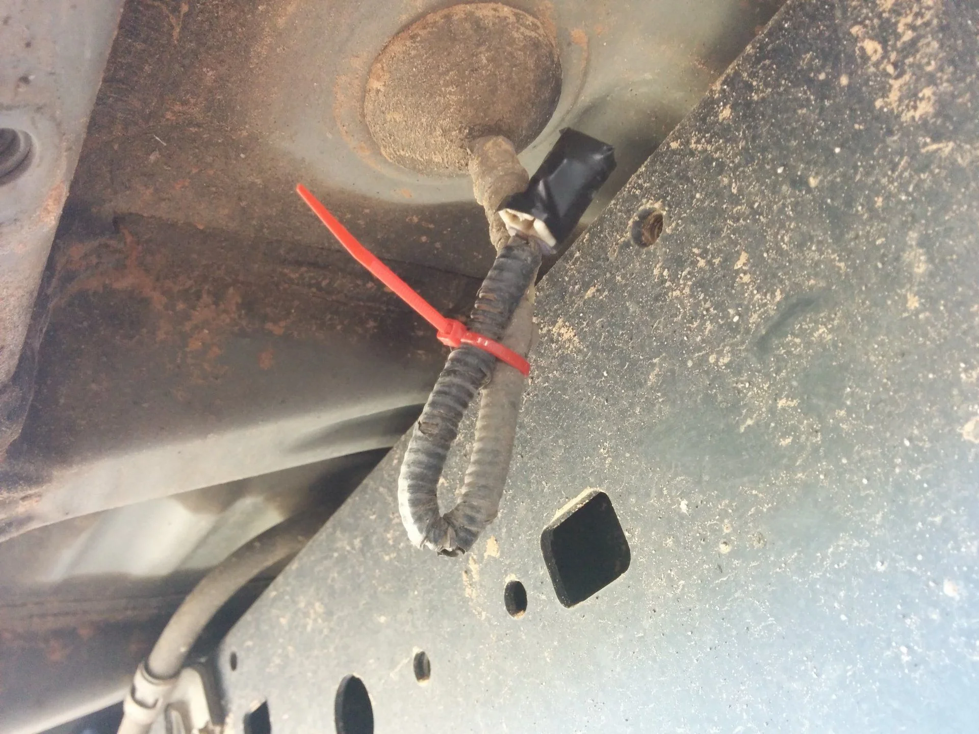

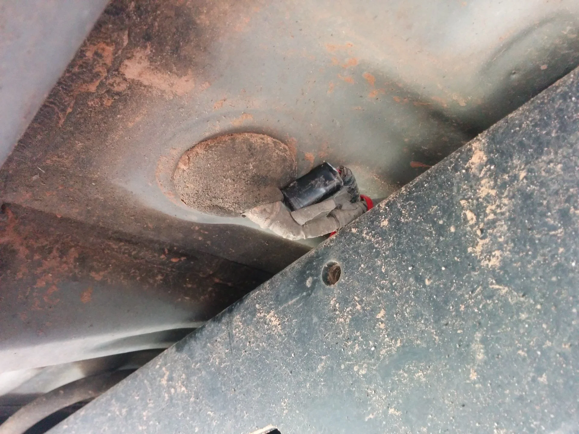

Taped, tied and tucked the running board lighting harness.

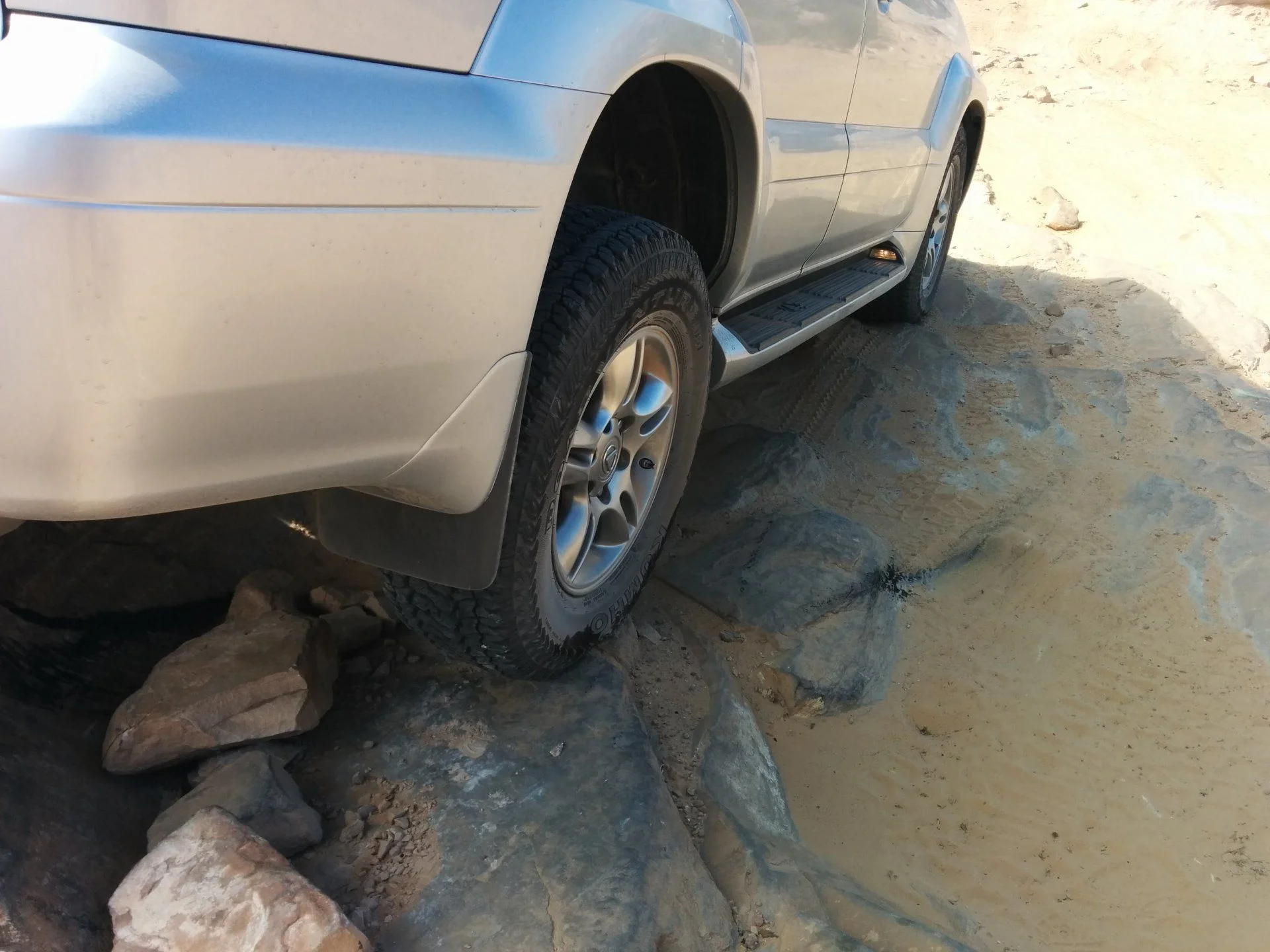

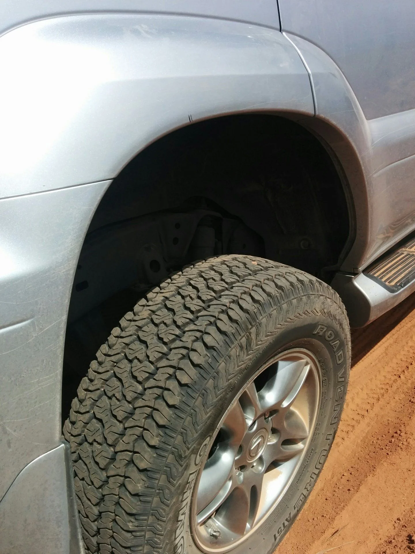

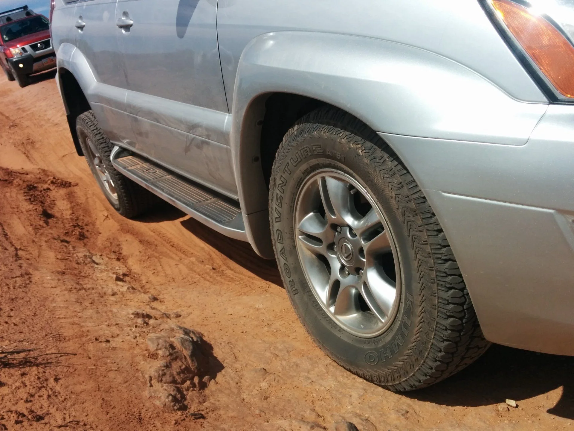

another perspective of stock-not stock

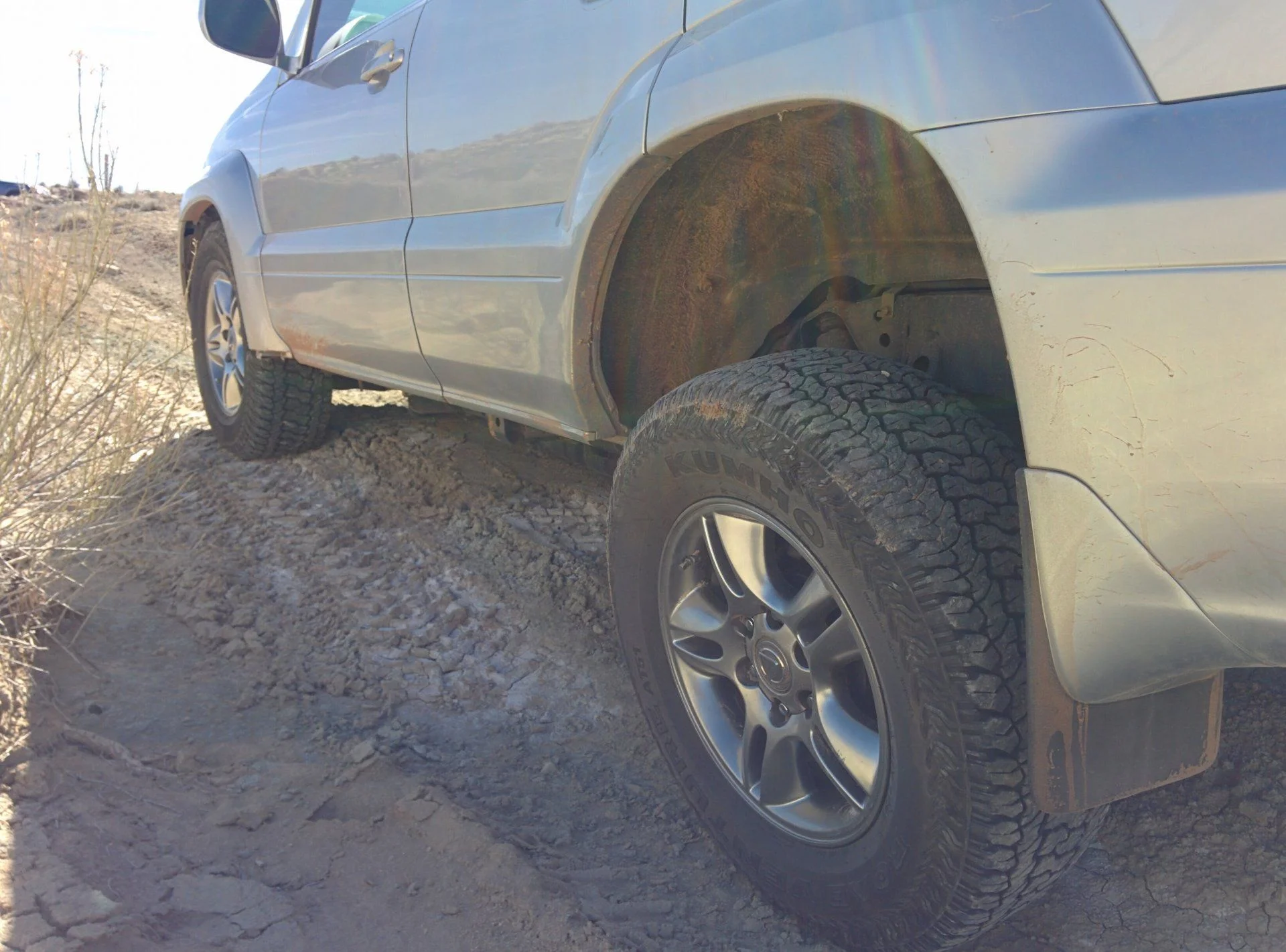

Spring is here (there's no reason to verify that though ;)!! Mid 70s most of last week, so I went out to Crystal Geyser (and it was erupting, sweet!) and the Whitewash sand dunes with a buddy.
Still marveling at stock suspension travel!

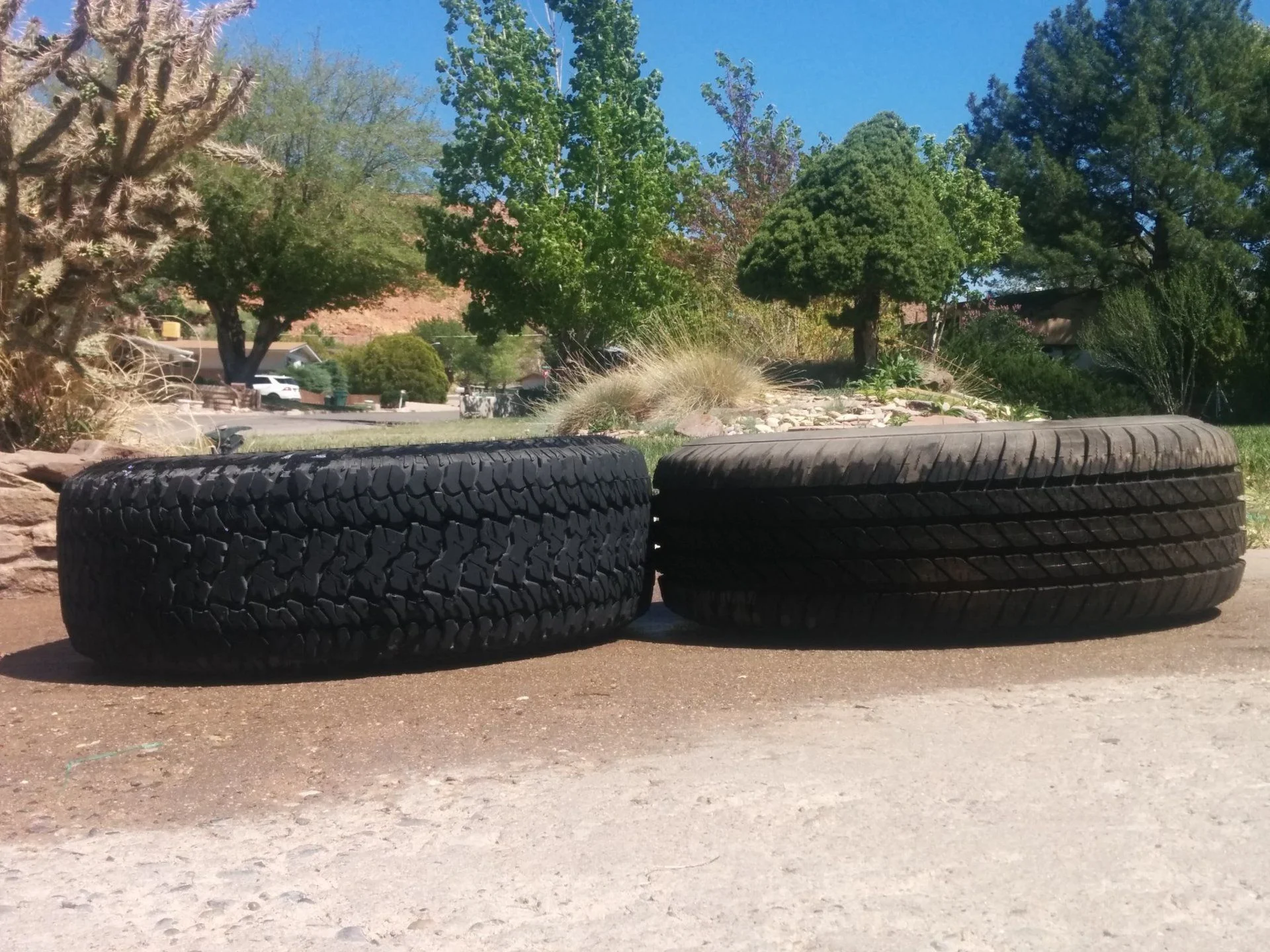

Khumo review update:
Not stellar.
P-metric is NOT an LT, despite tread pattern. So plusses, its quiet, good handling in dry, wet and snow but pretty quick tire wear. When I got the truck, the tires looked pretty new (caveat: I did not spec the tread depth, just visual) and were 1/2 size over stock which is good in my book.
8 months in, they have 8-9/32 tread remaining (kind of quick wear for like 5-6K miles). they're wearing pretty evenly but I had to get 2 alignments to verify/check a right pull in the truck.

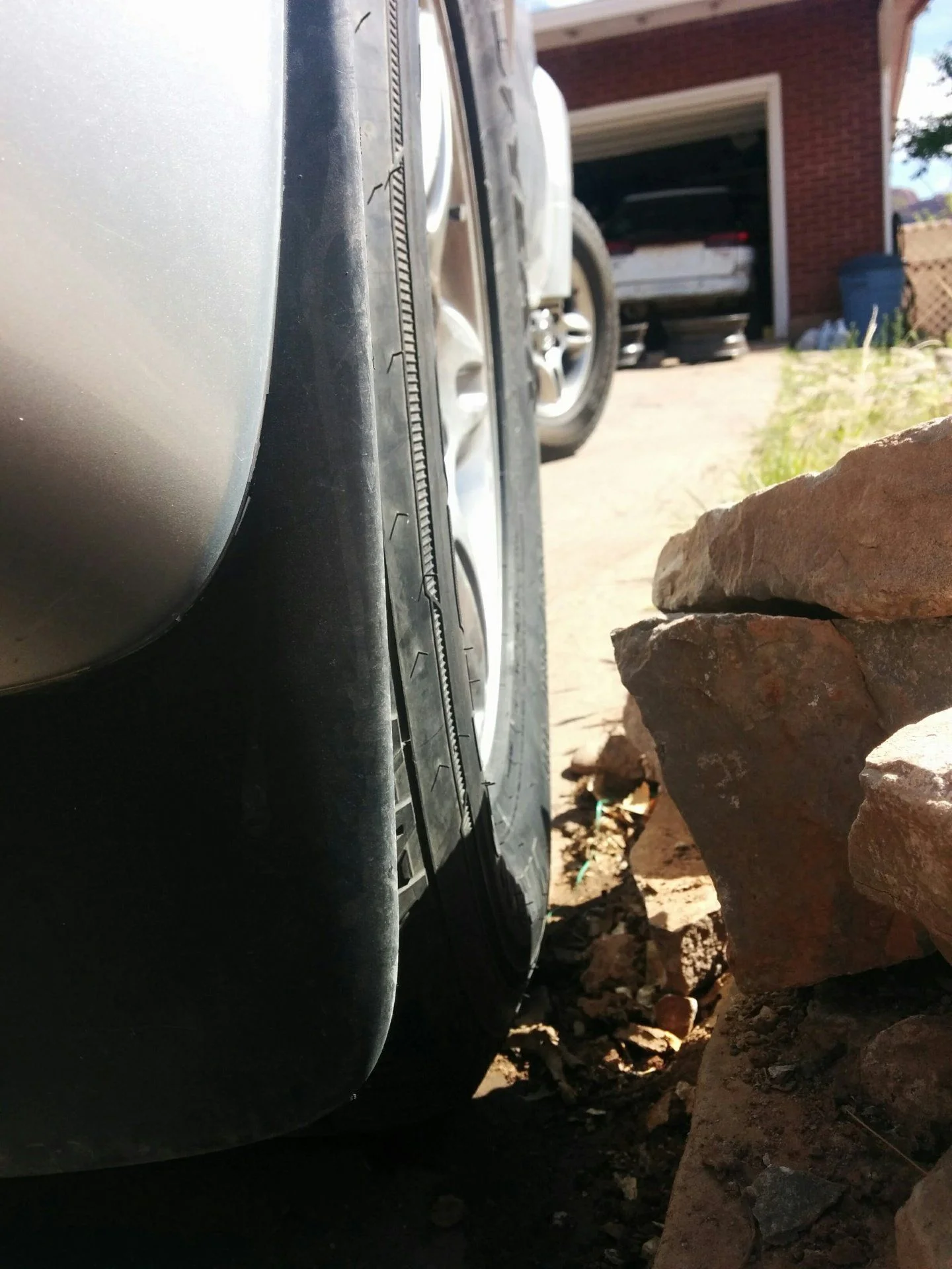

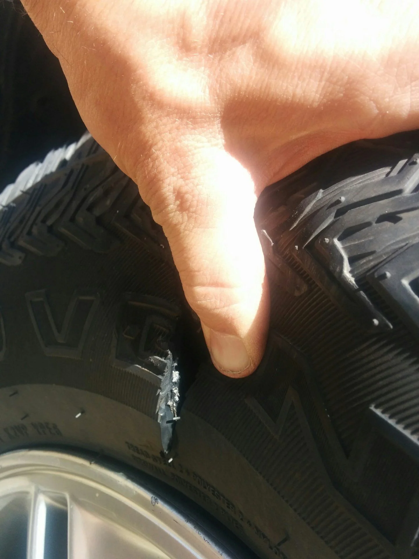

I've trailed them a couple times and was pleased, but yesterday I incurred a horrible sidewall gash...
This reminded me of the promo videos of the new BFGH AT/KO2 (check in at :40 of this clip) and I thought longingly about those. I've blown sidewalls on my Grabber AT2s as well... apparently sidewalls need to be tougher in Moab. :bang:
The good of it is it wasn't on trail, so changing it was easy, and bad of it is it wasn't on trail, so I wasn't having fun.
IT WAS IN MY EFFING DRIVEWAY!!! :crybaby:
So again coming from Subaru land, the blessing and curse of AWD. blow one worn tire, buy four! :cool::mad:

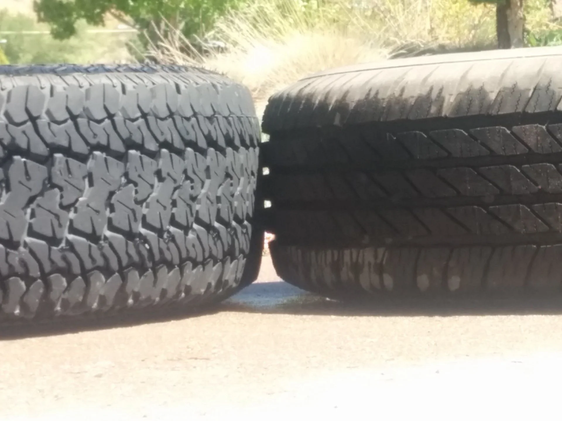

I'm working on finding a used with similar tread wear/circumference for now, and looking forward to Memorial Day tire sales. . . .

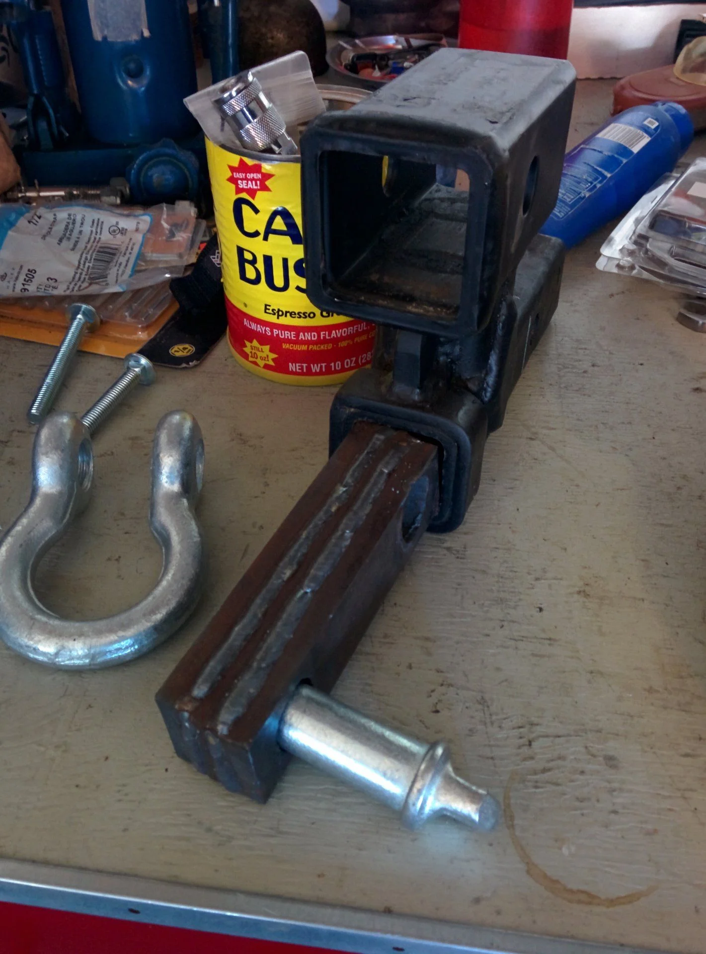

I built a hitch riser.
This was inspired by a White Rim trip. So have the bike rack, AND a recovery point, and sure one can buy all this stuff, but hell, what a fun project to MAKE it...from scrap on-hand! :cool:

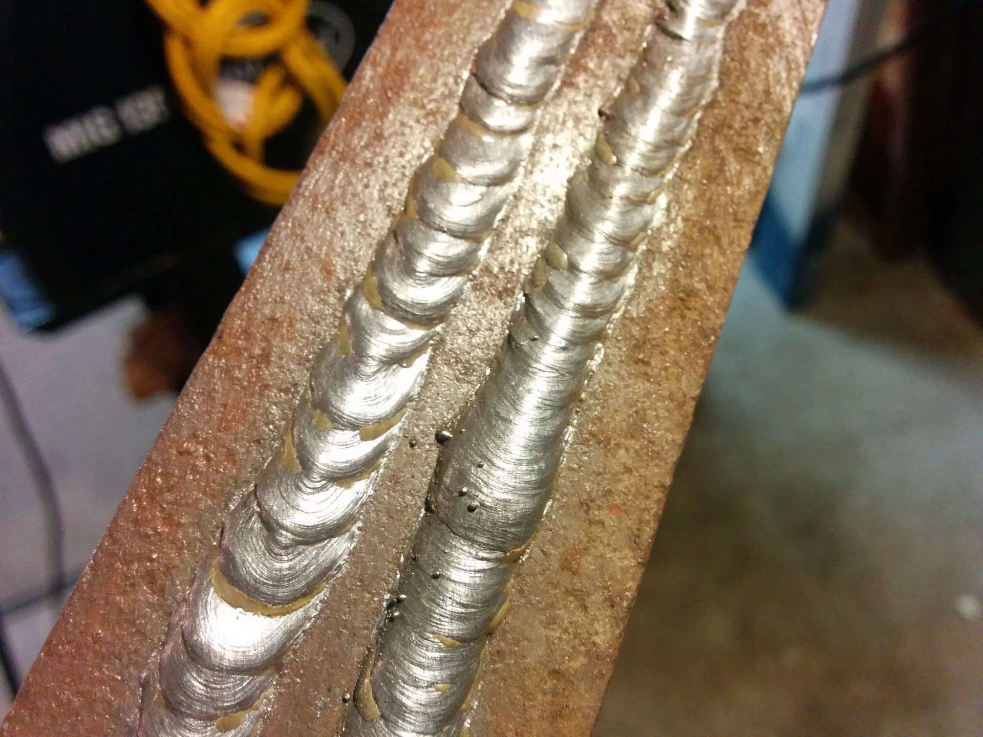

I know, I know. the gusset is on the wrong side. ;)
I was eager to stick metal together that night. So it goes. :p
I've pulled a car around the block and up my driveway with it, but a real-world extraction... uh, my confidence is mediocre to okay for the guy behind me. . :barefoot:
It looks good, but I'm not a trained welder. . . paint it black and it looks rad mounted. Plus, mounted is a good place to store it too. :clap:
