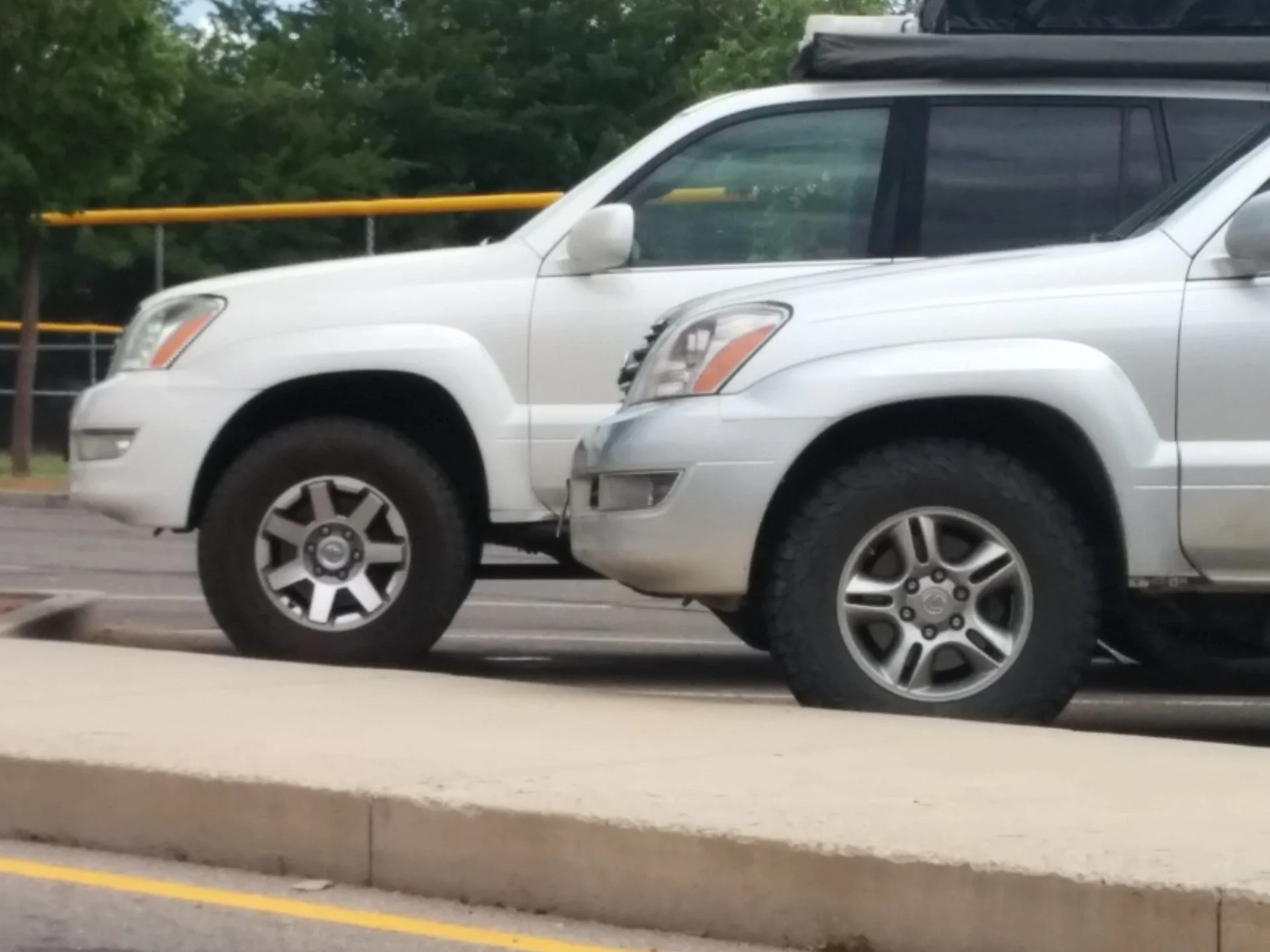

I did not keep written records but mental averaging I was north of 16.5 MPG all told for this trip; but with the oversized tires my calculated avg MPG for the trip was around or over 17 MPG.
I reset the MPG calculator when mounting the 31.5s (265x70 17 LT BFGs) and it now reads 16.7 MPG avg; that's 4370 total on the BFGs, and with 3.4% difference, my calculated 4370 mile average is 17.268 mpg. Over half those new tire miles are on this road trip, but that's pretty good!
We had a roof box too.

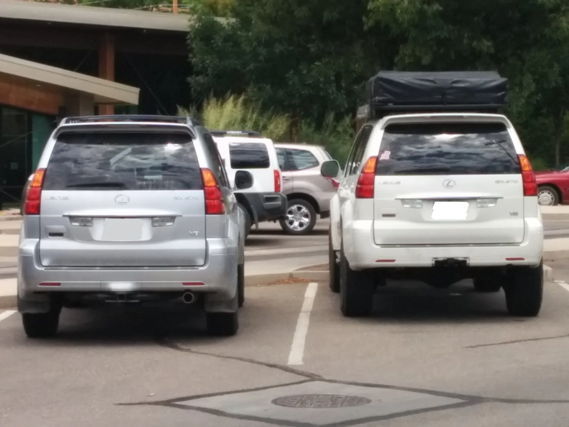

here was our configuration.

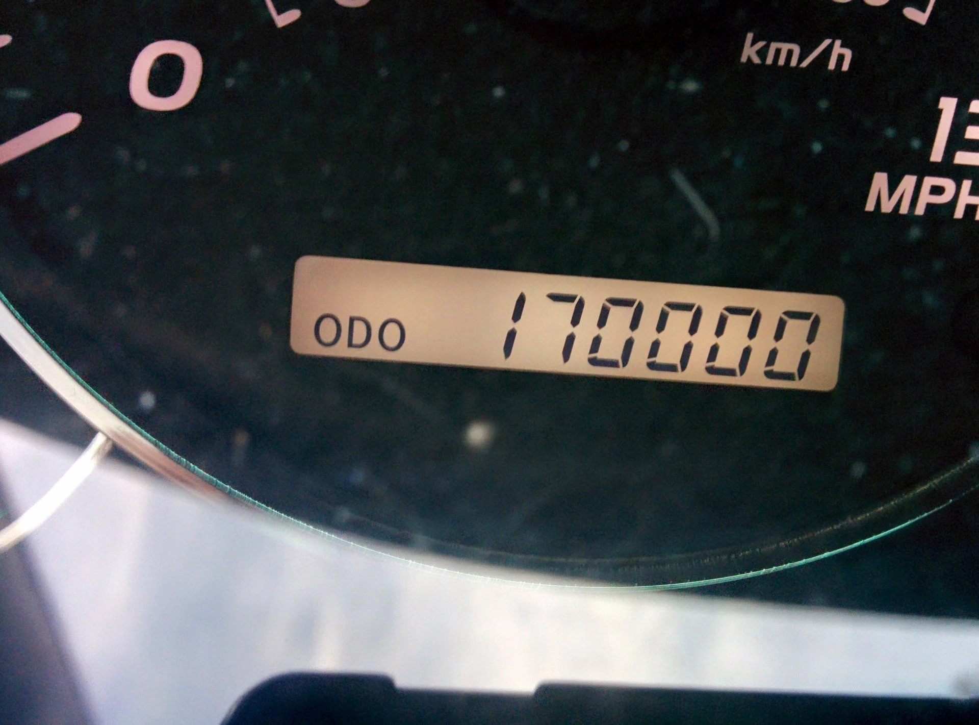

I've got about 167K on this 07 sport now and when scanning the service history (I'm 3rd owner, 2nd had it a year or so and a member here (thanks again Bruce! :)) I think there's record of the trans fluid bing dirt but never changed. I think there's record or the diff fluids changed around 30K.
It's a sealed unit (as we know), and "lifetime" fluid Read: 100K. So I'm looking up FSM procedures and it looks simple enough as a drain and fill 9some details in there like heating to temp and overflow drain, etc. etc.) which (aslo per svc info at a yota dealer) yields 3.2 qts.
So there's the drain and refill idea, yielding 1/3-1/2 new fluid mxing with the remaining dirty stuff, and do that drain and fill more frequently than the 100K interval (opinions saught here... drain and fill on 5K oil interval or more like on the 30K interval?)
Or the power flush idea: this (AFAIK) is a dealer service. This expresses ALL 6+ qts (the remaining not yielded in a drain and fill is harvested from torque converter), flushes the crud caught in the filter OUT (per yota svc tech) and then the whole magic box is refilled with luxuriant new red awesomeness...
I only bring this up because A: i've got close to 170K on this rig; B: I started noticing some downshifts and 3-4 shifts occasionally on our big road trip...previously shifts were (save looking at the odo) unnoticed...; AND c: i WANT THIS RIG AS SUPPLE AND SMOOTH AS EVER FOR EVER! :cool:
