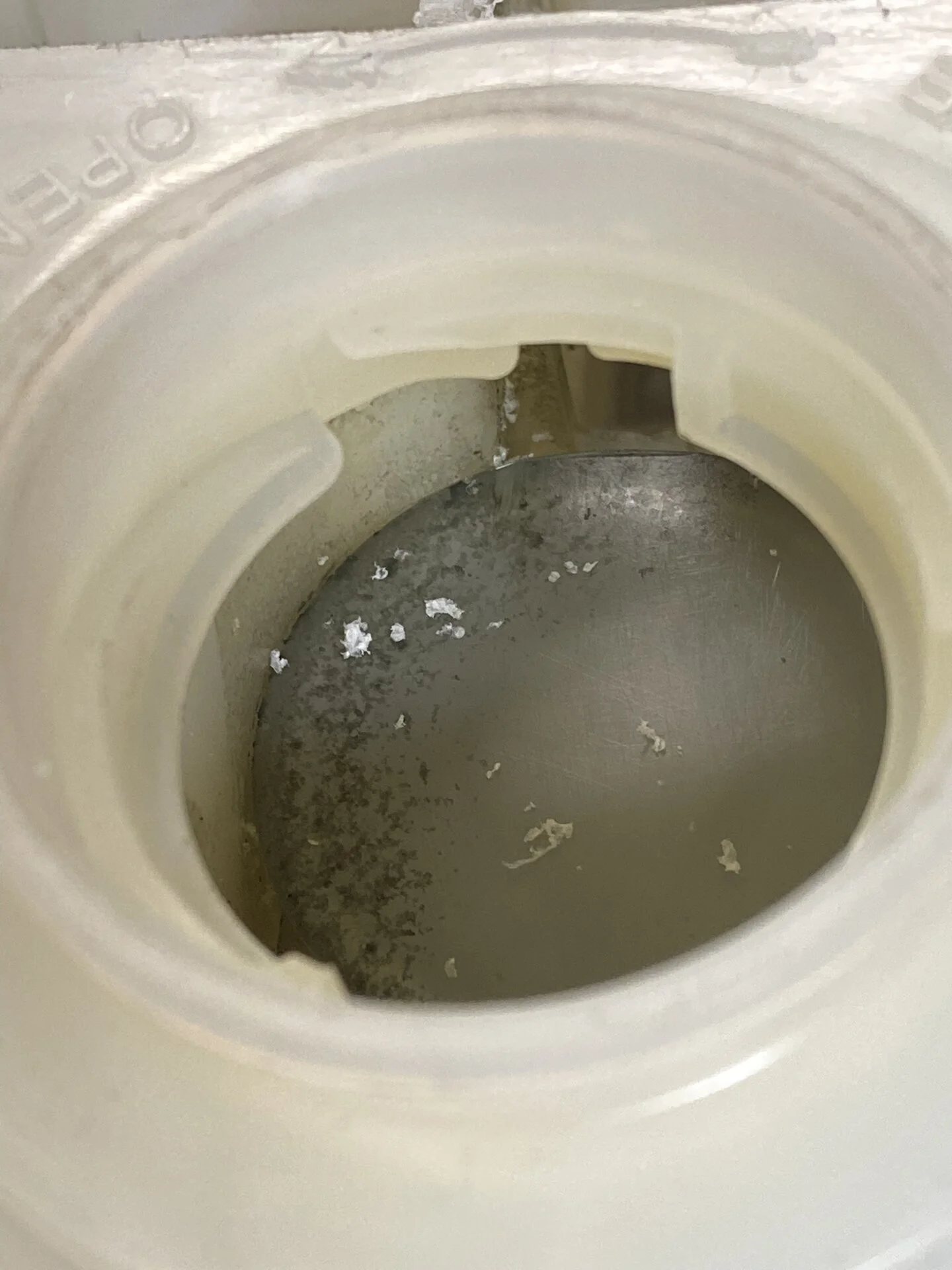

Keep in mind it's very difficult to suck out all the brake fluid from the reservoir with the filter in there. You may get half if you're lucky

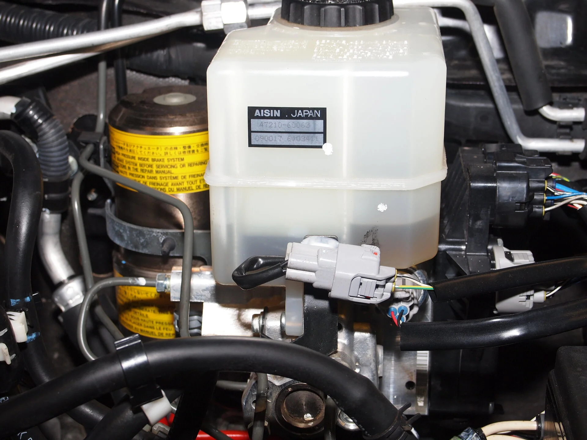

Only one good way to clear/clean out the reservoir tank; With IG key ON, hold down brake pedal, open a rear caliper bleeder.
Once reservoir very near the bottom. Close bleeder, turn off IG key then pump brake pedal 40 times (empties accumulator).
Accumulator dumps fluid back into to reservoir as you pump brake pedal with IG key off, to about level seen below.
Now add new Toyota brake fluid, doubling the amount currently in reservoir. (50/50 mix of old and new)
Now again clear/empty reservoir though rear bleeder. Repeat this 5 times.

Which brake line is the shortest length from the reservoir to the bleeder? Draining the reservoir using that line would get the old fluid out of the reservoir via the most direct route. Less brake line for old fluid to travel through.
Driver side front!

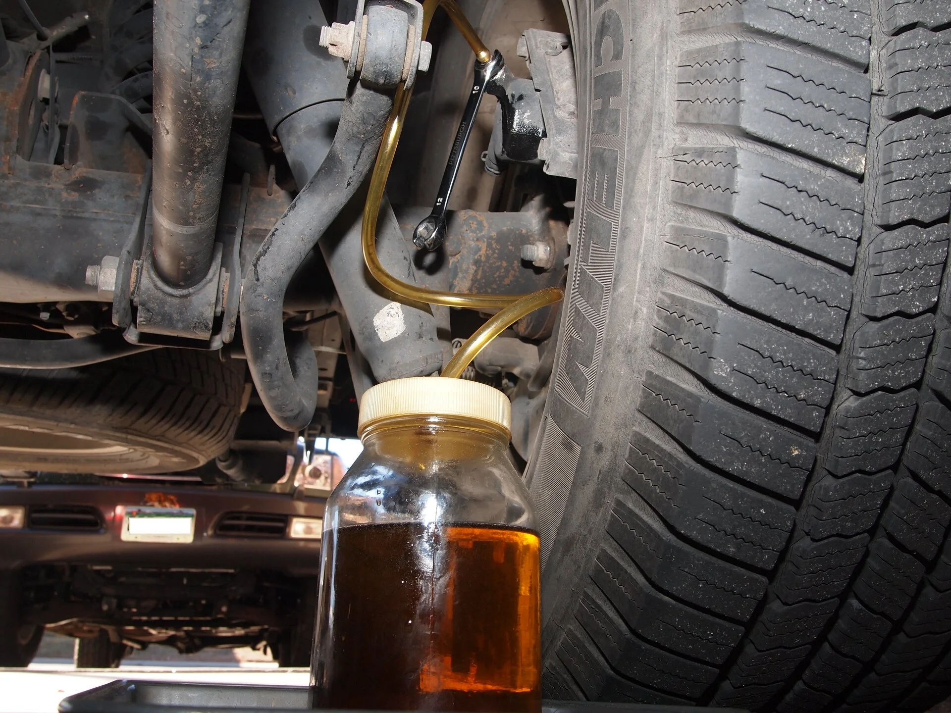

Drivers front is shortest by distance, but the rear calipers bleed so much faster (can bleed continually rather than press-release method) that I have used rears as the initial drain point. The fronts are then quick and easy to do with a second person using press-release-repeat.

What I mean is that when I bleed front brakes on my 100 or other vehicles with a similar HBB (late 3rd gen 4runner, LS430, etc) I bleed the fronts the 'conventional' way that I would bleed vacuum boosted brakes: pump pedal three times, hold pedal in depressed position, crack bleeder for 3 seconds or so, close bleeder, repeat. If the bleeder is kept open, the pressurized stream of fluid only lasts about 5 seconds. After those 5 or so seconds, the stream is slow which makes me think it would be inefficient and risk air entering the system if I were to leave the bleeder open to drain.
When I bleed the rears on my 100, I simply depress the pedal (can even use a bar, brick, whatever—as there is no pumping or releasing of pedal required), open the bleeder, and the brake booster will pump out fluid as quickly as the bleeder valve can handle. When the reservoir runs low or the fluid runs clear, I close the bleeder valve and add fluid to the reservoir. The fluid remains pressurized so long as there's fluid in the reservoir and the HBB pump motor is running.
It would take me dozens of pump 3x, hold, open bleeder, close bleeder, pump 'er back up cycles to drain the reservoir completely, it takes far less time, effort, and helping hands to drain the reservoir via the never-ending fluid pressure at the rear calipers. I do not know the true reasoning behind this, but I suspect it has less to do with gravity and more to do with how the ABS circuits are designed, but who am I to guess! If you want to gravity bleed or use a power bleeder, then yes the shorter line run of the fronts would likely be preferred and you would not rely on the HBB motor and pump to do the work for you.

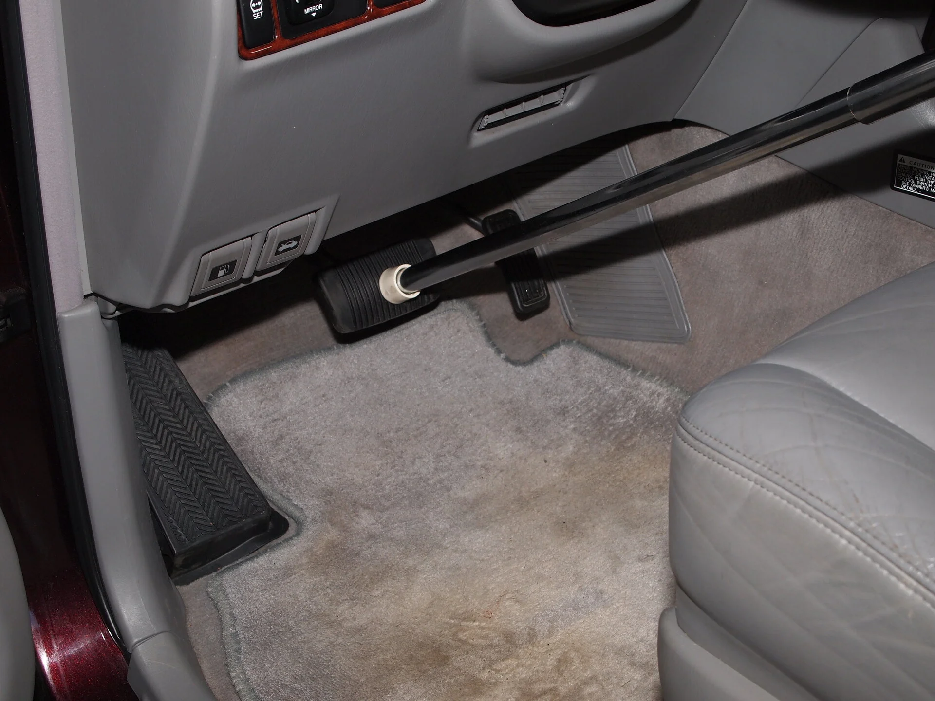

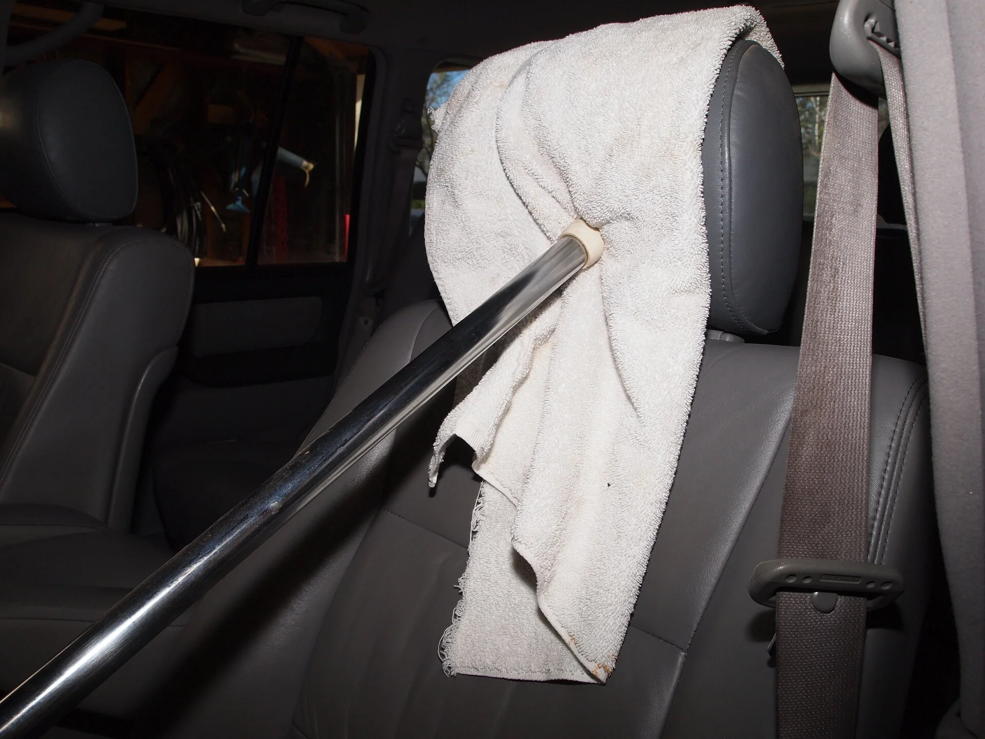

I do the rears with my "little helper"
Fronts are better to have a second person to help.
"My Little helper" is a spring loaded shower curtain pole. Works very well for rear. Since rears continuously flows, as long as brake pedal held down and IG key ON (booster pump running). My little helper, can be used for front also. But requires getting out from under vehicle about 17 times, to pump pedal five time and reset it holding down the pedal between each bleed. Note: booster pressure does not work to continuously flow fluid out front bleeders, as pedal held down.

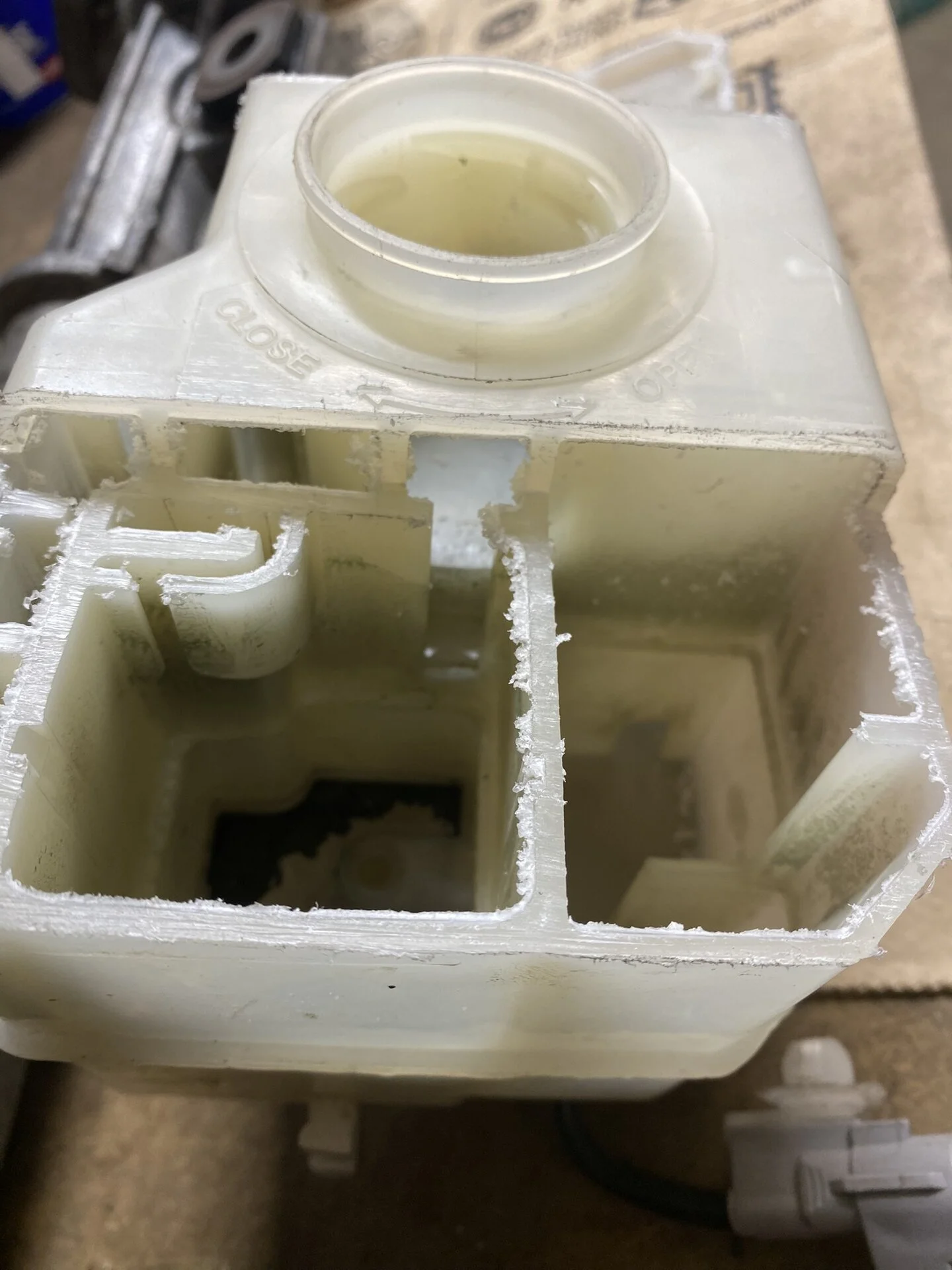

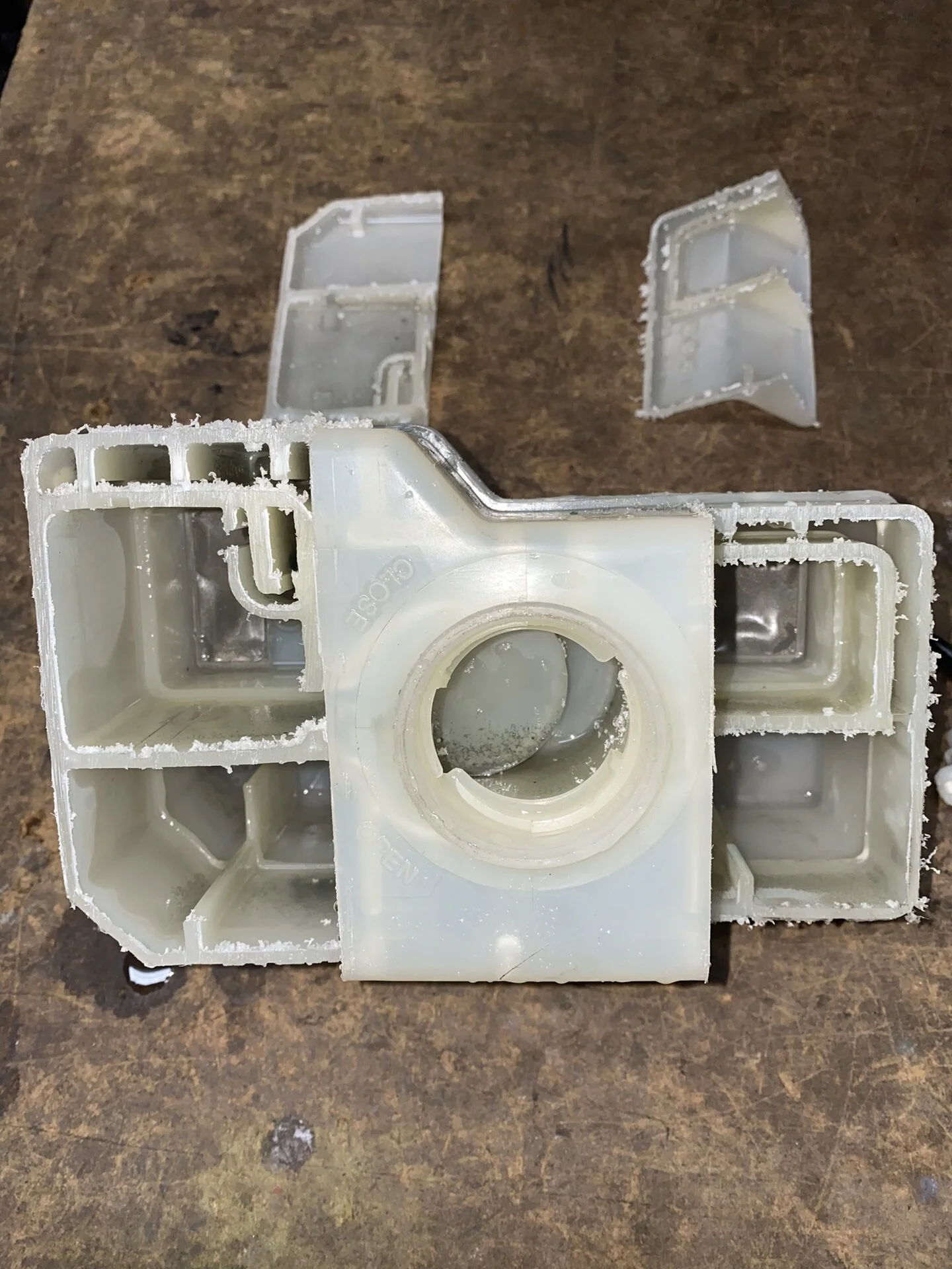

You may find these interesting:
What are the final cut open reservoir pics showing?
