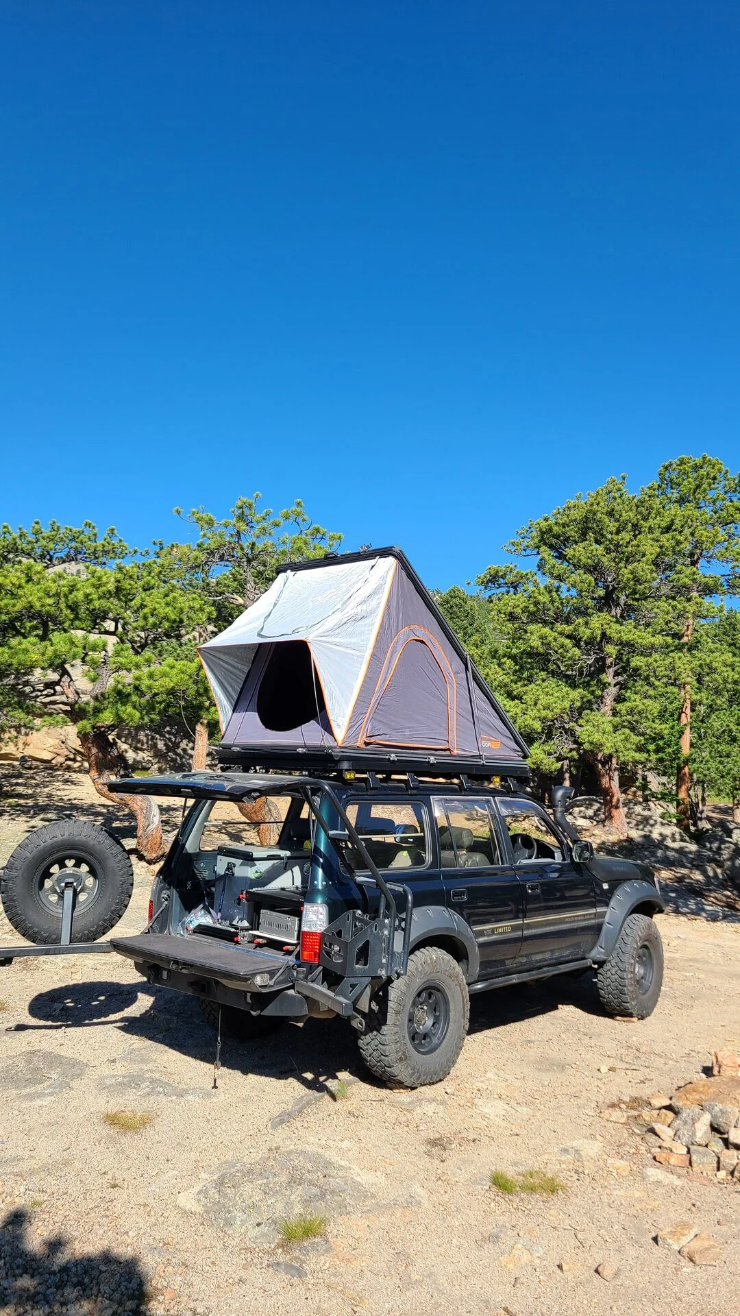

I had 701s on my 80. They are NOT plug amd play. You either need spacers to fit as the inner bore has a raised lips that retains the center cap. The wheel need either a spacer to avoid interference with the lip, or the lips needs machined to the main bore diameter. I has spacers to make the wheels work, but had rubbing on my flares, so I went back to oem wheels.
Wheels are for sale, as are spacers, in Colorado.
In this shot you can see that the end of the axle hubs come right to the edge of the wheel bore. The lips I speak of is actually touching the hub nuts. The authentic looks nice as the wheels come out to the edge of the kut snake flares, but I'm not much on form over function.
Good to know! You didn’t want to machine them?
First challenge I had is I didn't want to pay to unmount the tires and need to find a machine shop with a lathe with enough swing to machine the lip. If I didn't love them afterwards, they would have been modified and harder to sell.
Second is that the lip inside the oem wheel is very close to the same height. The main difference being the serrations the grip the tire lip. I've run tire on oem rims at 8 to 10psi without losing a bead, so the value of the feature is lessened in my head.
