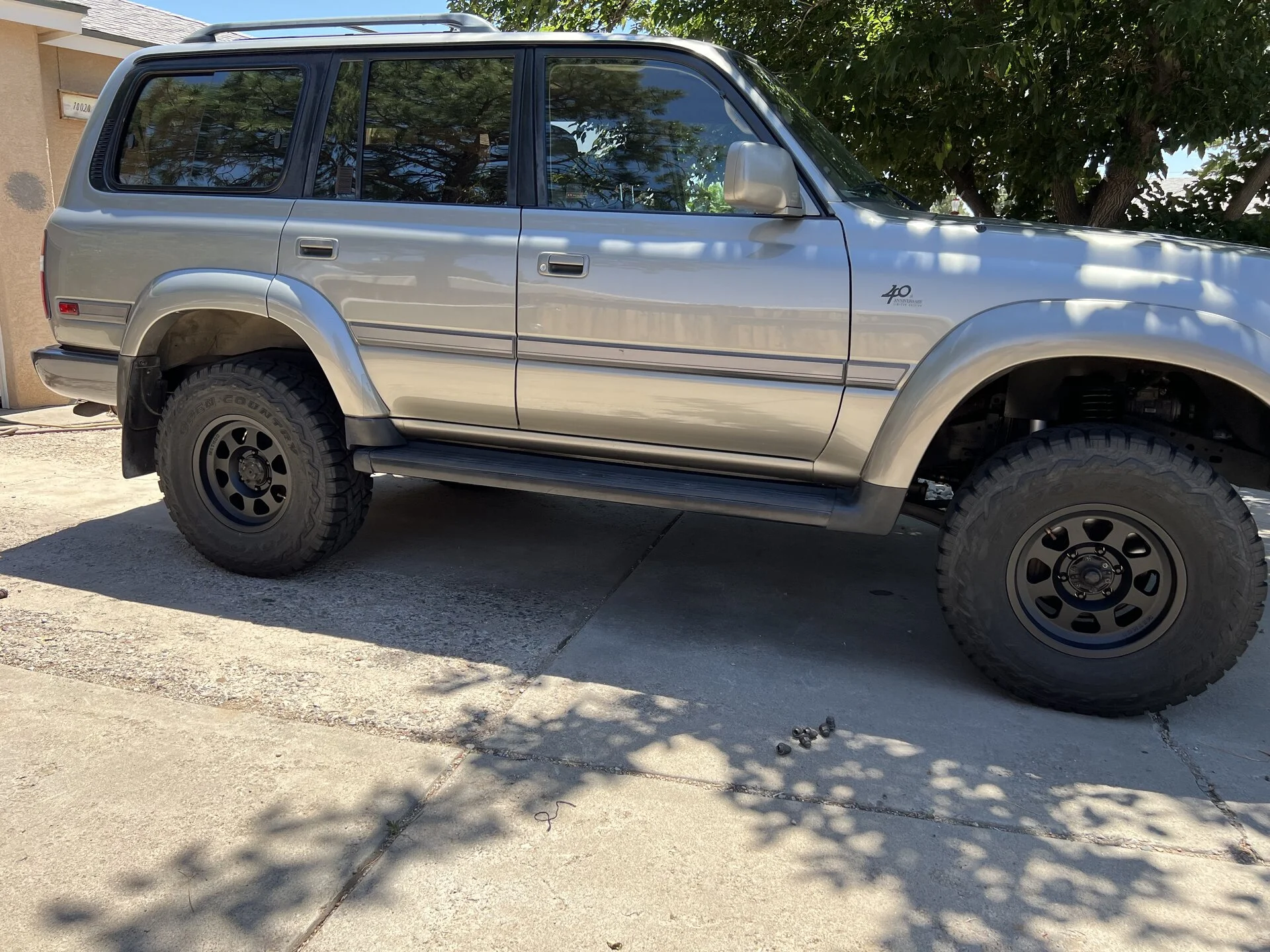

Here is mine on 105s and 37" SXIIs. I am running a 1" spacer also. They were a little bit tight flexed out, and the 1" made them perfect. Very minimal wheel well rub front or rear now. Since this pic, I also stepped down to a 2" spring.
Ive looked a little bit into adding center caps, just havent gotten that far yet. Hopefully someone else has done this for some ideas.

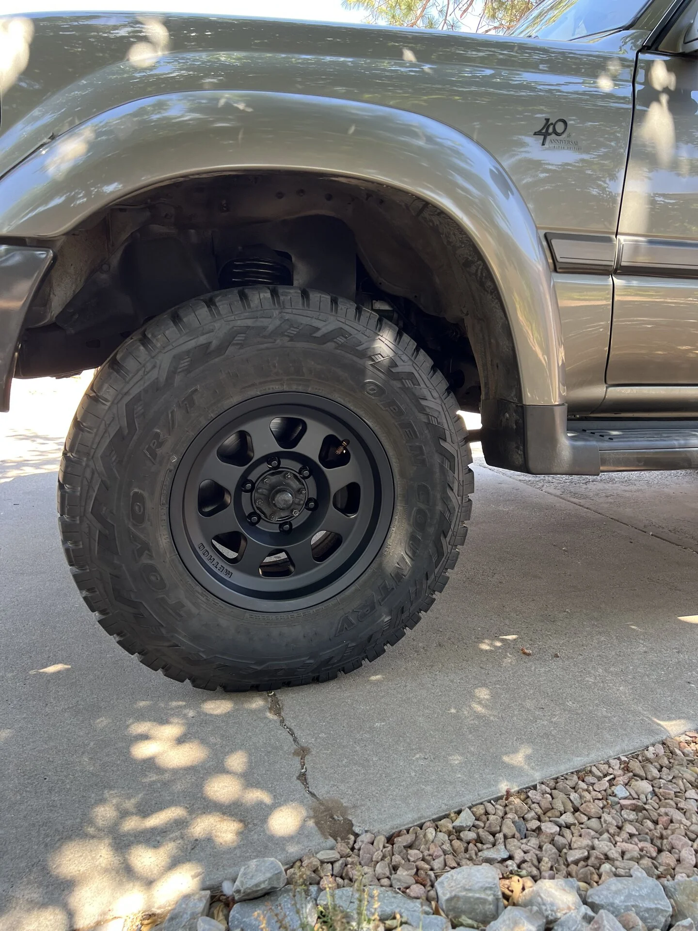

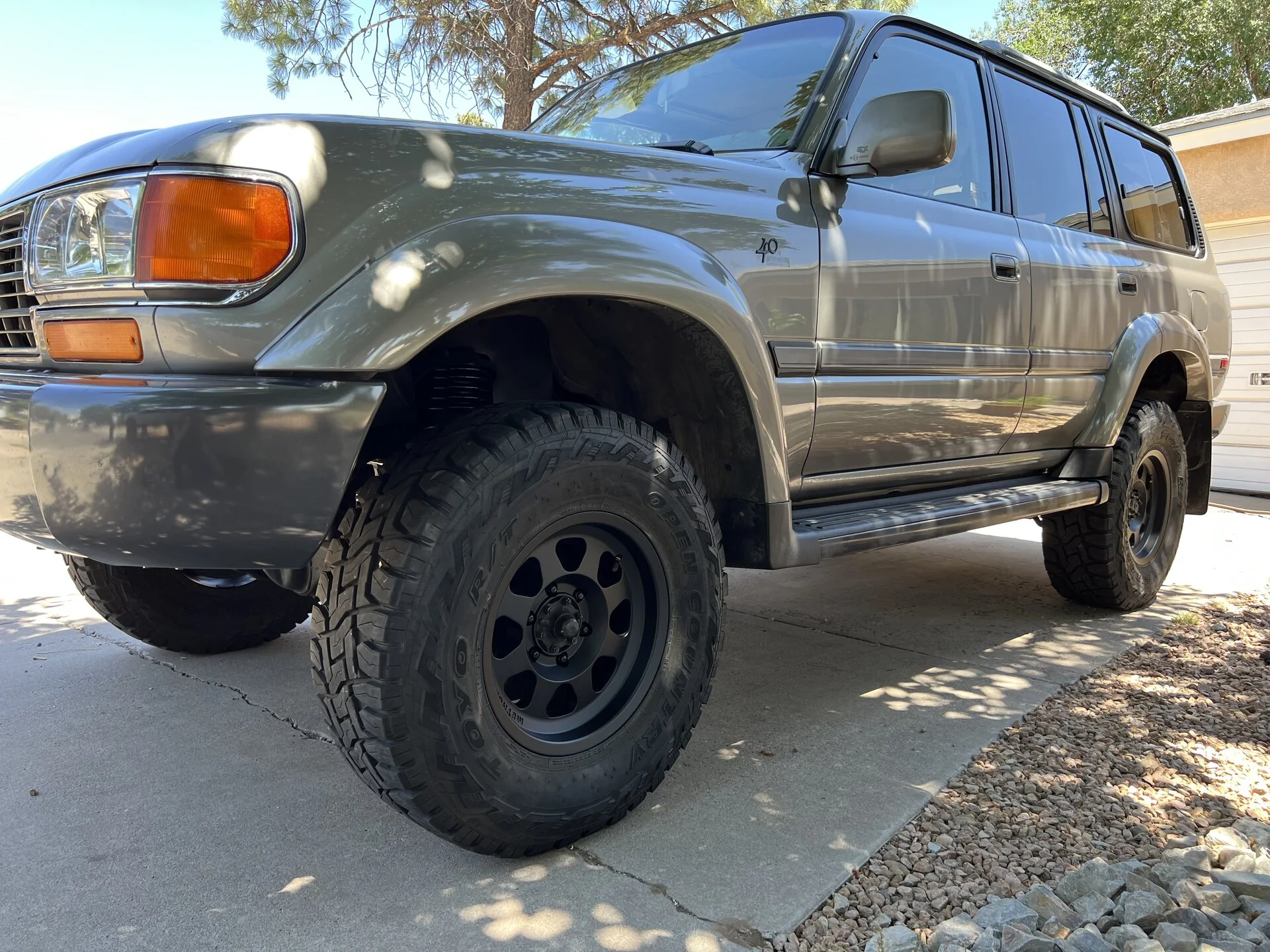

Method 701’s. Machined the catch ring for the center cap to fit.
Good to know you can run something like the 701. Sucks that I'd have to find someone to machine them out a bit. But I like the idea of running the light weight wheel with the beadgrip tech.

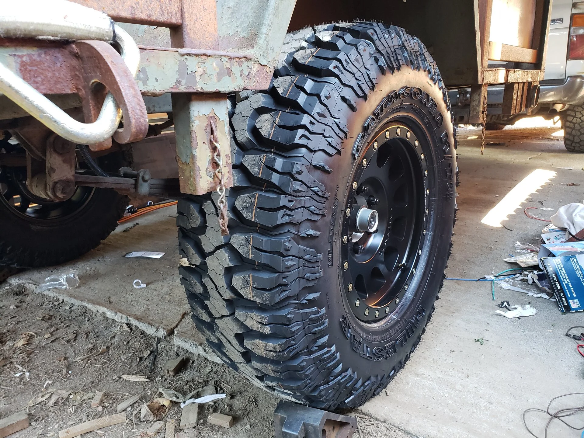

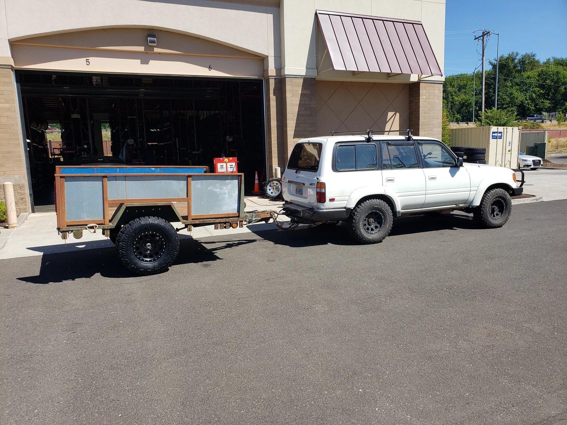

So... my rig has the MB 352's, which are Method MR305 knockoffs. I recently was trying to find two more for my trailer and they were discontinued, so I had to buy the Method MR305's. So yes, my trailer has the real ones and my rig has the knockoffs haha. I was able to get the front cap on my rig, but not on the rear. I haven't tried fitting the real methods onto my rig, but I'm assuming it's the same. And yes, I put bags on my rig last night, so no more sag.
