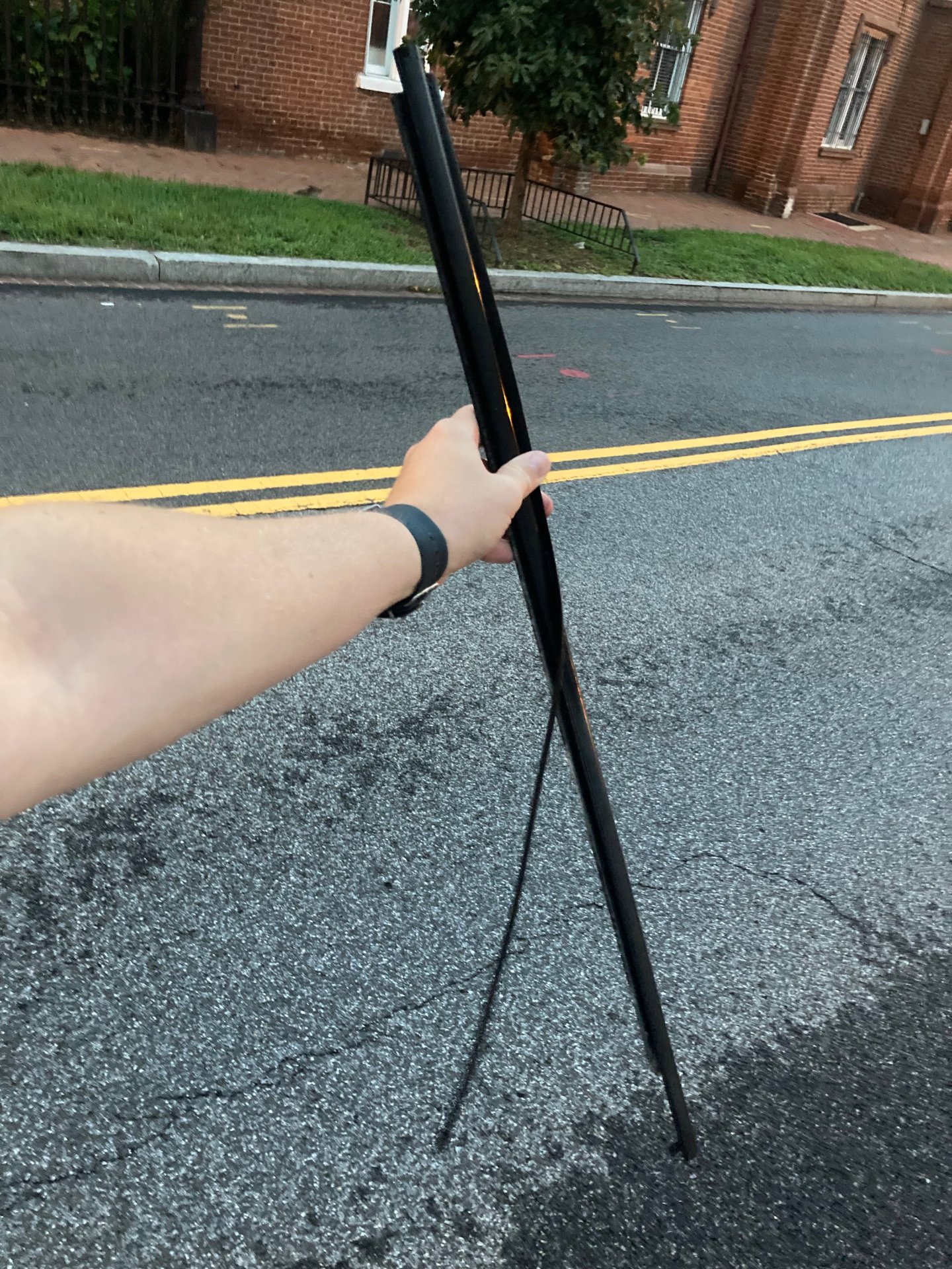

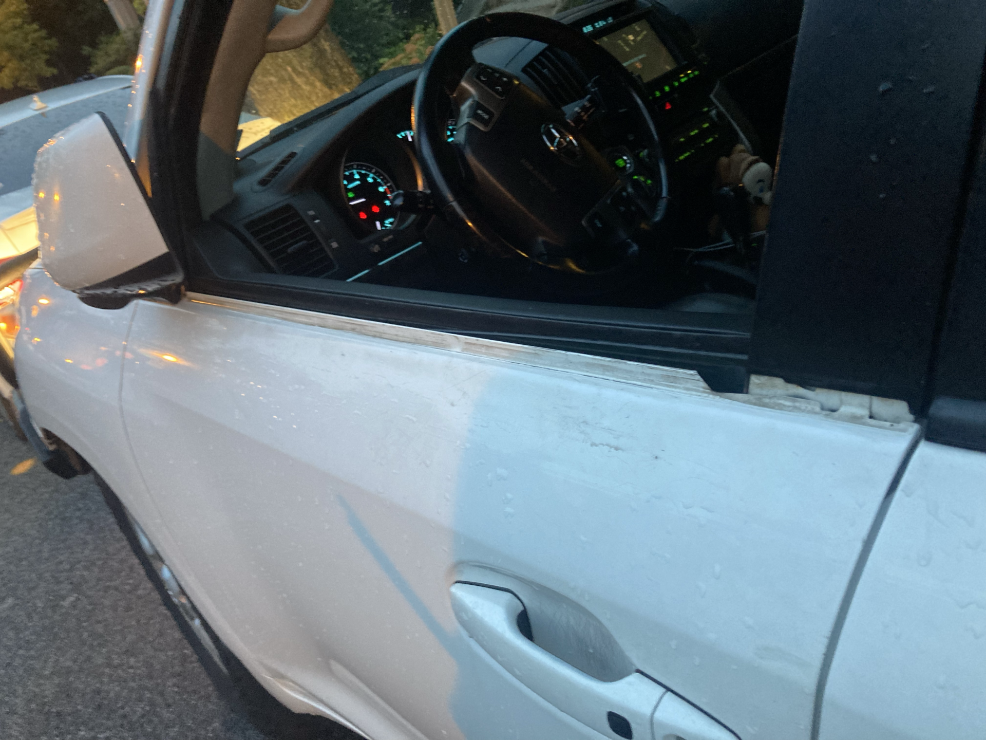

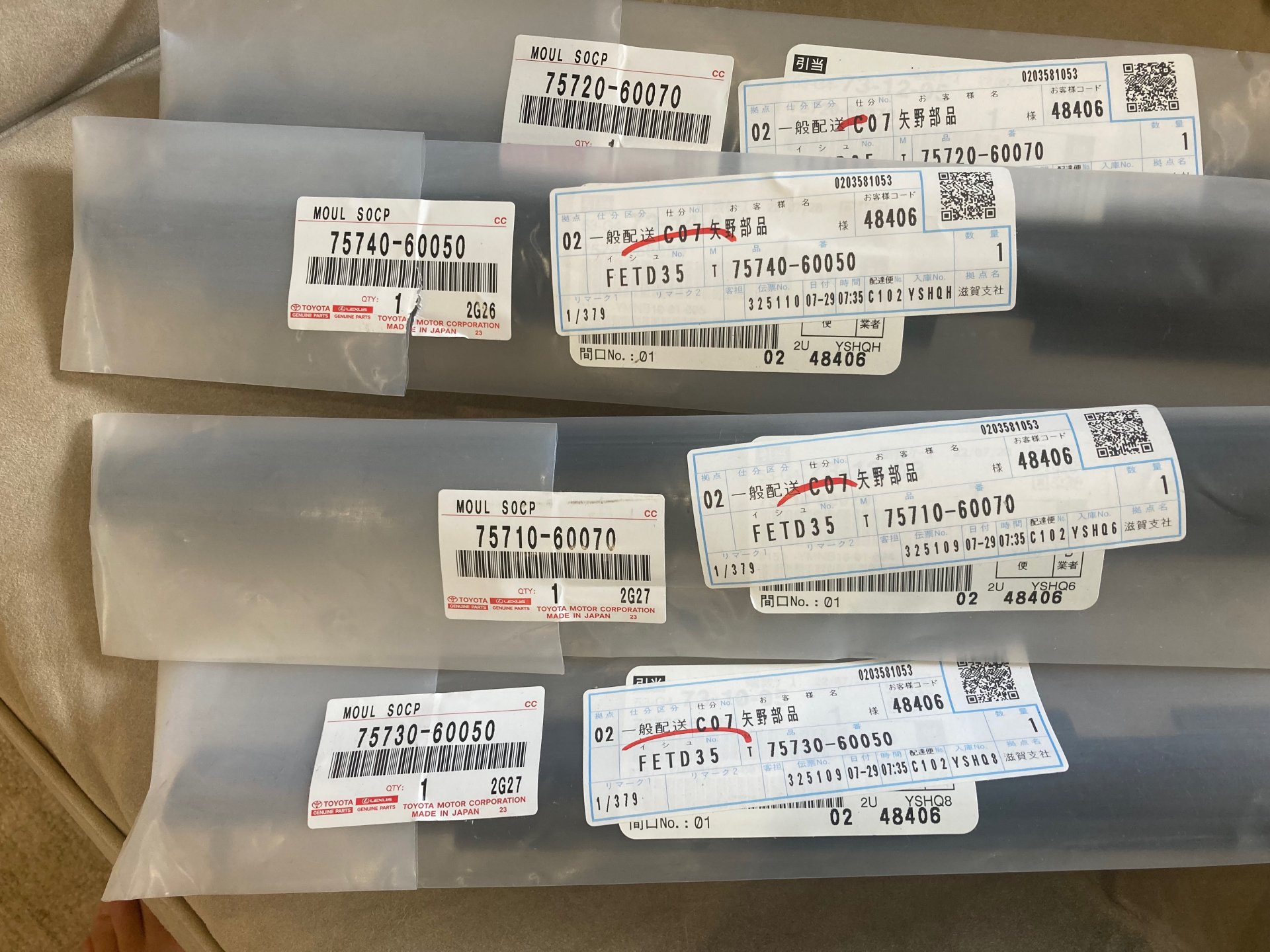

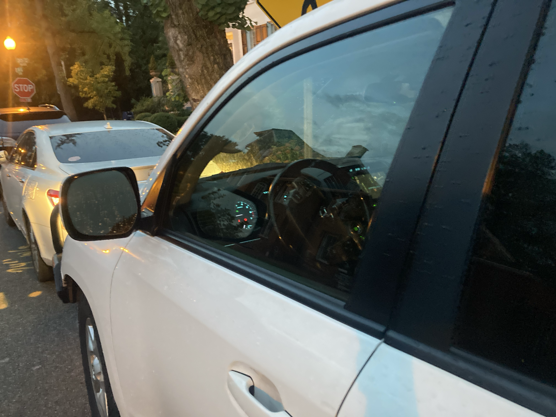

Replaced Door Belt Moulding for all side windows. Sourced from Japan. 1/2 banana job to pull off old ones and replace. Maybe even easier than some wiper blade replacements. Just pull to remove and the new ones click in easily. I find the new window moulding to be super sexy. Pro tip- roll the windows down first.
Toyota Part No.
75720-60070
75710-60070
75740-60050
75730-60050
Toyota Part No.
75720-60070
75710-60070
75740-60050
75730-60050
did you wipe down and clean the underside before putting the new ones in? My OCD is dying to know!!
Of course! We're not barbarians.

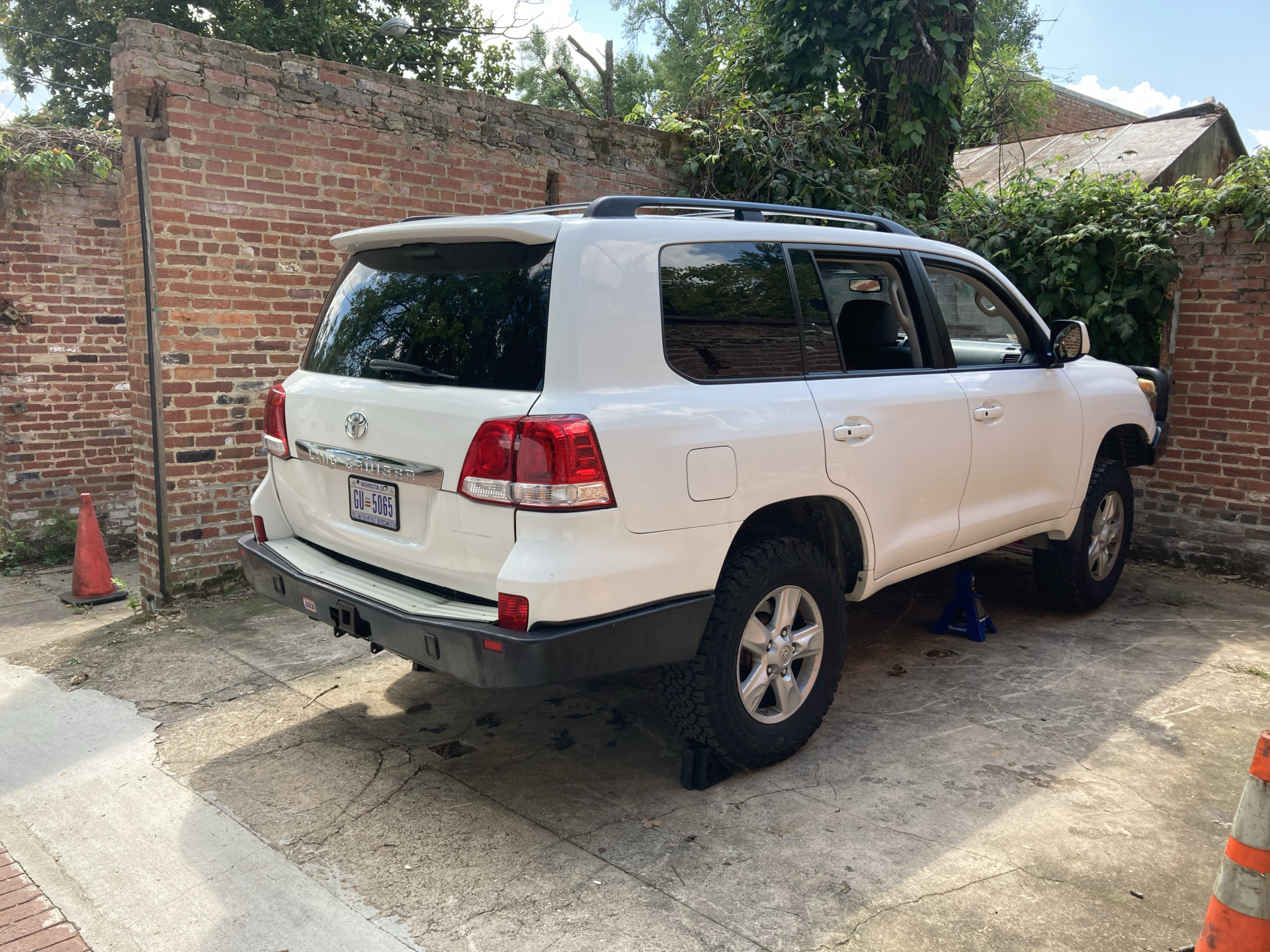

I actually did remember to chock the rear wheels after taking these pics of my secret vacant lot back alley wrenching location. I'll pretty much have to sell my condo and move once they start redeveloping this property behind my place because I won't have anywhere on the block left to wrench- I was going to rent the work spot from the old guy who owned it, but he passed away and the property got sold to developers this year. Pre-pandemic I used to wrench on base, I might look into that again, but I would sure like to get a house with a garage instead.
