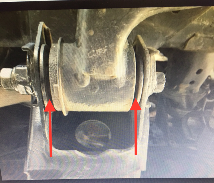

SPC sells an upgraded cam bolt with a sleeve designed to prevent this. If I had to replace mine, those would be the replacement.
Cruiser Outfitters uses and stocks them, which speaks highly of the product in my book.
"This is an OE replacement cam with a corrosion resistant coating superior to the OE bolt. This kit will not give you much over what the OE bolt will get, but will not freeze into the bushing like the OE bolt."
I thought someone may bring this up. But I’m with @04UZJ100 . If Toyota wants these bolts seized every ten years, so be it! ;)
Edit: Someone had mentioned the SPC Cam Bolts in a comment above, but it looks like they deleted the comment for some reason. I was being sarcastic above- yes, OEM is almost always a good idea- but the SPC Cam Bolts look like a smart upgrade and will prevent this issue in the future. (Edit: hearing mixed feedback on the SPC Cam Bolts so I ended up sticking with OEM)

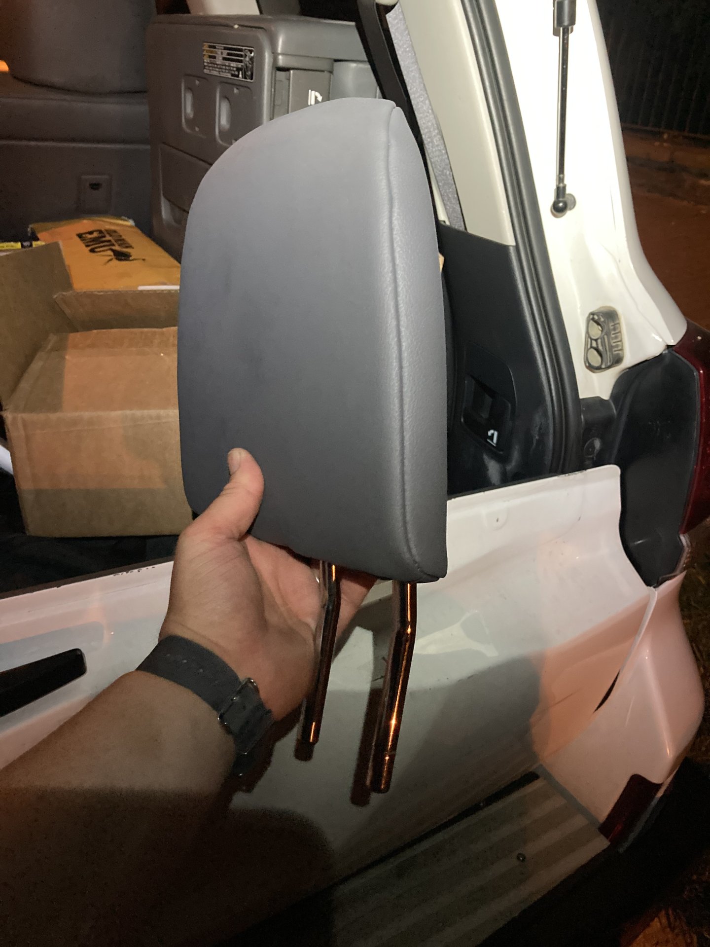

Some excitement via MUDship from a very kind MUD member. This third row center headrest was the only OEM part my truck was missing. Couldn't be happier to have this in hand. Toyota wants $500 for one of these!

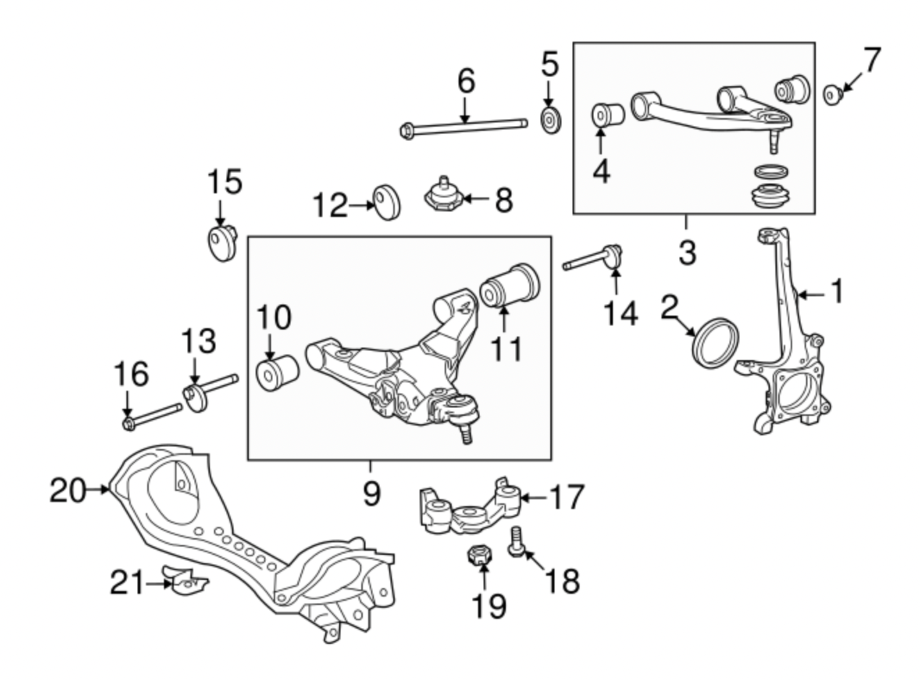

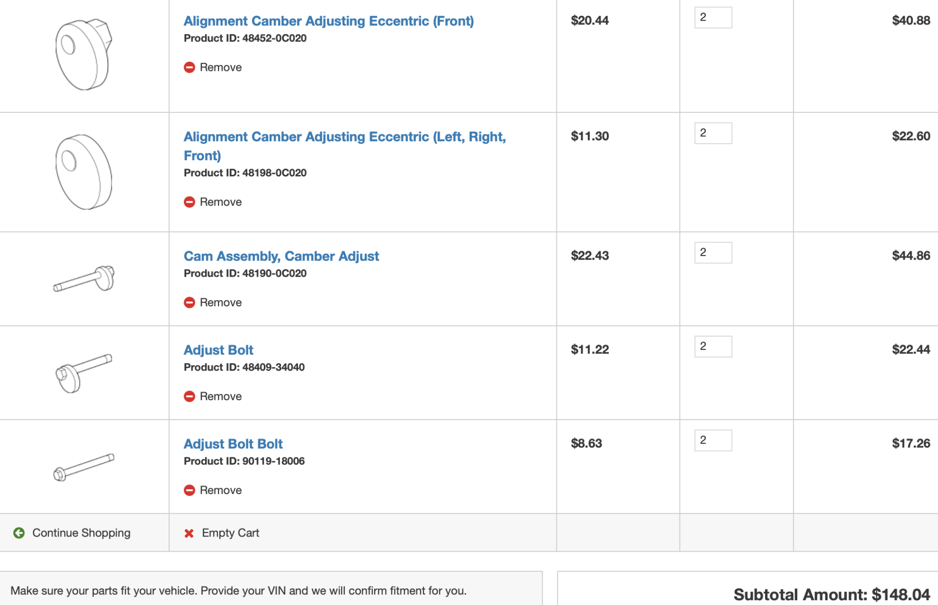

New LCAs ordered and, apparently, 10 additional Toyota parts for the related bolts. I will use anti seize on this hardware when it goes into the new LCAs.
Cutting out the old cam bolts should be interesting. I know where to cut, question is what to cut them with for quickest and easiest removal?
Let the fun begin...
New LCAs ordered and, apparently, 10 additional Toyota parts for the related bolts! I will use anti seize on this hardware when it goes into the new LCAs. I think the SPC cam bolts are a good way to go too, and time will tell if this was a smart or dumb route to go staying OEM.
Edit: I am questioning the clarity of the diagram on item 16 (Adjust Bolt Bolt - Toyota Part No. 90119-18006), do I need to order this bolt or not?
Do not use SPC cam bolts. They’re cheaply machined and do not provide the necessary clamping force to keep the LCAs from moving around. Further, they’re machined with grease channels in them which appear “functional” but end up compromising the strength of the bolted connect.
OEM and antiseize is the only way I’d go.
If you use anti-seize on the bolts they should be fine and shouldn’t rust in the future, or so my very trusted Toyota 4x4 shop tells me.
If you SAS you'll never have to worry about cam bolts seizing on you :smokin:

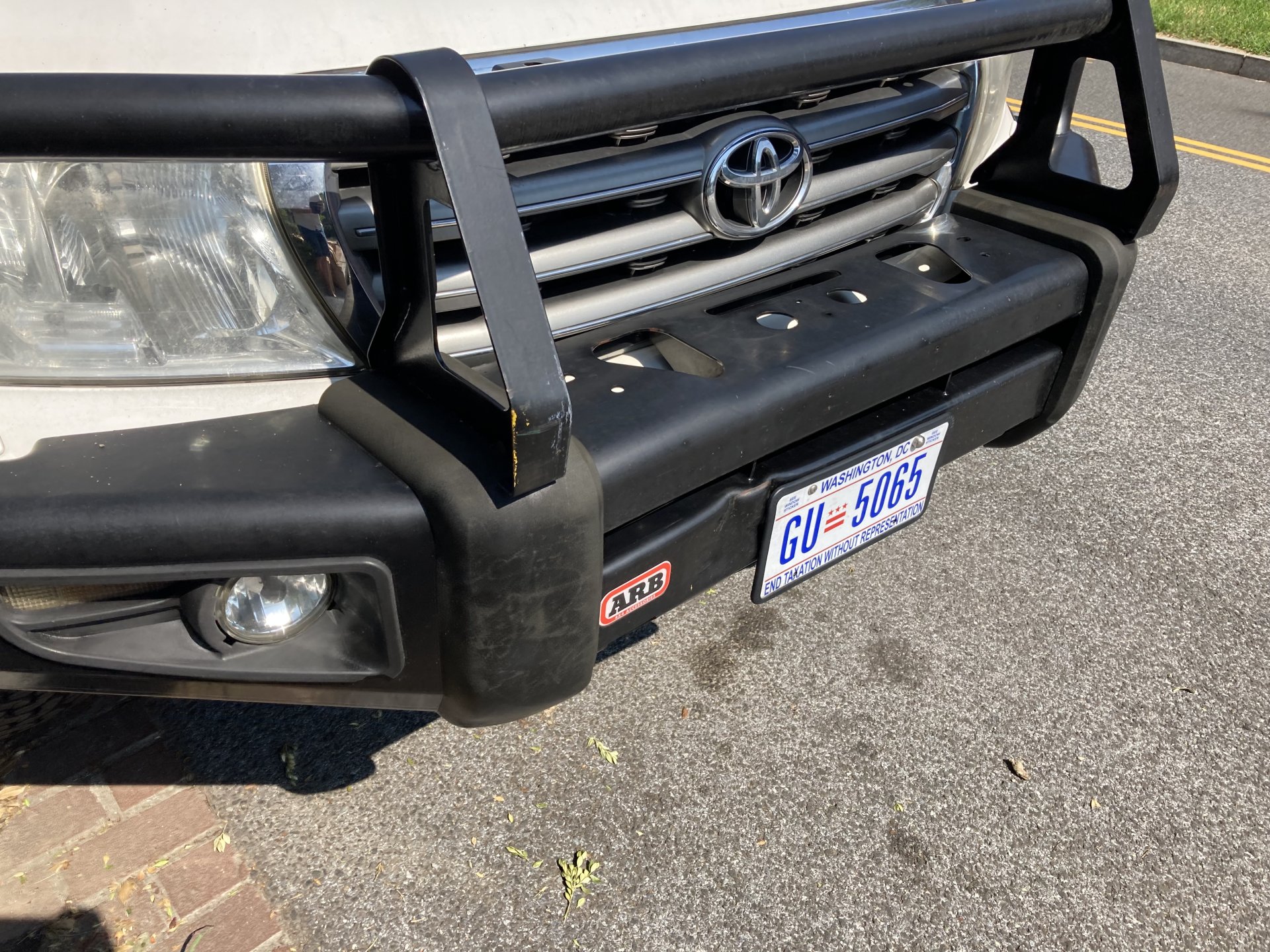

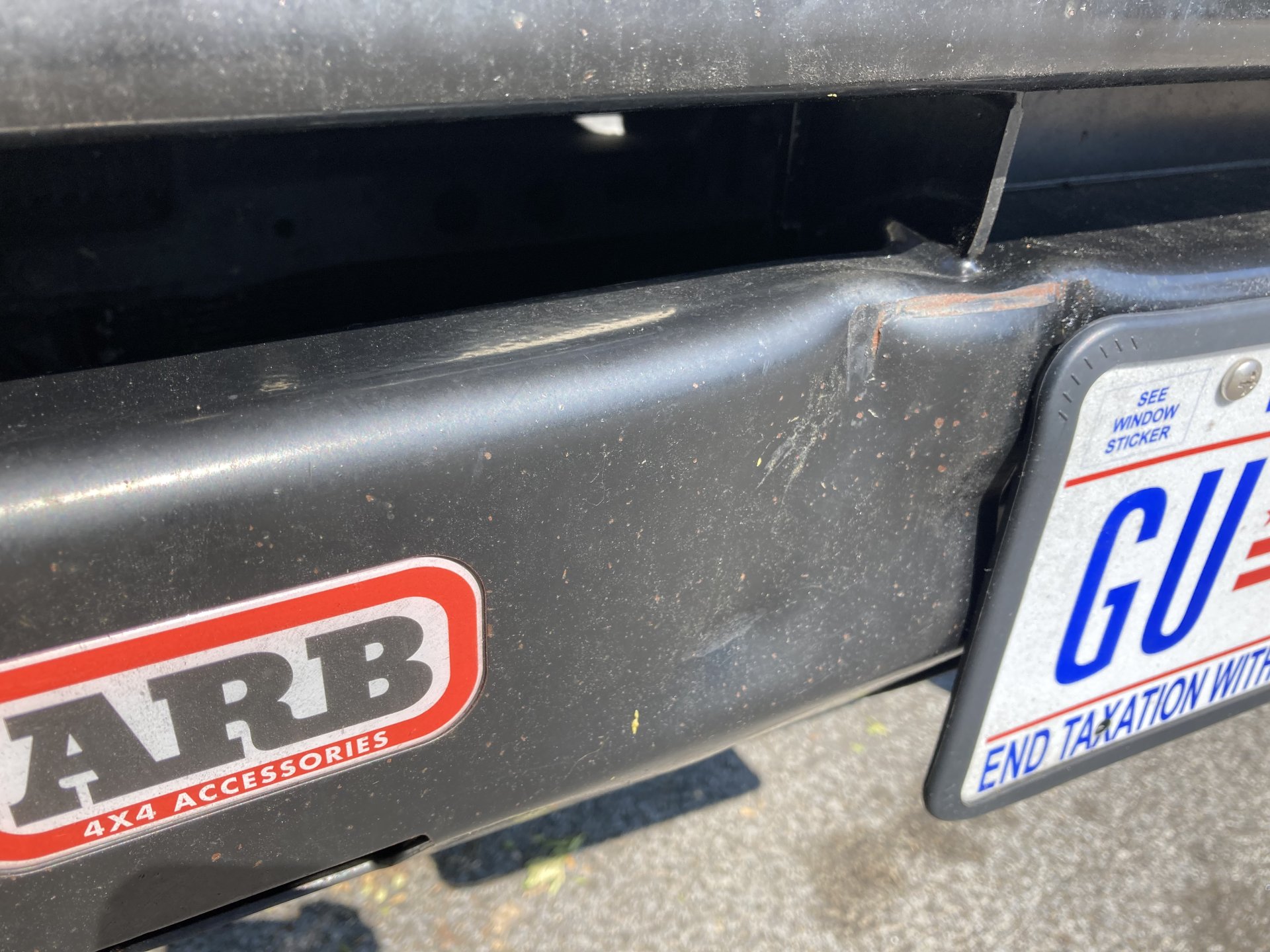

@TRDdrew and others... is it plausible to get a dent like this out of an ARB bumper? It is a wheeling rig after all, but the dent is a bit obnoxious. The PO said it was some sort of hitch impact from another vehicle on the cattle ranch this truck lived on:
@Diff Kraken is it possible? Yes. The metal is pretty strong right there and if i remember correctly there might be a brace behind the bumper right in that area. If so to repair it fully will be pretty difficult without cutting out the damaged metal and welding in a patch.
but if it is going to continue life as a wheeling rig why bother fixing it, the bumper will probably get dinged up again
It’s too bad you’re in DC where front plates are required, otherwise I’d suggest removing it and finding a wider European-style plate that says Land Cruiser or something similar to just cover it. You still might look for something like that I suppose but it would sit under the license plate.
