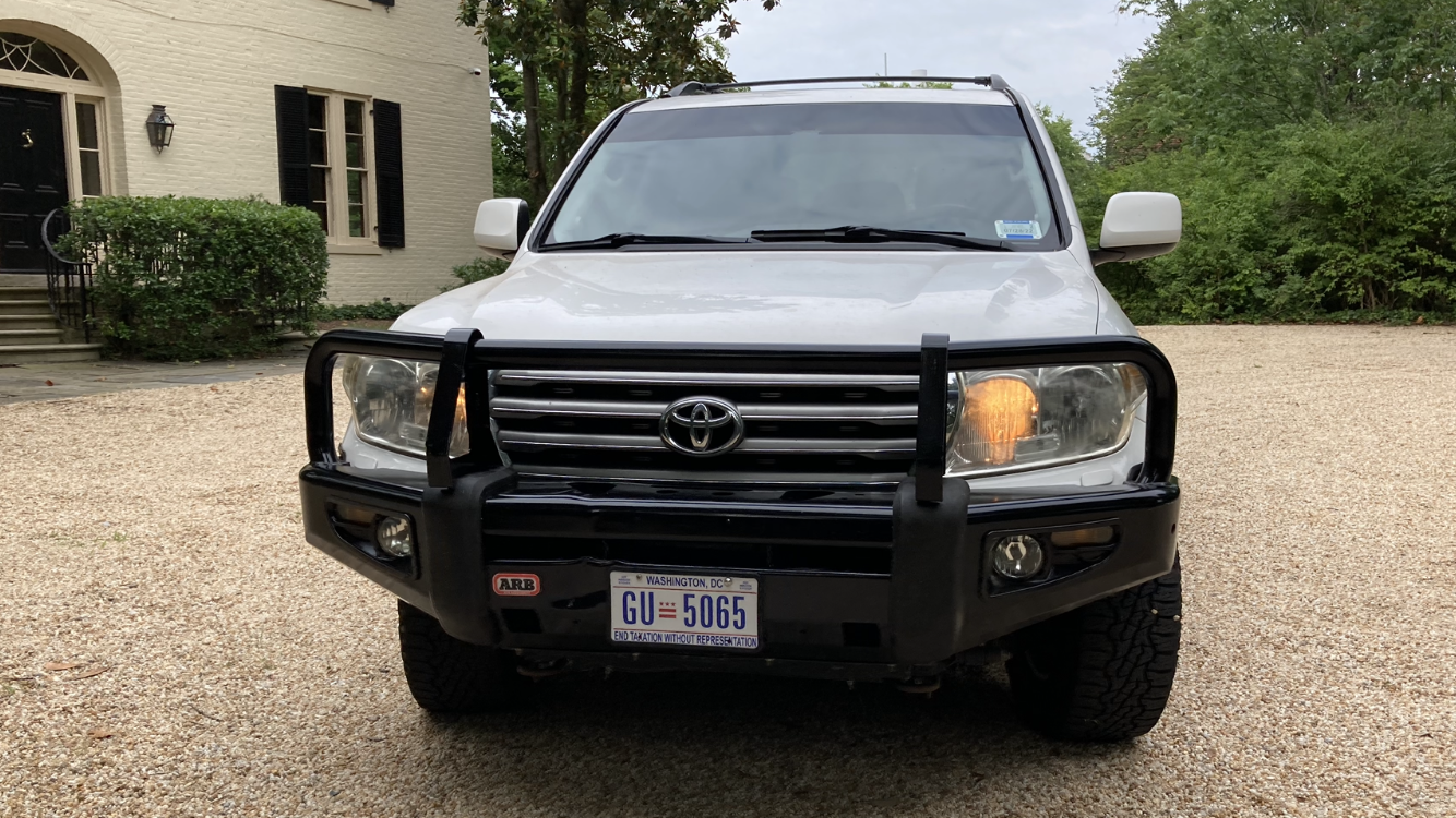

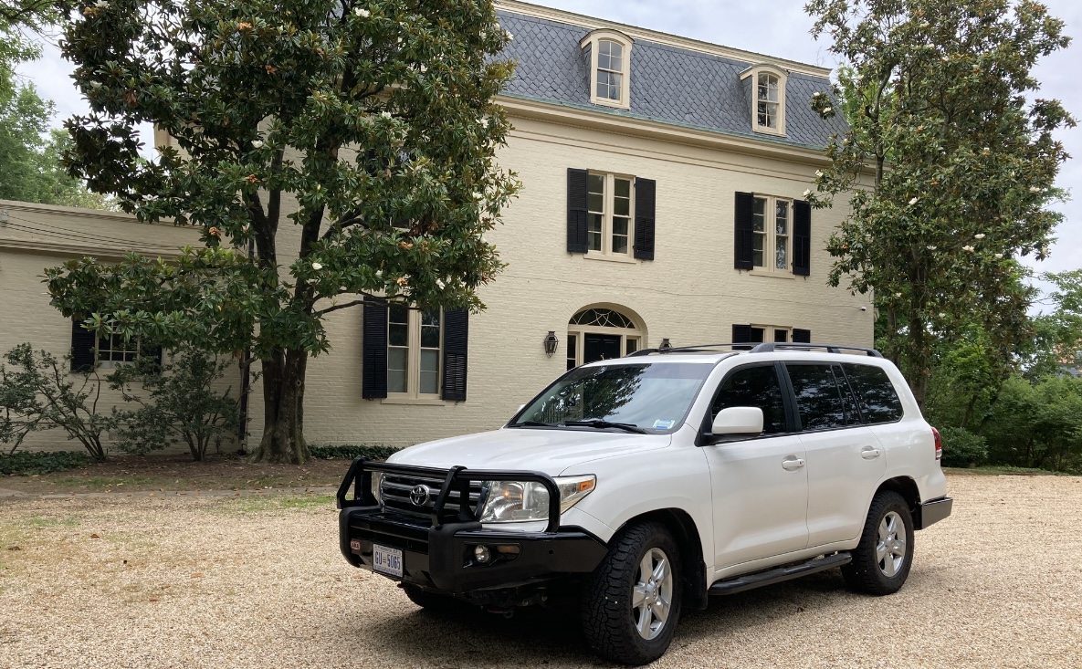

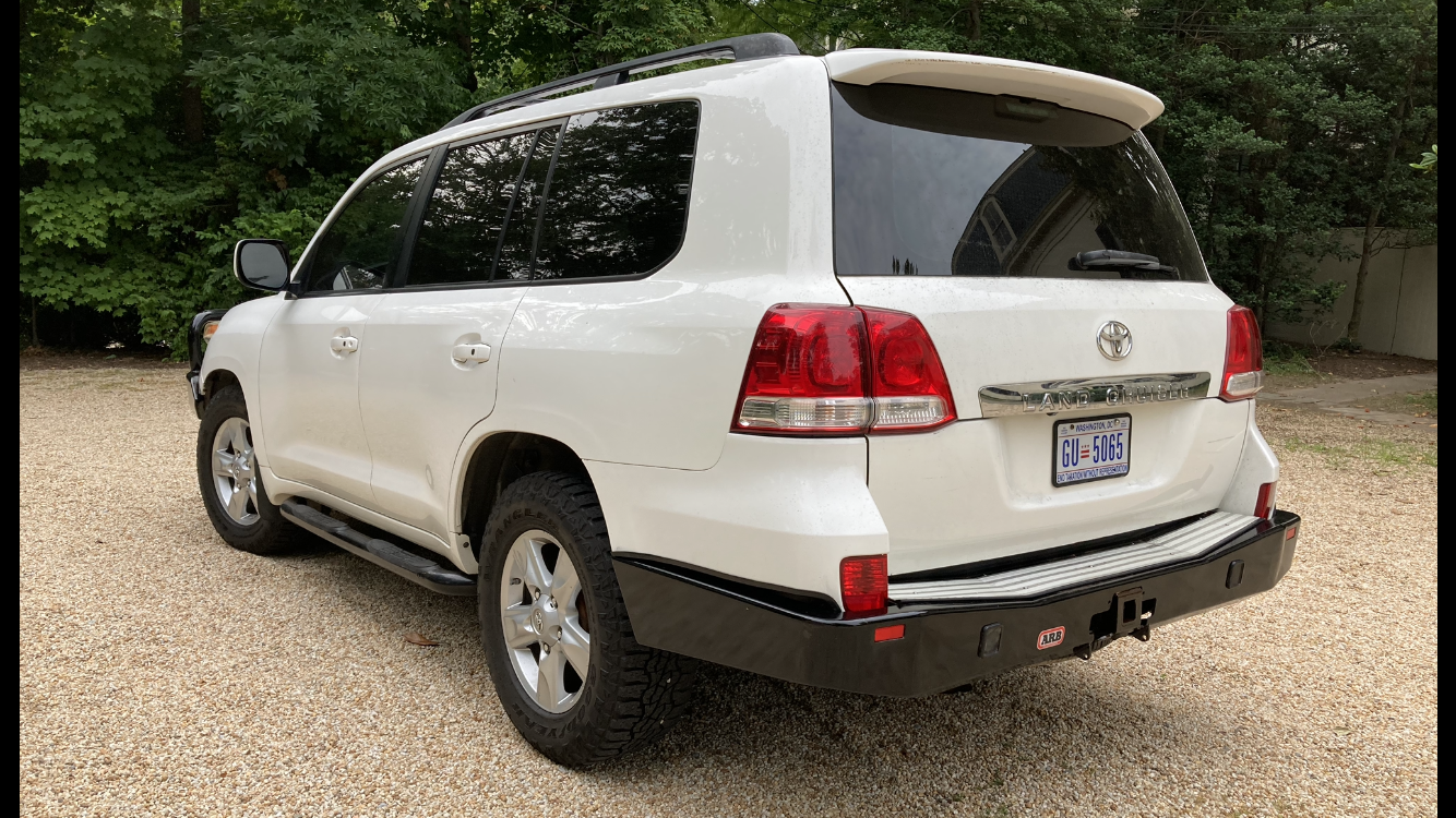

I found this 2008 Land Cruiser for sale 3 miles from my place after a nationwide search for a 200, go figure! I was looking for a cheap, rust free, mechanically sound, flawless interior, 200 to wheel at local East Coast TLCA events and to take on road trips with family and friends. This truck was exactly that. Flawless victory.
She was bought new and registered to a prominent Oklahoma cattle company for her first 10 years, and then spent the last 4 years with an Oklahoma City businessman who drove it back and forth to Virginia. It currently has 175k miles on it and was maintained at Toyota dealers for most of its life. It has full vehicle history by Toyota VIN lookup and is all up to date with new radiator and starter.
Uniquely, she has front and rear ARB bumpers from the cattle ranch, but with stock height springs. Although it does have Old Man Emu shocks on it- the lowest part of the front skid plate sits at 8" so it is ready to get updated suspension ASAP. I'm not sure how long the bumpers have been on the truck, but they are faded, the rubber "buffers" on the front bumper are dried out, and the foglight housing is cracked.
I bought the truck last week during a full moon, the truck is Super White- and is about as big as the moon- so I'm calling this big girl "Lunar 1" aka "Luna".
Below is the initial to do list that will be the main focus of this build thread. These items will likely be accompanied by any trials and tribulations associated with said build. This is technically my third Toyota truck build in the last 4 years. G-d help me! Send a priest! This addiction is real.

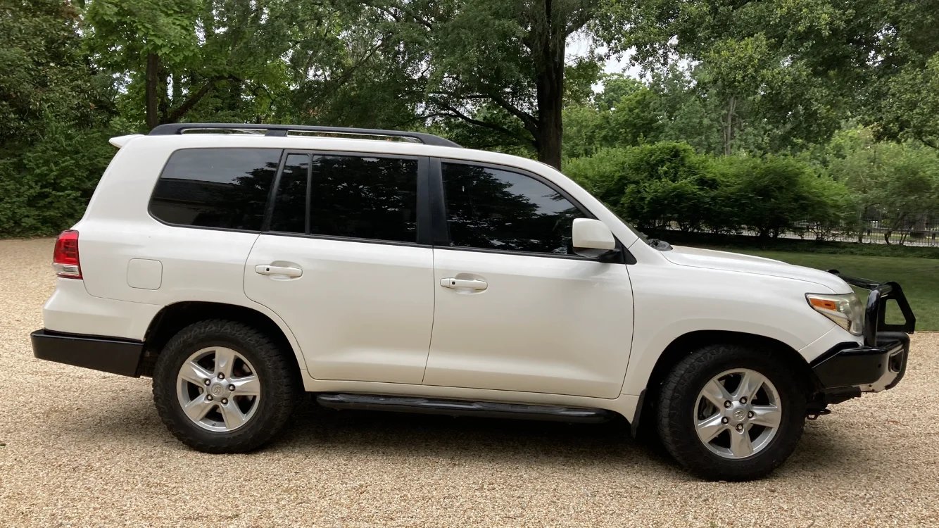

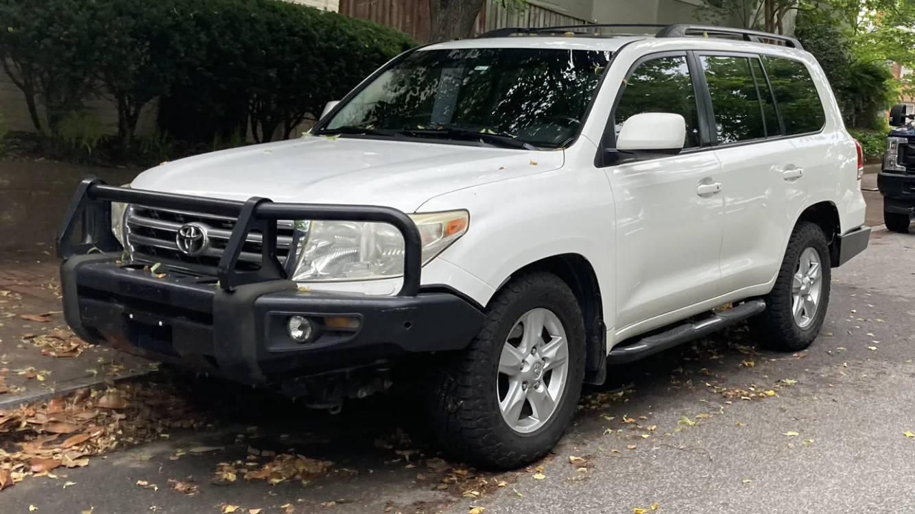

Here is Luna as she sits now:
PS- If you were also looking at this truck when it was listed for sale online and have any extra info, feel free to leave a comment here or PM me. Any additional info is always appreciated.

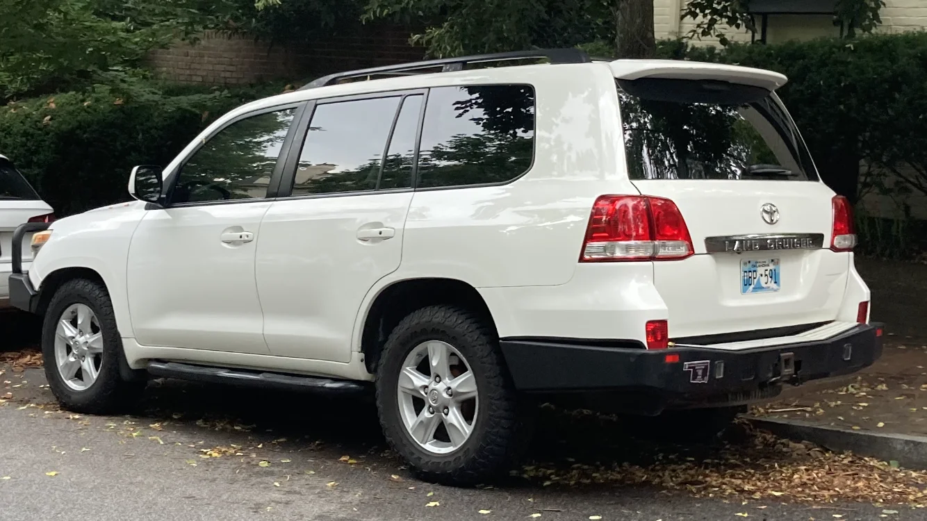

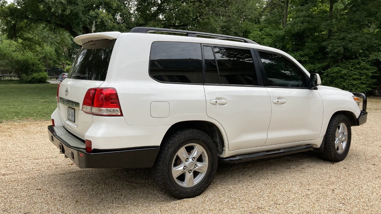

Some glamour shots at a historic mansion down the street- why not… showing off that sweet, sweet fluid film shine on the bumpers. Truck is looking way better already. Need to pull off those side steps.

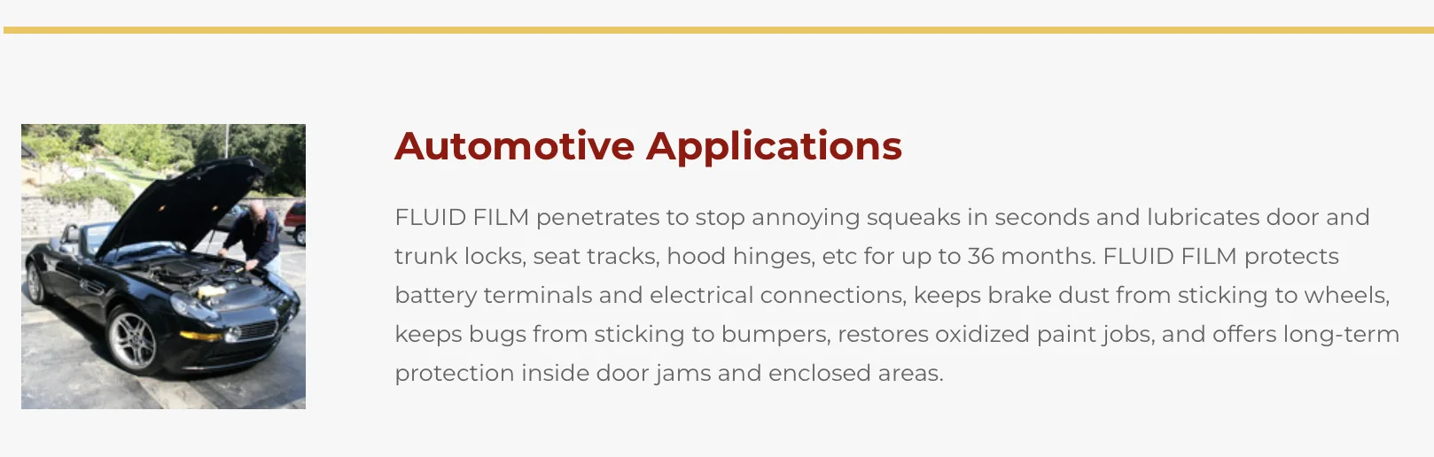

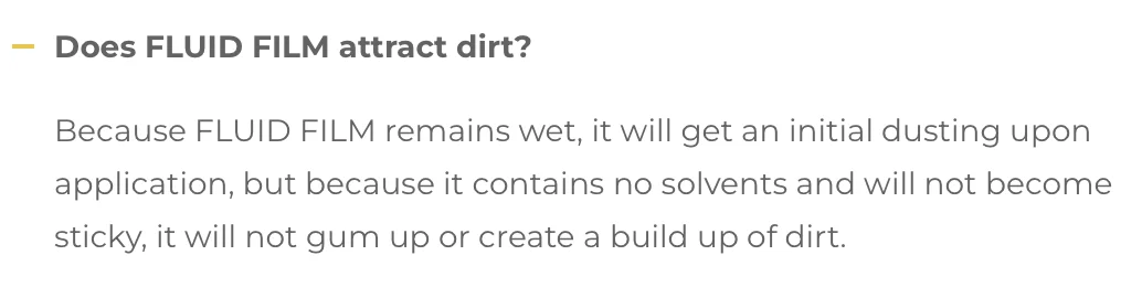

You might find it interesting to note that Fluid FIlm advertises itself as being good for oxidized paintwork and application on bumpers. This is from their website: Home Applications - Fluid Film - https://www.fluid-film.com/home-applications

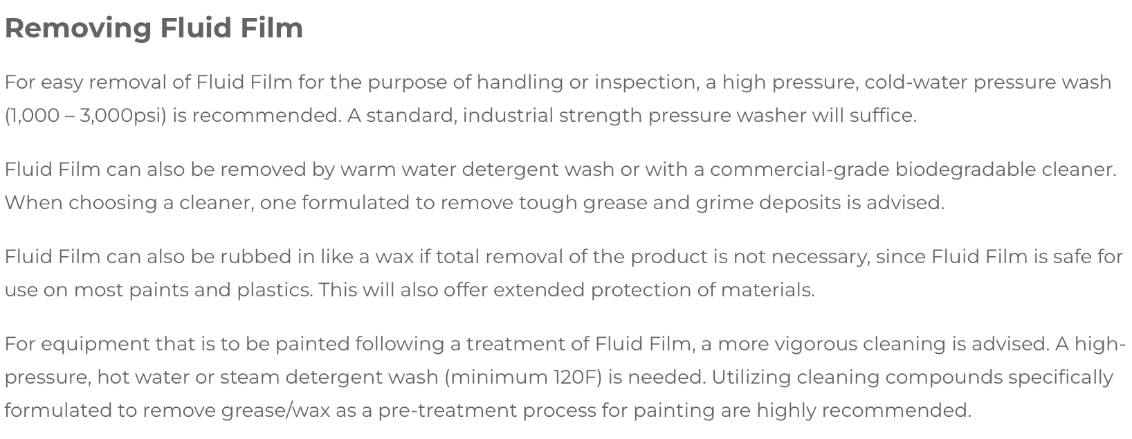

If for some reason the fluid film proves to be a problem, it's not difficult to remove: Spraying - Fluid Film - https://www.fluid-film.com/spraying-fluid-film/

Finally, if the manufacturer is to be believed, you may wish to check out their FAQ. Yes, I know you have experience using the stuff, and feel free to let me know if you don't agree with the manufacturer, but it's worth noting their official stance on this: FAQ - Fluid Film - https://www.fluid-film.com/frequently-asked-questions/

Sounds like I can wipe the bumpers off with a cloth if/when needed.
