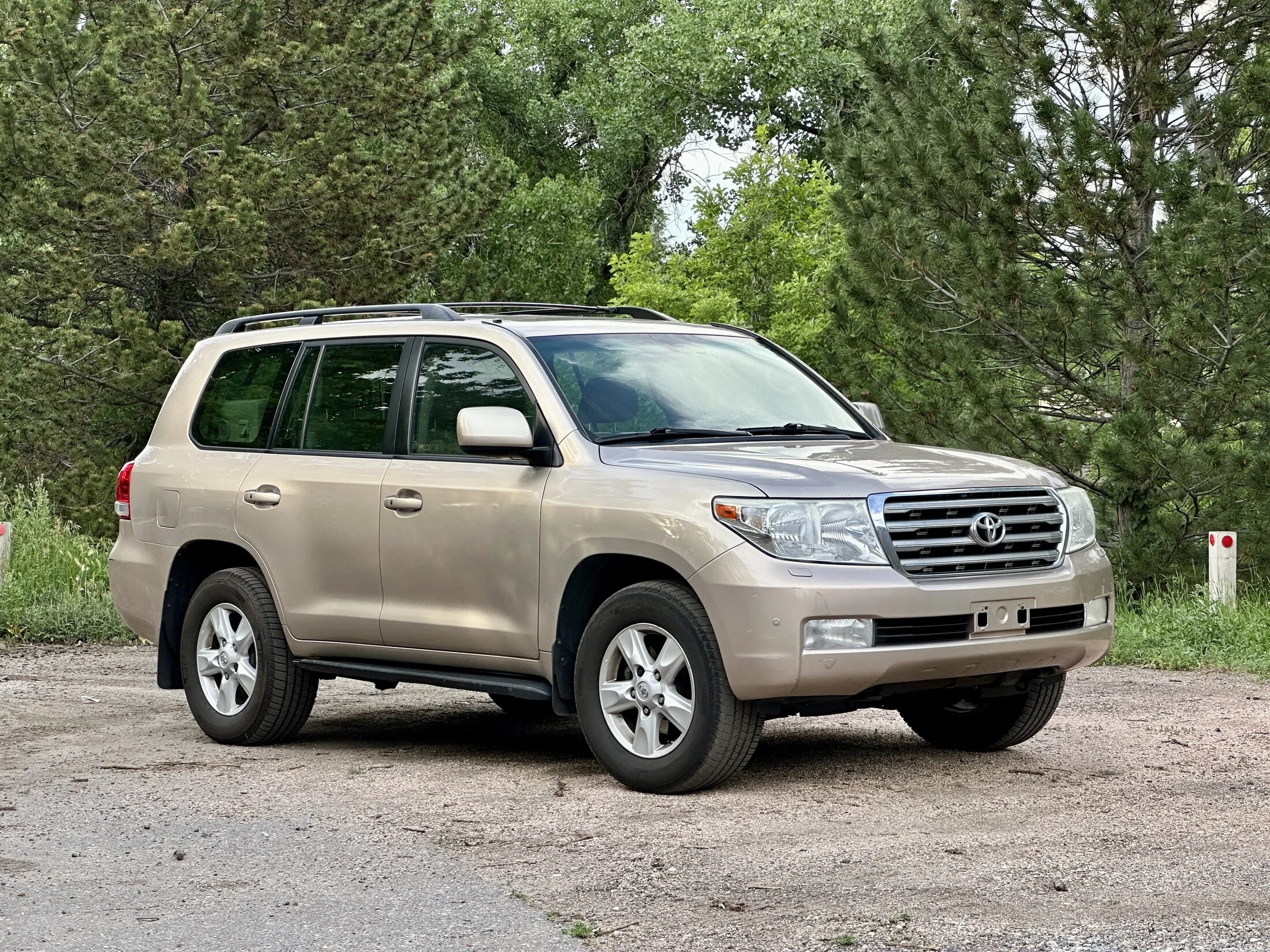

Hey All,
After lusting for an LC for a few years and finally coming to terms with parting with my beloved MK7 Golf R, I pulled the trigger on this 2-owner 2008 Land Cruiser. I was convinced I wanted a 100 series, but after driving a 100 and this 200 back to back on the same day, I was sold. I wanted something to serve as a comfy daily, snowboarding rig, and summer camping/trail rig. I drove a '98 T100 in college, and man, it's nice to be back in a Toyota after a stint in a few Subarus, BMWs, and VWs.
I got lucky finding this 200 right here in Denver after looking all over the Rockies for the right one. The second owner babied and maintained this rig as his family hauler, handing me a stack of records about 2 inches thick dating back to about 40k miles. Though it has 205k on it, it has never seen a trail harder than your average dirt road (previous owner had a 3rd gen 4runner rock-crawler for off-road stuff) and is fairly clean aside from a few scrapes and bumps. Here are some pics from day 1, before its first wash (was too excited to take some pics and shame my buddies with Tacoma's)
These last few weeks have been a deep dive into the IH8MUD 200 forums, baselining this rig. I wanted to give a huge shoutout to a few posters who were an amazing resource for baselining:
[SIZE=4][B]2001LC[/B][/SIZE]'s thread
mceagle555's thread
So far, I have completed:
  • Oil change and filter with Mobil 1 0W20 and OEM Toyota filter
  • Cabin air filter change with WIX - 24511
  • Engine air filter with OEM Toyota filter
  • Front Diff, Rear Diff, Transfer case drain and fill with Mobil 1 Gear Oil 75W90, and new crush washers all around
    • I had 0 difficulty getting the front diff drain plug out and didn't strip it somehow haha
  • Power Steering Flush with Mobil 1 Synthetic ATF
  • Torqued the driveshaft bolts
  • Greased driveshafts and U-joints with Lucas Oil X-Tra Heavy Duty Grease
  • Cracked the KDSS valve screws loose after soaking in PB Blaster and greased thanks to this thread.
  • Spark plug change with Denso Iridium Long Life Spark Plugs 3421
  • Brake fluid change and bleed
  • Valley Pan reseal with J2hundy gasket
    • I know there is some controversy surrounding this one, but in my experience working on other makes, I always prefer a gasket to the form-in-place stuff. This LC had a new radiator put in at 125k and evidence of the leak, but no loss of coolant in the few weeks I have had it. It seems like the leak sealed itself and left a bunch of hardened coolant in the valley. I decided to do the gasket and will be sure to post updates if it fails.
  • Coolant change with OEM Toyota SLLC
  • Heater T replacements with the doorman metal ones, thanks to this thread.
    • I know these aren't a huge problem on the 200s, but I noticed a bit of seepage when changing the coolant, and upon removal, one of them crumbled into dust. I can only assume I may have broken one of them while laying across the engine bay to get those damn air injection pump bolts out
Next on the list:
  • Clean up the coolbox
    • There was a dried spill under the white thing in the center console coolbox that I cleaned up as best I could, but I'm wondering if I should take it apart to clean the drain.
  • Headlight upgrade or facelift headlights
  • Cup holder upgrade
  • Undercoating/treatment of light surface rust underneath
Looking for a bit of advice on a few things:
A drain and fill was done on the trans at 90k miles, and I am now sitting at 205k. I know there is a bit of love and hate for TCCN on IH8MUD, but after watching this video, I'm debating draining and filling the trans with Toyota WS since it hasn't been done in about 115k.
When greasing the driveshafts, I could not get the rear driveshaft to expand and didn't want to risk pumping in too much grease. I still have a slight clunk, and I'm debating throwing in new u-joints. For those who have taken their driveshafts out and apart to clean and grease them, has anyone replaced the lip seal on the shaft as well?
Anything else I could be missing and add to my baselining list? (besides tracking down a set of rock warrior wheels for a reasonable price, skid plates, sliders, and bumpers haha)

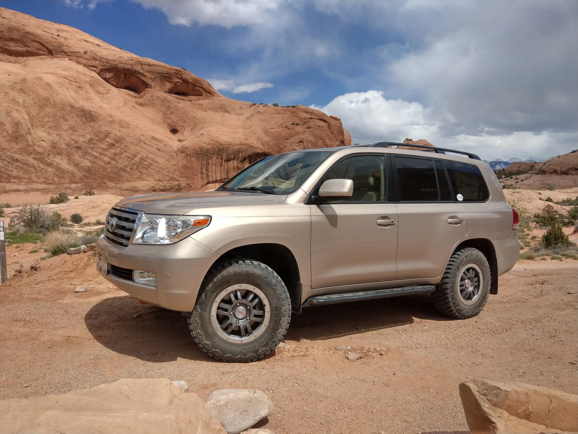

Congrats on your 200. Here's my 2008 that I bought in 2017 with 65k. Now has about 135k. Sounds like you've got most of the bases covered. I did replace my starter proactively this last winter. Which I would consider doing if I was you. I also have replaced the serpentine belt and idlers/tensioners.
