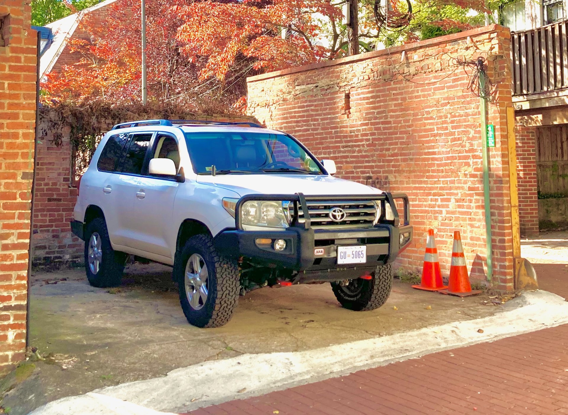

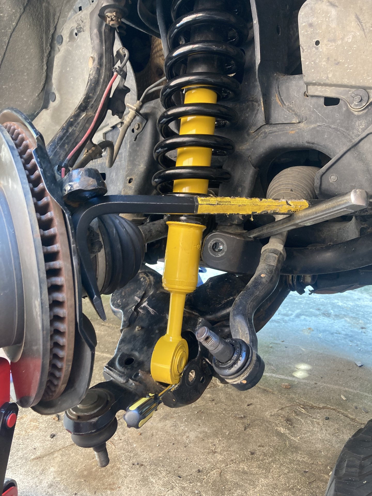

Completed the Old Man Emu lift kit install on my 200 this weekend... it was a lot of bananas.
:banana::banana::banana::banana::banana:

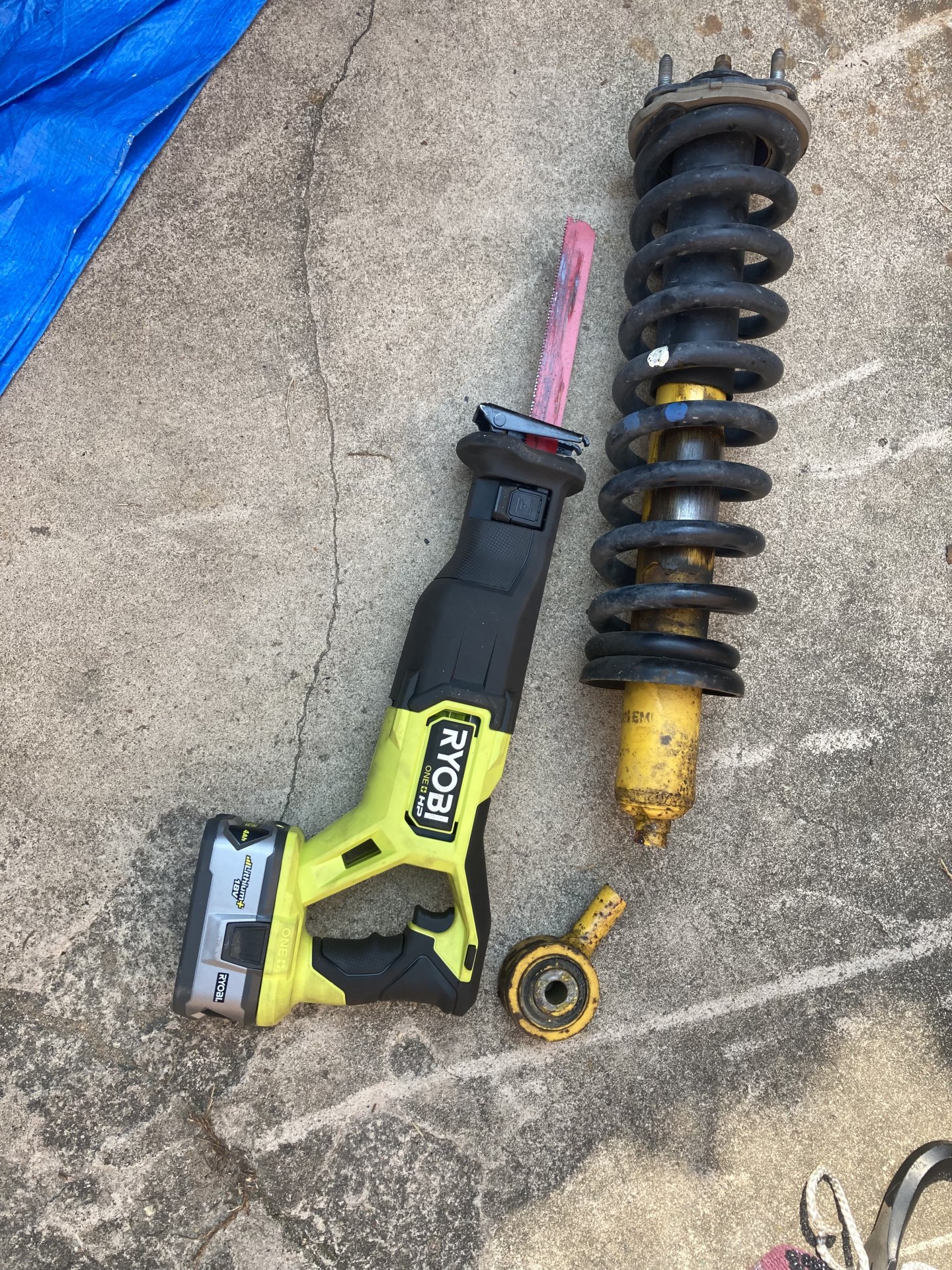

The rear was way easier to do than the front. Got tired of fighting to pull the old front shocks out of the Lower Control Arm so hit em with the Diablo carbide blade on the sawzall. Zip zip.
Not sure if it’s because of the KDSS system, but the sway bars and sway bar links were a huge pain during the install process. Always in the way on front passenger and hard to get seated again.

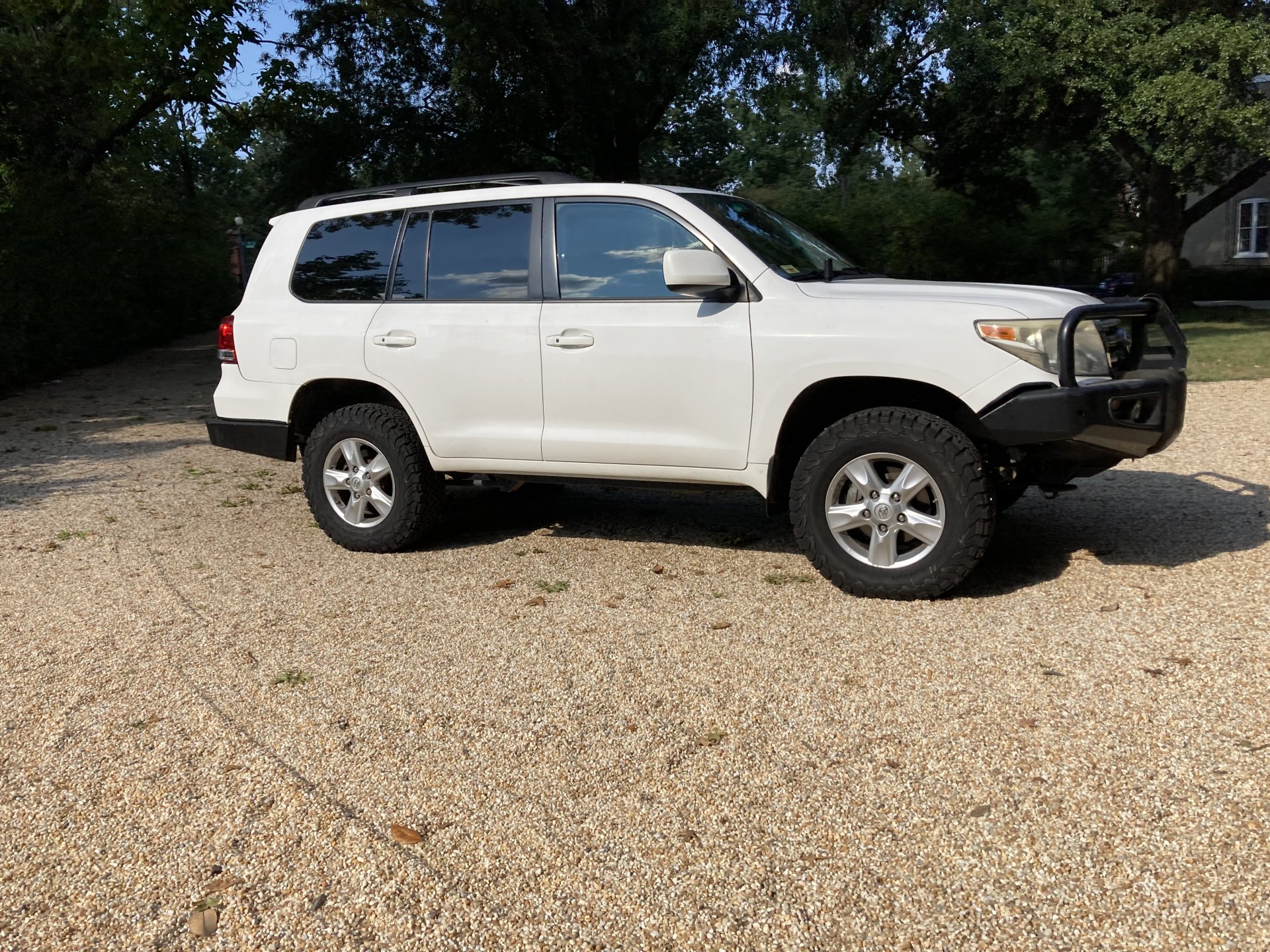

Truck rides way nicer with the new suspension. Front came up by a solid 5”. Rear is up by 3”. Clearance at the lowest point of the front skid in now at 13”. It had been at 8” with the old blown shocks.
Now off to alignment and I’ll throw some wheel spacers on it this week to fill the wheel wells a bit better with these tiny 33” girl tires. As @afgman786 had warned- post lift it looks like the truck skipped leg day.
Budbuilt skids and sliders going on next week soon and then I’ll tackle install for the 10k warn winch.

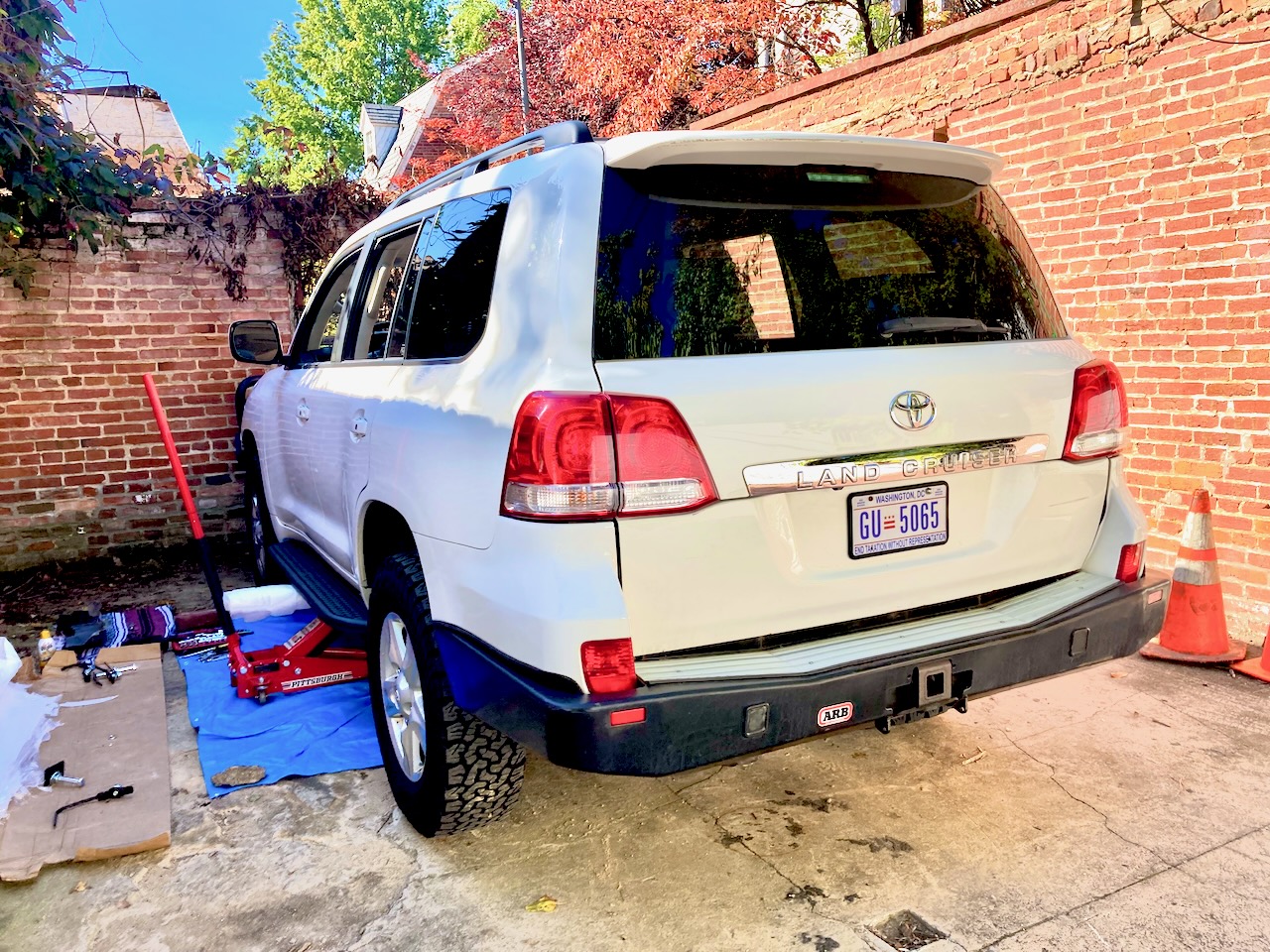

- Installed ARB front recovery points (ARB2815020)

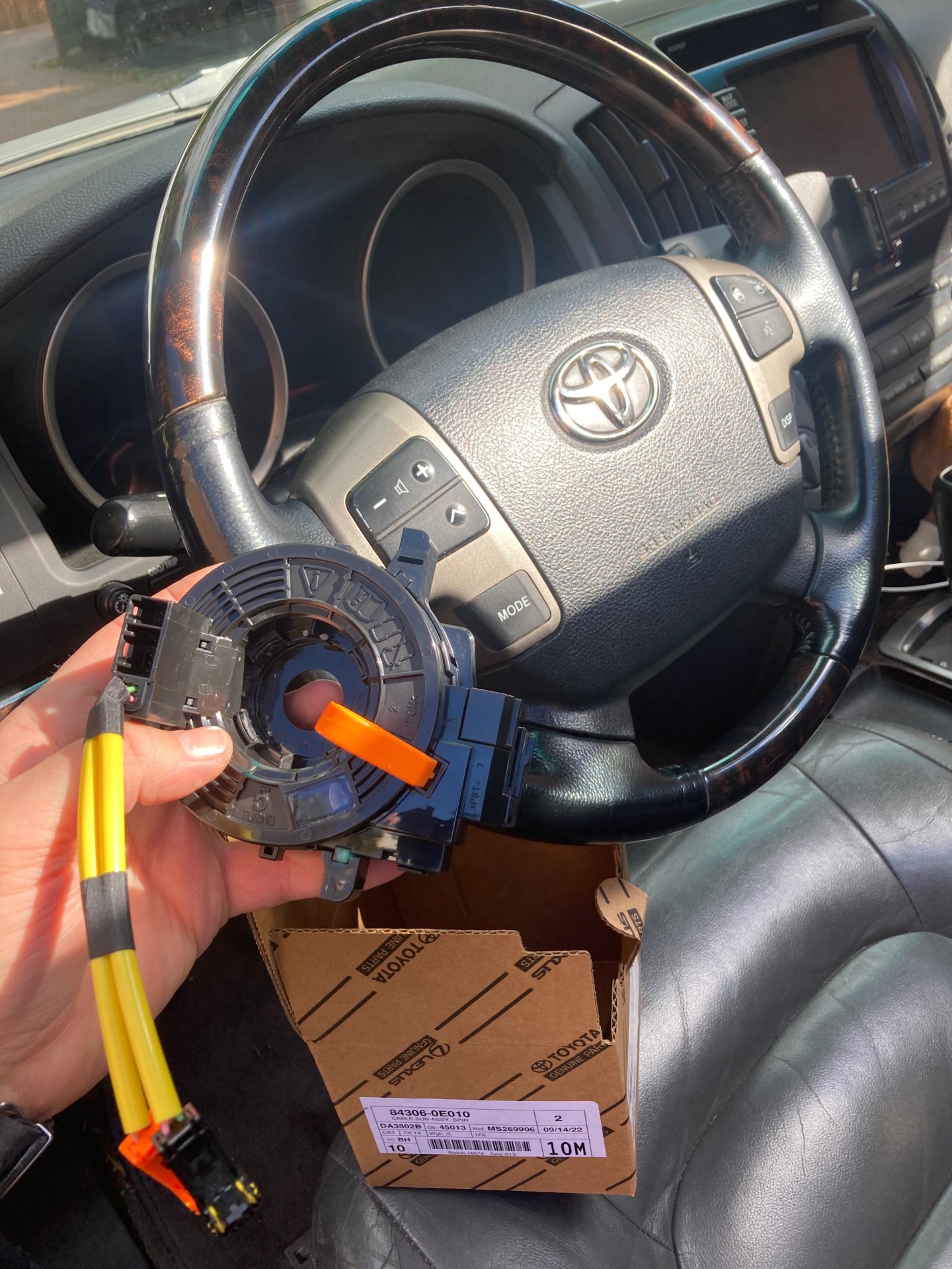

- Installed new clock spring to fix issue with intermittent Cruise Control - (Toyota Part No. 84306-0E010)

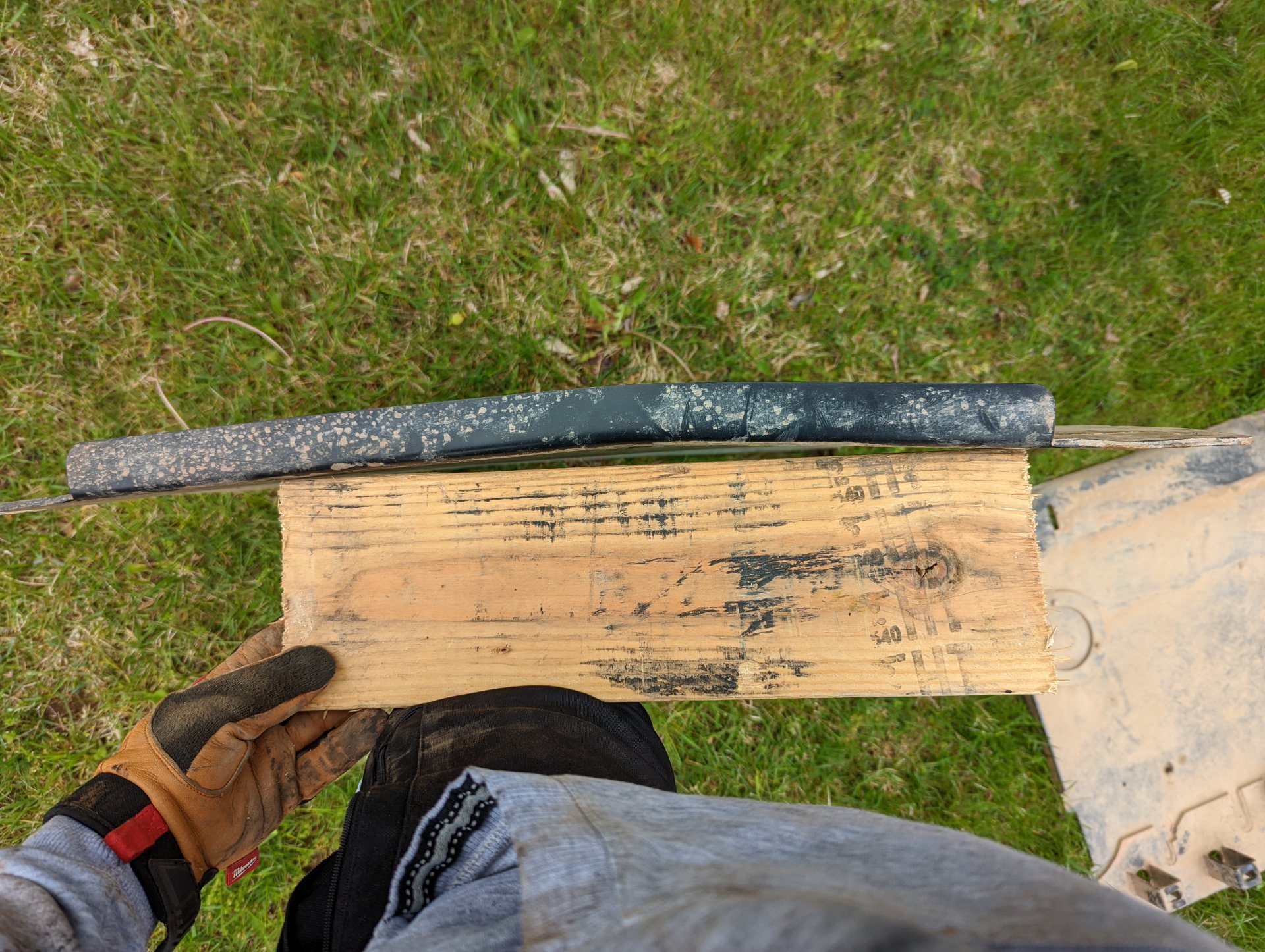

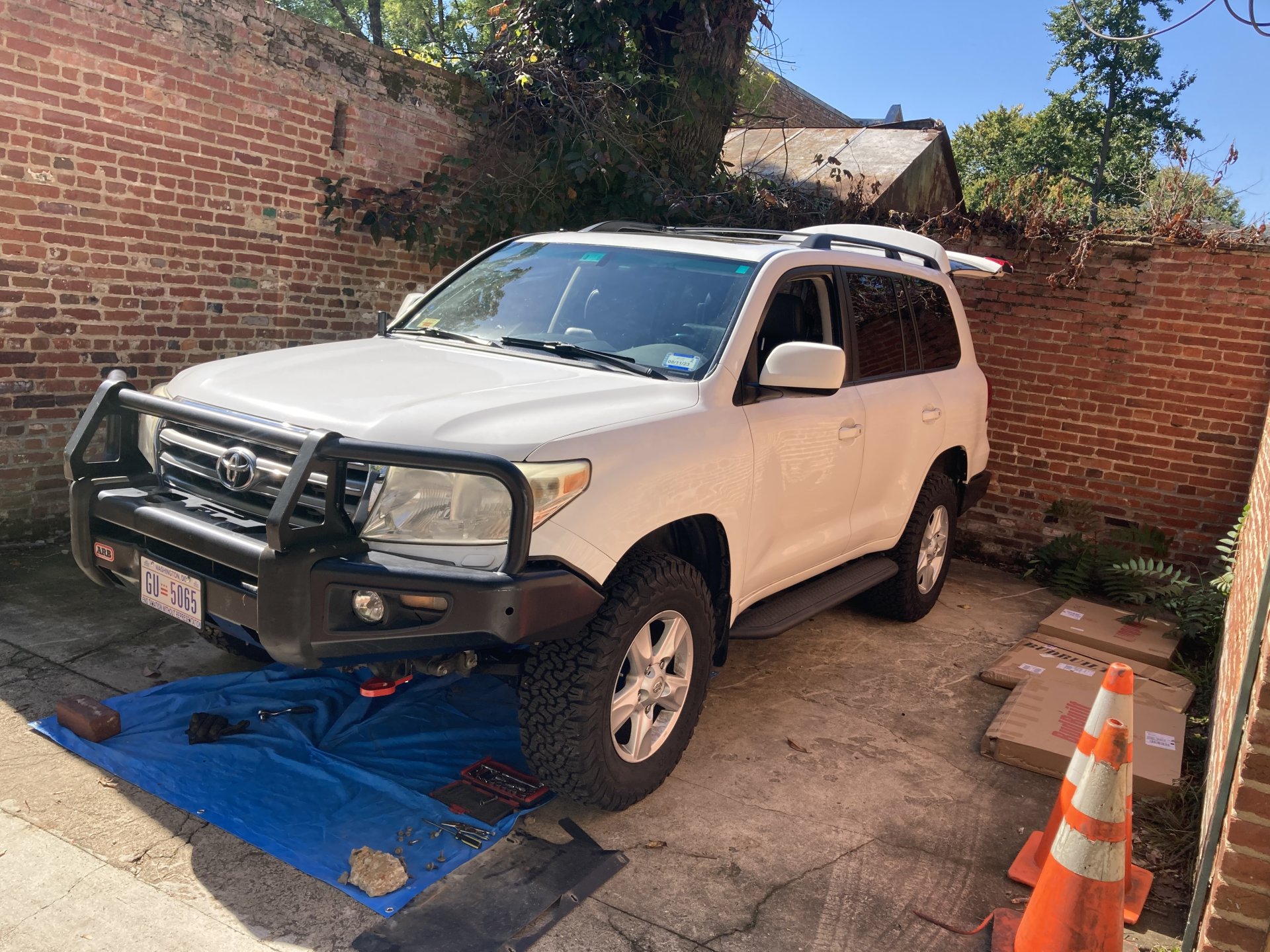

And now featuring BudBuilt rock sliders. It was a couple banana job, but it took about 6 hours. Thanks to the BudBuilt install video, I had all the right tools ready to go (floor jack, piece of 1x4 lumber about 15" long, flex head 12mm wrench, etc.), none the less, a very long install. In my opinion, worth the time to not have to drill the frame and worth every penny for stout build quality for my use case of smacking into east coast boulders and rock ledges.
BudBuilt skids and Warn 10k synthetic line winch going in next weekend. That will complete the build for the next year or two- or more. She's coming together nicely.

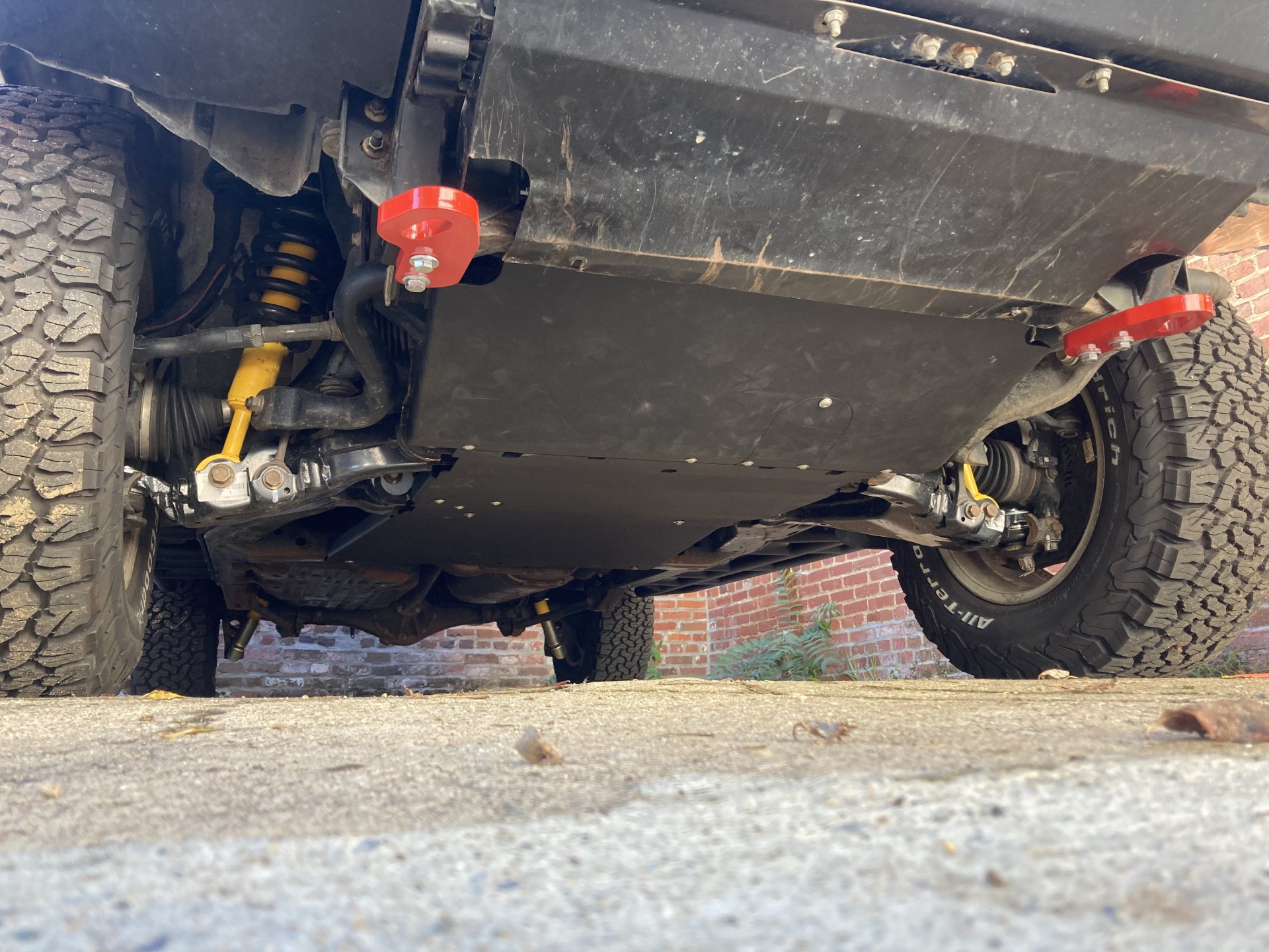

- Installed BudBuilt skid plates. Front, engine, and transmission. Stout build and great engineering. Fit, finish, and hardware are impressive. I still need to order a transfer case skid but this will have to do for now. *Note to self: don’t hit the transfer case. (Edit: ordered and received transfer case and gas tank skids from BudBuilt. Will install before hitting the trails.)

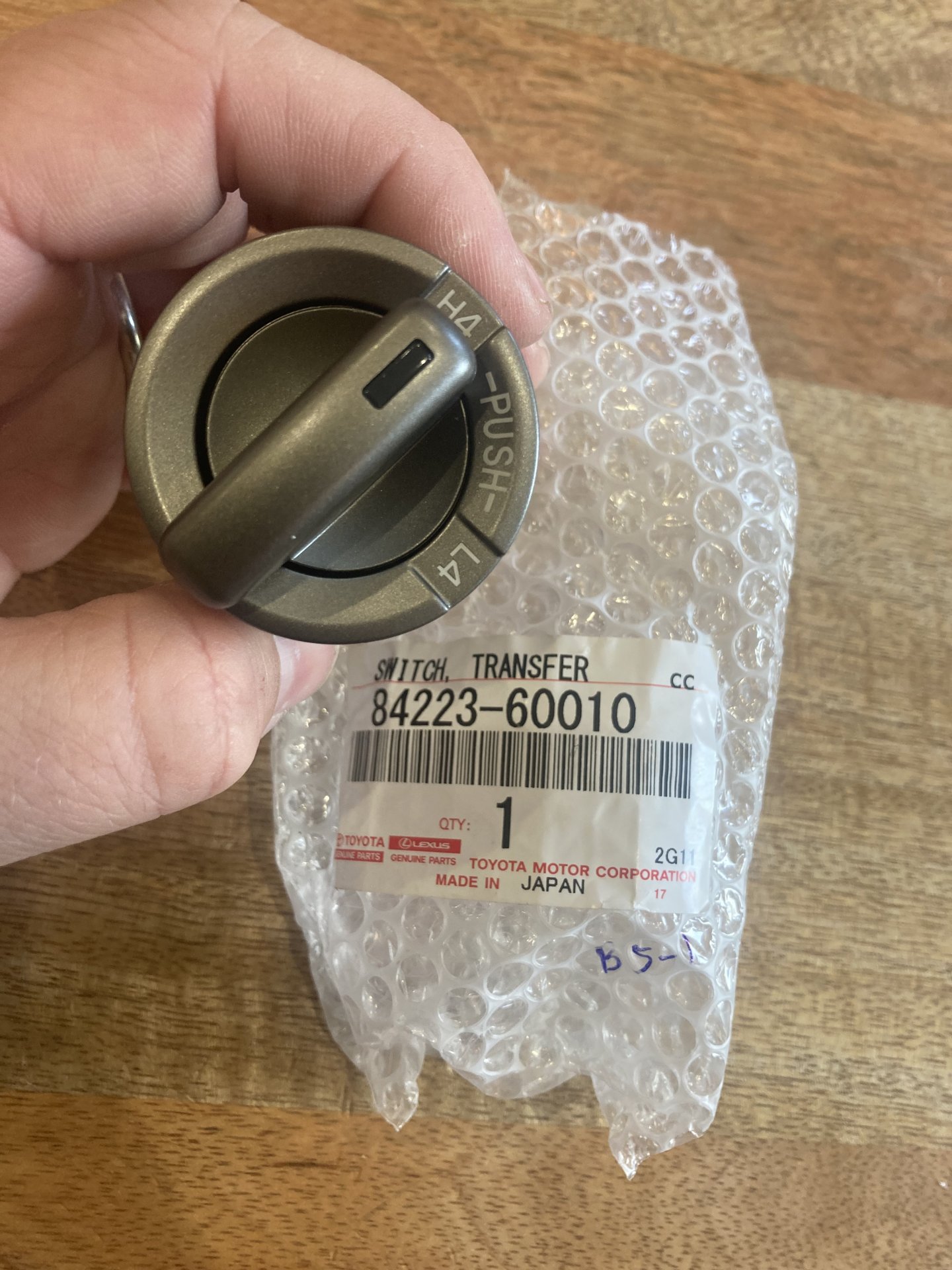

- Also installed new OEM Transfer Position Switch (Toyota Part No. 84223-60010) Very easy install and nice to have 4lo engage without wiggling around the switch every time. I suspect that someone didn’t realize you need to push in when turning the switch and forced it, breaking the internal pieces and causing them to spin in the housing and not engage properly.

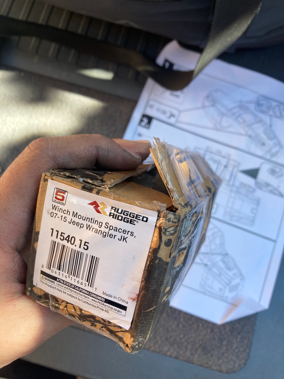

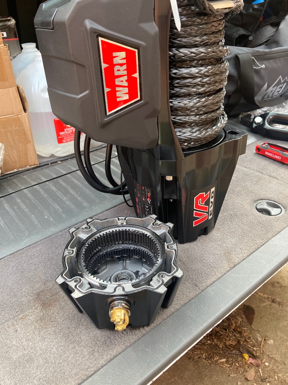

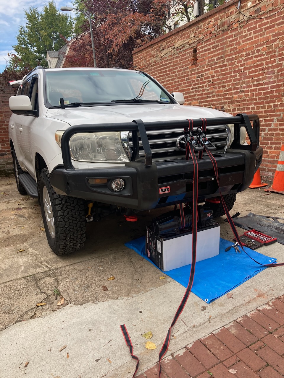

I got the winch mounted into the bull bar today using ratchet straps without removing the bull bar. The "rugged ridge" winch spacers I had on-hand really came in handy as the Warn VR Evo 10S winch housing was interfering with the internal bracing on the bull bar making it impossible to mount the feet onto the bar without a spacer. I also had to grab two longer bolts (M10-1.5 x 70mm) to mount the Warn hawse style fairlead to the bull bar as these bolts also have to pass through the spacer and attach to the winch feet.

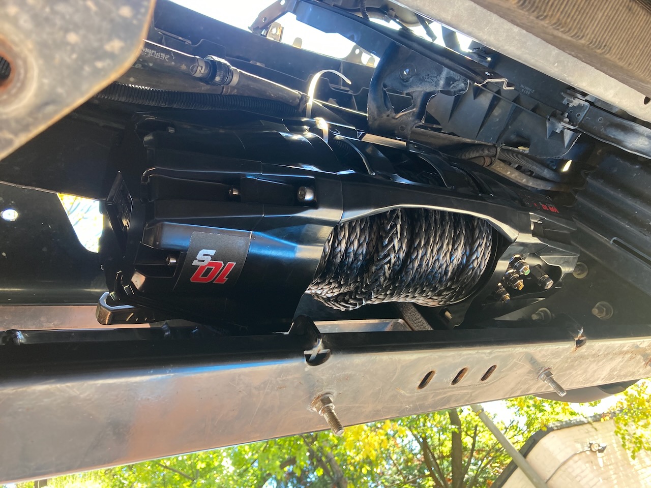

I clocked the clutch handle so that it is accessible through the top of the bumper, but I think I may have put the winch in upside down- laugh out loud. (Edit: I've double checked and it's not upside down. But I don't understand why Warn would put the cable attachments underneath the winch. It seems like that would expose them to a lot more water, and it's pretty far from the top of the bumper where the control box will get mounted- so I might need extended winch motor cables or I'll just keep the control box in the bumper somehow.) I'll get it sorted and post up more pics later this week.
The magic winch spacers:
Clocking the clutch handle:
View from beneath. Winch looks upside down? I'll have to pull the winch and figure it out:

It almost looks like I'll be able to fit the winch in the bumper with the control box attached. I'm going to try that and report back. Hopefully in that case it will still be easy to access the plug for the remote.
I originally wanted to get an M8000 Warn winch. Install would have been much more straight forward, but 8k is just a little too little for this big girl so I'd probably end up running a snatch block on most pulls in that case and it would be a hassle.
