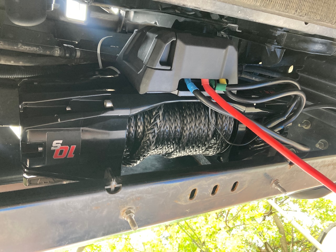

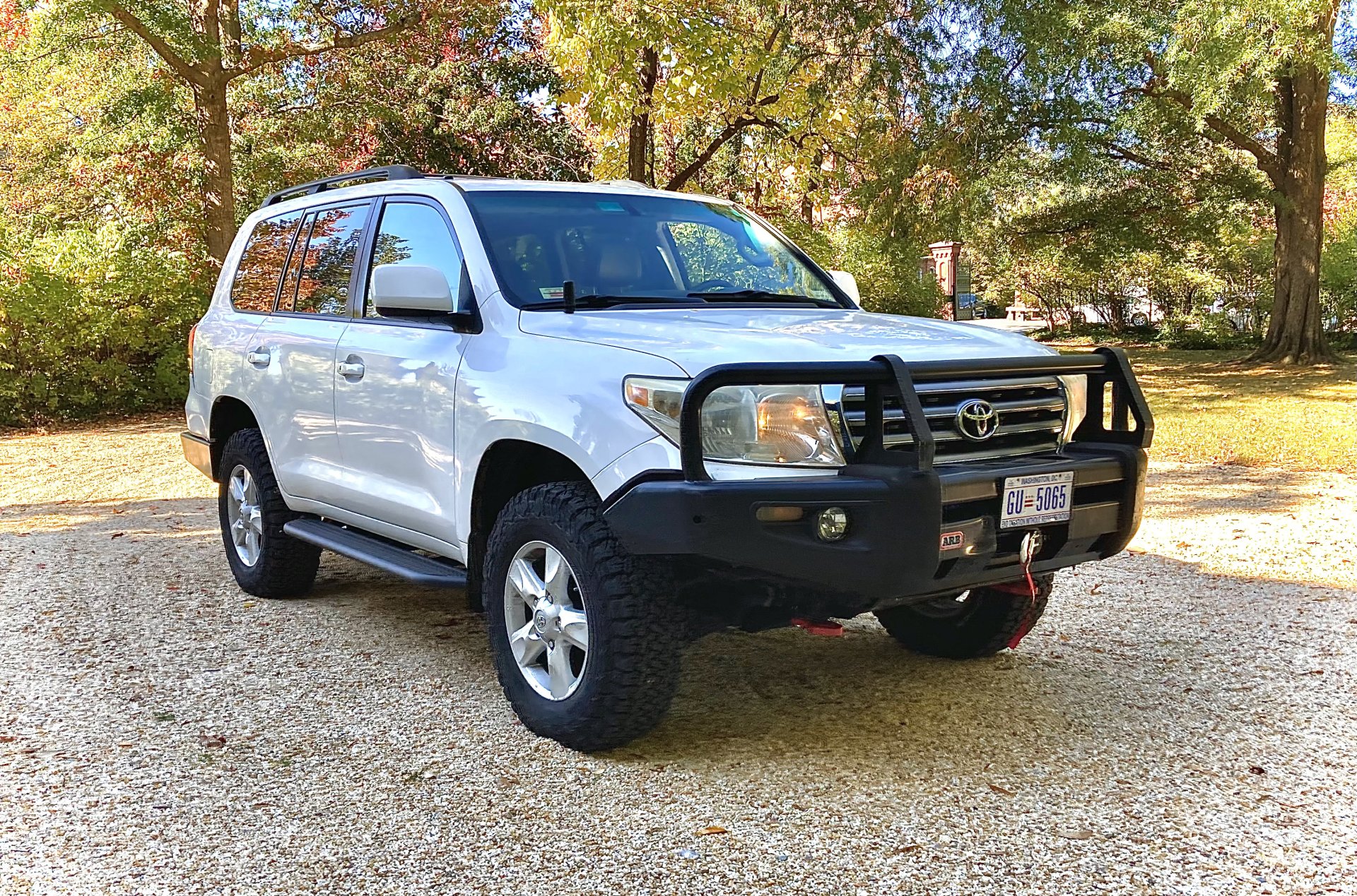

Hot dam! The winch works... I finished a clean install with the control box attached on top of the winch and easily accessible if the batteries in the remote go out and it needs to plug in. I connected the winch directly to the battery terminals for now, as per Warn instructions. I'll likely add a separate shut off switch at some point. The way the winch hook snuggles up against the rubber AEV Winch Hook Isolator on the fairlead leads to a real clean and tight fit, so I'll just keep the front plate on when I'm not wheeling and it's a hidden winch to keep away the riffraff. Woot woot! Winch accomplished.
Nice @Diff Kraken now you will have to get the bumper dents taken care of since she is SO pretty now!! Ill bring my nice camera to FC and snap some pics!!

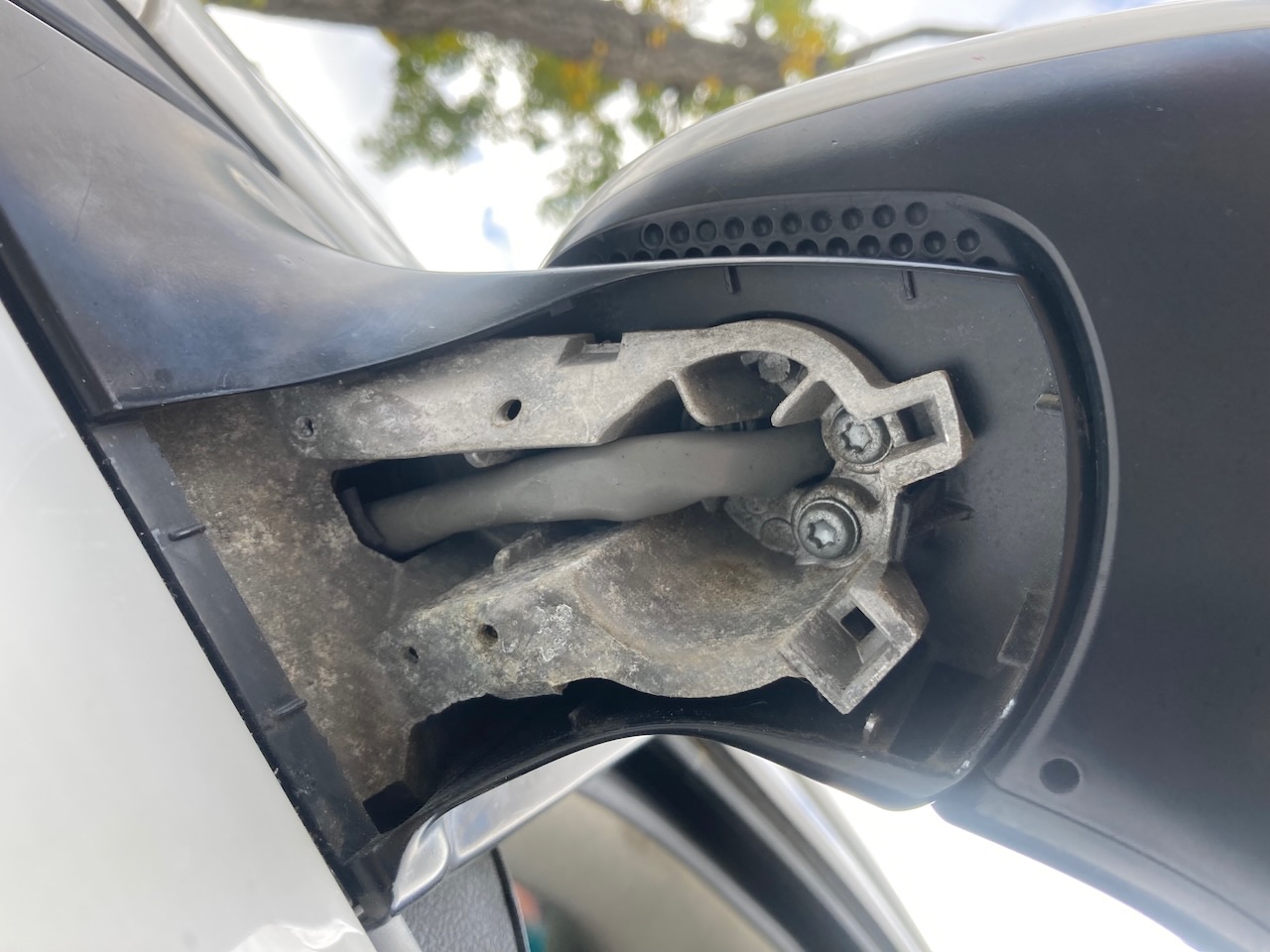

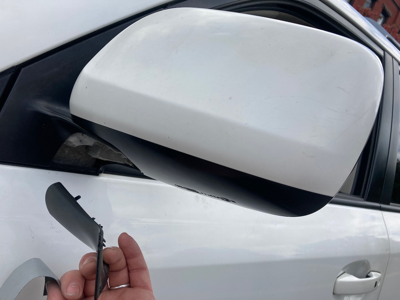

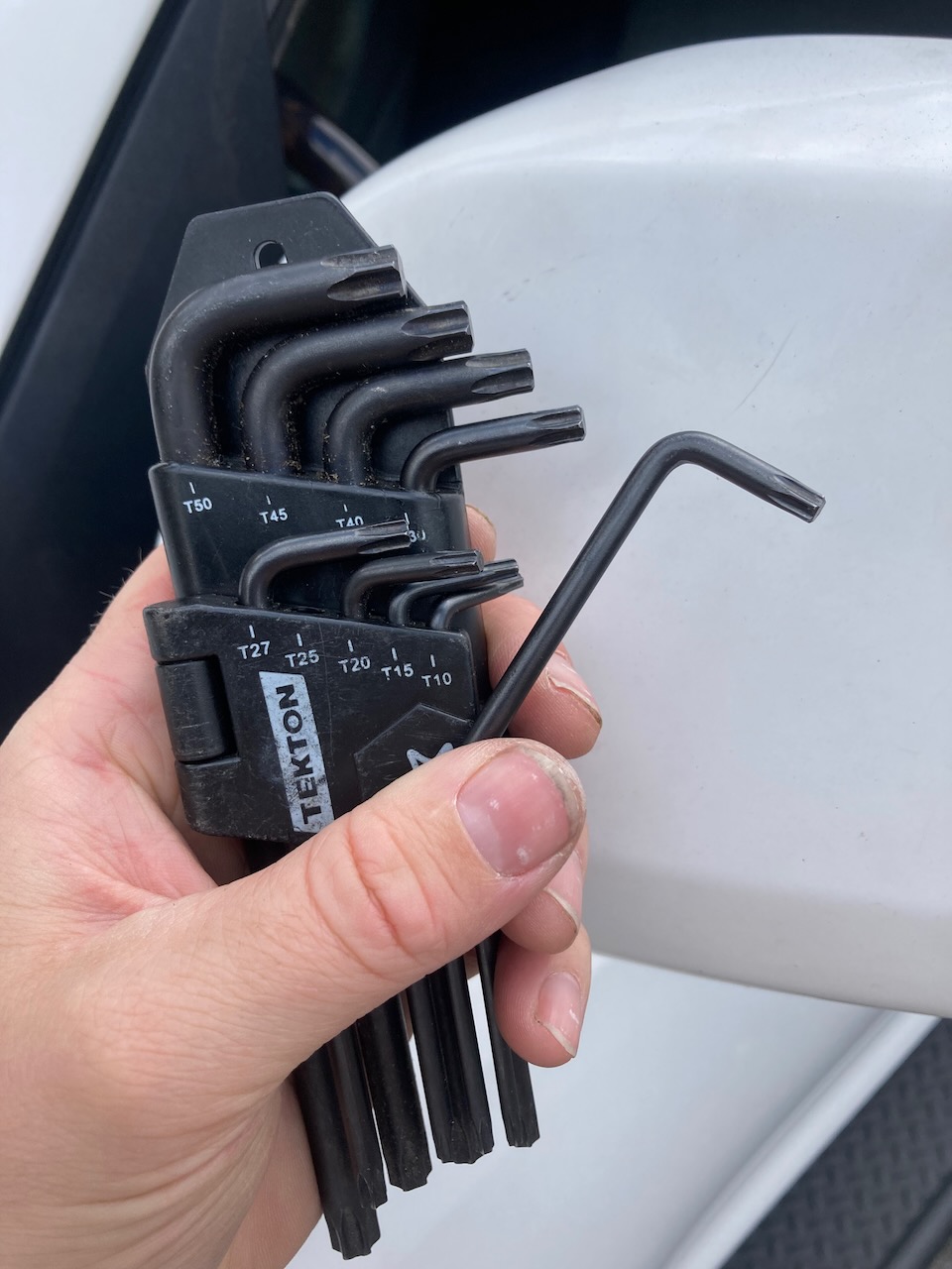

And... fixed that annoying driver's side mirror rattle:
1) Pop off the small cover piece with a tiny allen key- try not to break too many tabs off :rolleyes:
2) Tighten the three bolts with a T25 torx key
3) Pop back on the little cover
4) Enjoy no more mirror rattle :cool:

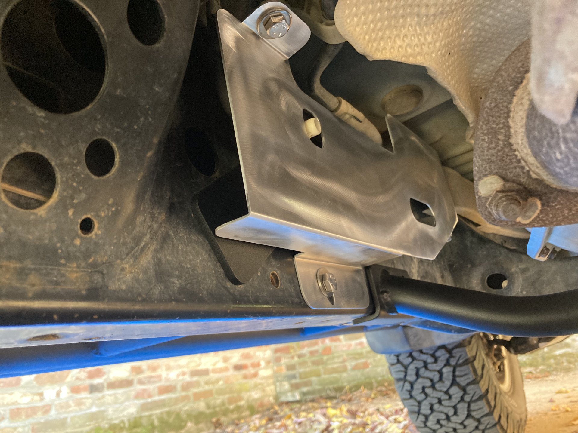

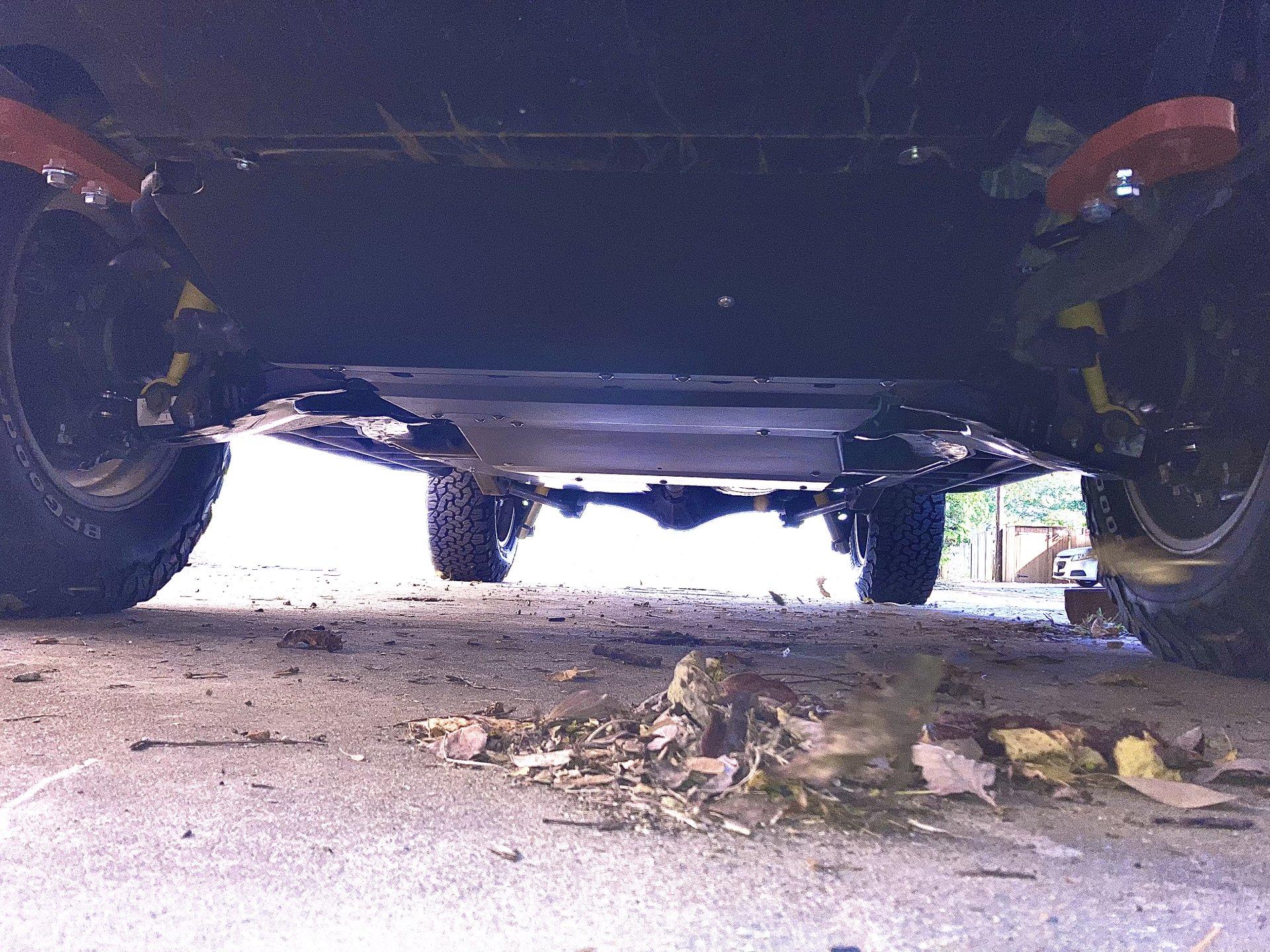

@afgman786 Is this better? Got the BudBuilt transfer case and gas tank skids installed.
Bud now includes this nifty custom heat shield with the transfer case skid so you no longer have to cut the OEM one. Nice touch.

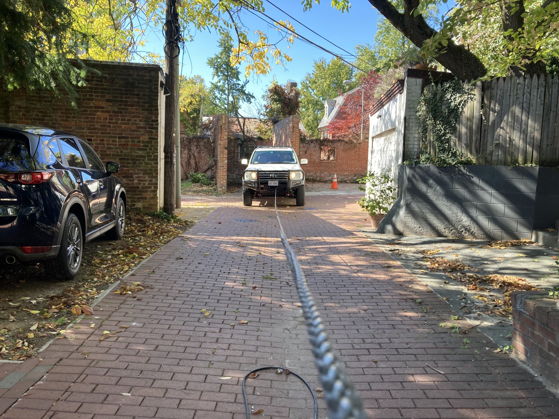

Also stretched out the new winch line…

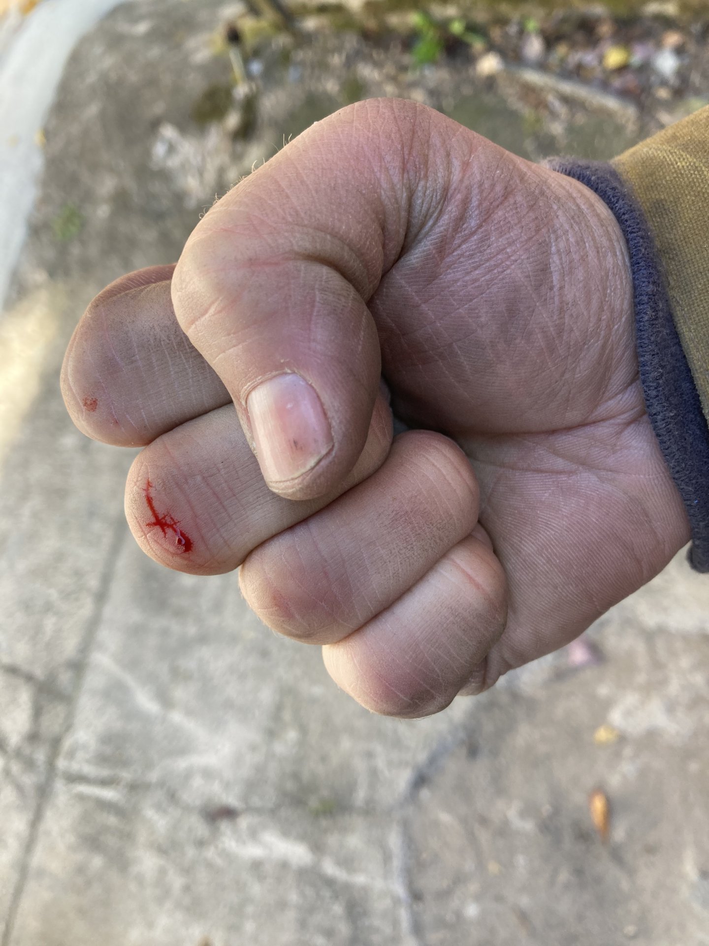

And I thought it was pretty funny that I had no injuries wrenching on this for 5 months… until the very last bolt of the build busted my knuckle. Classic. Wouldn’t ask for anything else…

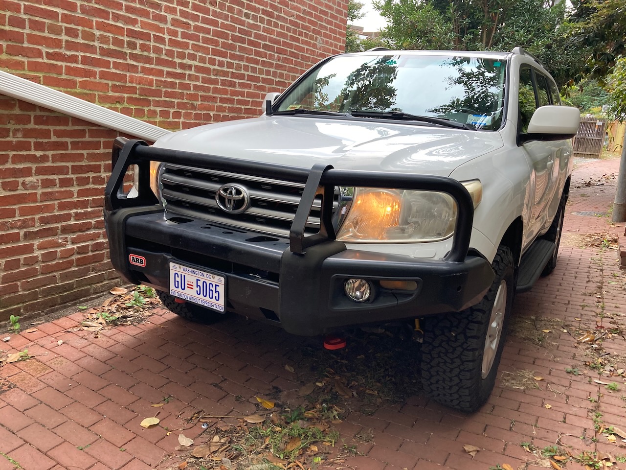

Thought I'd take some clearance measurements again now that I've got all the weight of the BudBuilt skids (front, engine, transmission, transfer case, gas tank), BudBuilt rock sliders, and Warn VR EVO 10-S winch (hidden in the bumper with the winch hook snugged up behind the license plate) and the suspension has settled in for a bit more than a month.
These are the Medium Old Man Emu 2" front and 0.75" rear springs from @cruiseroutfit *with 275/70R18 E-Rated BFG K02 Tires on OEM wheels and Spidertrax 1.25" wheel spacers. (*Edited to add tire info)
The truck is sitting with a perfect 12" of ground clearance under the engine skid. It measures 37.5" at the front fender and 38.5" at the rear fender. I get pretty close measurements for both passenger and driver side. I'm very happy with the setup. It drives real nice both on and off road. Couldn't be happier.
