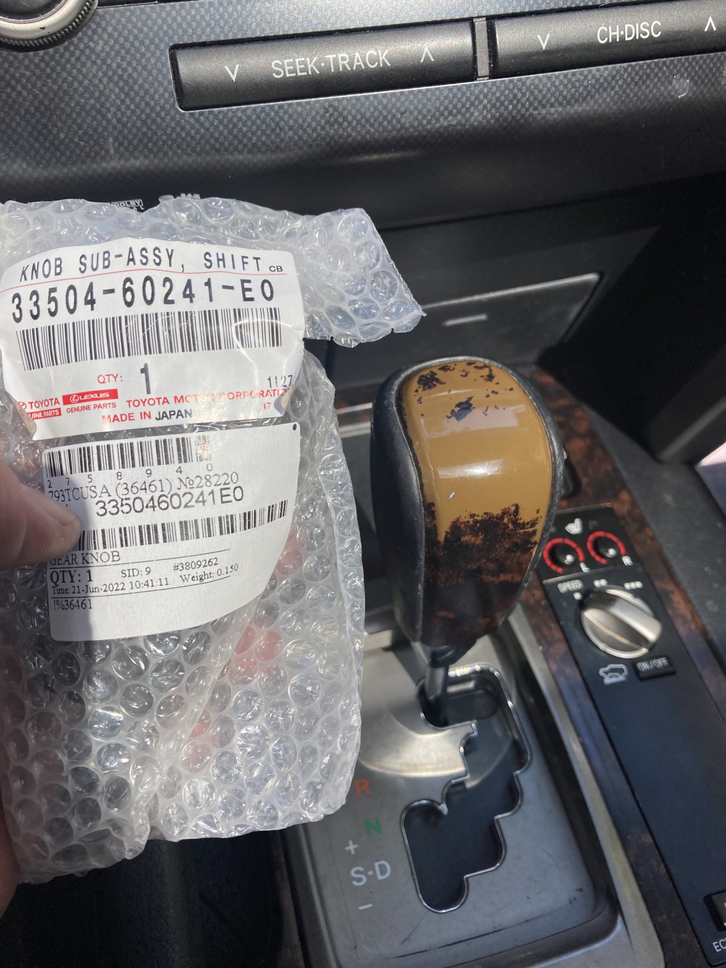

New OEM shift knob, OEM mats, and lift kit ready for install. 🥰

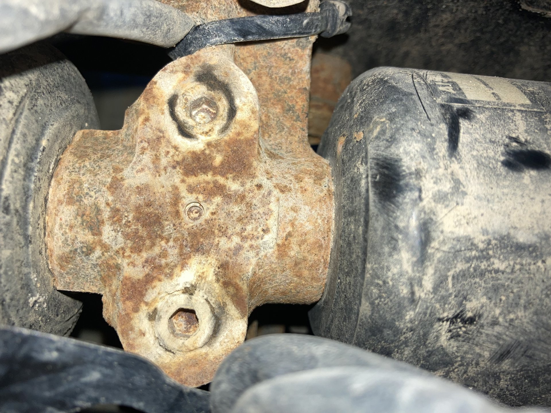

Read up on loosening KDSS valves before you lift.
3 turns with a 5mm allenkey. PB blaster going on tonight, and tomorrow and the next day and the next day. Ill make sure it’s moving before diving in on the install.
@OTRAMM has got it figured out here.
Alright, here’s what we’re working with. Just sprayed the bolts but didn’t hit them with a wire brush or try them with an allen key yet. They don’t look too bad. I’m cautiously optimistic.
Yeah I’d expect them to turn
When you’re all done, slather then with marine grease
They turn!! They turn!!! :)

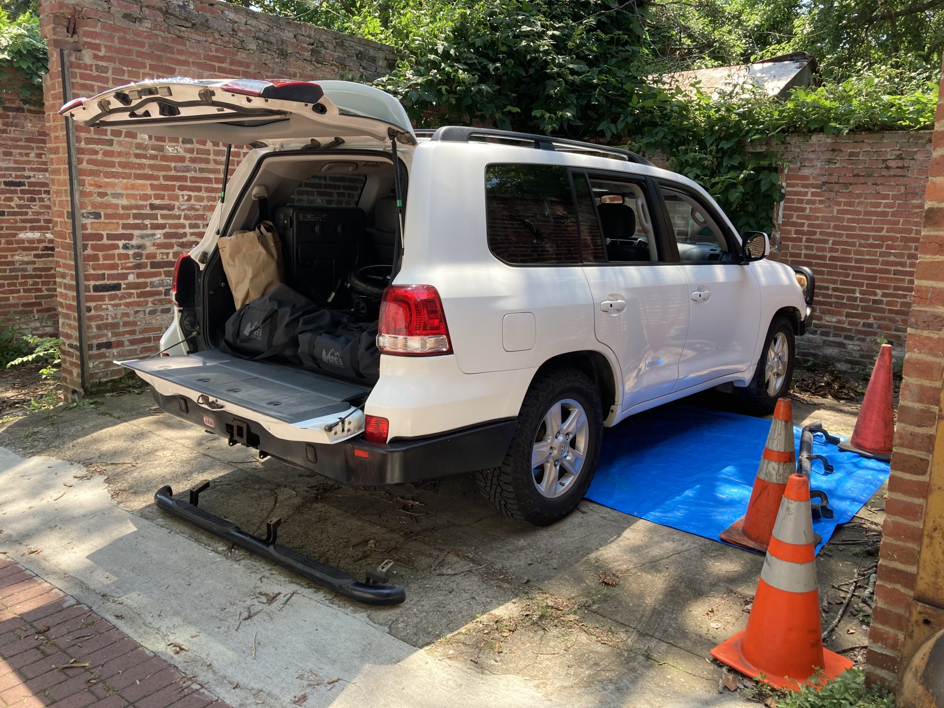

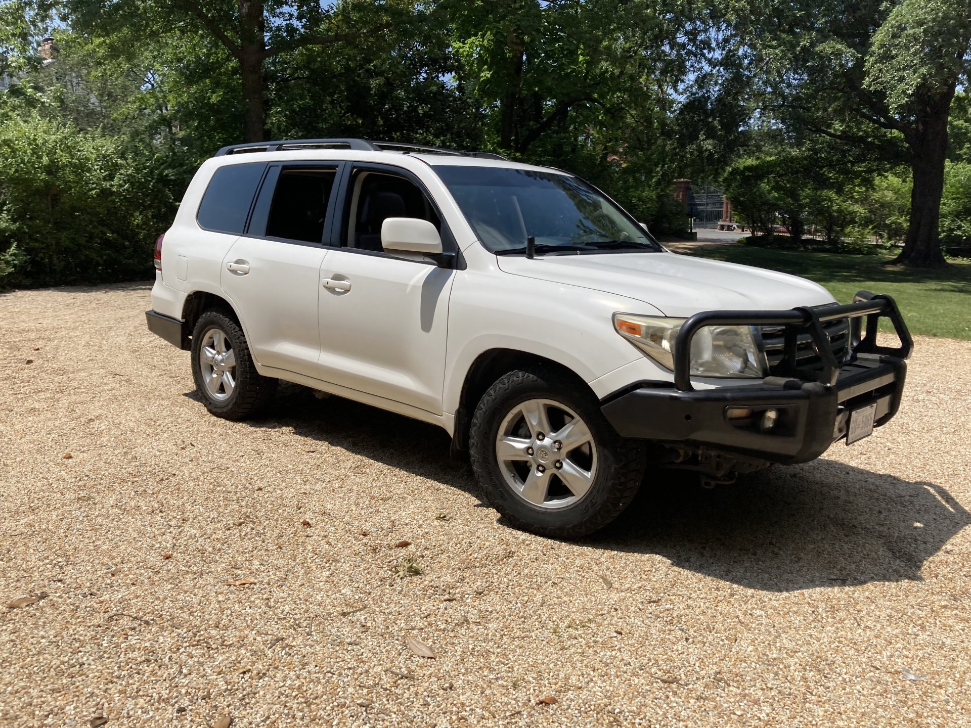

Removed and tossed the rando truck sidesteps... looking much better. Now I need rock sliders...

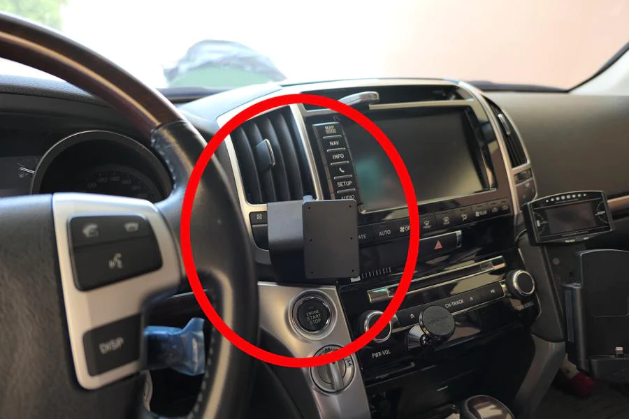

I’ll have the phone mounted up near the driver’s side airvent above the radio using this mount (it is on back order and ProClip will have one made for you when you order). I hope I’ll still be able to use the master HVAC temperature control buttons under the vent after install:
