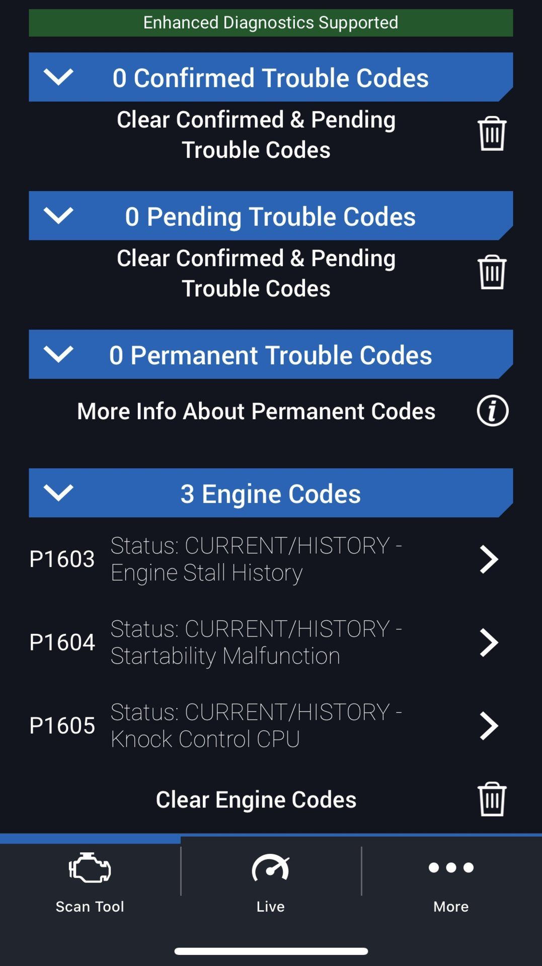

We got the computer replaced and it fired right up, but there’s an issue when in park and these codes are new.
PO171 System too lean (Bank 1)
PO174 System too lean (Bank 2)
PO101 Mass Air Flow or Volume Air Flow Sensor - Circuit Range/Performance
Also, still have the TRAC OFF, flashing 4LO, and of course the CEL. I can’t help but feel like something i was left unplugged. It’s got to be related somehow right?
