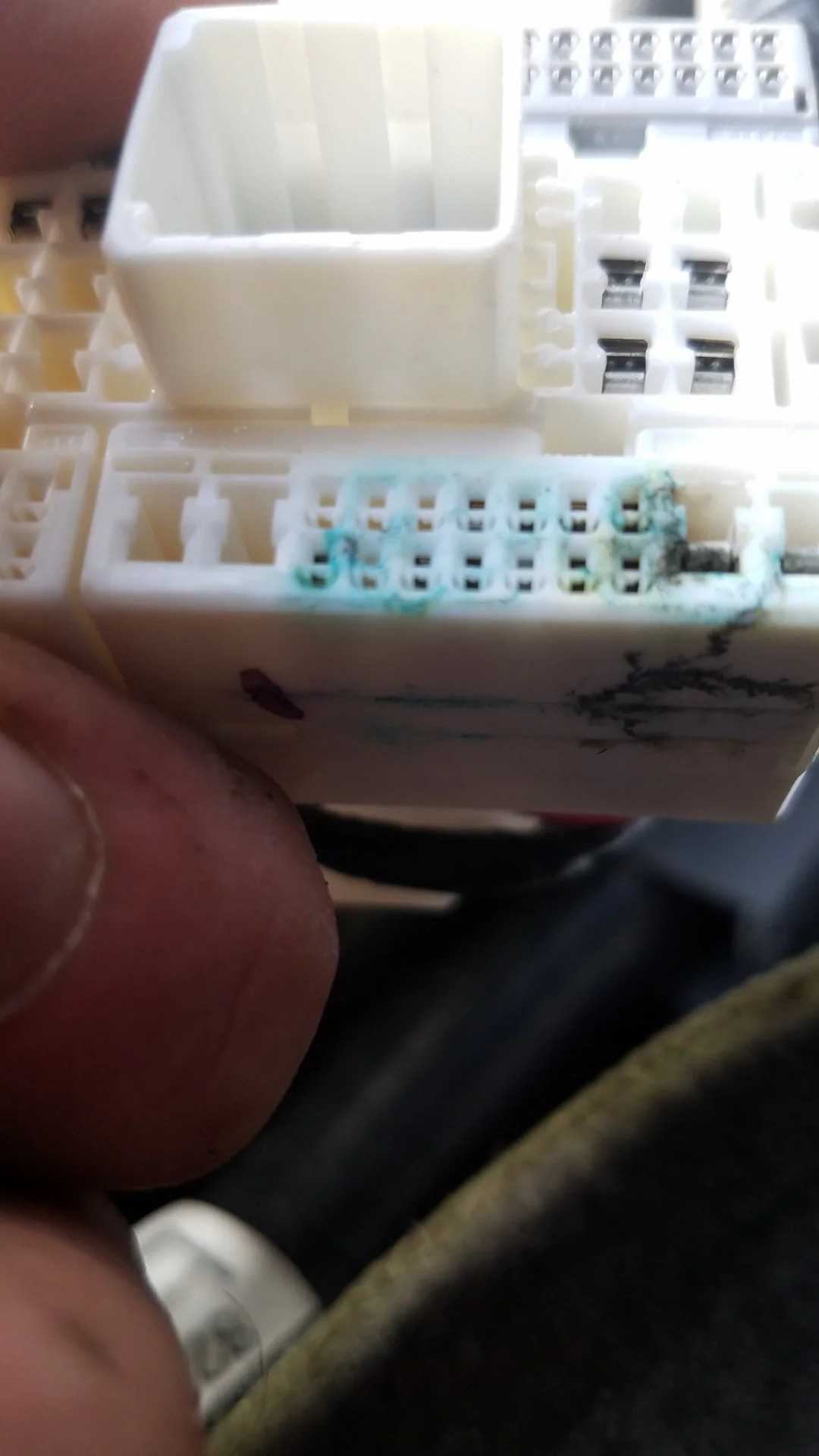

Nothing except, water intrusion. I parked on a hill a couple weeks ago nose down And noticed water in the driver side floorboard. It was wet under the dash

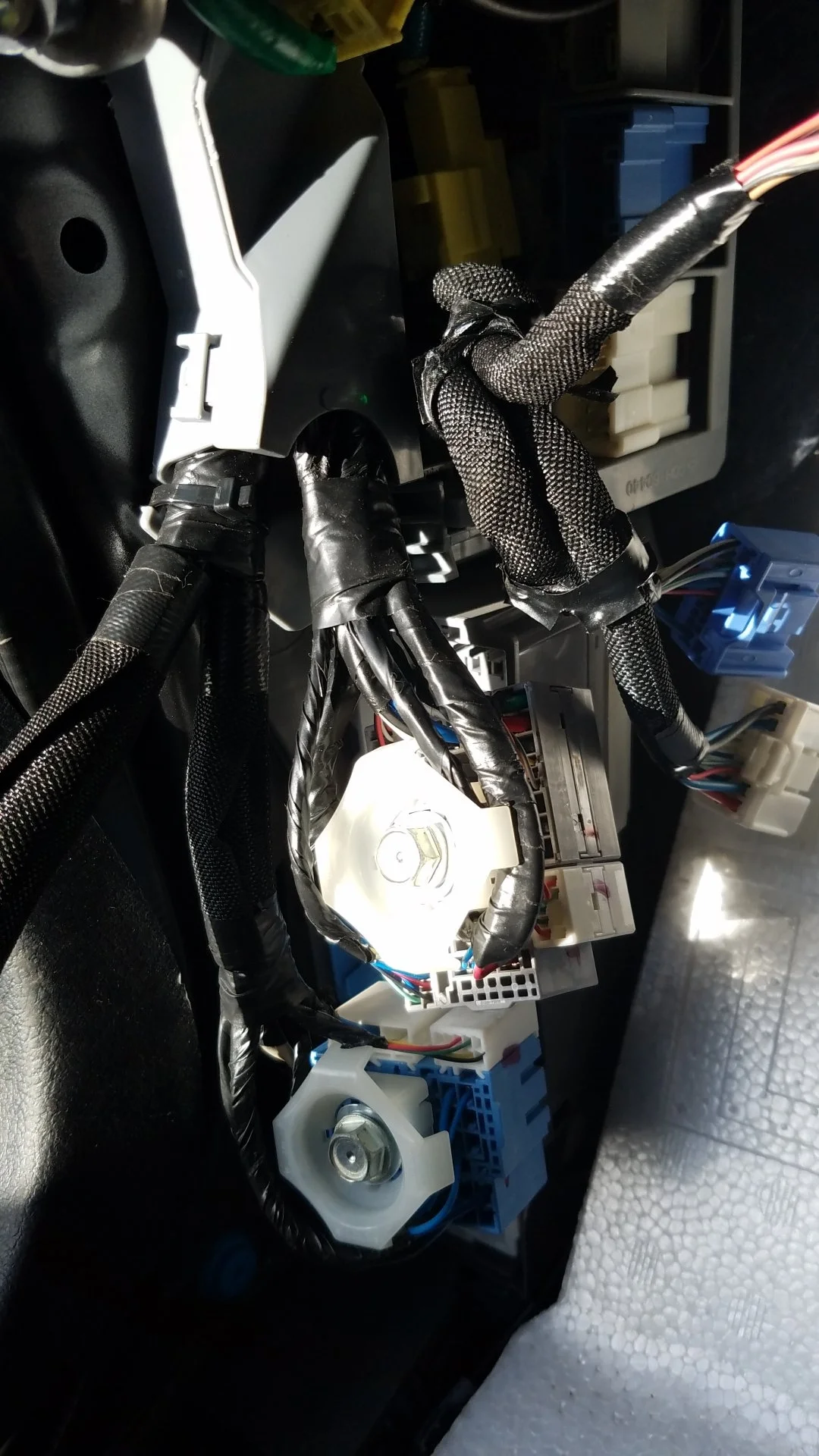

This will be the problem. Corroded or shorted connections from the water. Did you remove the carpet and/or associated trim to get the water out? You’ll need to do a complete drying sequence to dry everything.
The connectors by the kick panels are likely the source of issues. Open them carefully and look for corrosion. If the water has been there a while it is likely you will have a mess to deal with.
I definitely remember a post here a while back about someone dealing with the same issue. They used sole kind of contact cleaner and dielectric grease to get it all working. Unsure what to tell you to search for though.
