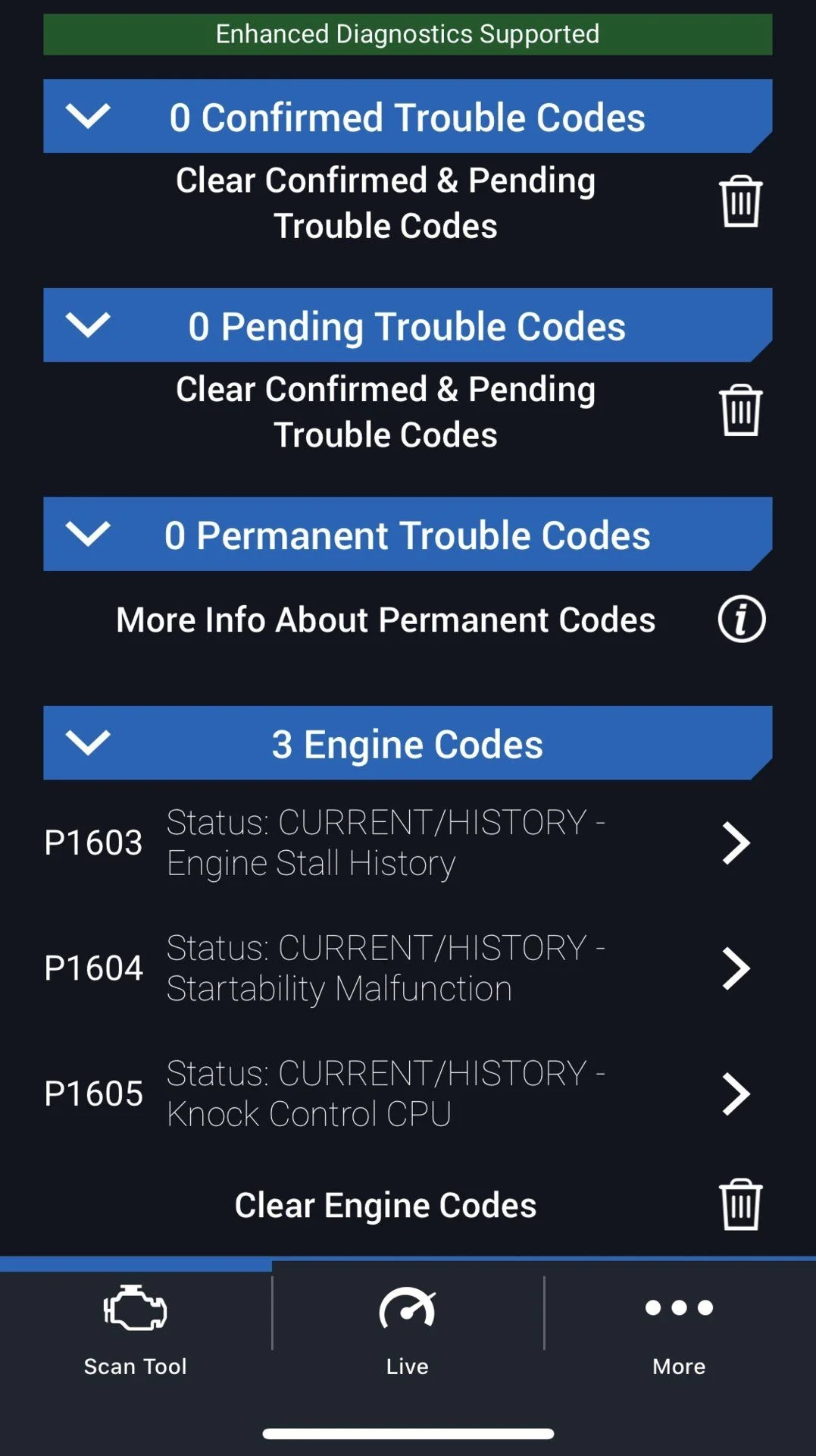

There are no check engine lights coming on. I ran a scan of all codes using my blue driver scan tool and the only ones that come up are P1603 Engine Stall and P1605 Knock Control CPU.

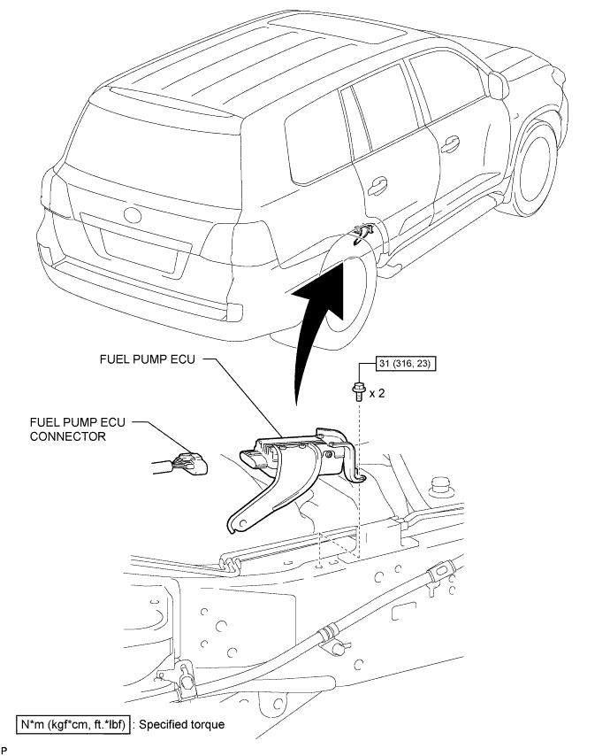

anyone got a pic of where this thing is? Or just tell me about where it is.
Passenger side behind second row seat
on top of frame rail, accessible from below.
