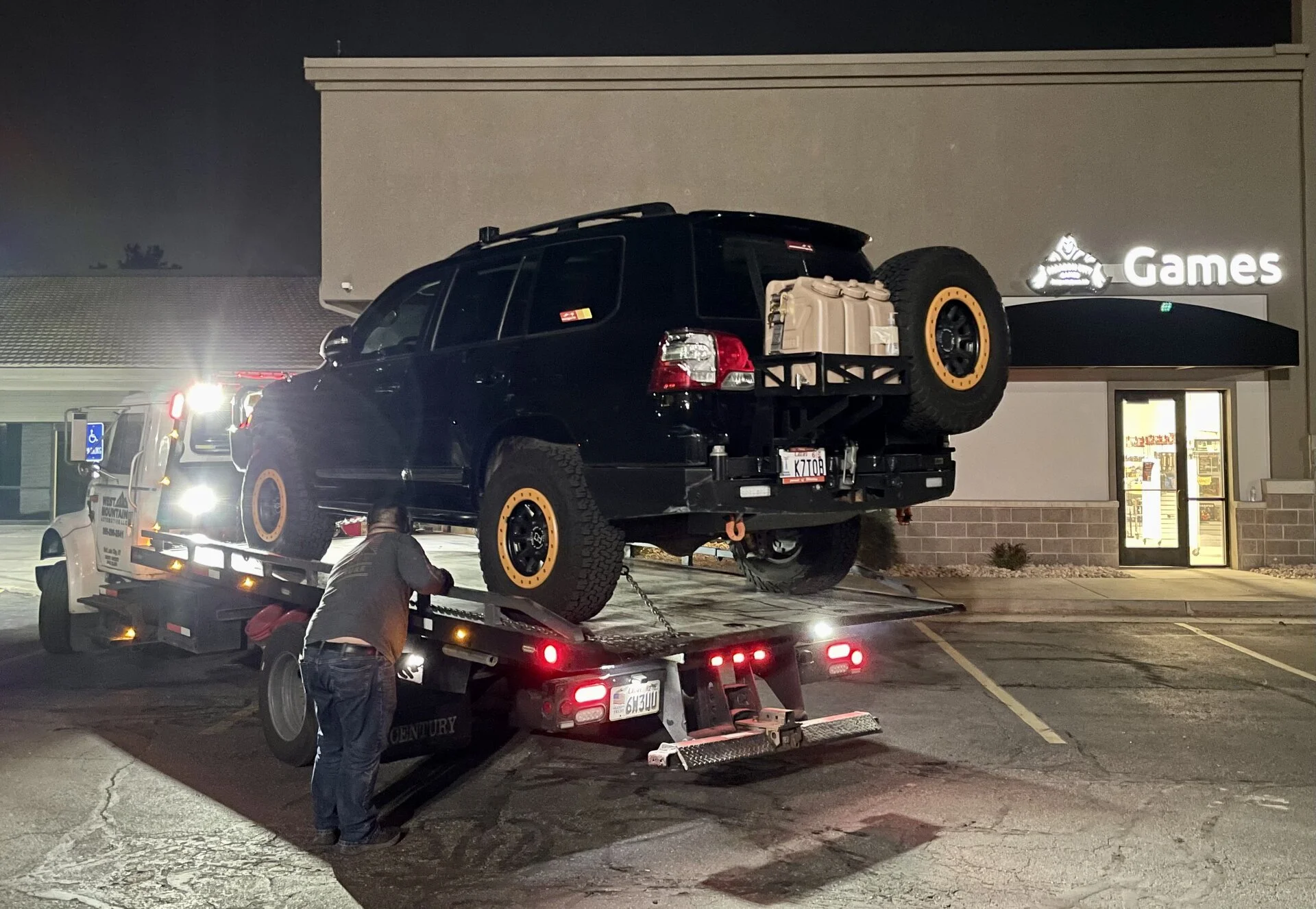

It was already a sad day. I was at the card shop with my 4yr old getting some guidance on how much I could sell some of my old school Magic: The Gathering cards I’ve had since the mid 90s for.

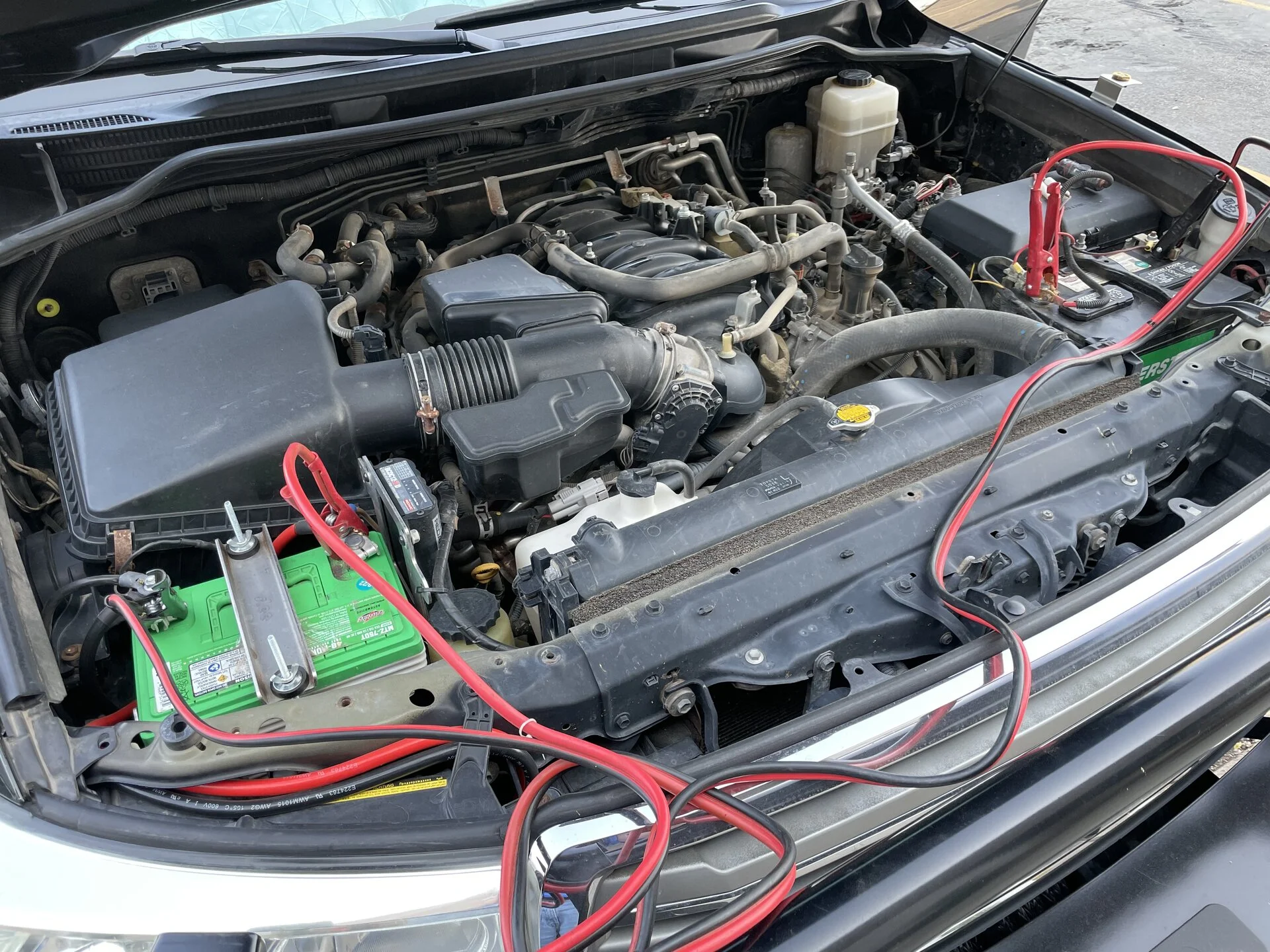

I was running pretty low on fuel so I filled all the way up at Chevron (my preferred fuel choice) on the way to the store. After finishing at the card shop, the cruiser no longer wanted to start. Just chugged and chugged. Luckily I keep a code reader in the car.
Some of the codes included P2401 and PO43E. Don’t ask me why I didn’t write them all down. I thought I could clear them and be on my way for some reason. Internet says these are related to evap stuff. It ran okay during the 15 min commute from the gas station to the game store.
But honestly, I think these codes might have already been in the system. The TRAC OFF, 4LO (flashing), and CEL all came on yesterday after sitting in the garage.
I thought I was being careful turning off everything, but in the end, I guess I tinkered around so much, that I couldn’t even jump start myself any longer. 🤦🏻‍♂️

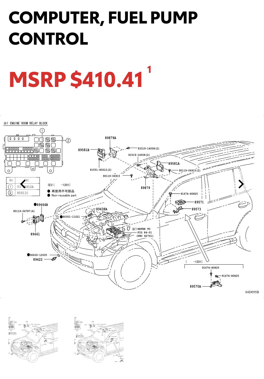

With power going in, but not coming out, it appears to be the fuel pump control box that’s bolted to the frame.

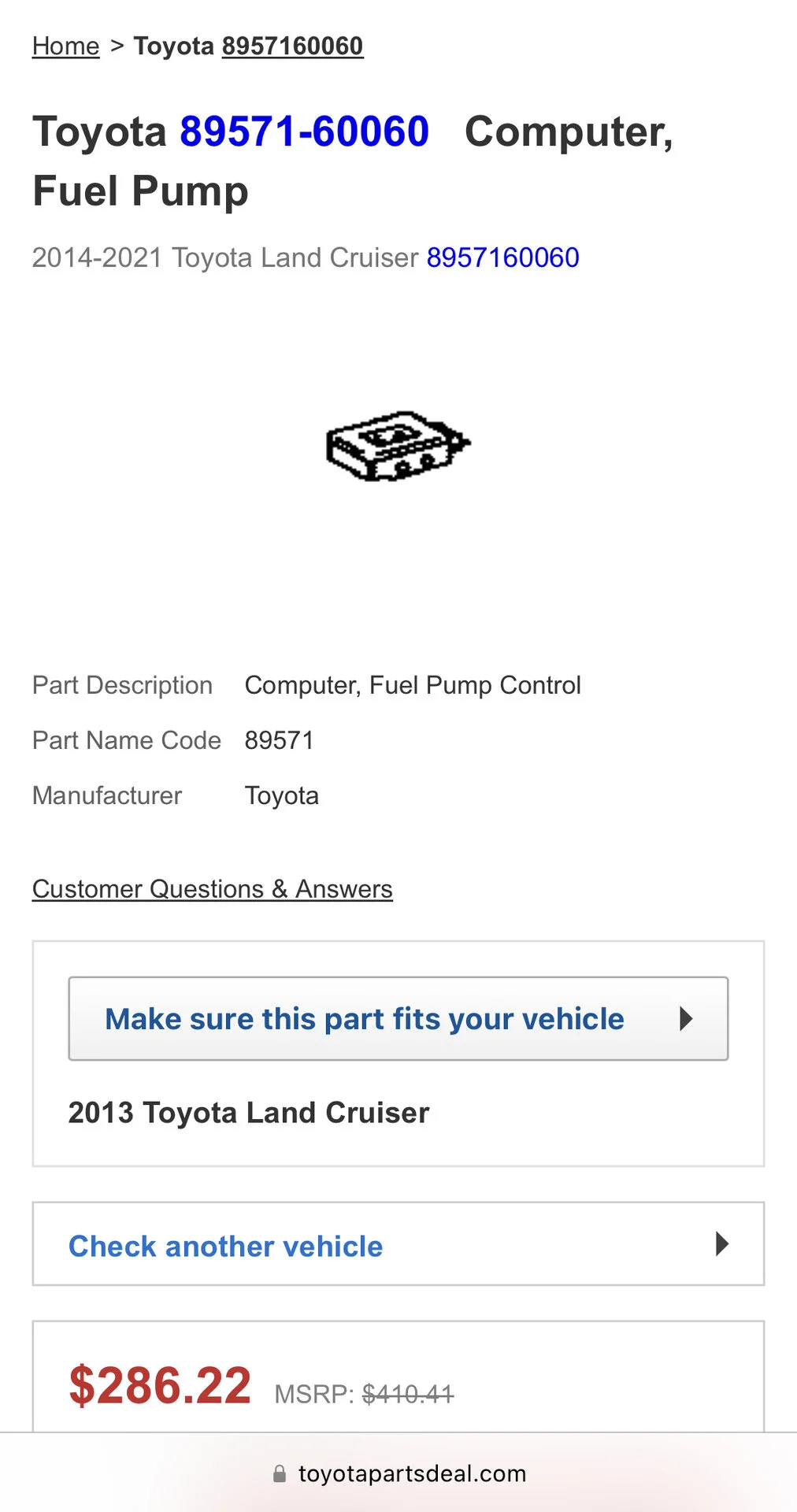

The part # is 89571-60060.
It also seems this is a dealer only part and the closest one to UT that we can find is a week out at Rochester Toyota in NY.

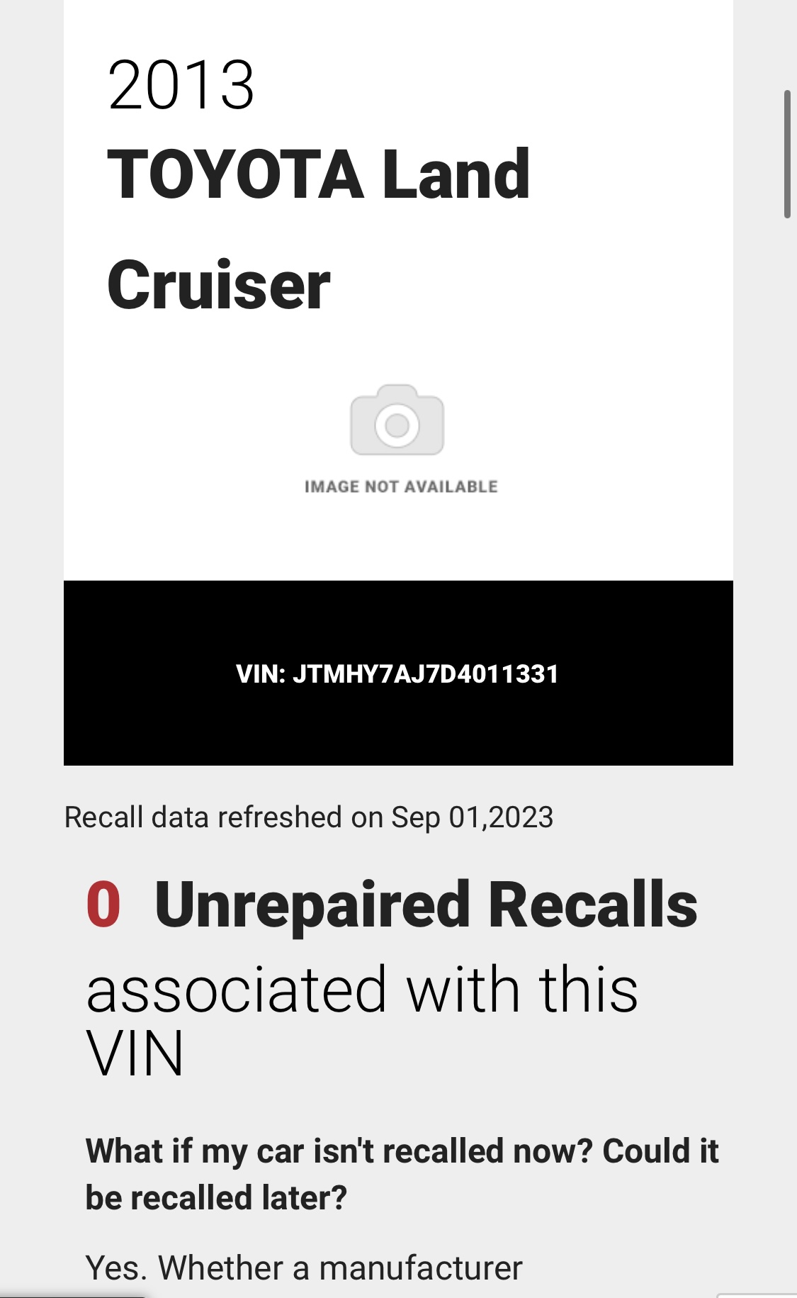

It sure seems like all the fuel pump ecus that go out are 2013 MY..
