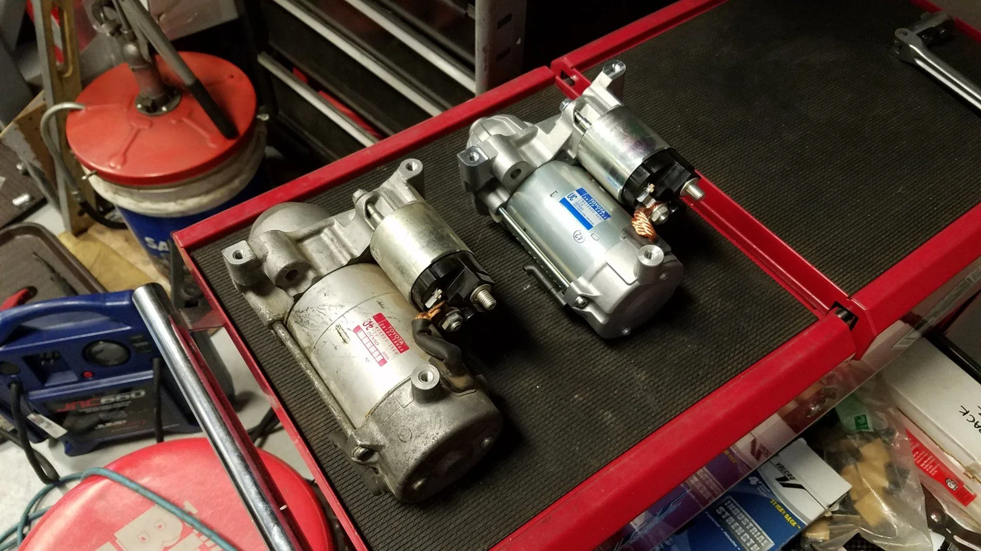

Starter Failure (No Warning)
I’ll see if I can make this follow the format as Ken suggests. I’m proactively replacing my starter to avoid being stranded somewhere.
A few 200 owners have had their starter fail abruptly, leaving them stranded. As I understand it, the failure is in the solenoid, which is attached to the starter motor. There's a way to jump it using a long screwdriver; once I understand that a bit better, I'll post it here.
The original-installed starter is a pretty large unit. The replacement starter is quite a bit smaller. I copied this pic from @cruiseroutfit. Original starter on left, new unit on right.
I'll be updating this more when I can. If you have info that should be added here, please let me or @Romer know, and we'll edit this thread to include it. Thanks!

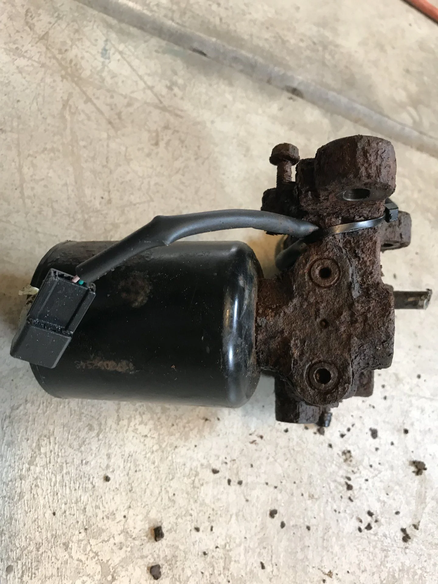

Rusted KDSS valves / accumulator
The KDSS valve housing + bolts appear to be the only undercarriage component that is not treated to inhibit rust. 2017 and earlier appear to have hex-bolts that like to break allen wrenches when the housing gets rusted. 2018+ have standard bolts, which is better, but the housing can still rust in almost no time (especially in northern / snowy / salty road states). Preventative maintenance is to cover the KDSS valve housing in something like LPS3 (spray-on, self-healing, wax-like protectant) or marine grease.
final cost of KDSS valve was $2626.00 The cannon ball that my brother brought up from the bottom of the ocean had less rust. the vehicle has been in service since Jan 2012 and has some surface rust on the rear end, but not like this. I always thought that the screwulater valve was a joke: Toyota calls it a KDSS accumulator. New one is getting coated with fluid film or LPS3.
