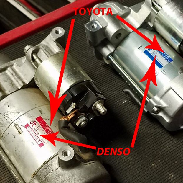

I was just thinking why would i go for OEM starter if it only lasted 128k.
Would it be a smart move to go with a denso instead? Or is the OEM supplied by denso?

Thanks for the link tonyp the picture in there that kurt had posted answers my question.
It appears that the oem starter is denso and interestingly the new smaller version shows toyota.
They both show Toyota and Denso ...
20171023_140144-jpg.1560835

You'll be glad it's smaller when you go to install it :D
Just to be clear:
