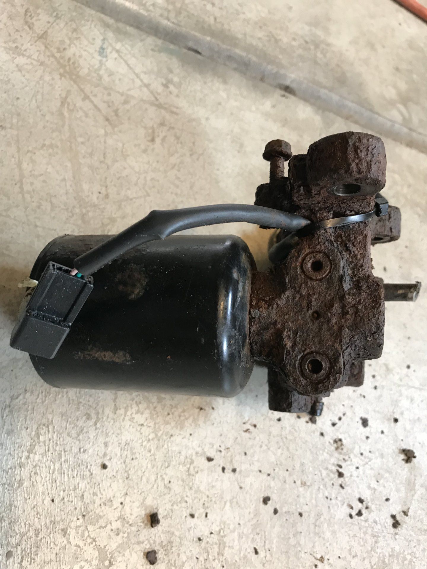

final cost of KDSS valve was $2626.00 The cannon ball that my brother brought up from the bottom of the ocean had less rust. the vehicle has been in service since Jan 2012 and has some surface rust on the rear end, but not like this. I always thought that the screwulater valve was a joke: Toyota calls it a KDSS accumulator. New one is getting coated with fluid film or LPS3.

I really wish I knew what that electrical harness is for
the electrical harness goes to what looks like some type of pressure swit
if you look at the lower left of picture you can see a pressure sensor or something. So, I would guess that if the pressure fails a warning light would come up some where in the system.

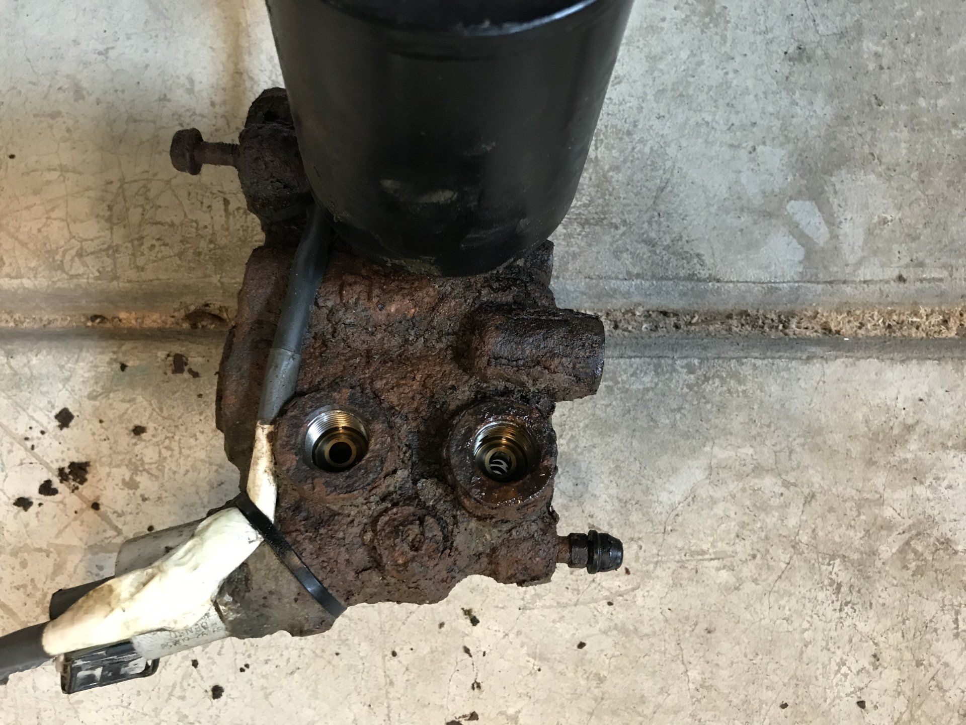

Interesting. I thought I remember crawling around under my 2013 and couldn’t find any wires at all.
From these pics it would seem coating just the bottom unpainted surface of the unit isn’t enough..
Or are we thinking the corrosion started there, got under the paint, and spread like cancer?

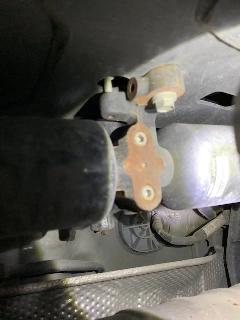

Thanks for the warning on this. Can anyone comment on my KDSS situation? I took a pic, and see some rust, but doesnt seem quite as bad as yours OP.
Many, many people would be jealous of your KDSS situation. Looks great.
I'd still verify the screws turn, but I'm betting you wont have any trouble. Put the truck on level ground and MAKE SURE YOU DON'T GO PAST THREE TURNS. Really no need to go the full three unless you are trying to reset the system. If you go with a socket to allen bit, make sure it's high quality and adapters to 3/8" drive as close to the bit as possible will help with flex. The torque setting is quite low, 10ft-lb. Highly advise you don't just go crazy on them.. get a torque wrench that will cover it. In-lb can make it more precise.
Beyond that, just clean it up with a wire brush, coat liberally with LPS3, and button it up. I then clean and re-coat once per year.
