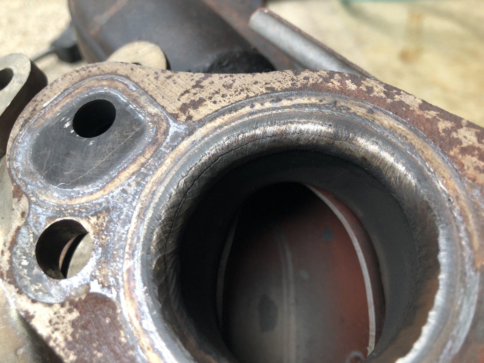

I couldn’t get the broken and galled studs out (sold my welder a while back. NEVER sell your welder) so I took it to a machine shop. They said they had trouble with them. Very evident by the galled holes left behind and obvious heavy use of a torch.
Well I didn’t notice it until I get home to clean it up and reinstall and now there is a crack on the rear port. Confirmed that it leaks with soap and compressed air. No soot on the other side and I don’t remember hearing a leak.. pretty sure it’s new. But, I can’t prove the machine shop did it so I’m buying a manifold.
Yes a good welding shop could probably fix this but I don’t have one I trust yet, don’t want to deal with the risk of it cracking later and having to repeat all the work, and the downpipe stud holes are pretty ****ed as well.
Oh and they are on backorder.
Use more PB blaster. And -never- sell your welder.
