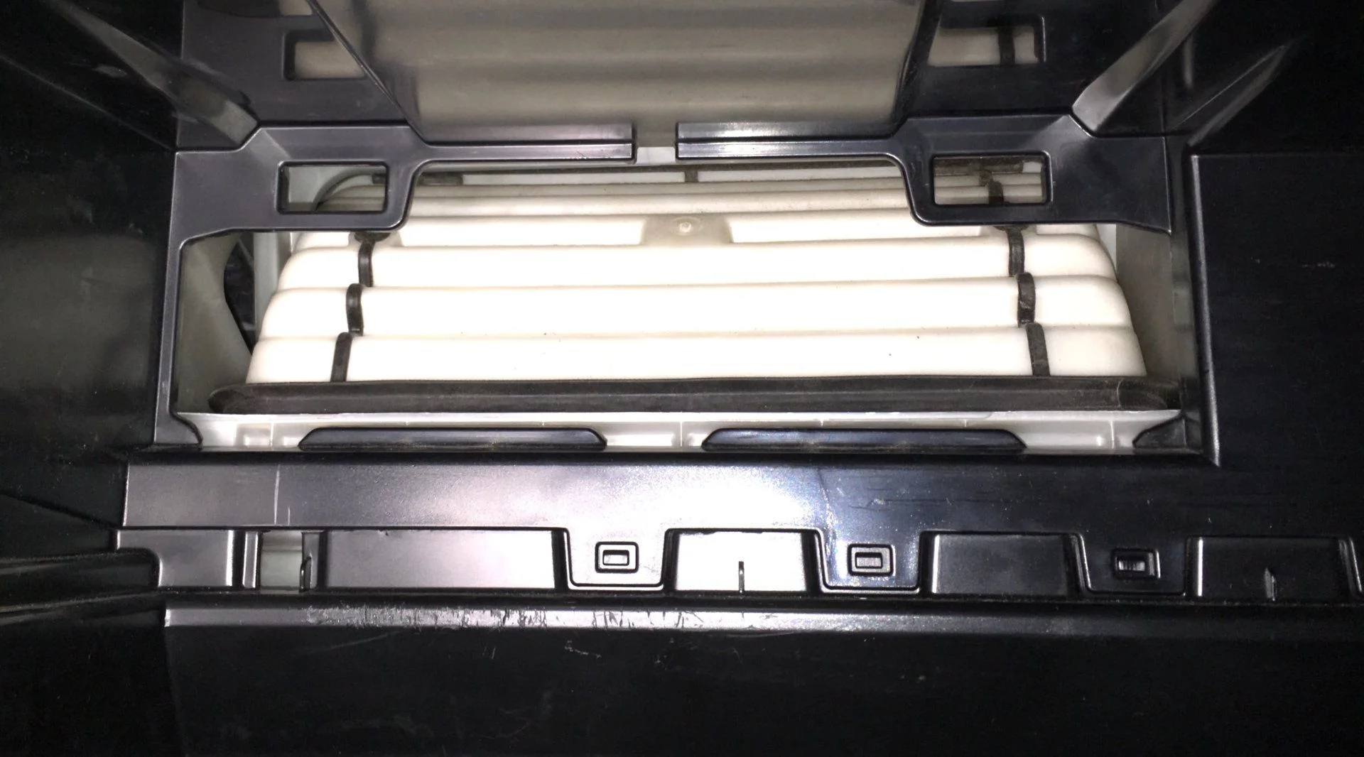

Inspect the recirc door, it should look like this, the cabin filter is visible below it:

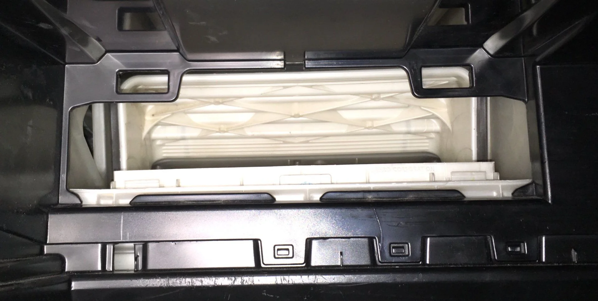

Turn ignition ON and operate the door by cycling the Recirc off and on. You should see this when Recirc is OFF, the door has rotated down:
If the door operates smoothly without any problems, great. Change the filter if it is dirty and put it back together.
If the door sticks or binds there is a problem with the linkage.
If the door does not move the outboard hinge hole or linkage shaft is broken or stripped. Grab the upper edge of the door and move it full travel, and you should be able to get an idea where the problem is. Push the door DOWN and leave it there if your door is screwed up!!! That will give you the best defrost operation in winter.

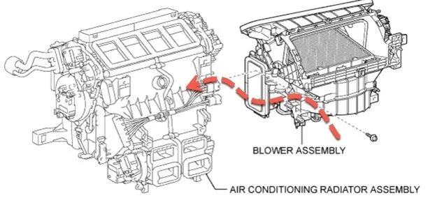

If your door is screwed up you will have to remove this blower assembly, on the right:
It might be possible to repair the damage. The street cost of a new assembly including fan and motor is $425+. I am researching whether or not sub-parts are available.

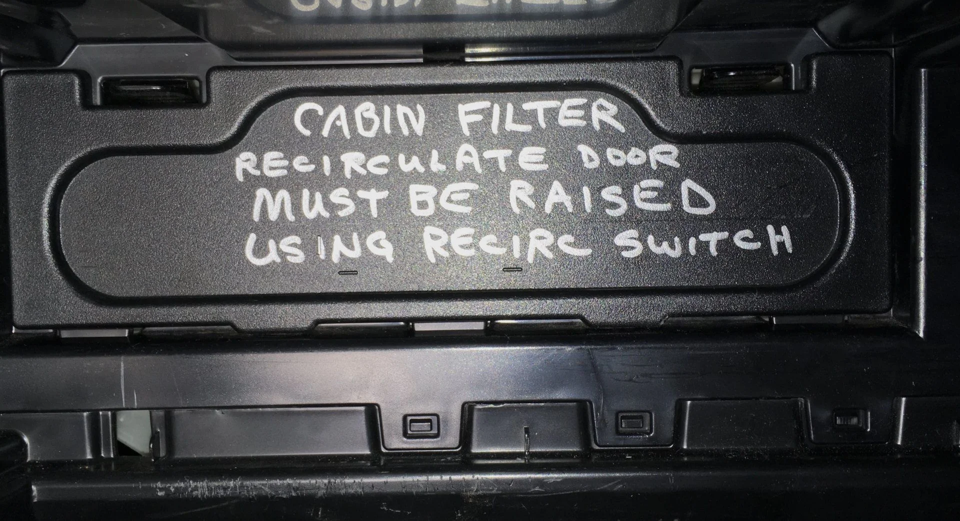

Finally, write a warning on the filter cover, to prevent the next clueless drone from destroying the door:

GREAT idea to write on the access plate that you need to use the recirculate button! It is likely a very common "mistake" to force that sliding door up to access the filter (never to close again). :doh:

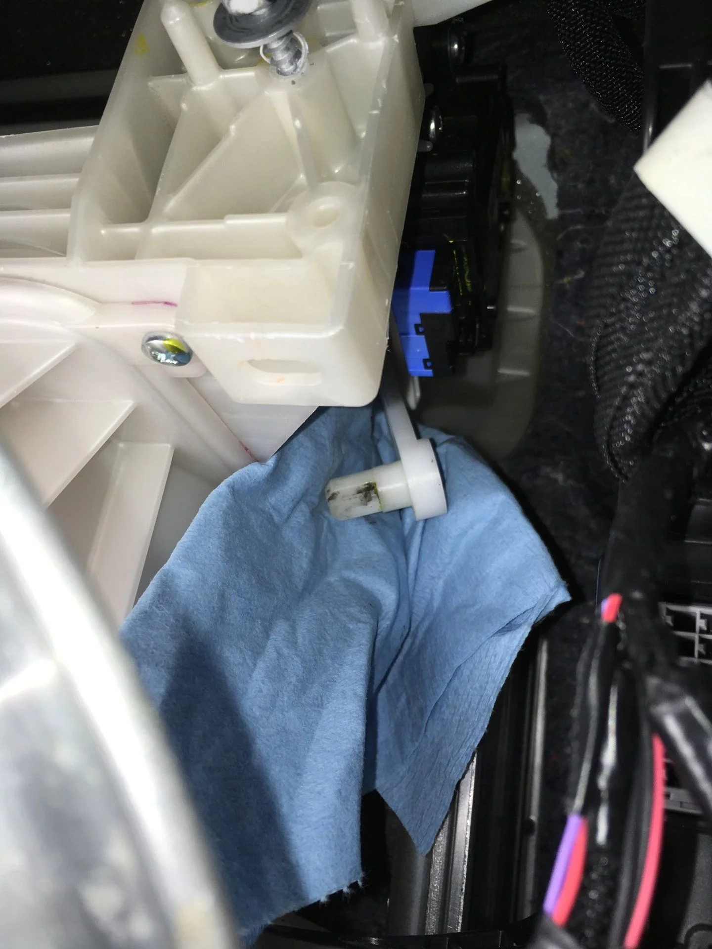

The shaft that goes into the door has grease on it, so try to retract it manually out to where you can get to it, and clean it and the door hole squeaky clean. You can access this area by removing the airbag and glovebox, and the module bracket that is directly in line with the actuator.
You can try spraying contact cleaner in there and just hope for the best, but it won’t be what you would call a high quality repair. Good luck.

If you pull the entire box out, you should be able to split the halves (screws) and get the door out easily, unless the halves are gued also.

I don't mind pulling the entire box, the only issue is the FSM calls for dash (and A/C) removal for pulling the box. That seems a bit overblown from what I see. I'll give it a go this weekend and see what I can come up with.
