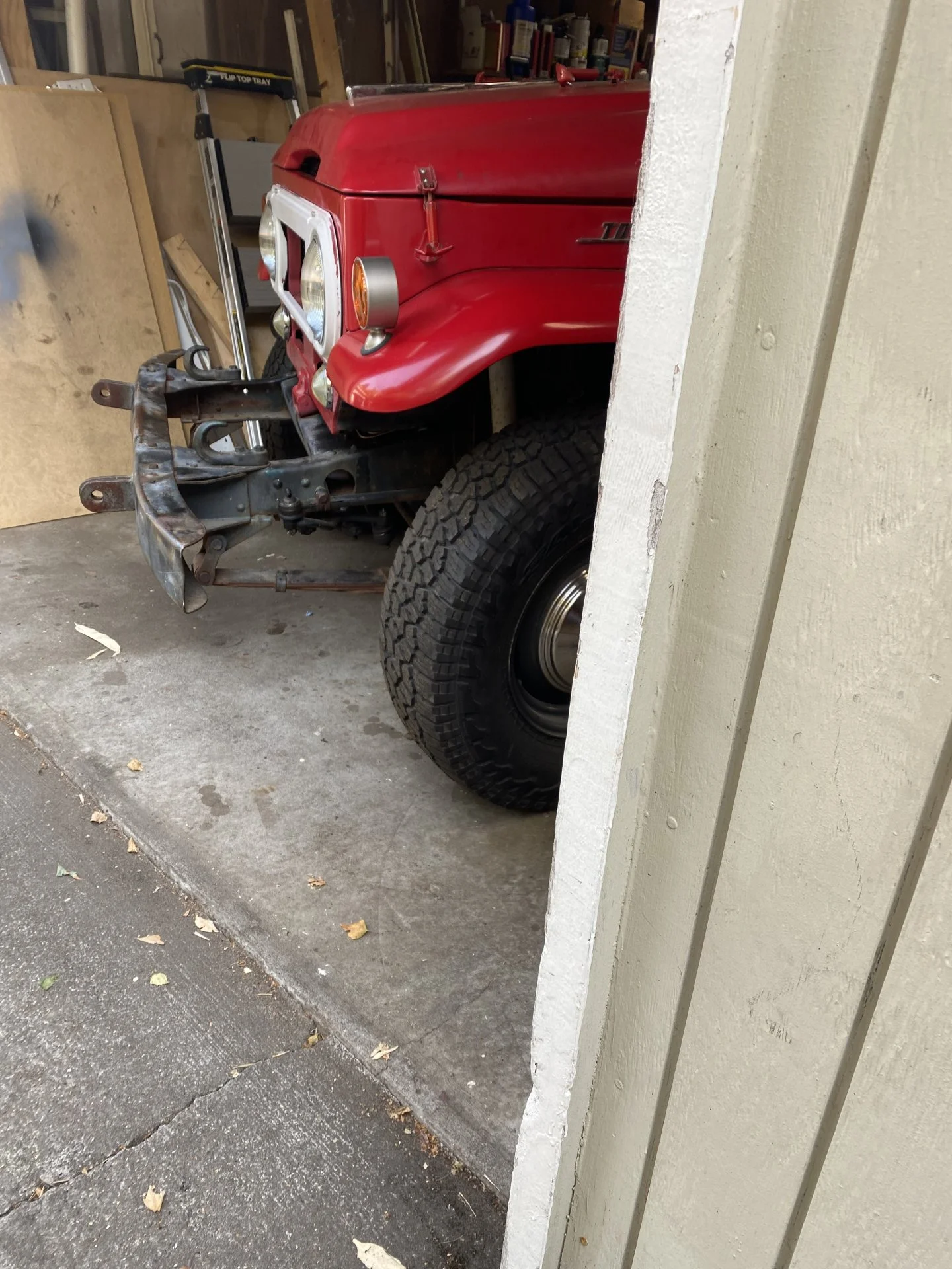

It got a brief moment outside before having to sulk back into the garage with a couple more issues. Hahaha. Took a bit to get it started with all the air in the gas lines. But it’s running well now. Still need to tune better and resolve a sticking throttle on the low end. Close!
There was a crazy weird rattling sound when I let out the clutch to drive forward. And the voltage regulator is buzzing like a swarm of bees. I think it could be a ground issue…

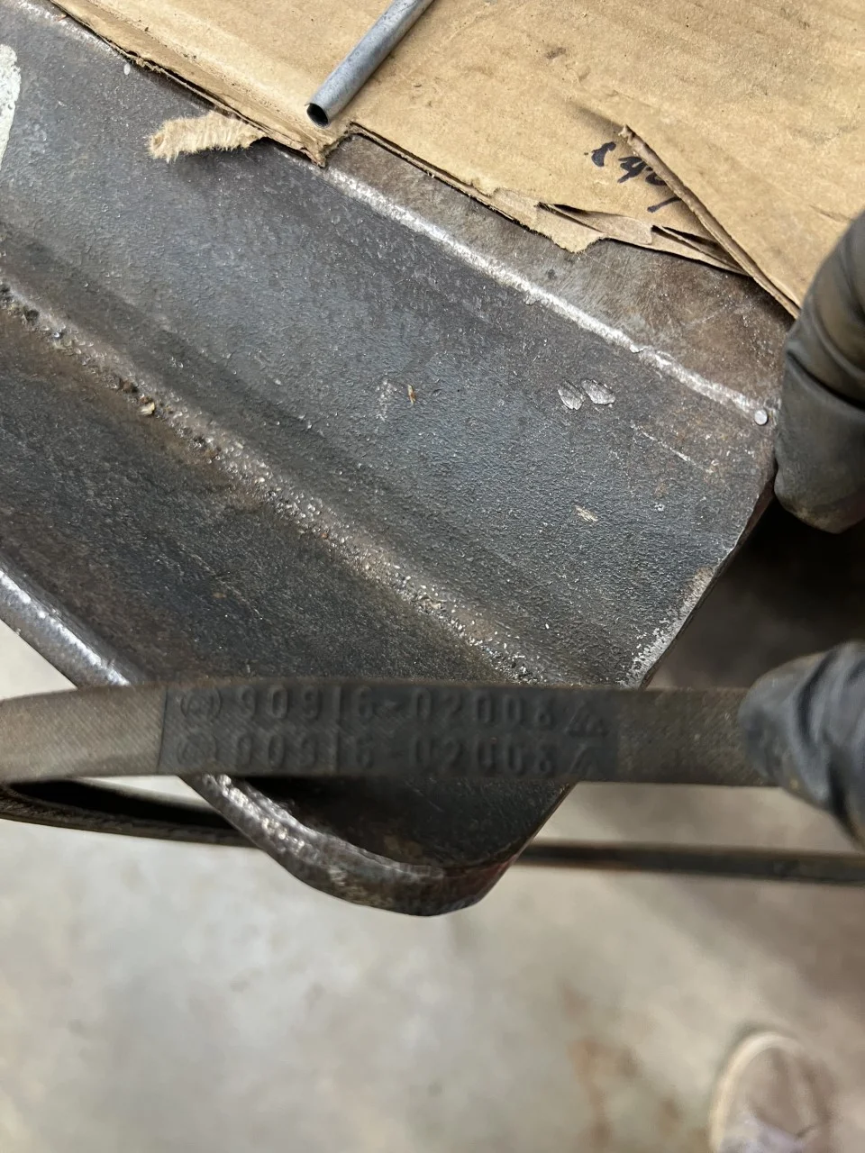

Anyone know if a OEM belt is still available for the F135? I ordered a 9932301040 and that was definitely not right. Too wide.
Coincidentally, Anyone need a 9932301040 ? :slap:
Did you ever locate a belt? I just pulled my and noticed this part number. Doesn't look like Toyota still has it available but hopefully this helps. Keep me posted because I need one 😂
I ended up using a NAPA belt. It would be cool to find a Toyota replacement at some point. This was the same belt I put on in 2007 when I sold it. :)

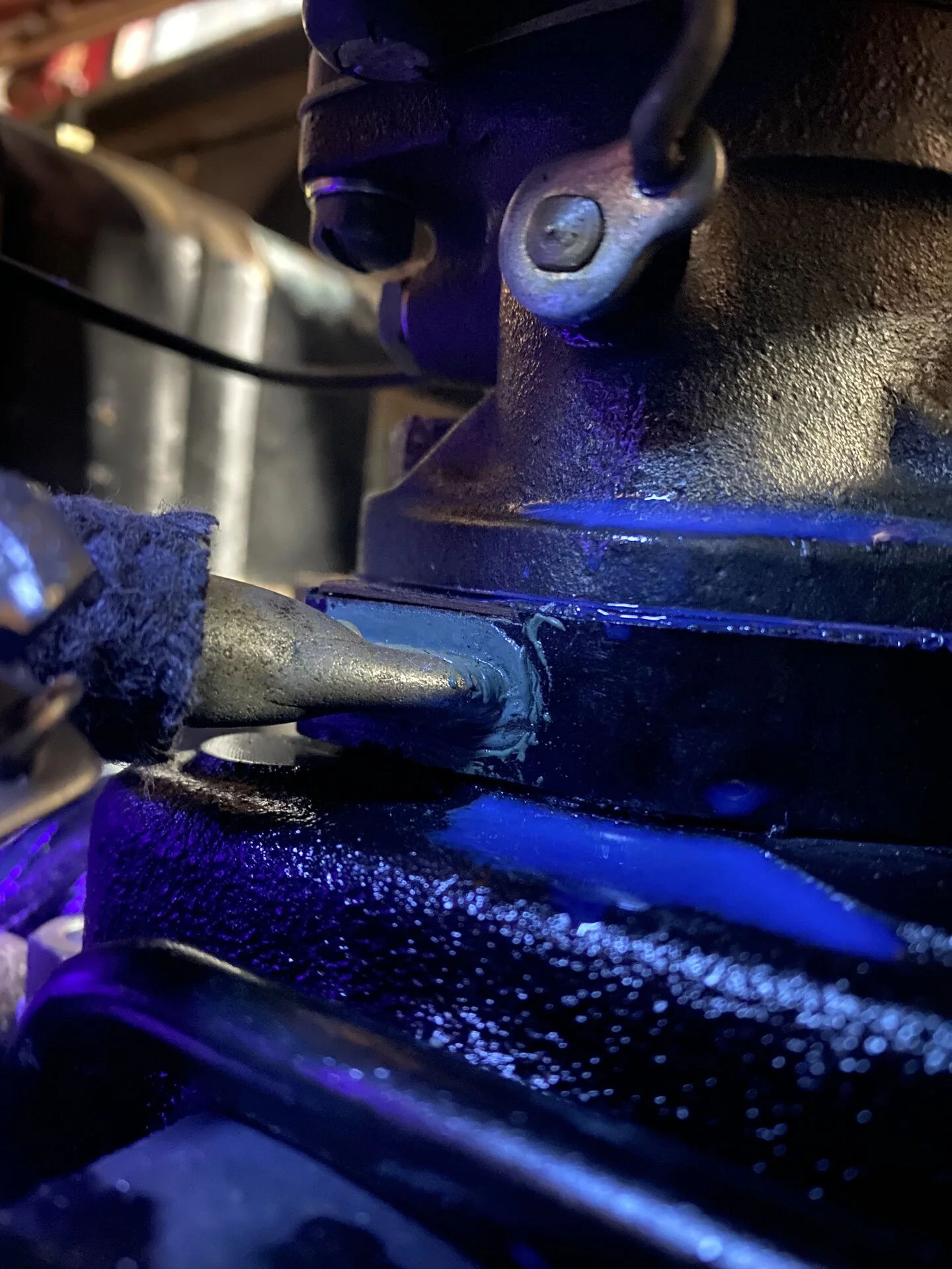

So I had time to mess with this more tonight. I hooked up the smoke machine to the top of the carb and turned it all on. It was definitely kinda tricky to see the smoke! I used a black light flashlight and that helped visualize it. On this first pass I noticed that smoke and fluid was coming out of the throttle shaft! But I am not sure that is the issue.
The garage was 27 degrees.. so all the metal on the truck was very cold and the fog was condensing and I think that inhibited how far it traveled in the system. I need to warm the truck up and try again. Second this bogging down happened to me on this same truck before I put on this rebuilt carb and replaced the manifold gaskets.... so it wouldn't seem like the those would be the culprits... but you never know I guess.
You can see the leaking and condensed fog fluid pooling on the carb:
I think the next step is to try this again when the truck is warmed up. I am hoping its not the throttle shaft as I am not even sure that is a fixable issue...?
When it's running, if you hit that throttle shaft with some carb cleaner or starting fluid and the idle jumps, then yep, you've got a hogged out throttle shaft.
If it's not to bad, you should be able to adjust the idle mixture to counteract it. I've haven't done this myself but I've seen a few guys hollow out the hole and install a brass bushing.
If it's not too bad, you should be able to adjust the idle mixture to counteract it. I've haven't done this myself but I've seen a few guys hollow out the hole and install a brass bushing.

Not sure how much of a vacuum leak problem that is around your throttle shaft, definitely a nuisance from fuel escaping. As @rainingagain said, I’d check that with engine running and spraying carb cleaner on it, that will tell you right away if it’s causing running issues. GL.
