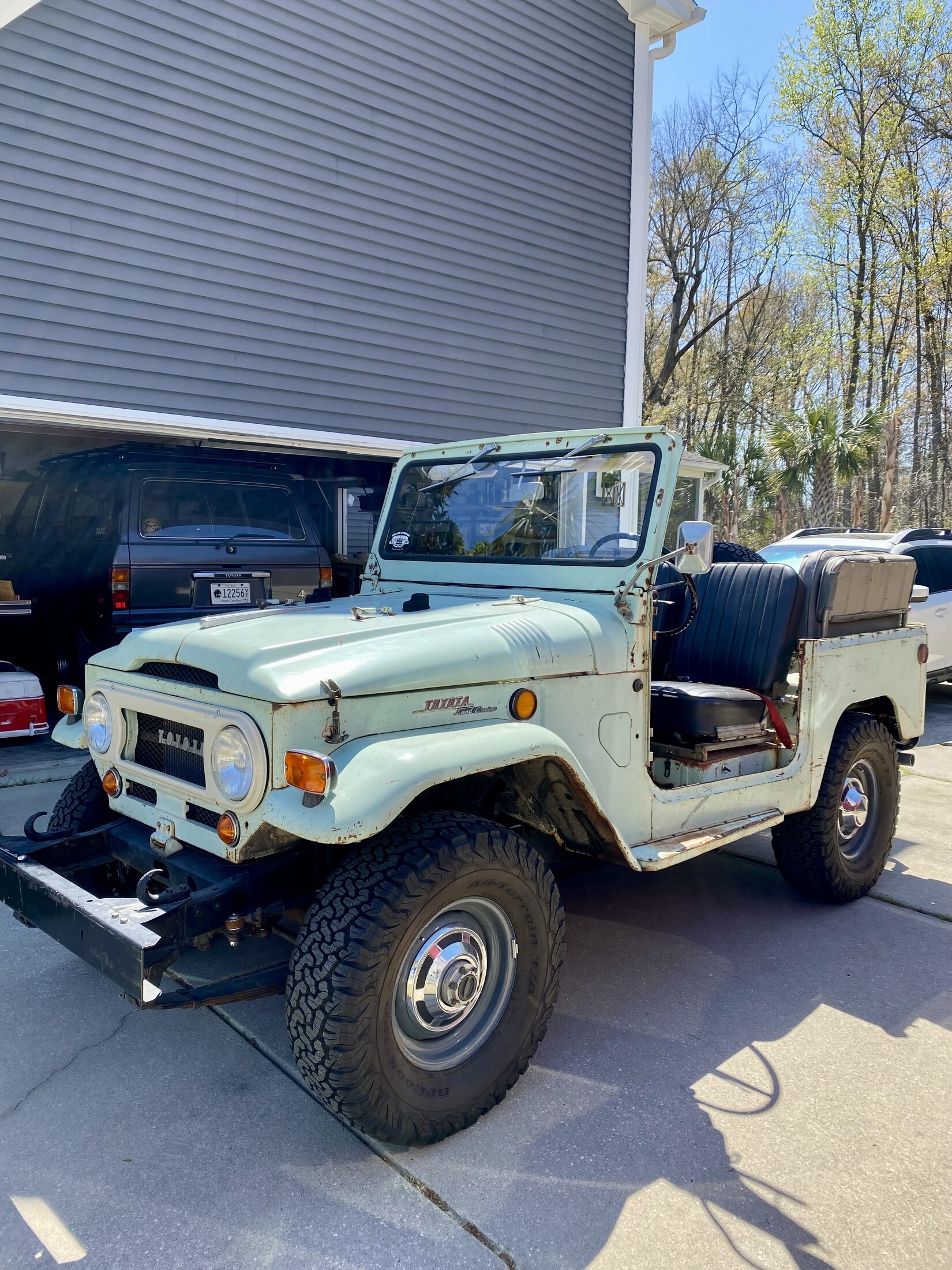

Well this is more of a continuation build than a start. I just took delivery of this beauty after a long, safe, well protected coast to coast journey. This Spring Green 69 has been tastefully updated by @Mightymes and just recently serviced by Valley Hybrids who assisted in storage and shipping - thank you! At the recommendation of @orangefj45 I used Optimus Shipping. Highly recommend. The 40 was in good company!
As my intended use for it is daily enjoyment and surf trips to the beach, the soft top and frame were removed (wouldn’t fit in garage anyway) and she’s tucked (stuffed) away for now.
First items on the list are preserving this beautiful patina and protecting the chassis from this salty air.
Front disc conversion and Dobinsons suspension next in line.

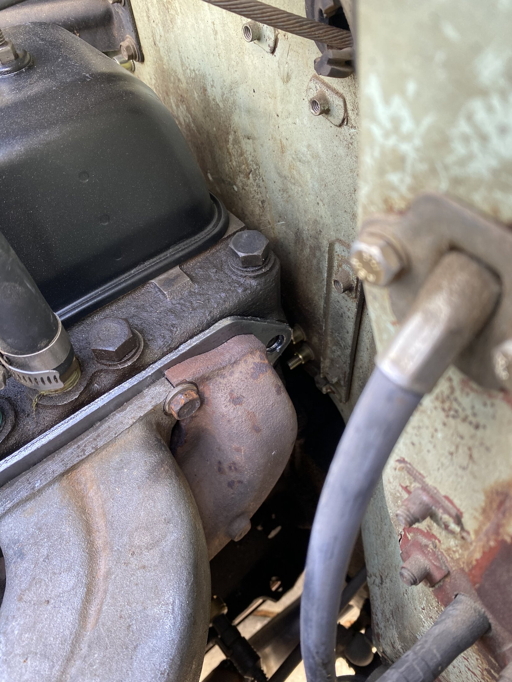

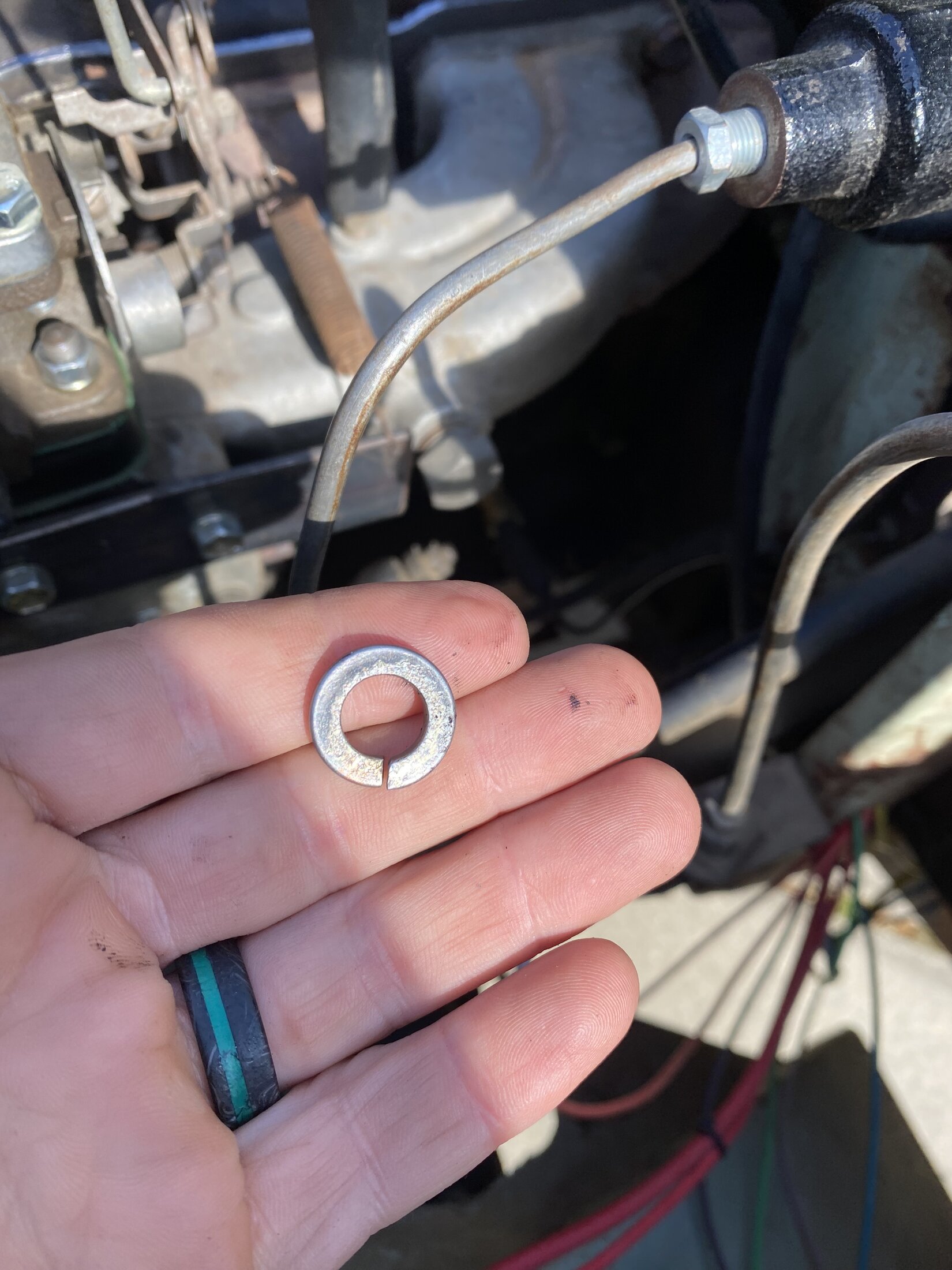

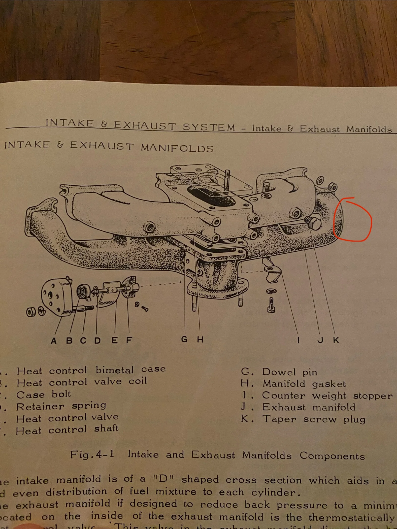

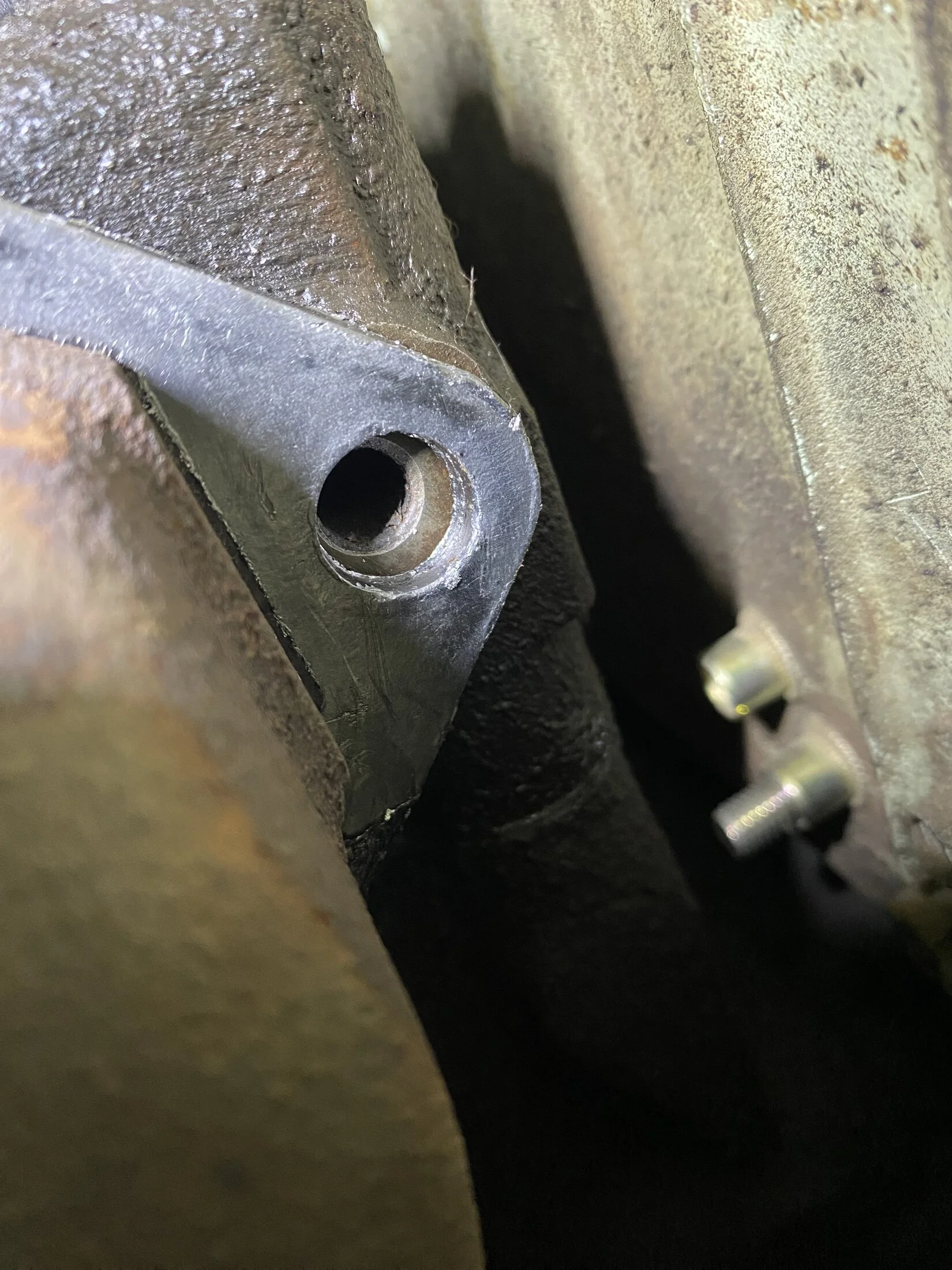

Giving everything a once-over and noticed a lock washer just sitting on the block lip at the oil pan. Then noticed I’m missing a stud/bolt on the rear most spot on the head. Had to pull her back into the garage cuz the no-see-ums were absolutely savage tonight.
According to the FSM, and a visual inspection, the manifold doesn’t have mounting provisions there.
What am I missing?
Giving everything a once-over and noticed a lock washer just sitting on the block lip at the oil pan. Then noticed I’m missing a stud/bolt on the rear most spot on the head. Had to pull her back into the garage cuz the no-see-ums were absolutely savage tonight. View attachment 3871936View attachment 3871937View attachment 3871938
What am I missing?
My 69 has a lifting hook there.

Excellent! Thanks. Wonder if I can source one of those still.
Put up a wanted ad in the classifieds. I'm sure someone has one. Glad to see you got your Spring Green 40 you were looking for.

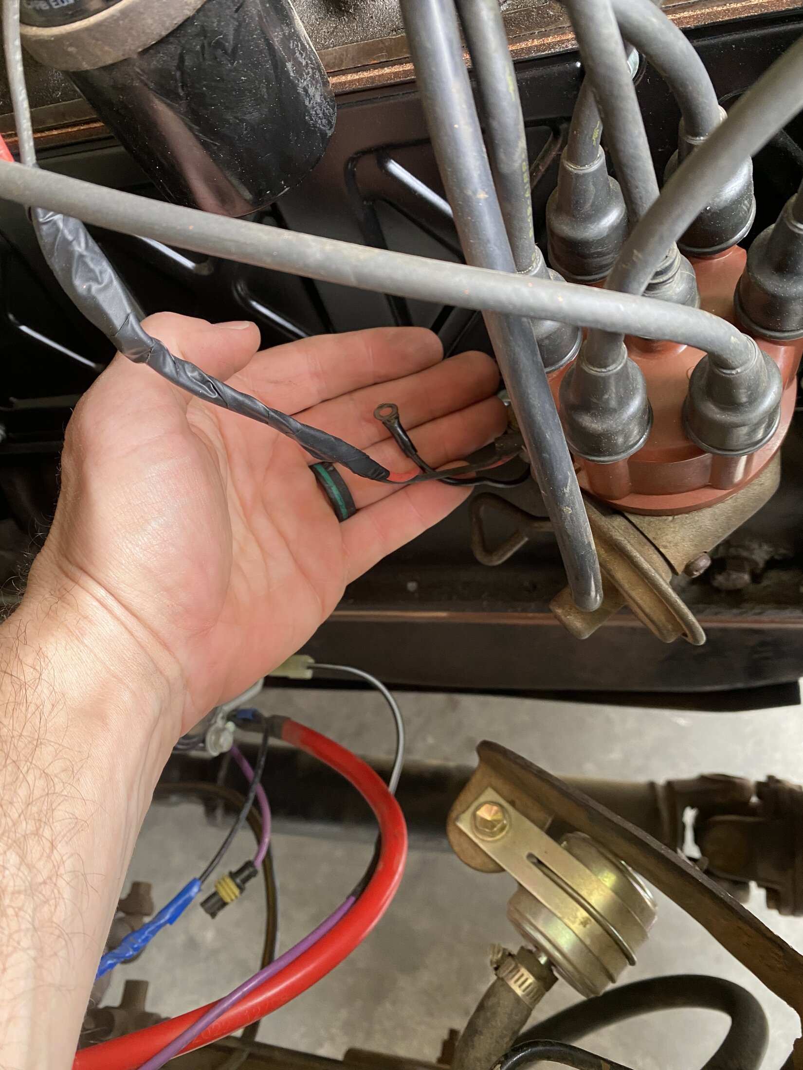

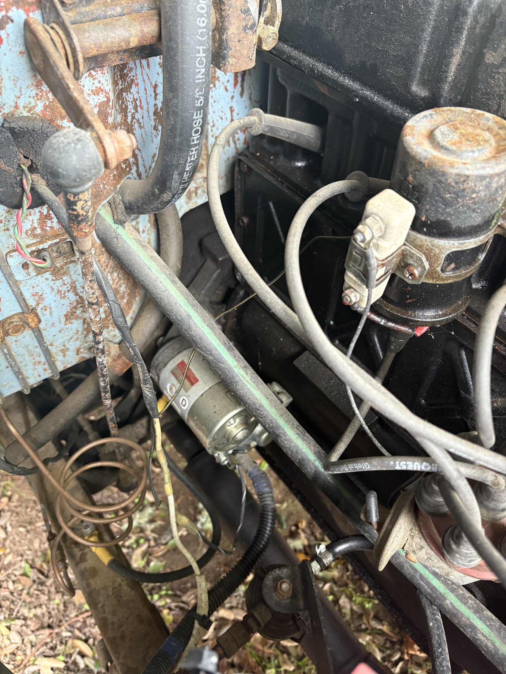

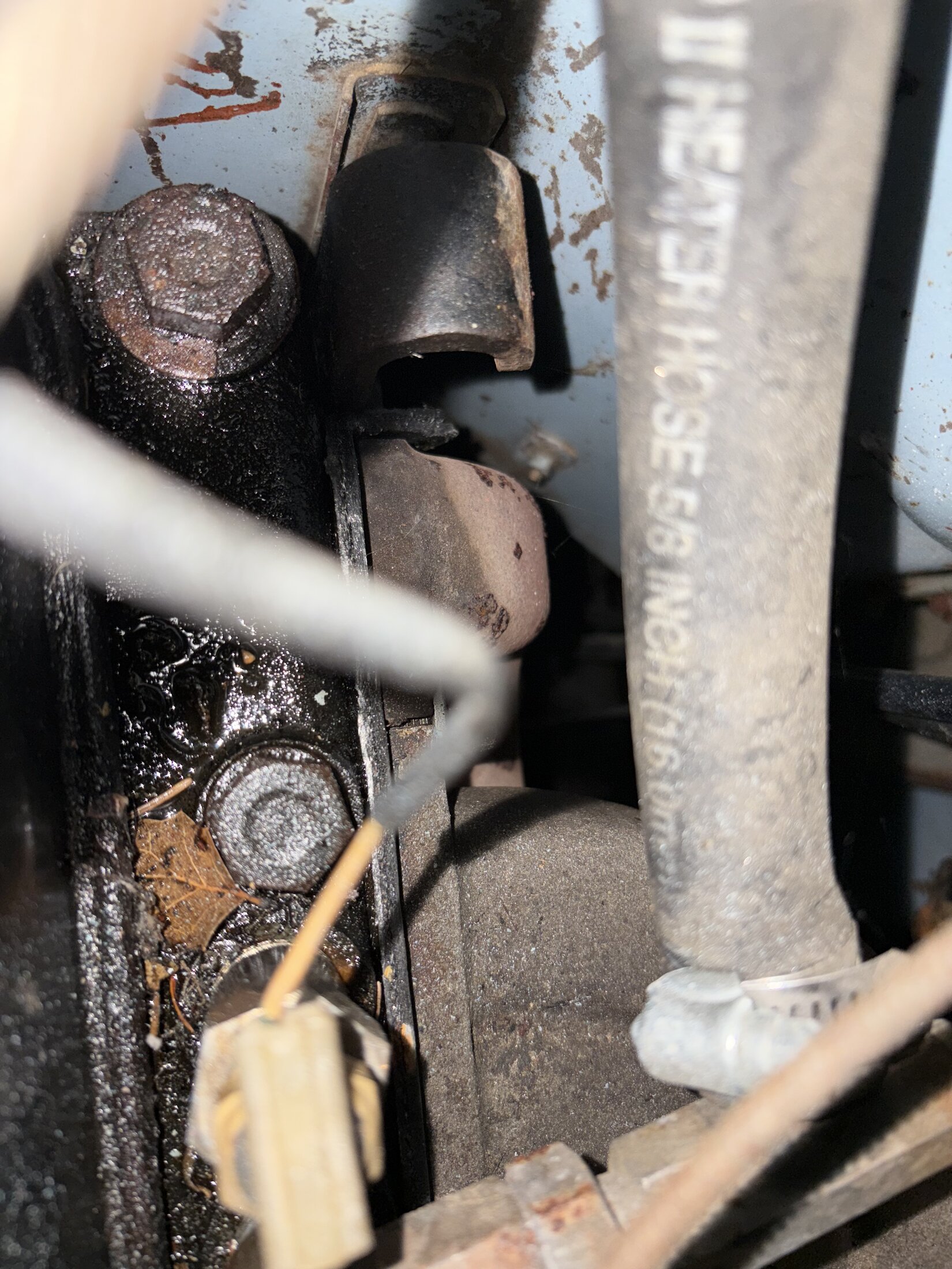

Anyone know if this is a ground? Not sure where it should be.

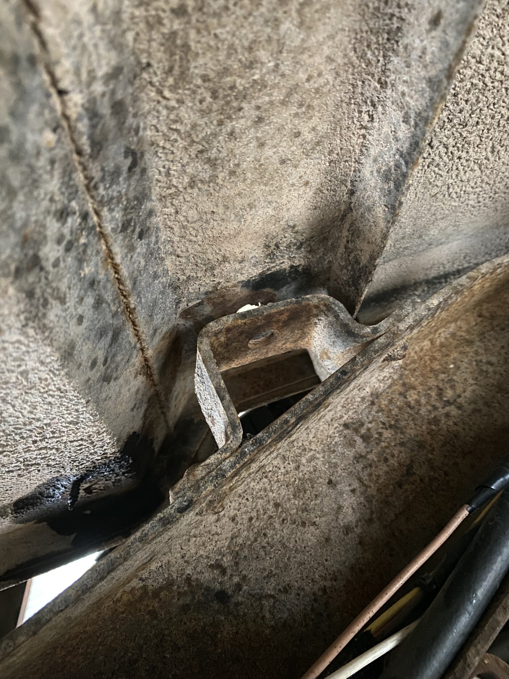

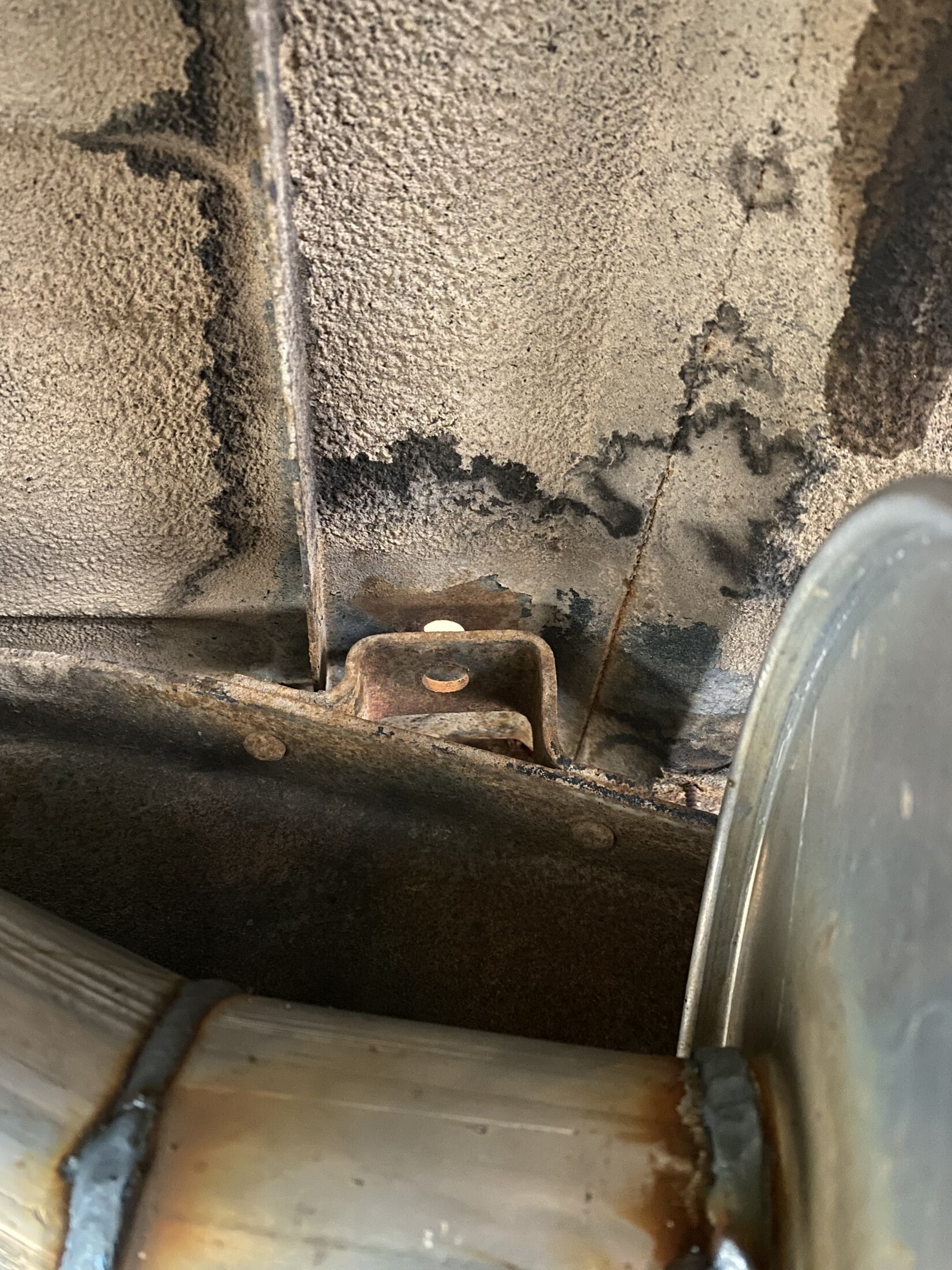

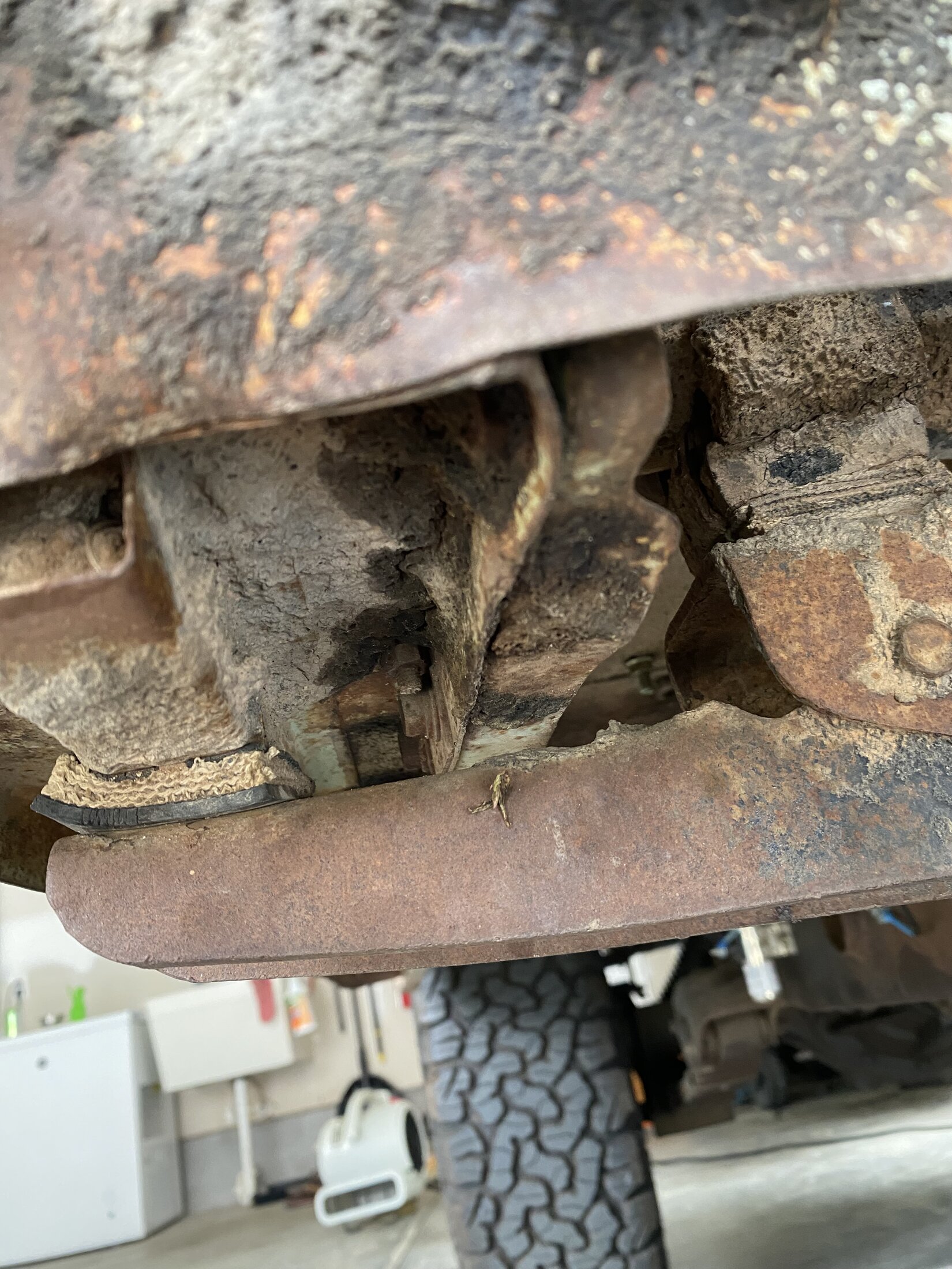

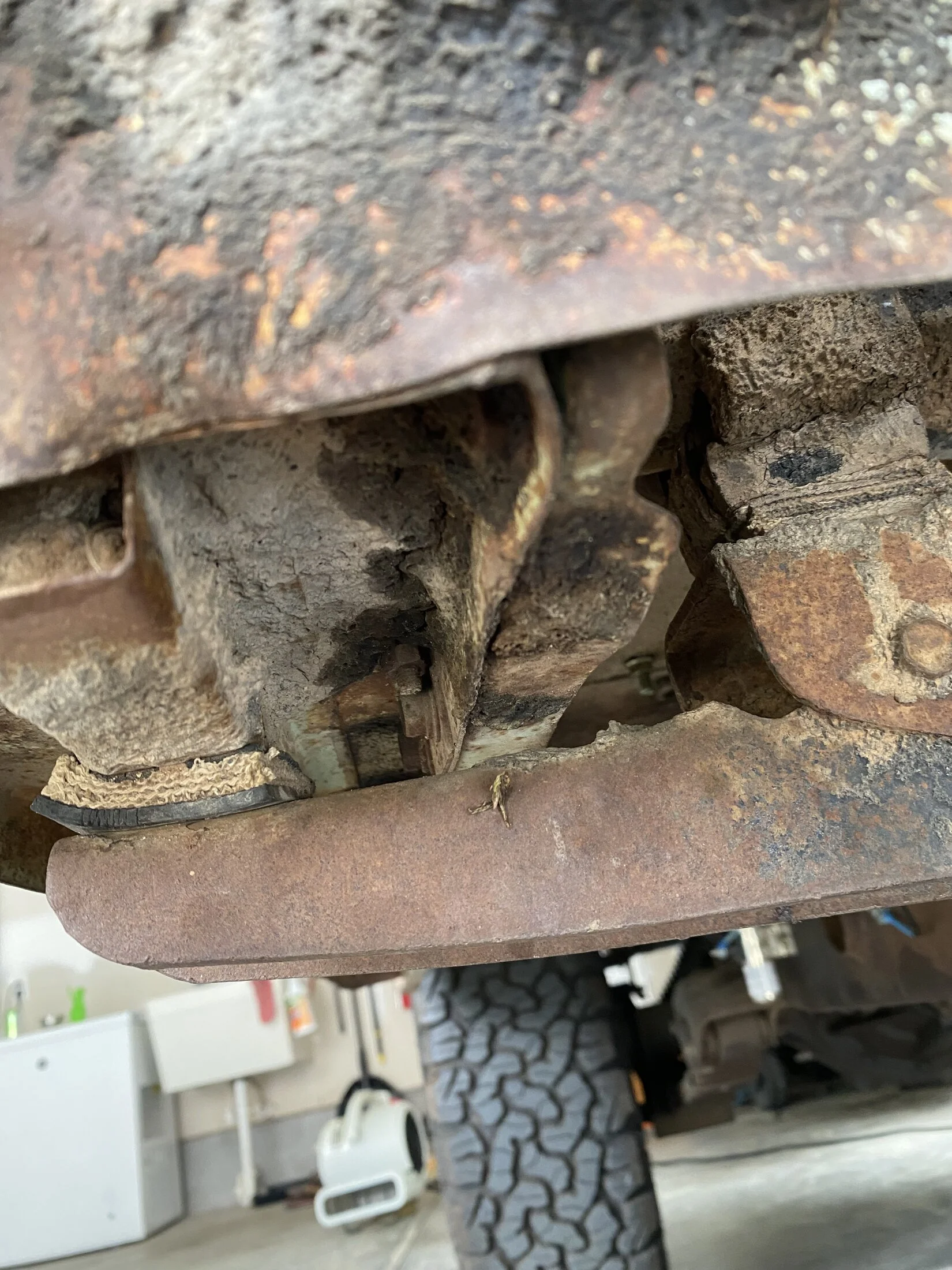

Missing some body mounts and the others look like it’s time for replacement.

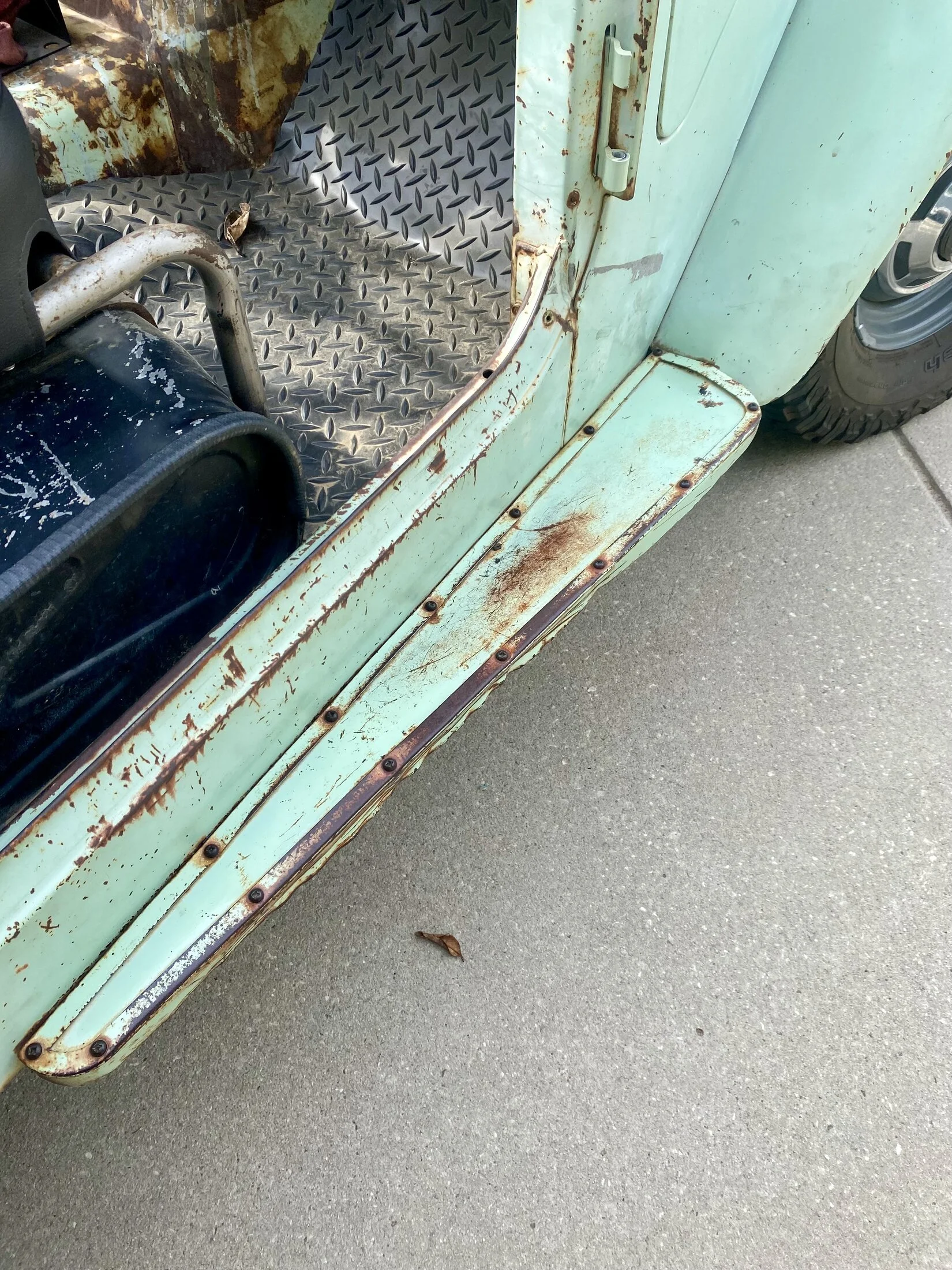

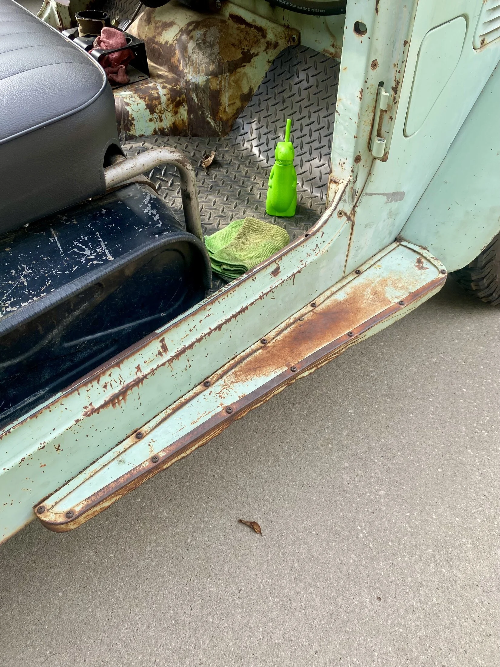

Also started test spotting the patina preservation methods. Prett happy with these results!
Before
After
@schuy2147 the area of my 69 in your ‘ground’ pic. Not seeing anything that resembles the what looks to be wad of tape with the wire coming out.
There's a Petronix Ignition in there...that ground doesn't go to anything. I'm not really sure why I left it on there.

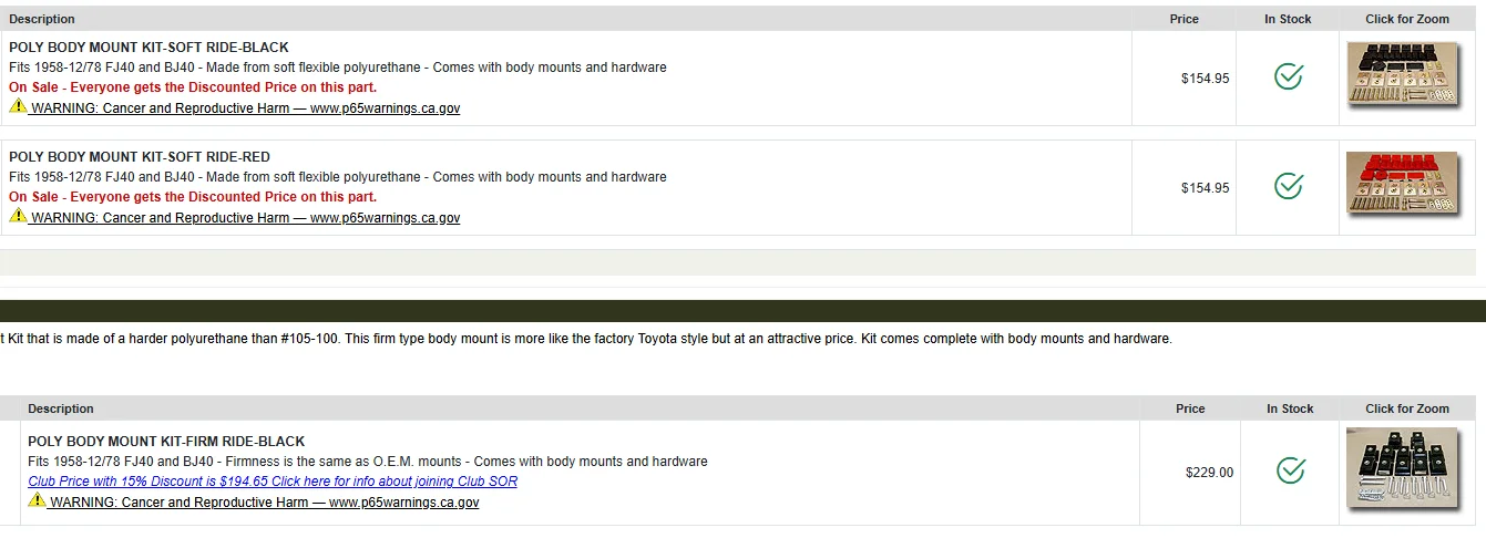

I really want to address the body mounts (or lack thereof) soon. SOR offers the Energy poly kit but also a "firm ride" kit that supposedly resembles the factory setup but at a higher cost.
Anyone have experience with either?
I'm leaning -no pun intended - toward the firm ride/OEM.
I've used the red soft ride kits on some of my other builds. This build was one I didn't want to separate from the chassis....a lot of the mounts can be difficult to remove due to all the rust/gunk build up. Especially the running boards. As for the firmness of the ride I can't tell between one or the other.
