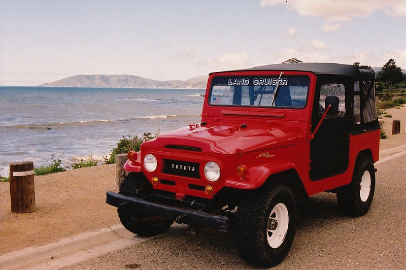

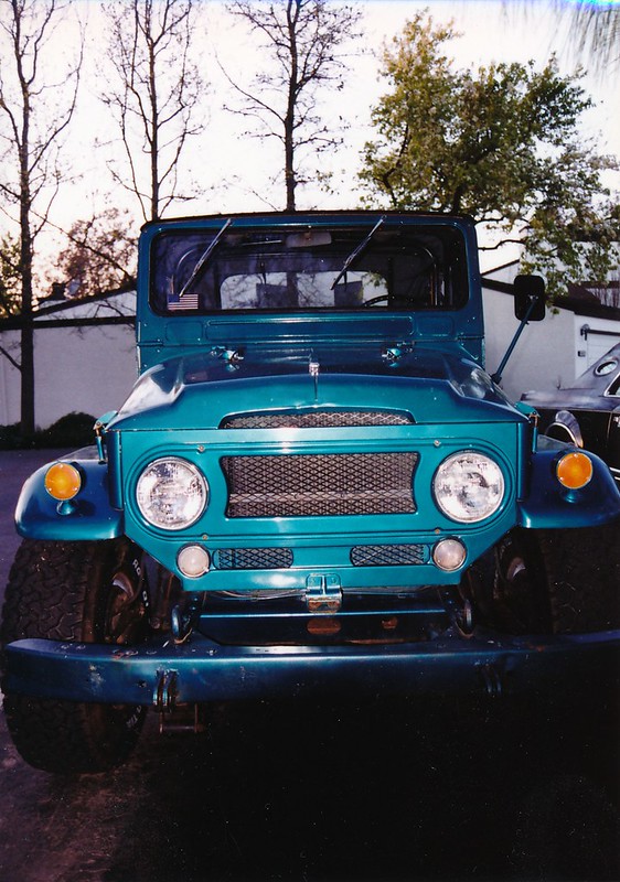

I purchased "Clifford" back in 2001 when I was 16. I paid $2000 for it from a guy name "Rusty" in Davis, CA. It just came with a bikini top, broken old seats, no doors (well it had chains that ran across the openings) or seatbelts and questionable brakes but it ran great. For some reason my mom let me buy it even though it gave her more grey hairs on her head as the years went by. At some point it had been repainted in a blue-green color, also had a weird aftermarket rear heater (no front heater), old school SOR roll bar and a GM alternator. Other than that it was pretty original. Here it is soon after I purchased it. My dad and I took it for a fishing trip up at Davis Lake.

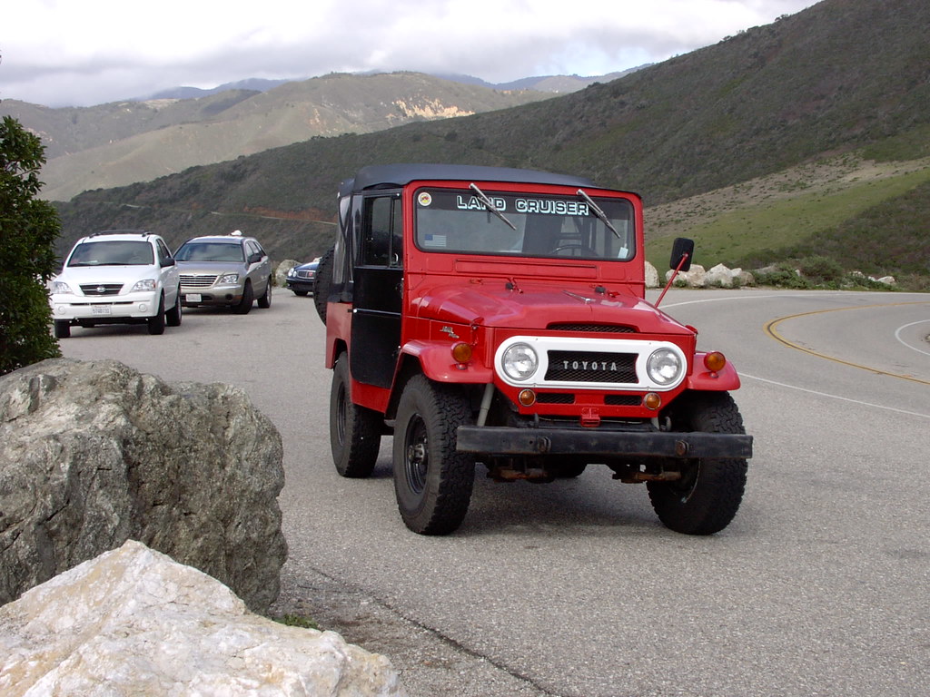

Driving around with @pismojim :
The tires were used and lasted me a couple years until I could save up for the tires I really wanted... BFG 33x9.5! :D I also had @FJ40Jim rebuild the carb, I recovered the seats with the SOR kit at the time, swapped the front axle for a 69 FJ40 one and put on FJ60 front knuckles and brakes. Added a Chevy S10 brake MC with a spacer so it cleared the firewall rib. Swapped the old metal fan for a spacer and a plastic version from @65swb45 . Installed a Mojave front heater. I installed a stereo at one point hanging below the dash but took it back out after a while. Did a few other improvements but thankfully left it mostly stock.

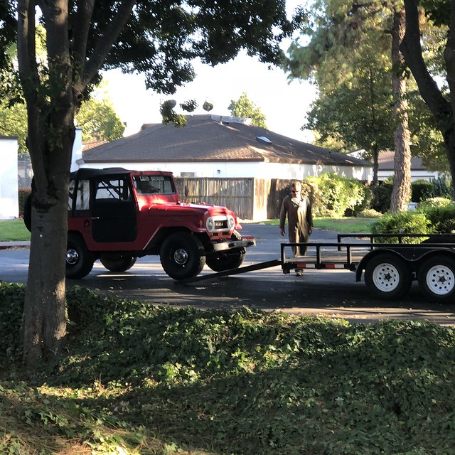

Special delivery today in CA. :bounce: Wish I could have been there.

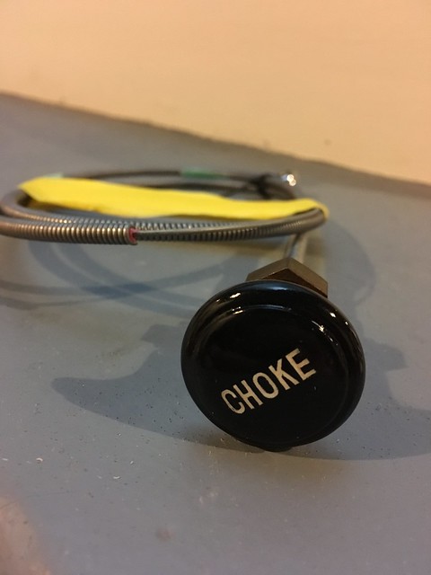

Beautiful restored period correct choke cable from @RAGINGMATT

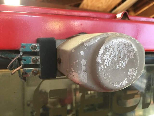

NOS flasher unit courtesy of @Racer65

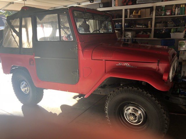

Finally got a chance to see Clifford in person again and go for a test drive. It was both in better and worse condition than I had anticipated. Some rust starting on a few spots by the windshield and some of the body seams. Thankfully they didn't eat through the metal yet. I attacked them with a wire brush and put OSPHO on them. :) After replacing the battery, it fired up with only a little effort. Its not road legal or safe yet so the test drive was limited to the immediate property but it was a blast none the less:

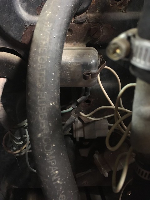

Horn relay still has the plastic cover?!

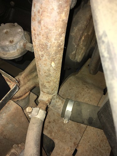

Sketchy alt to battery wire junction:

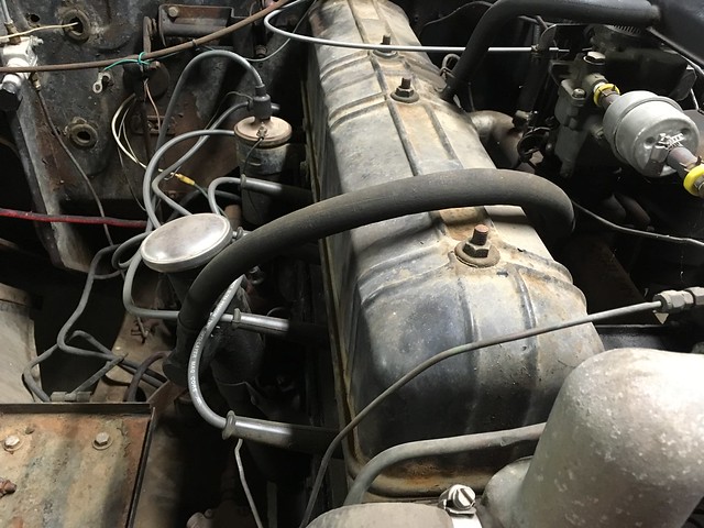

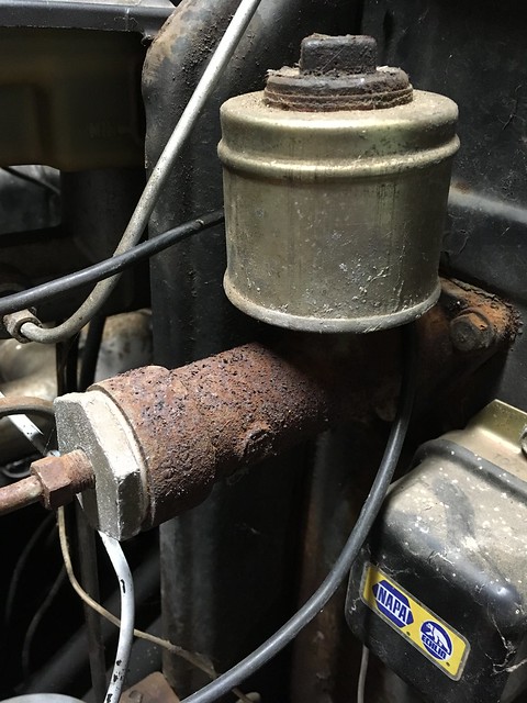

Still has the original PCV hose:

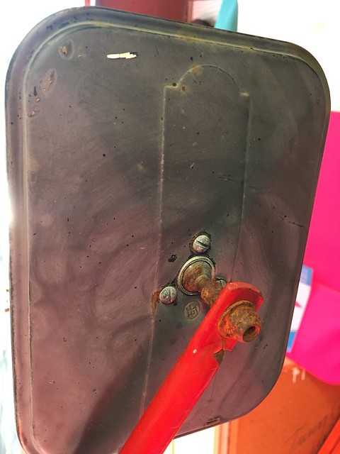

Guessing an aftermarket mirror:

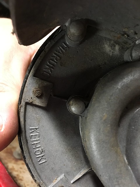

High horn:

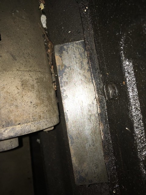

Looks like an additional bracket was tacked on for the GM alternator?

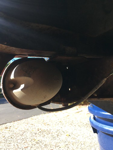

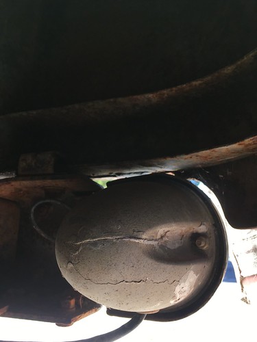

One cool thing I rediscovered is that the back tail lamps still have the plastic protective cones! One is cracked but I am sure I can find a good plastic patching compound to make it strong again. :)
