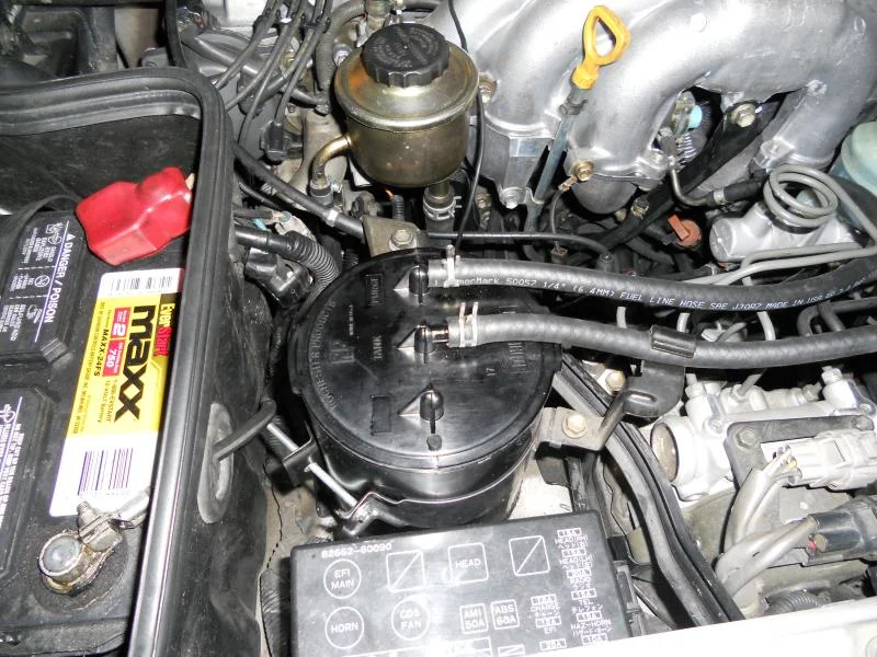

So I ordered the Auto Zone canister and it is actually a Denso with Toyota part number.
That doesnt match the description of the Duralast VC4054 from auto zones site. Is that it in the picture? Is it possible someone threw their cleaned up used one in the duralast box, returned it and the store just put it back on the shelf?
i cleaned mine using the fsm method, i also sprayed a bit of penetrating oil into the inlet and outlet to lube the check valves, they seem to be working great because i can hear them open and close. no fuel vapor when i open the gas cap now.
No, this canister was drop shipped from 'Wells Vehicle Electronics' to Auto Zone's distribution center. It was then dropped into an Auto Zone box and shipped to me (someone left ALL the paperwork in the box). It did appear to be dusted off but its unused. I'm thinking that this Wells company may have bought Toyotas inventory of vapor canisters - since the dealer has none.
old left - new right

Thanks to Jeeper. I finally get to finish this vapor canister mod and free fuel vapor hoses for $35 from Autozone. No more gas vapor pollution at gas fill up and hopefully improve the mileage as well.
I drill a few holes around the perimeter of the bottom for drainage in case of water intrusion during engine wash. Another hole at the center of the bottom and attach the OEM bottom hose to the Duralast vapor canister VC120( this may get rid of the fuel smell that some members are complaining about this GM canister)> I think Mr T did it right with the bottom hose for venting?? and use only the upper OEM clamp due to space limitation. overall, it fit well but tight. :cheers:

How does the bottom hole, missing on my Amazon.com version, affect this?
The bottom vent on the OEM CC kicks in when there's too much pressure, and fuel will come out of the hole. The GM version has a series of "slots" around the bottom that serves the same function.
The GM canister vents at the slots at the bottom of the canister which will be inside the hood right at the driver side. That's probably why you guys are complaining the fuel smell at high attitutde. I think it will help a lot if you attach the OEM hose to the GM canister & vent it to the bottom of the engine instead. Just drill a hole like one of the member here did.
