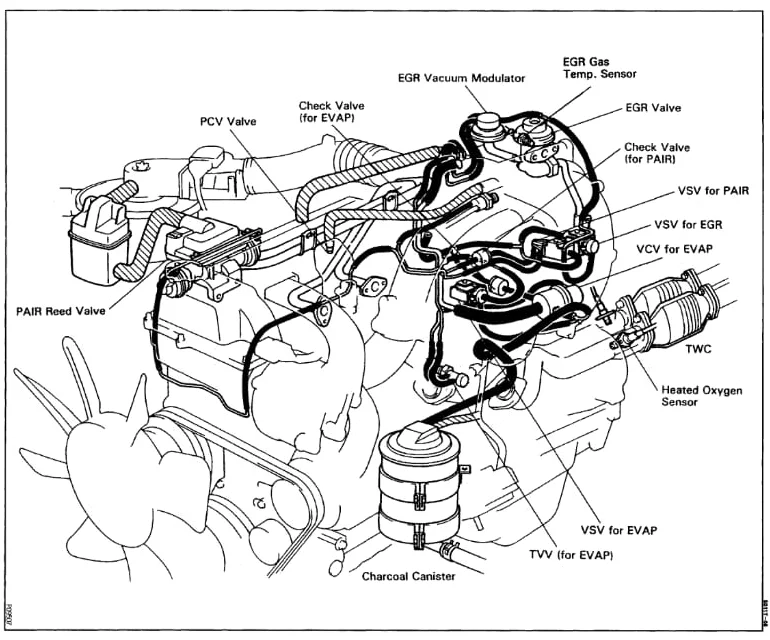

As far as I can tell the EVAP system should constantly equalize pressure. What varies is the movement of fumes to the intake.

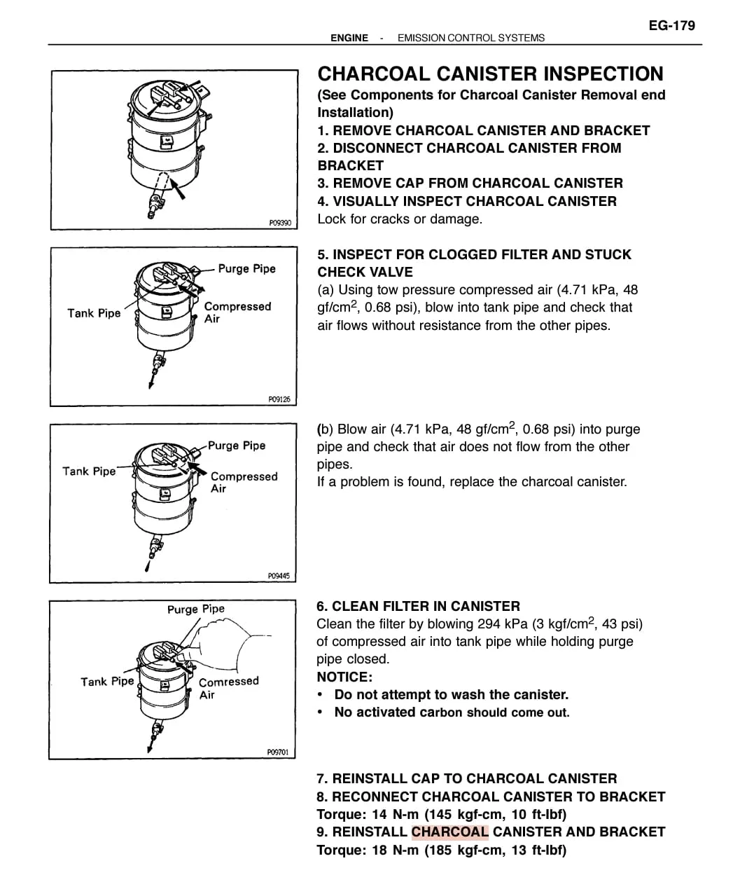

Some bits n pieces from the FSM:

I'll do the FSM tests and clean though!

I can't recall where the ball valve is on the canister - but if you put you fingers on each of the in and out lines where they become aluminum this buzzing in your video should be a vibration you feel. That said the FSM tests are dirt simple. I am took a risk with mine an rebuilt it removing the little ball and spring. It has to pass and emissions inspection test this July.
