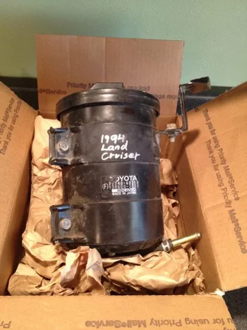

Just replaced the canister tonight, it's a lot tighter than the picture shows. Does feel like the car has a bit more power but that could just my imagination. I'll see if I get better mpg from it.

Look what was in today's mail. Now I'll have a spare to take apart ;)
Got mine in the mail yesterday and installed it today along with some new hoses.. Went in super easy and just used zip ties on both clamps, be careful as if you pull too hard it will crush the plastic canister. No more tank pressure!
