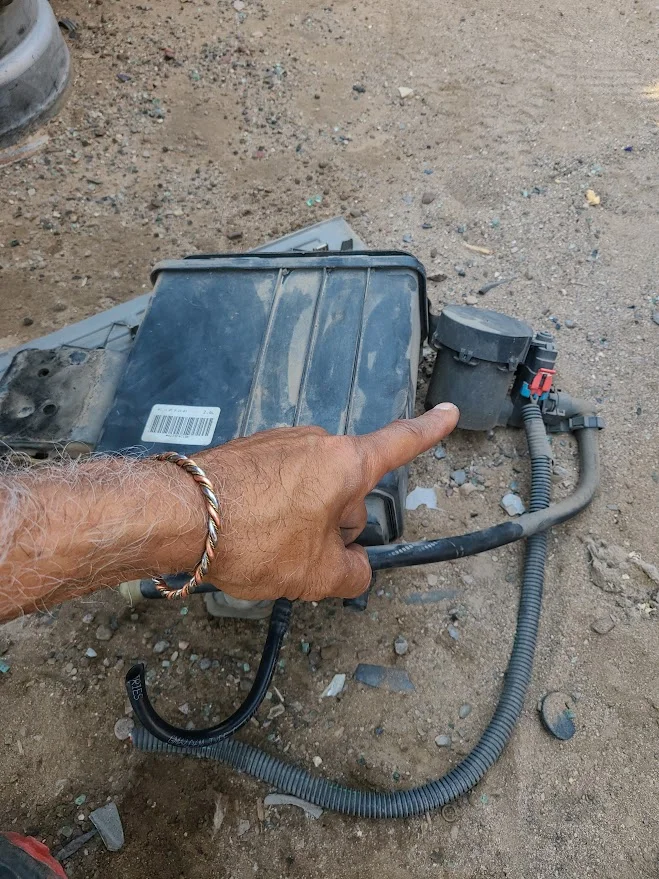

Go to the junkyard and pull off one of these evap canisters that are under lots of Tahoes, trucks, etc. Try to grab one with the pre-formed plastic tubings from GM so that you can use their plastic barbed fittings after you chuck their tubing.

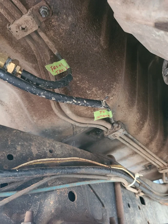

Our charcoal canister (CC) has a "tank" line from the fuel tank, and a "purge" line that goes to the intake manifold. In the picture you'll see how I disrupted the "tank" line from the fuel tank on its way to the engine bay CC tank port. The part from the tank now goes into the "tank" line of the evap canister. You'll need to do an adapter from Toyota dinky hose to GM gigantic hose. GM uses a small nipple on their purge line and this needs to 5/16" ID. I believe the same 5/16" ID hose will slip over the OEM hard piping.
The second part of the "tank" line is now connected to the "purge" line on the evap canister. This tank line goes straight to the area under the ABS and points upward. As Paul showed on his build thread, just use a small tubing bender to bend the "tank" rigid line in the engine bay so that it points to the intake. I used the same rubber hose from my original CC to connect this hard piping to the intake.
The third outlet out of the evap canister is going to the atmosphere, and in the picture you'll see GM has a solenoid valve in that circuit before the expelled air goes into a round filter. Some day I might install this round filter but probably not. The expelled air out of my evap canister goes into a hose then into atmosphere, same thing as Paul did. The solenoid valve is normally open but I don't need it.

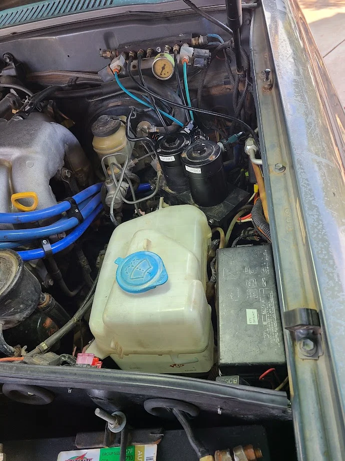

Now I have room for a dual pump ww reservoir plus two catch cans in this space.

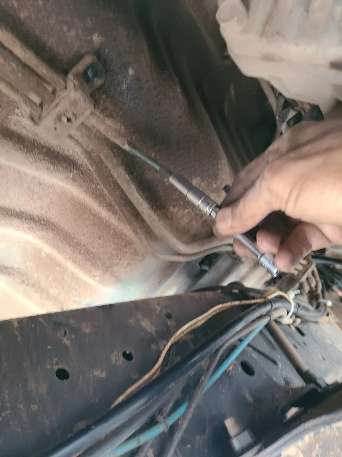

Under the 80, the tank line is this line with an outer hose type of protection. I simply separated the two, then cut it and bent it using a 9mm deep socket. It was already bent out from the other two from the factory, so I didn't have to bend it too much.

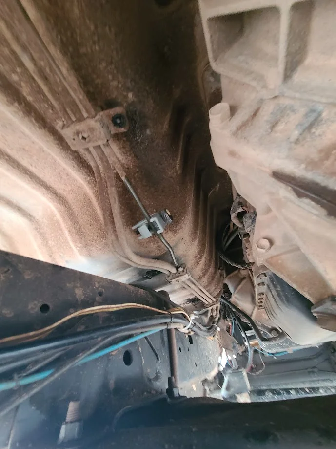

I'm now pointing to the newly bent line that used to be the "tank" line but now it's the "purge" line from the evap.
