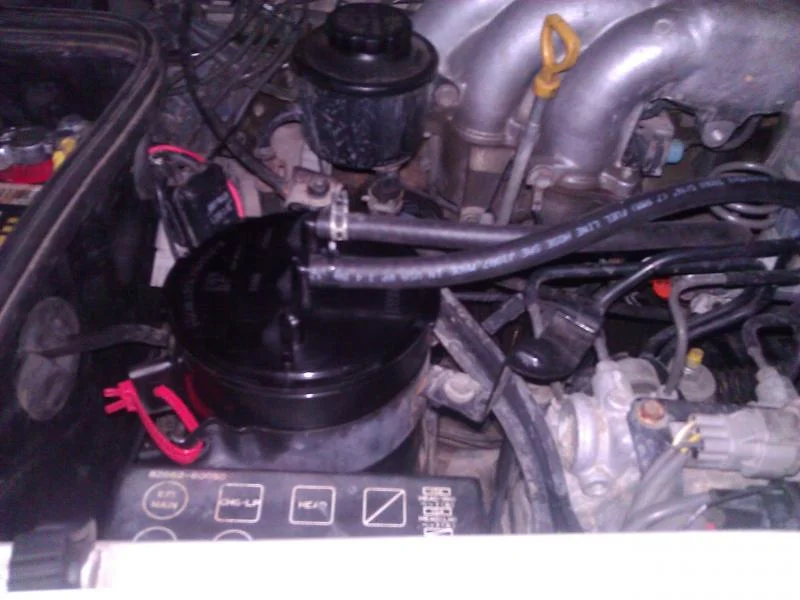

In the picture it looks like the hose fittings come out of the canister. Is this correct?
Also, is there any way to "open up" the check valves if they are stuck? (I opened up my canister and replaced the charcoal but the check valves are the main issue.)
the check valve is a simple ball and spring combo. Spray some brake cleaner and follow through with some air pressure and that should do it I suspect.

That's good news indeed. Did this unit fit w/o any issues or is it a slightly fatter unit than the OEM?
I can't speak on the Napa product, but the one I used was slightly larger in diameter. From what i have read, this has been the experience of others that have used the Pontiac canister.
Longer bolts will be needed or many have used zip ties. I fortunately don't have to deal with emission inspections/testing where I live, so making it look factory wasn't a goal.
I ended up taking off the lower loop of the bracket to make assembly with zip ties easier, because it's tricky to guess the mounting height until you start bolting the bracket back in. I feel a little guilty about that and might put it back on. Belt & suspenders is how Mr. T designed it so who am I to question it?
nope it was not a perfect fit had to modify it to work, but it worked. It was fatter and had to modify the bottom of it like stated in a above post. I have had zero issues with the aftermarket part.

had to use zip ties need longer bolts its a big gap but it works great so far need a long run to make sure!

I did the swap to the Duralast VC120. As others have mentioned:
-Used zip ties to hold the bracket together
-Had to remove all 4 bolts (its is a TLC after all) on the canister bracket to get lower vent tube off
-Removed old bracket and tube assembly off bottom of Toyota canister
-Drilled hole in bottom of VC120 canister and used self tapping screws to affix old lower tube
-Had to work to get new canister down inside old bracket
