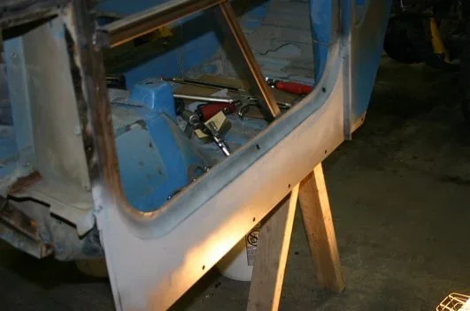

I left the good camera at the house today. But I can report that I welded the rocker panel back on.
Tacked it into place...
Then killed some time...
Then tacked it more, and more, and more... Once I had a tack weld about every inch or so, I basically just added a tack onto the end of each tack, working front, then back, then front, then back....
After a LONG time, I ended up with a nearly continuous weld bead...
I'm pleased with it. It's definitely far from perfect, but that's due to the dents and deformation in the original metal. Much of which I just couldn't get behind to straighten as much as I like. So this rocker will definitely see a bit of filler, but I think overall--it'll look great.

Before I put the rocker on I had to repair some rust (and a spot where I went too far with the spot weld cutter) in this little tab...

And here's some more close up shots of the rocker welds.
And here's one with the spot welds done. I decided to spot weld it to the flange before I finished the weld just to help keep it even more square and straight.

And here's a few pictures of the seam with the grinding mostly done...
And with as much grinding as I'm going to do for the time being, and a light coat of primer on it (to protect it, and to see how it looks)
You can clearly see towards the front of the rocker panel the crease that is caused by the original door sill being just a little bent in (about 1/8" maybe), while I left the new rocker panel straight. I filled the gap between the two with weld, and I'll probably just use filler to smooth all that out. But I COULD just build up weld above the seam and then grind it down smooth....
Either way, there will be a little filler, but never more than 1/16", and I can live with that. Because the quarters aren't going to be welded to dented up, bent up metal I shouldn't have this problem dealing with them.
