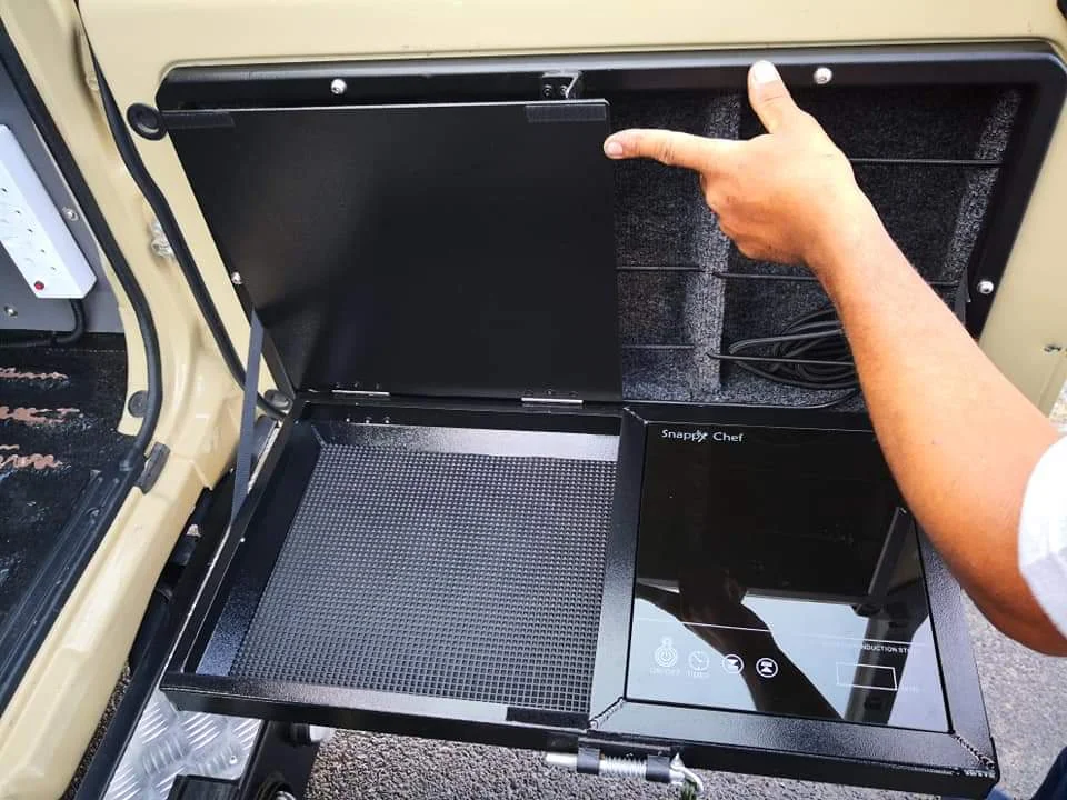

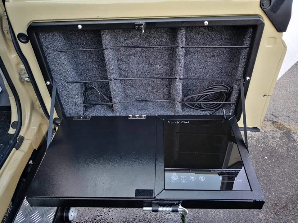

Alet do you have some details on the induction plate... power consumption (I believe it is high) size inverter etc. or are you only running it when there is shore supply?
We will hopefully be running our Snappy Chef Traveler Induction stove plate from the solar panel via a 4 Kwh Lithium Ion battery and a 1,6 - 2 Kw Victron inverter and Victron charger. The induction stove heats up so fast that I rarely use it for longer than 20 minutes while preparing a meal. This setup is still to be tested long term, and I will let you know how it goes!

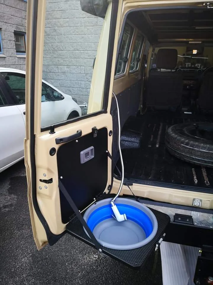

We took a huge leap of faith and had water tanks installed in the sides of the car. It is still very much an experiment, as we will have to first see if they leak or sweat at all (in which case they will be coming out immediately!)
1982684
These are approximately 20 liters each and together with a 50 liter tank underneath, we will be able to carry 130 liters for long trips in the bush. They also installed the kitchen drop-down on the right side barn door, and a sink on the small door.

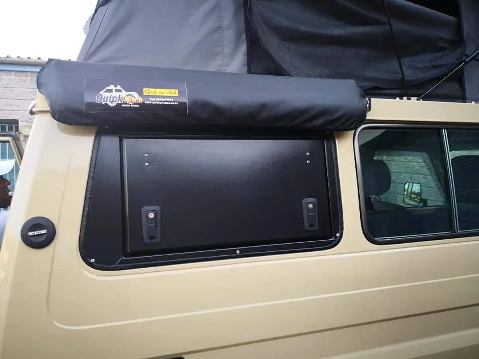

We had a Quick Pitch shower curtain installed over the gull wing hatch, and had the small platform of the tent split in two.

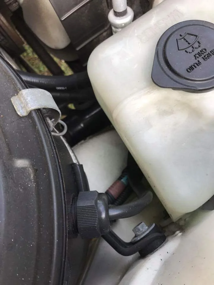

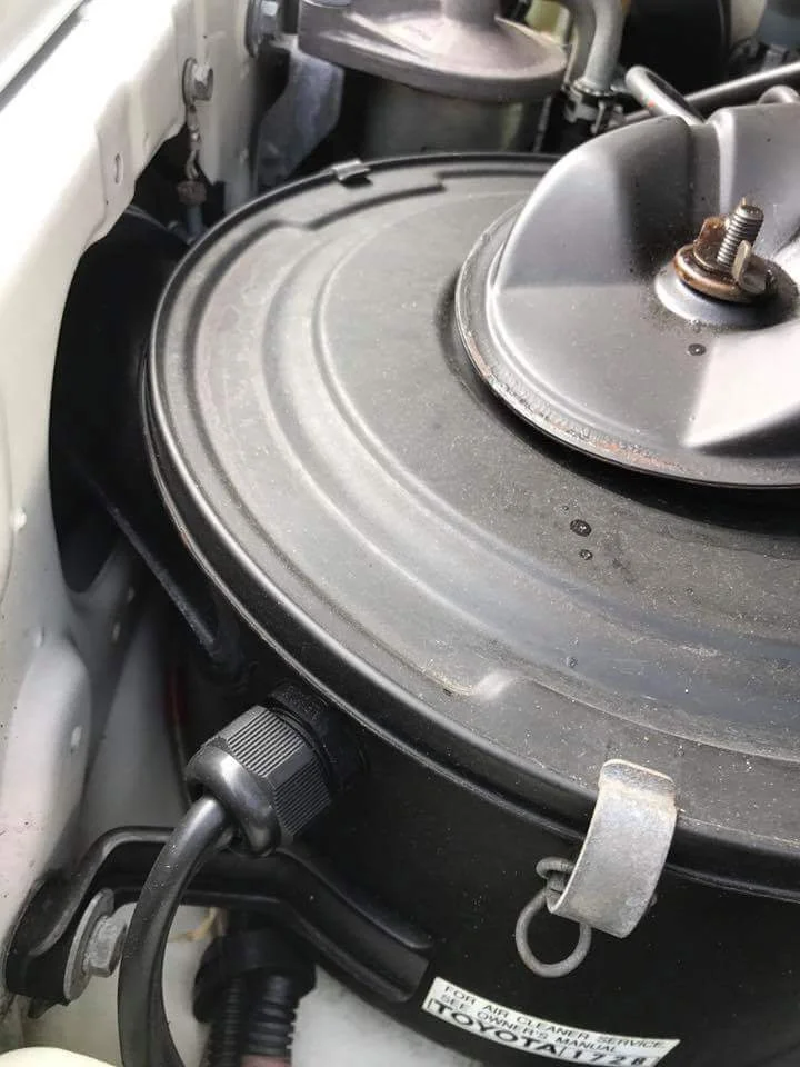

We do not have the panels on the roof yet, but the plan is to run the wiring through the snorkel. I include a pic of such an installation that I got off the Troopcarriers of Australia FB page.

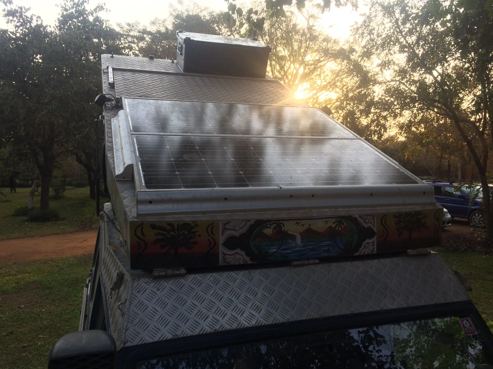

We had really hoped to put flexible panels on the roof, but since our pop-top is finished with checker plate on top, we can not do that. We are still working on a plan to fix this...
I'm putting flexible panels on mine. I'm using the same adhesive/sealant to stick them to the chequer as I did to fit the roof. With a thick enough bead, it will easily hold.
Not the most elegant solution, but works well. Remember that solar panels need an air gap to stay cool to work efficiently. A regular grommet is mounted under the panels and through the roof and sealed off with sicaflex, had never leaked.
A friend of mine glued flexible panels (sailing boat type) to his westfalia bus (slightly slanted forwards on his alcove top) and had to replace them twice. The third time a solar panel expert told him that the flexible panels can't cope with the pressure of driving wind... no idea if it's true, just putting it out there.
