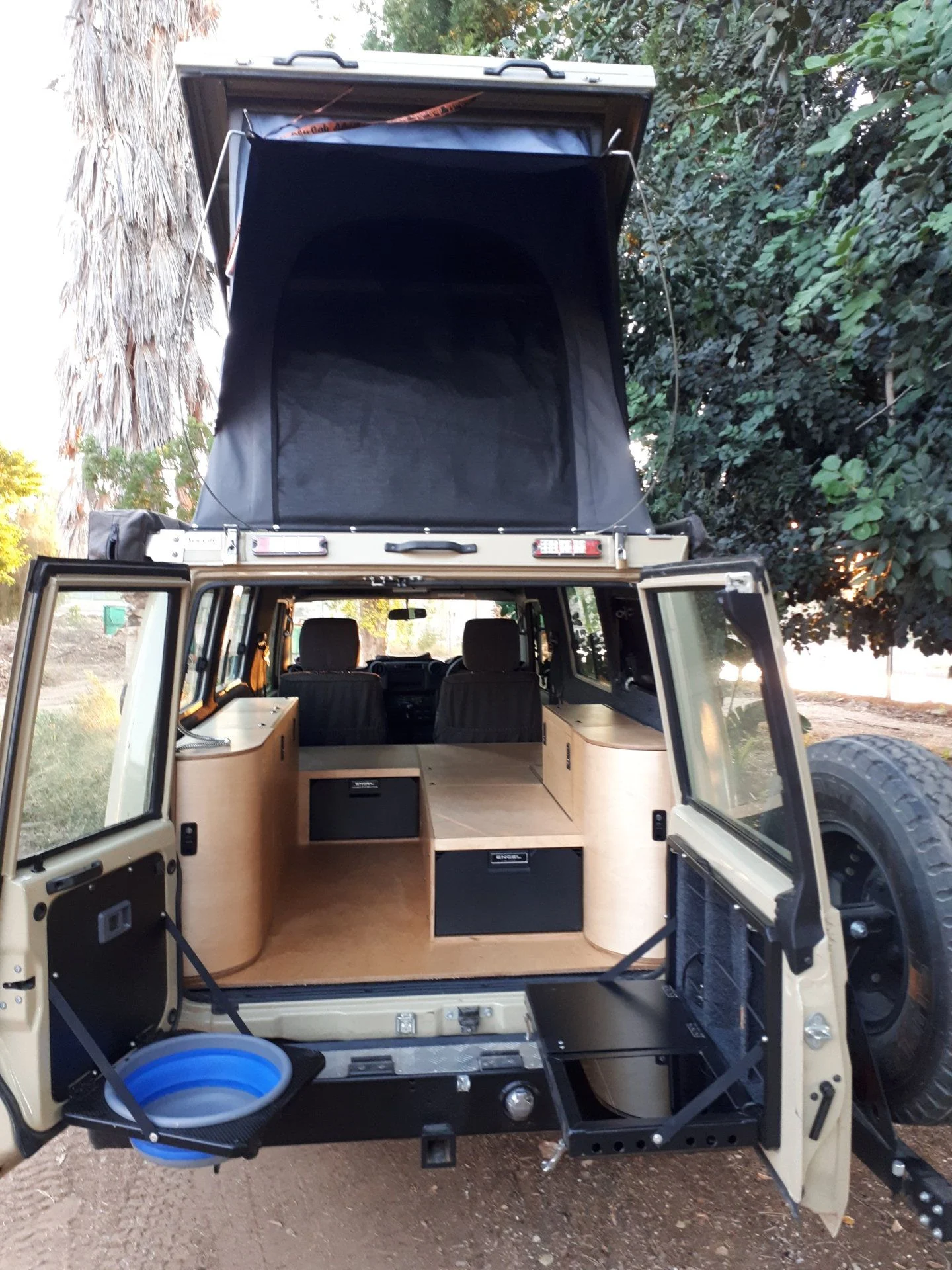

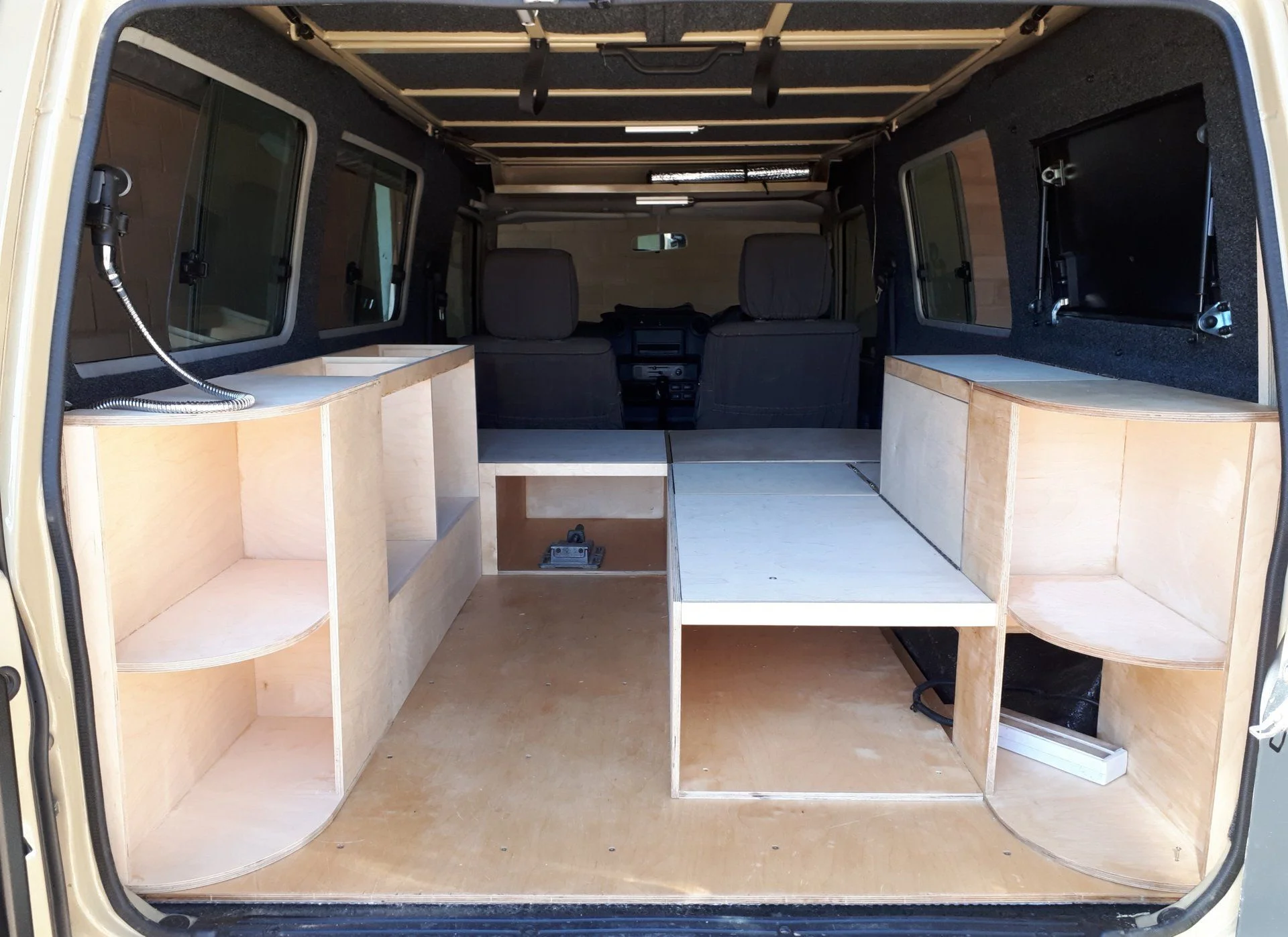

It took us almost a year to get this far, but thanks to lockdown, we finally finished the cabinets! I will only be able to make cushions and window treatments when we are “free” to shop for fabric etc. – AND when we have saved up some money again.

Loving what you've done with the interior. In my opinion, it's the toughest part of the build and one that I've been going over and over in my head for the past 12 months.

Thank you! As you can see from earlier in this thread, this is our second attempt at building a setup. We only decided on this layout after camping in the vehicle for a long time, establishing exactly what we needed to take, how long we spend in the car itself, the manner in which we travel etc., etc. This will be different for everyone. I used to be an architectural technician, and I found that every client had unique needs and preferences. So even when I designed a townhouse complex with more than 100 perfectly similar houses, every client wanted me to make some little change to their specific house. I can only hope that this setup will be the one to work for us, because frankly I am just over woodwork, and ready to ENJOY SOME CAMPING!!!
Great workmanship guys, looks superb! Love the rounded end cabinets!
I might have missed it in earlier posts, but could you talk us through your design considerations on how you chose this unique layout?

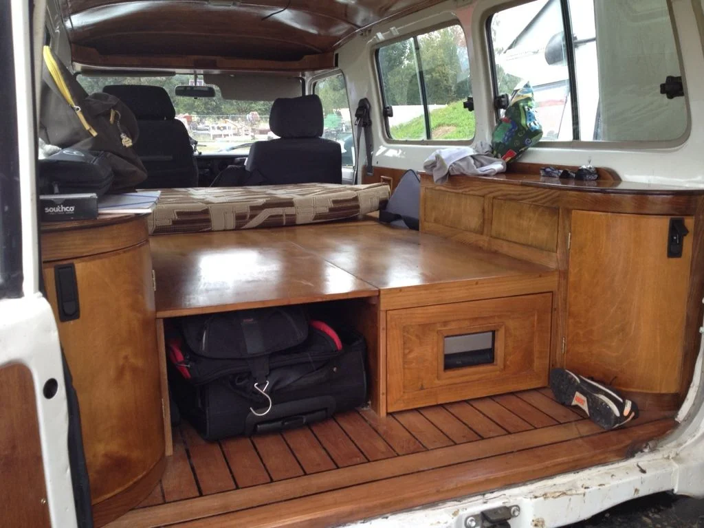

Thank you Paul! I found this picture on the internet years ago, but could not get any info on the car and can't remember where I found it. We just presumed it to be a Dutch or German Troopy, because it's left hand drive. We just loved that it was open and spacious, yet afforded enough cabinets for all the necessary "stuff", and it could also convert into bedspace down stairs if needed. It would be EPIC is you knew this car?!?! (Just look at the timber roof lining! 🤪)
We used this for our inspiration, and it grew from there.

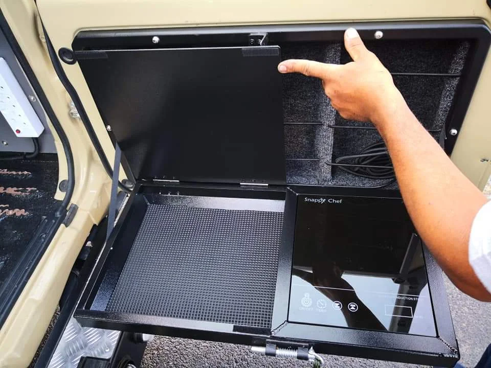

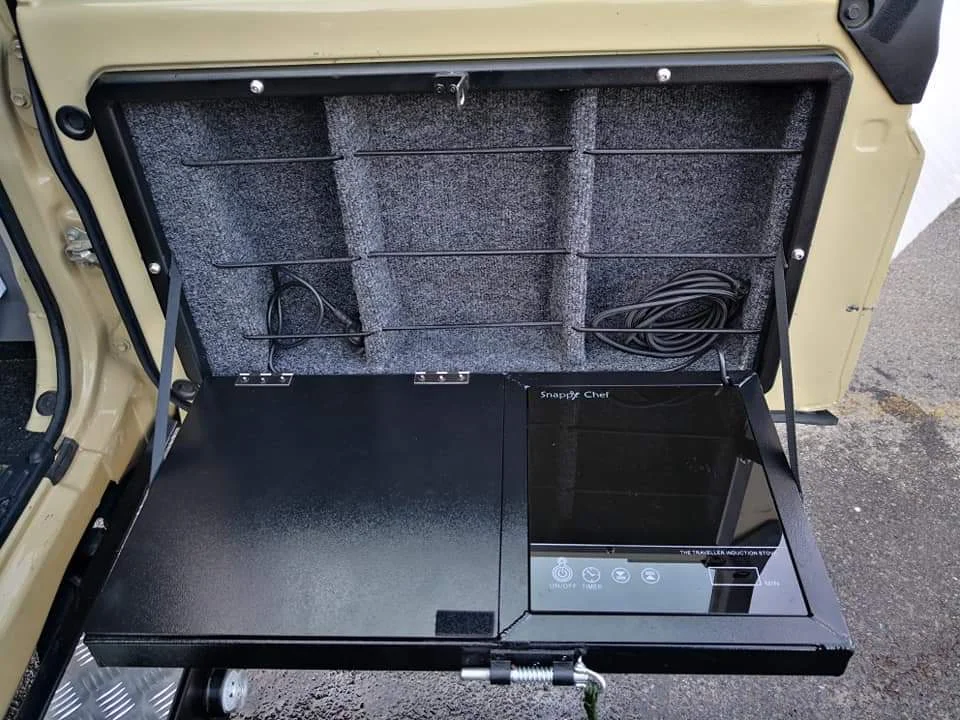

Here are 2 pics of the kitchen box on the big barn door.
and
Alu-Innovations in Cape Town builds this (called a Versabox) as a unit, and I'm sure they would ship it overseas. You will easily be able to fit it yourself. I hope this answers your question?

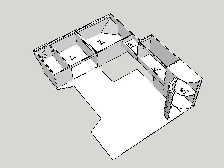

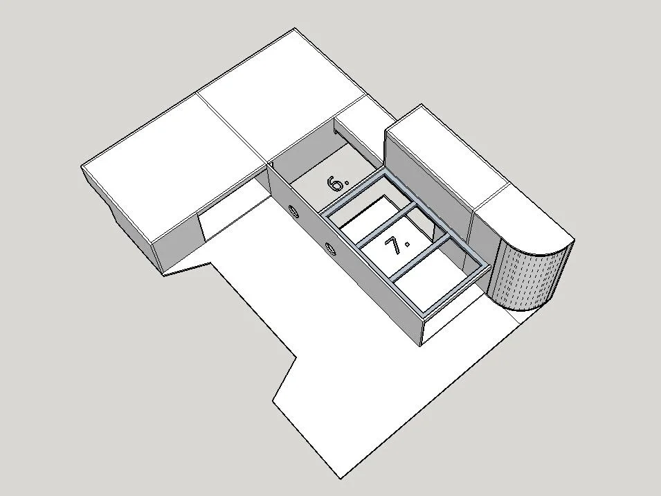

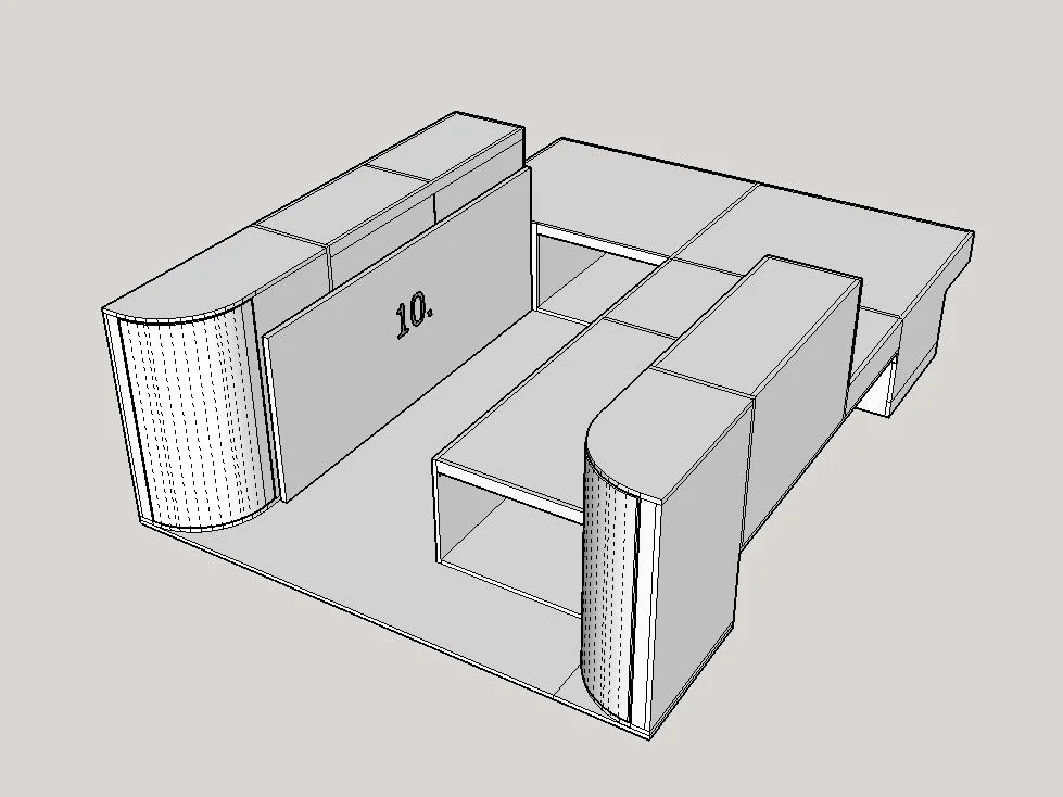

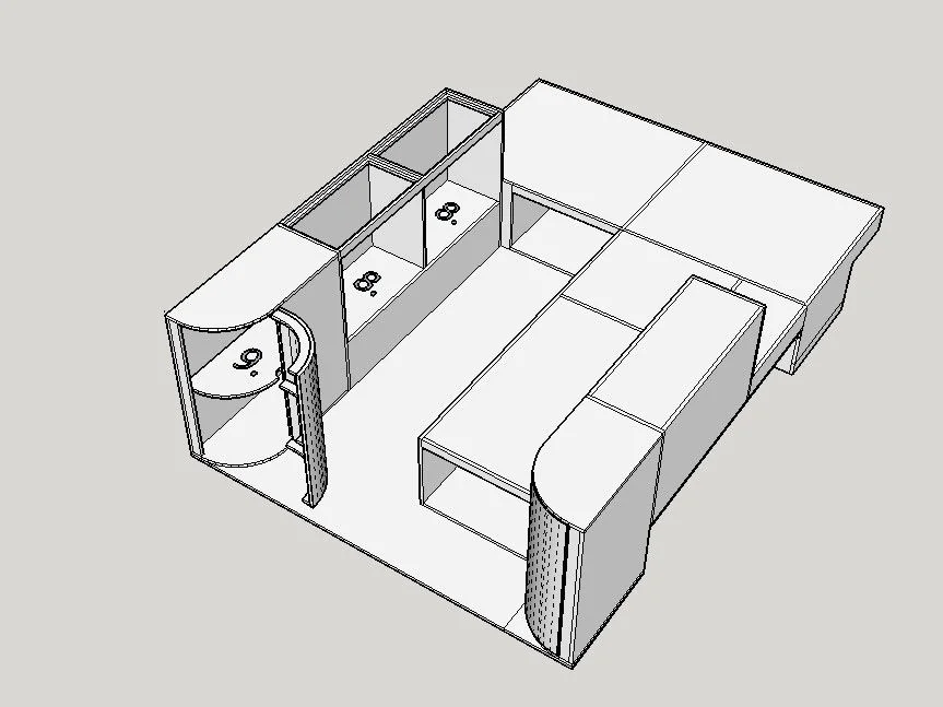

I can paste some drawings to explain our design.
Box 1 contains the Engel freezer. These drawer fridges are very versatile because you can leave the compressor unit behind the drawer or move it to either side of the drawer, or locate it in a completely different area for up to 1,50 m away from the actual drawer. We turned the freezer's compressor unit at 90 deg's to the left of the drawer so that it now ventilates toward the front, behind the passenger seat.
Box 2 will contain the lithium iron battery, inverter, all components for the solar setup and a water purifier. We have not installed any of these yet.
Box 3 is just a shallow cubby for odds and ends. The bottom is about 2,0 cm higher than the wheel arch, so that we can run cables underneath to Box 5, and a water pipe behind Box 4 and up to the gullwing window where we will attach the 3,5 kW Speedheat shower head.
Box 4 will serve as the pantry, and I will still add some compartments inside when I start working out the contents of this box.
Box 5 will contain all pots, pans and kitchen utensils. The back of the lower half of this cupboard is open towards the wheel arch so that pan handles etc. can stick in there, and also for ventilation of the fridge next door.

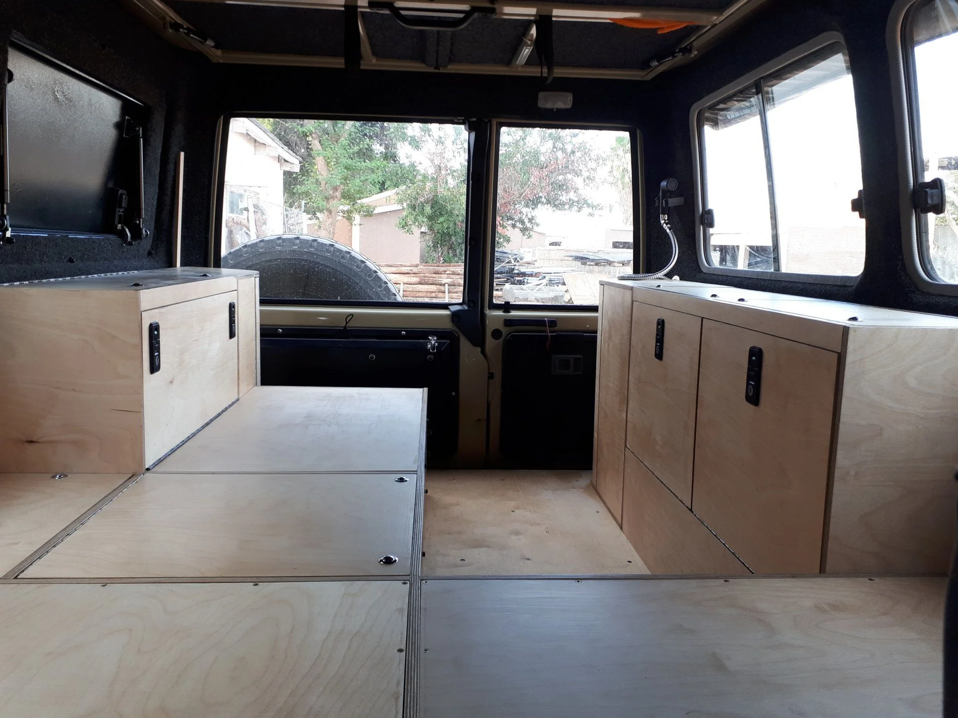

Box 6 is for the porta-potti. We had to cut the "floor" out here, because the potti is 300mm high, and because we wanted to keep the top of our seating area at 300mm we had to lower the potti into the floor plank. We attached an aluminium tray to the floor, and then the potti on top of that, so that we could still have the 12 mm wood lid over.
Box 7 is where the fridge lives, and it is reinforced with aluminium angle iron, because we will use it as a step to climb to and from the "top floor".
Box 8 is just made up of 2 compartments for clothing, and will probably still get a shelf somewhere. The bottom plank hinges on the floor so that it opens up in front of the left hand side wheel arch. This is not a big space at all, but will be nice for storing shoes etc.
Box 9 will house spares, the jack and our Desert Fox chairs.
The plan is to make a table (or two smaller ones) with extendable legs which could be either 300 mm or 600 mm high. It will fit into the opening between the fridge and box 8, and when @ 300 mm high is will close up the sleeping platform for the odd occasion that we will have to sleep inside. When the legs are extended to 600 mm it can be used as a workstation inside, or as a normal table for use outside. It will slide in on it's side and will attach to box 8 with some kind of bracket or magnets. All this is still very far in the future though :)
and

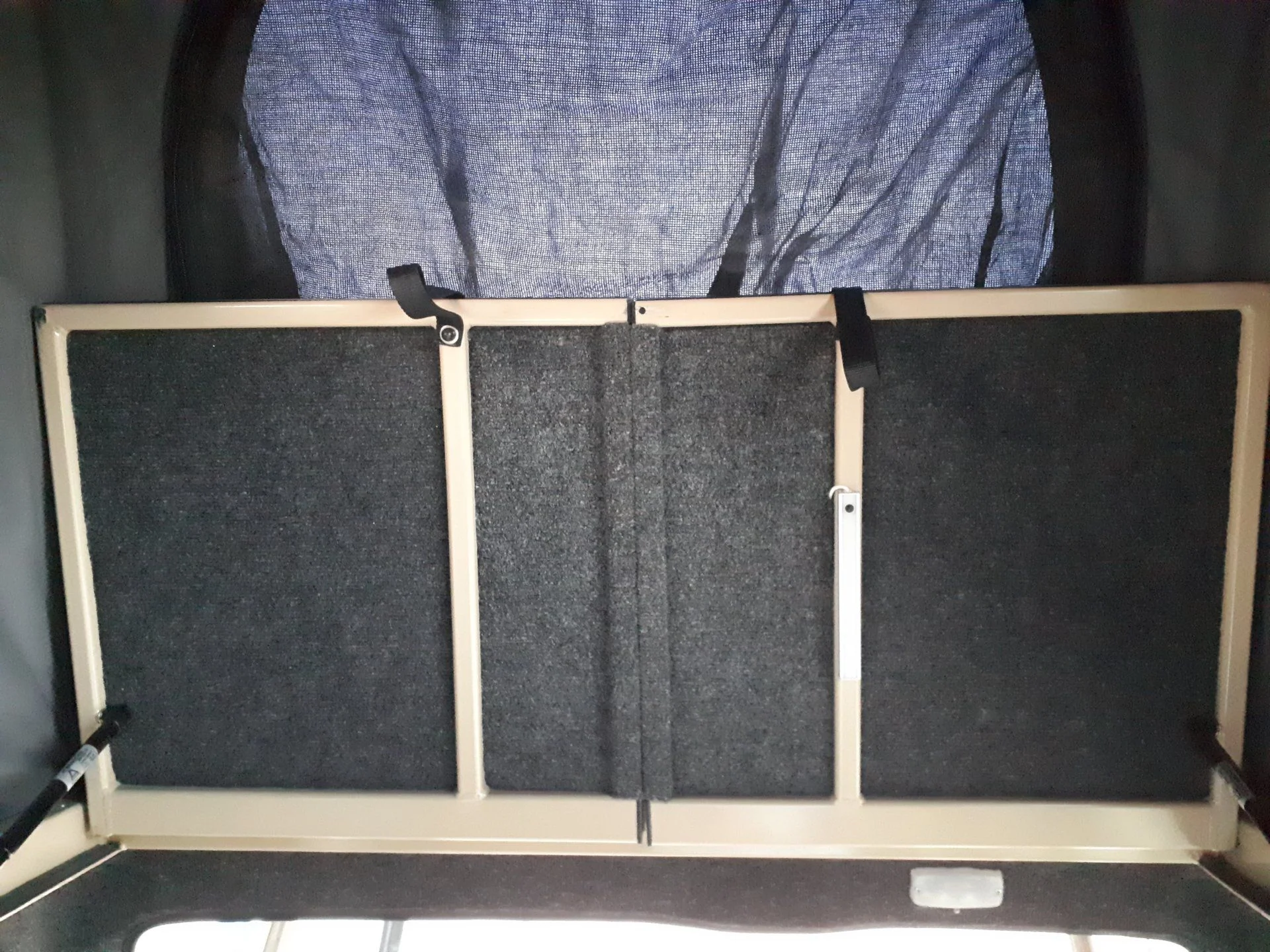

Hi Rodney!

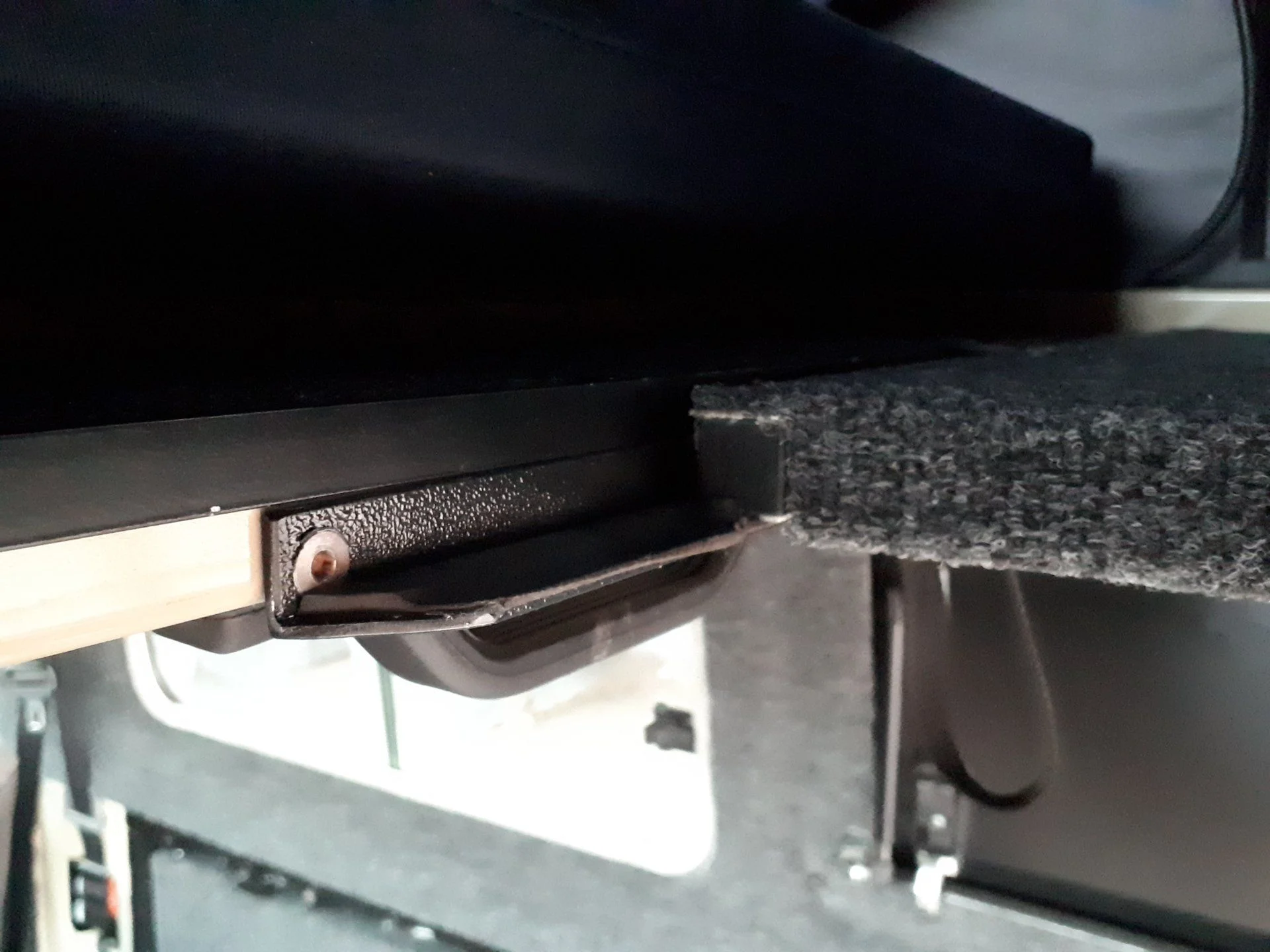

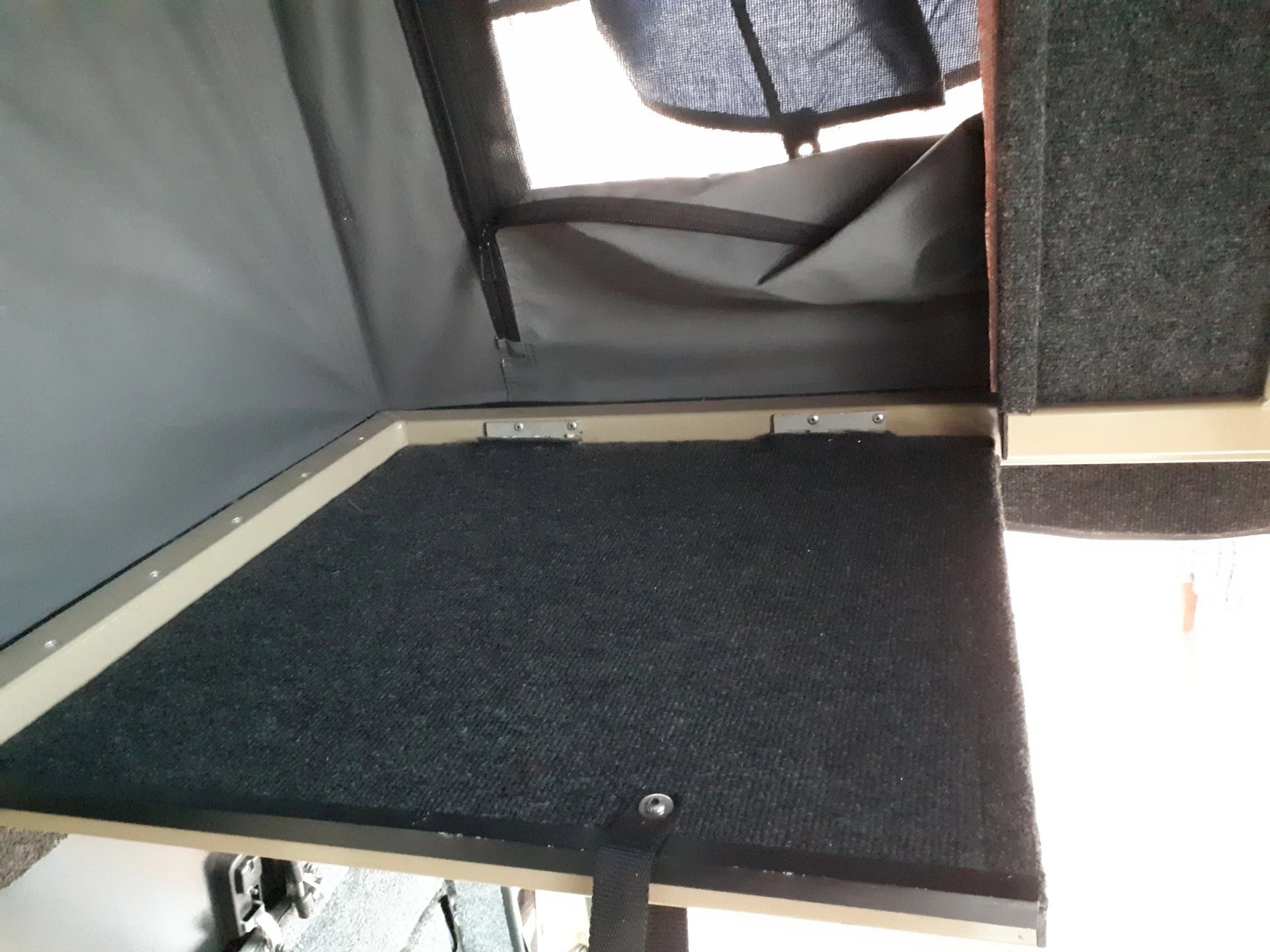

We cut the old platform in half, welded in square tubing on the new edges, and covered them with carpet so that they will not squeek.
Each platform got a second hinge.
We added a small piece of aluminium angle in the middle of the bed platform for the two 'new' platforms to rest on.
I hope these are helping!
