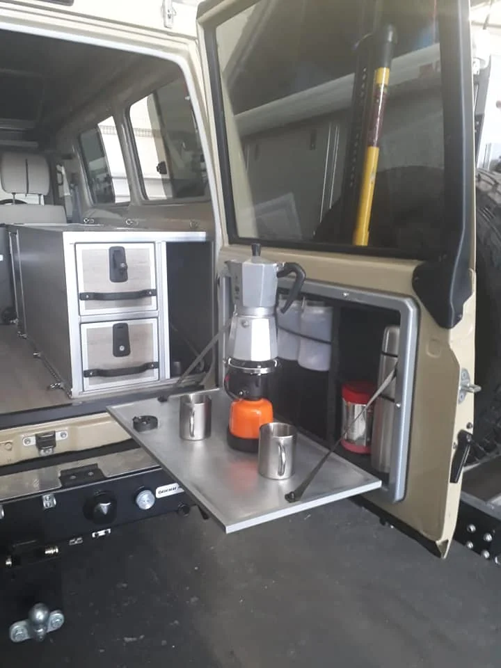

Another great addition going in is this nifty box kitchen by Alu Innovations.
1961701
1961702
It is called the 'Versabox' and will be available to self-install. They are fitting my induction stove plate to the drop-down table. I think I am most excited about this addition!!!

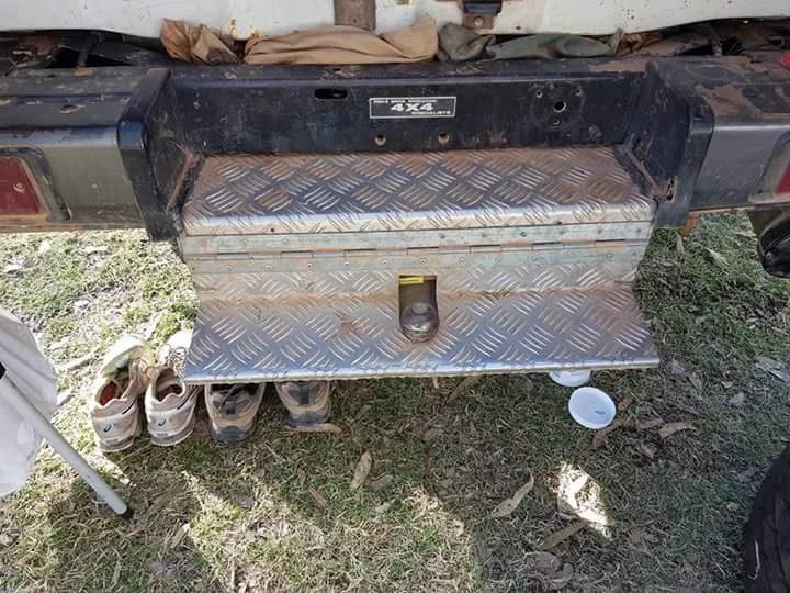

We are also looking into a step for the rear bumper, and I haven't really come up with the right solution yet.

.........and I'm old. How do you get in and out of the back of your truck? I've been hauling around the small ladder you see in the photo. It works well enough but I'd like to attach something to the bumper or use the receiver hitch although I wouldn't want steps to hang below the hitch when not in use. Would need to fold up somehow.

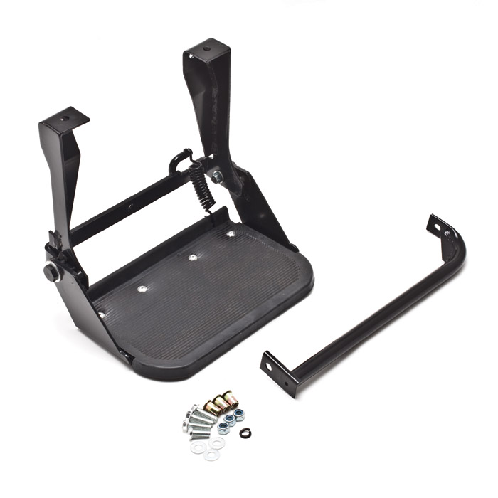

I like this idea, but it needs some work...
1961805
1961806
So basically this guy has built a little step that folds back over the tow bar to form two steps getting up into the car.

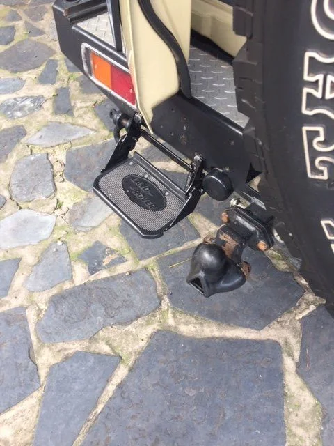

This works for me... it is the more reliable component from another vehicle (the side step)
There's a metal fabricator in Portland. I'm going to make contact and see if he can make something custom based upon the company in post 189. I like the idea......something that folds into the bumper.
I wouldn't be able to put a branded product like that on my Troopy. I never kissed my sister either. At least not on the mouth.
I will let you know if I come up with something.
Our travel buddies drive “one of those” vehicles... this is the most reliable component and is sure to be an interesting conversation piece 😄. Buying the step was an experience in itself! You can remove the rubber cover if you find it that offensive😇
I actually looked online and the only thing I see related was side running boards. I googled side step on the vehicle.
Removing the rubber cover is still not going to prevent the component from leaking oil though 😋
Yes that’s the one, just a mod to the arms depending on your bumper. There should be plenty used ones around from the defenders since they are removed when installing rock sliders on the landy... if you use a 10MF bolt to mount it you can get those with a 17mm head and 14mm nut, and you’ll feel right at home!
You may want to look at their rear step as well, it is different to the side step but it didn’t fit my bumper.
