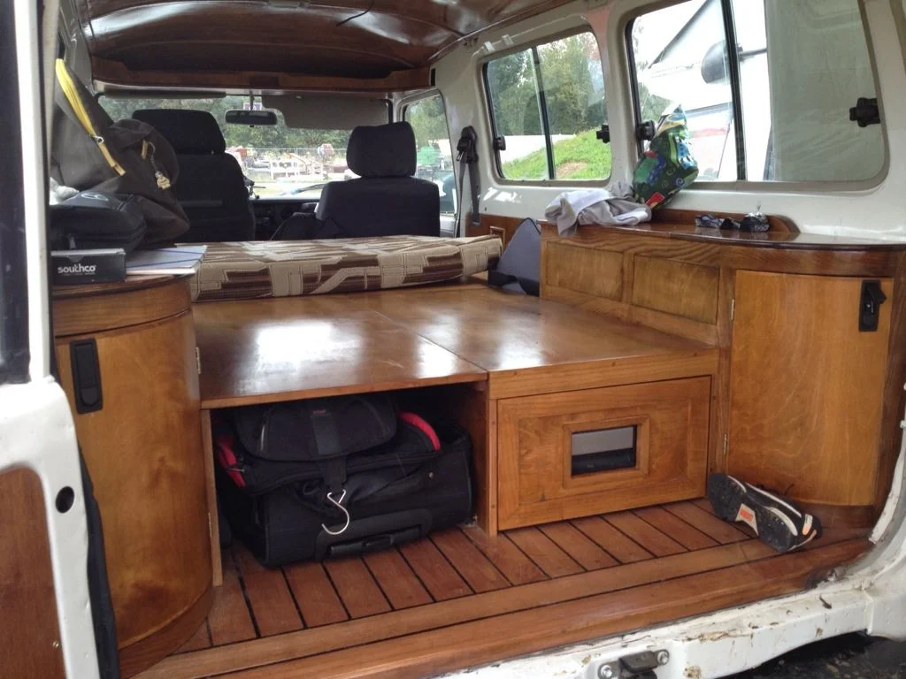

Here some photos of the double flaps. Still getting some mattresses made for the flaps, so haven't tested them yet
Thanks for pictures. Did you create some form of flap on the main bed that support each flap when down? ie so that they are supported by more than just the sides?
I used a standard wooden slatted bedframe of 120x200cm. The flaps rest on the bedframe's crossmember. The bed has a mattress of 10cm thick, the flaps will have a 14cm mattress to cope with the height difference between slats and the flaps.
If I could redo the whole thing, I would weld a bedframe and mount slats on the frame. The wooden bedframe is currently too flexible (torsion wise), will have to see if it survives our trip.
Yes, our bases are metal (Aluminium) square tubing wedded all round with a 10mm plywood base for the 75mm mattress. We could easily add a "lip" on the main bed part onto which the two flaps could rest. As the flaps don't really ever carry much weight they should be fine (unless now that we can climb down with one up and one down, we sit on the one in the down position - that may not take the weight (of me!). Still worth trying it.
I would love to hear how successful it is to have a split back shelf, so please let us know once you have done a trip.

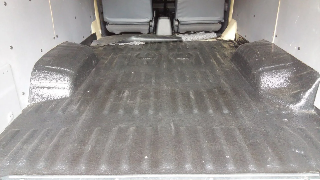

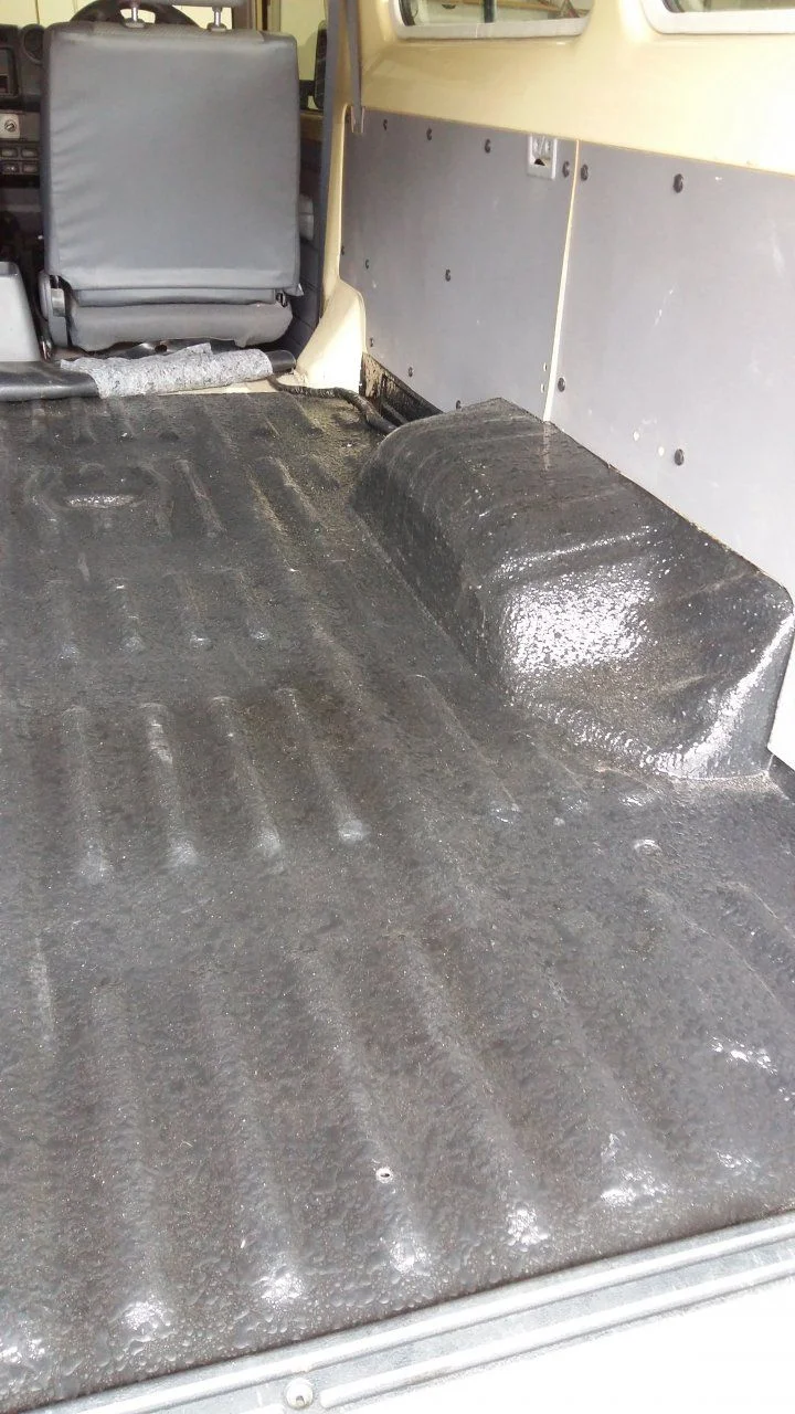

I had the bed of the car Rhino-lined and am very happy with the outcome. Now the ply floor can go in, which will make working in the back much easier, as hobbeling around on the uneven steel floor was not the most comfortable experience.

Hallo 78ToYeti! Really sorry for replying so late :notworthy: We did apply a stick-down rubber product into the back cavities, and then Rhino-lined the whole floor. I unfortunately do not know the name of the stick-down product anymore, although it did seem to make a difference in noise levels! If you are really keen on the product's name, I can try do find out on Monday, as we are in Cape Town at the moment.
The rhino lining did not make any difference sound-wise, but we had that sprayed to protect the floor from the 12mm plywood that we put on top of it. We did not want the plywood to scrape off the paint and cause the floor to eventually rust through without us being able to pick that up before it was way too late.

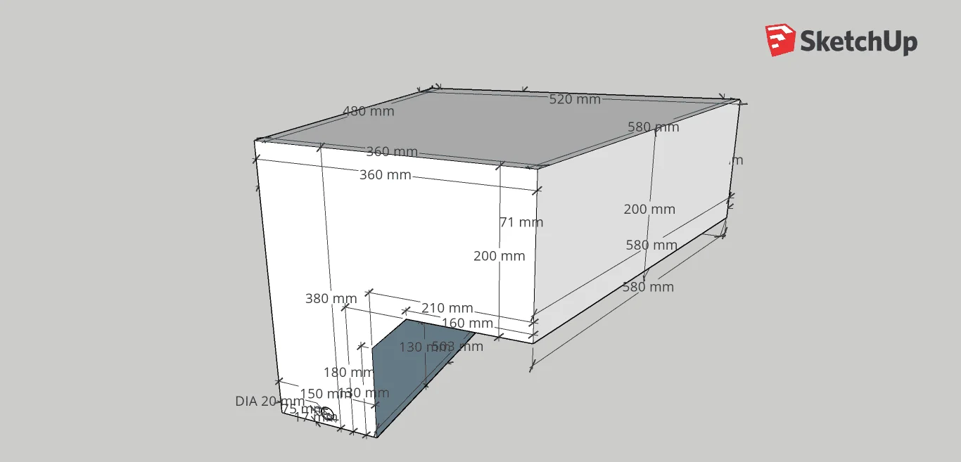

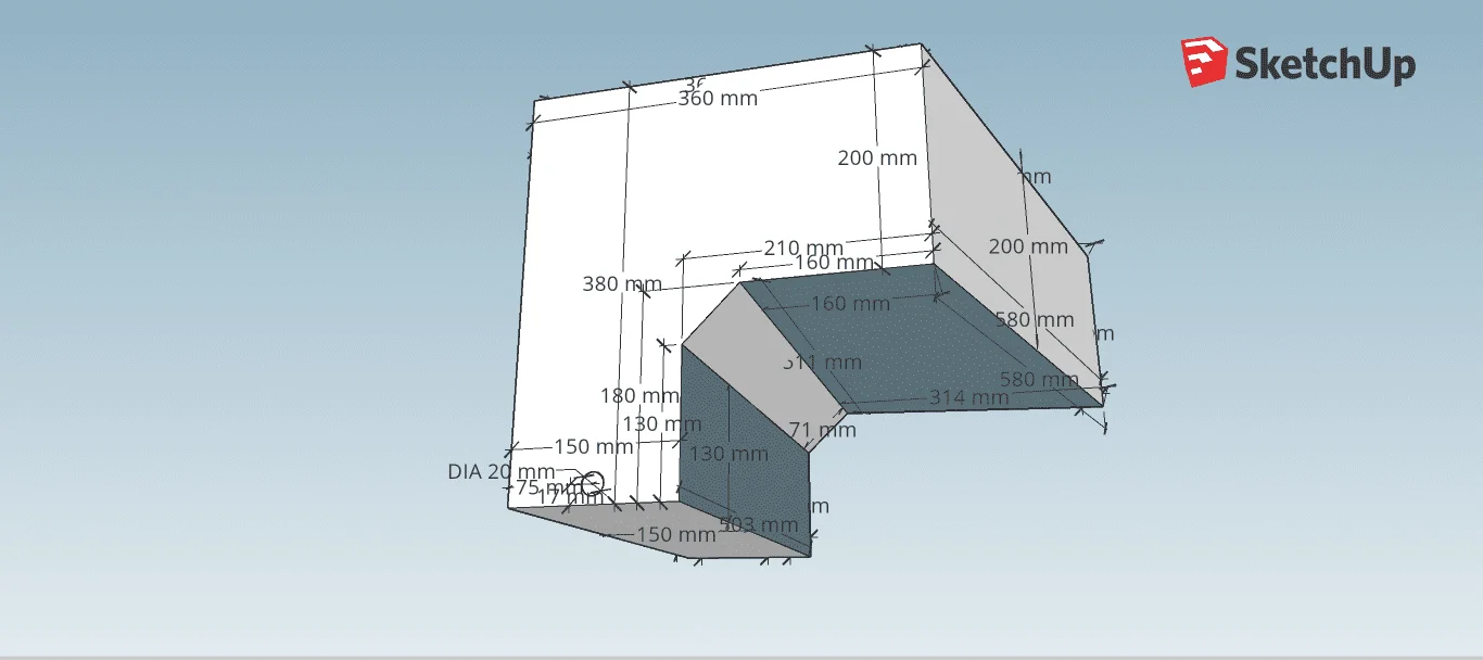

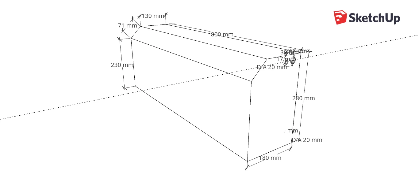

Will you be willing to share your under belly water tank designs? I am MOST interested, since I still have to do that too.

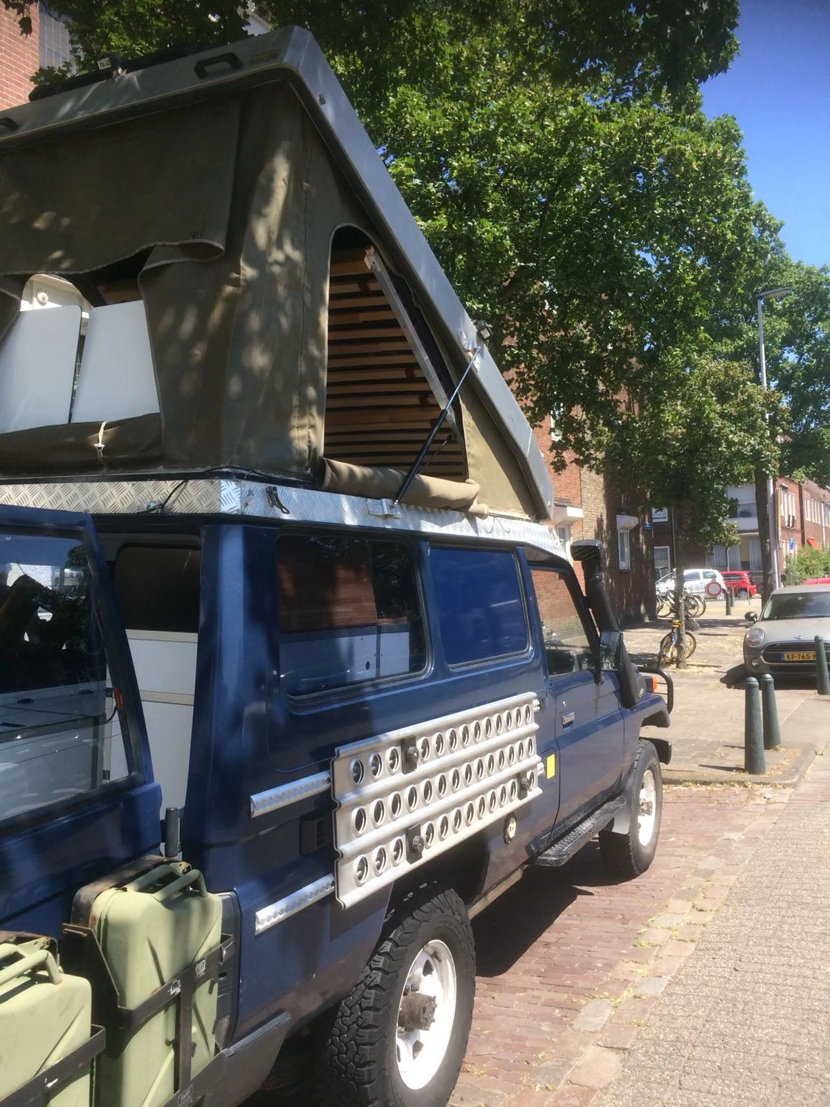

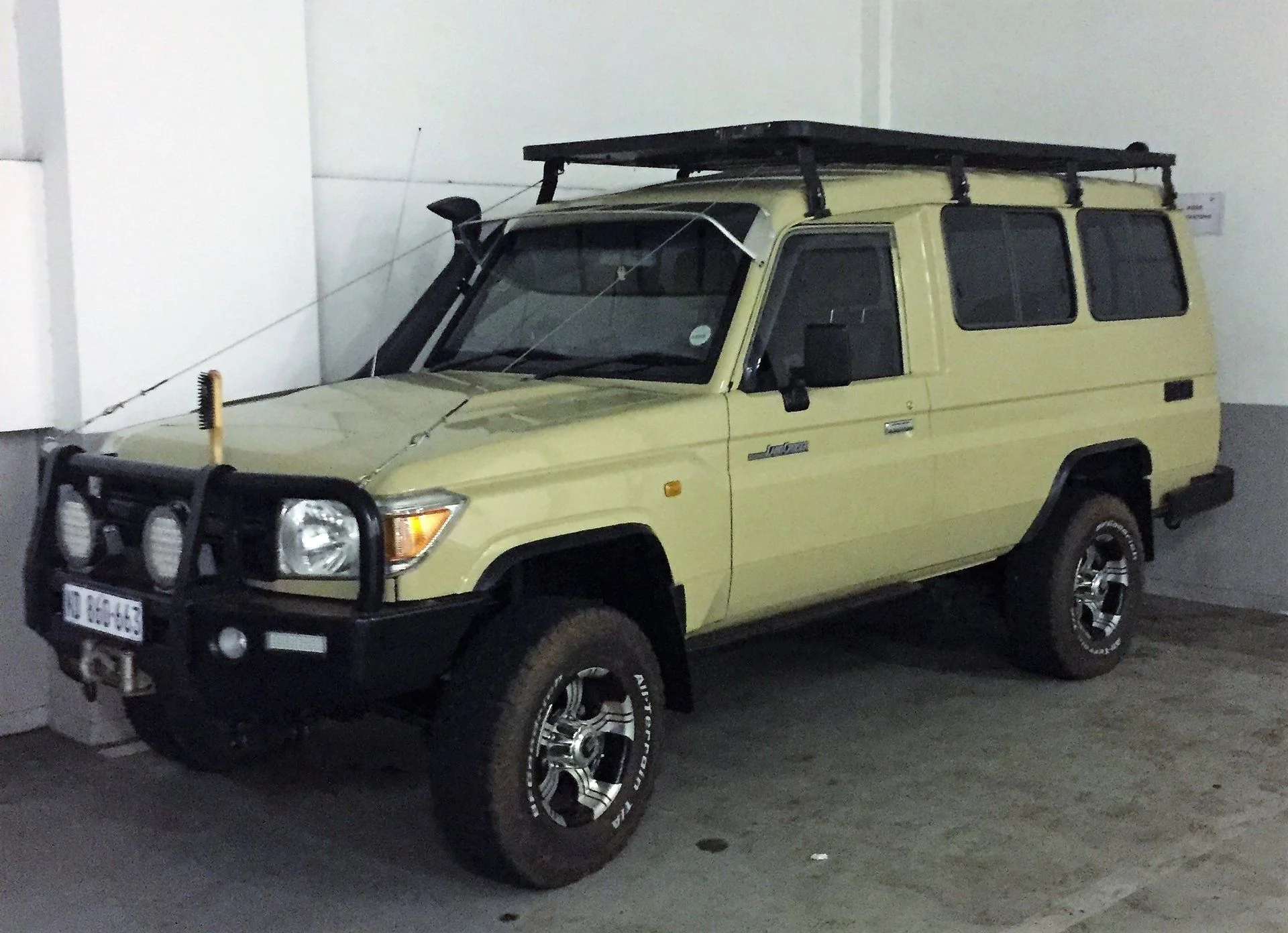

Hi Troepadoer,
I ashamedly don't have any pics of the car since the roof and awning was fitted... I'm still recovering from that event! but here she is when she first arrived.
(Someone told me it's cheaper to buy a wire brush if your left palm is itching, this wire brush had an attachment!!)

Here are a few snap shots from Sketchup for the tanks.
Rear Tank:
RHS Tank (View 1):
RHS Tank (View 2):
I have no issues with sharing the detailed .SKP and .DWF files if you need them.

Hi Troepadoer,
Rear Tank:
RHS Tank (View 1):
RHS Tank (View 2):

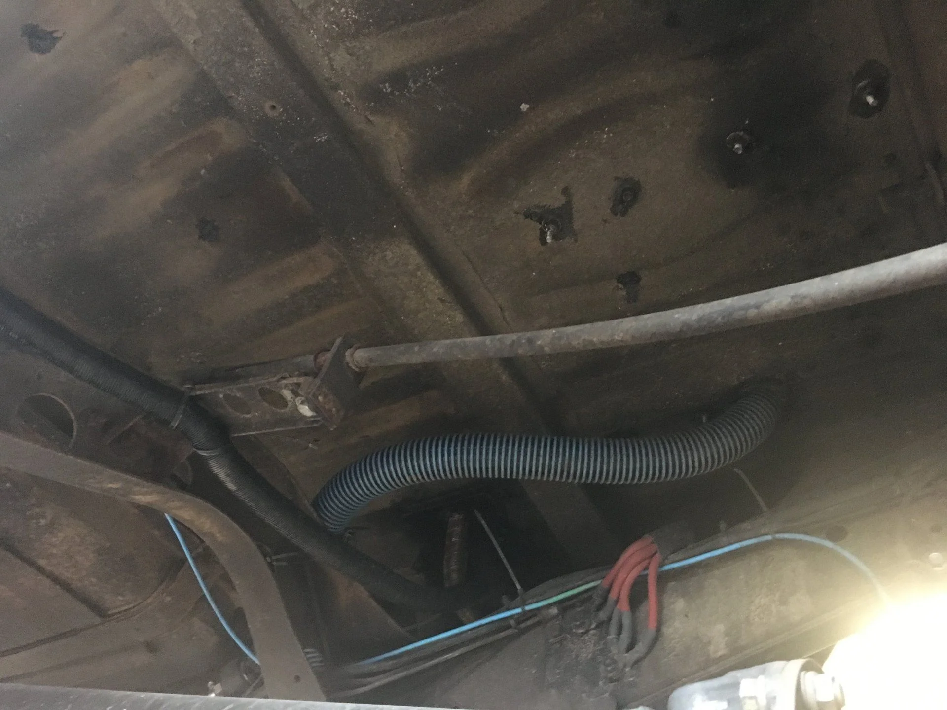

Alu-Innovations (in Cape Town) are putting 4 tanks into the side 'pockets' of the car totalling about 60 litres, and another 60 litres underneath (I think behind the second diesel tank).

On my thread I am getting ready to post info in regard to the tank placement. It's approximately 20 gallons (75 liters), stainless steel and will be mounted under the truck. The tank will be mounted between the transmission and the rear fuel tank. I have attached a pic that will hopefully provide an idea. The e-brake cable will need to be relocated. You will notice some bolts coming down that will need to be ground down. They are holding the inside floor to the body. The tank will be mounted against that round looking bar that you will see. Pick taken looking towards the back of the truck. The blue hose is the sink drain which will go into a bucket.
And.......at this point I don't plan to haul any water inside the truck other than maybe a gallon or two. A couple of fairly obvious concerns; freezing conditions and a puncture/leak.
Always something to think about.....

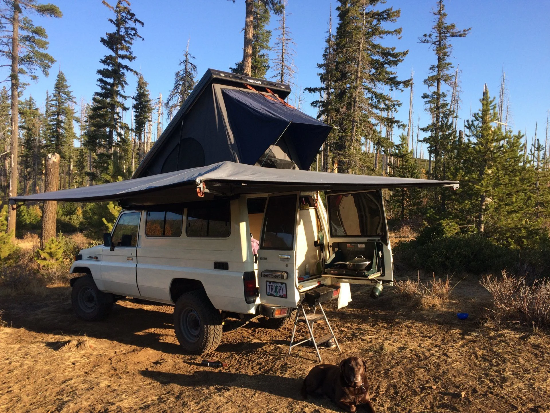

Hi again, it's Rodney in Portland.
I re-read the thread from a few pages back and have a comment or three on the Alucab top after using it for the last year or so. I'd like to see if you are having the same or similar experience/thoughts/issues.
First, the small access door on the sleep surface has a quite sharp point that has now managed to make a very small (just noticed it) HOLE in the tent. Apparently this has happened during the normal opening and closing of the door rubbing against the tent. The hole isn't much larger than maybe a pencil lead or large needle and I noticed it because a small amount of light was shining though the tent material ("WTF is THAT? It's a HOLE"). Has anyone experienced this? I'm wondering where I could get a small amount of tent material to cover the hole and what kind of glue (I guess) could be used to attach it. This is likely a question for Alucab. I will also need to glue some type of maybe foam to the point on the hatch door to cover the sharp point to keep it from happening again. If you "haven't" experienced this you might want to be on the lookout for it.
I do like the idea of splitting the hatch door so that you can enter/exit without waking the other person. It doesn't look like anyone has come up with the solution yet.? I need to follow up with Mookies as he said he had something sketched up.
I keep bedding stored in the tent. In the winter in Oregon it's cold so I keep a down comforter (Duvet), a sheet over the mattress and a couple of pillows. It's likely that Alucab makes the tent for warmer weather because I've noticed the top is very hard to close with the mentioned bedding in place. It's a very "tight" fit. Would another 1/4 to half an inch of space been a deal breaker for them?? Also, I think the cold weather affects the gas struts that hold the bed in the upright position because the bed itself has slammed down unexpectedly a couple of times. If that thing were to hit you in the head......anyone else experience this? I may need to install heavier struts.
