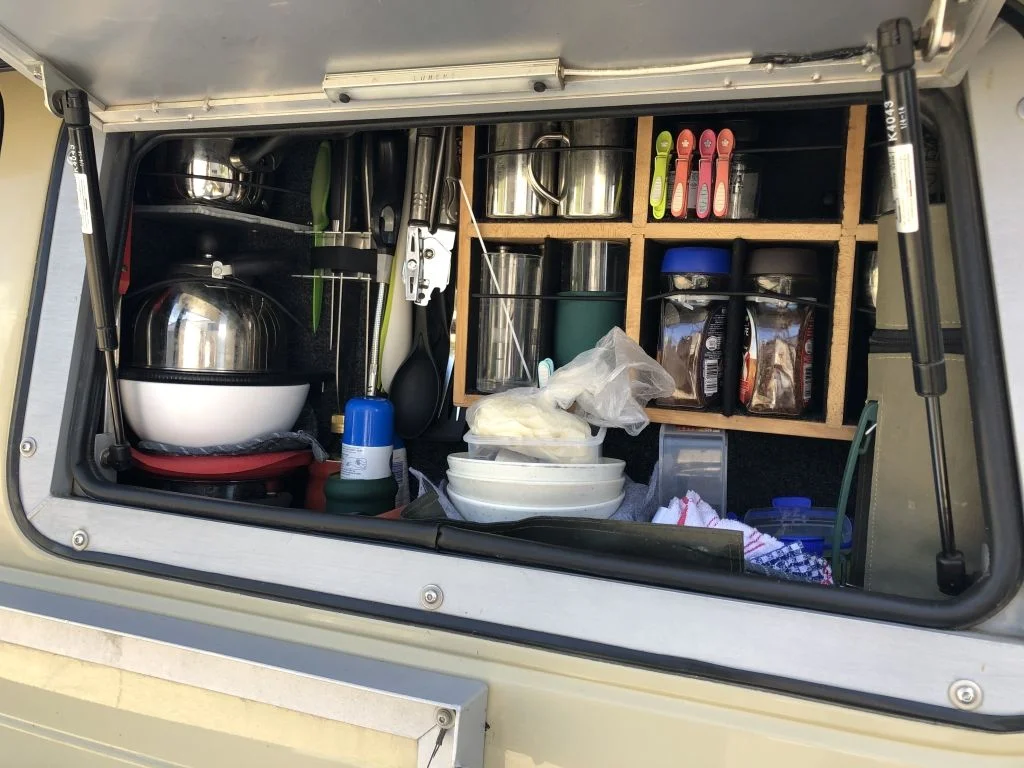

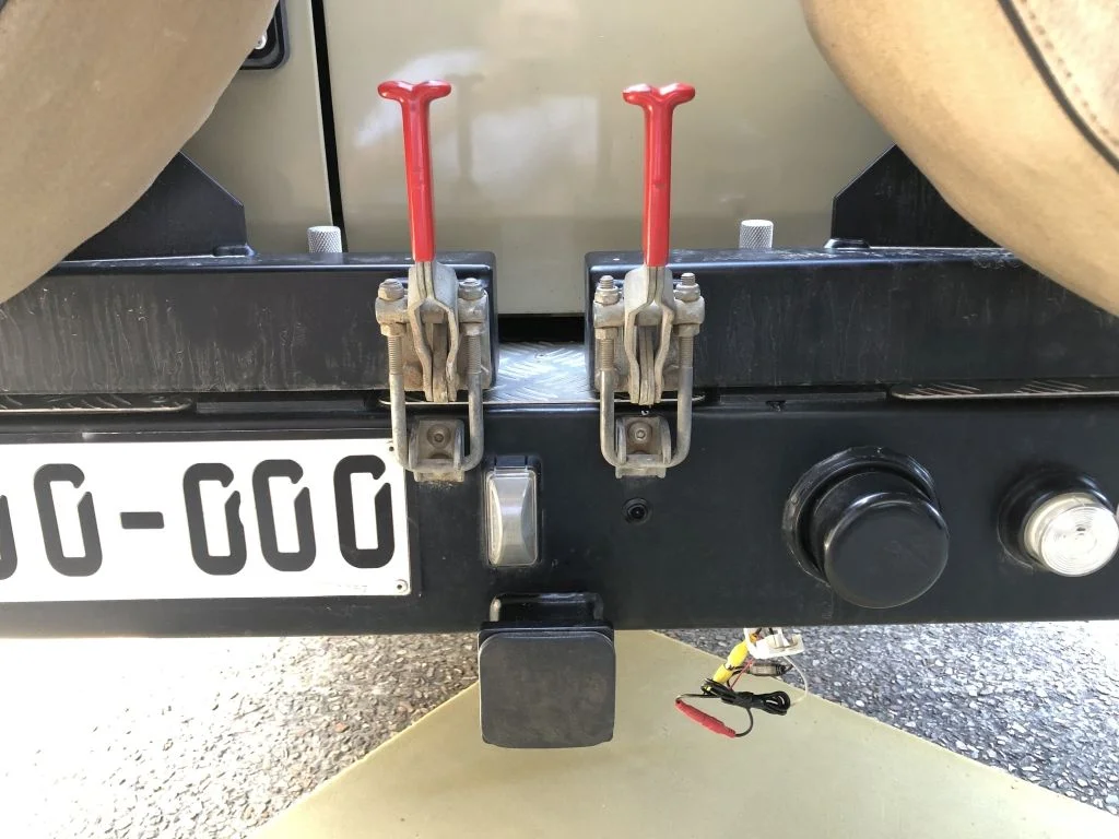

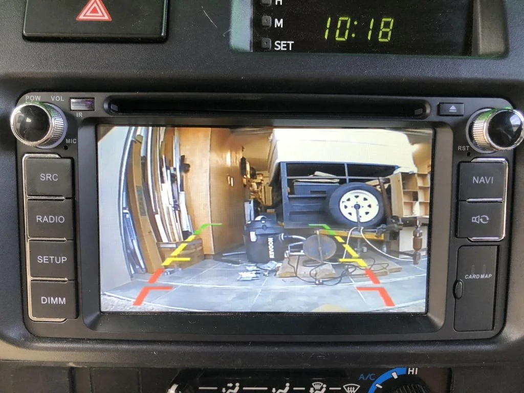

In the mean time, I have rearranged the side "kitchen" to make it easier to get pots and the kettle out. I also finally fitted a rear view camera for my replacement radio/headset. You can see the camera in the bumper below the right hand wheel bracket brace. The view when in reverse, which switches on automatically, is quite wide and very clear (excuse the mess in the garage!).

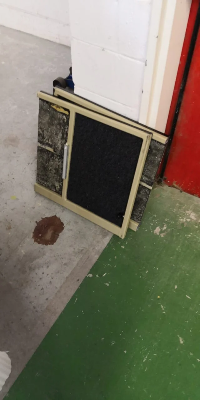

We cut the old platform in half, welded in square tubing on the new edges, and covered them with carpet so that they will not squeek.
Each platform got a second hinge.
We added a small piece of aluminium angle in the middle of the bed platform for the two 'new' platforms to rest on.
I hope these are helping!
Alet

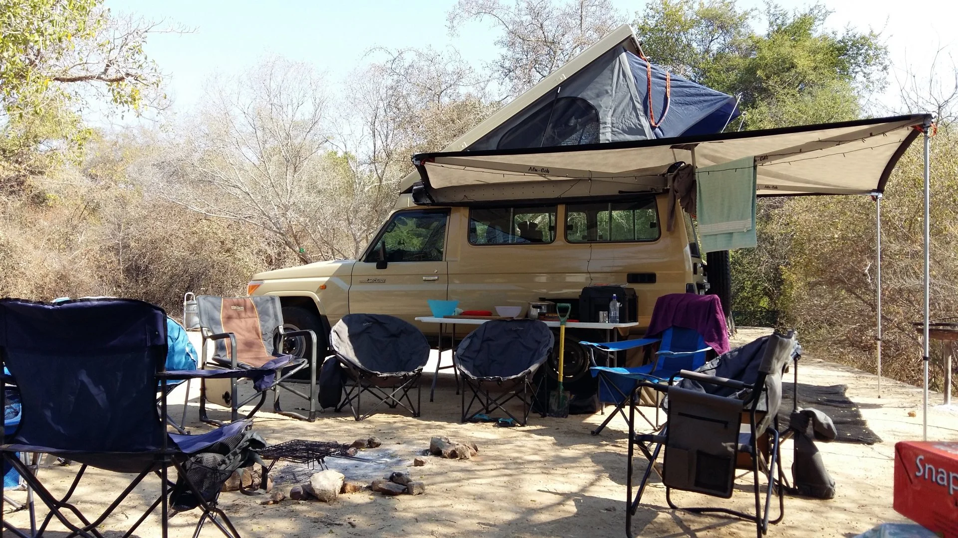

Ever consider a rear awning? This will get you some cover to use the back kitchen when weather is not great. Great build!!!
Thank you for the compliment! We have a 270° awning (also from Alu-cab) which pitches in seconds and provides good coverage over the cooking area. In the beginning I was not sure if I should get it, because it wasn't cheap, but after having the roof tent for about six months, we knew that an awning was essential.

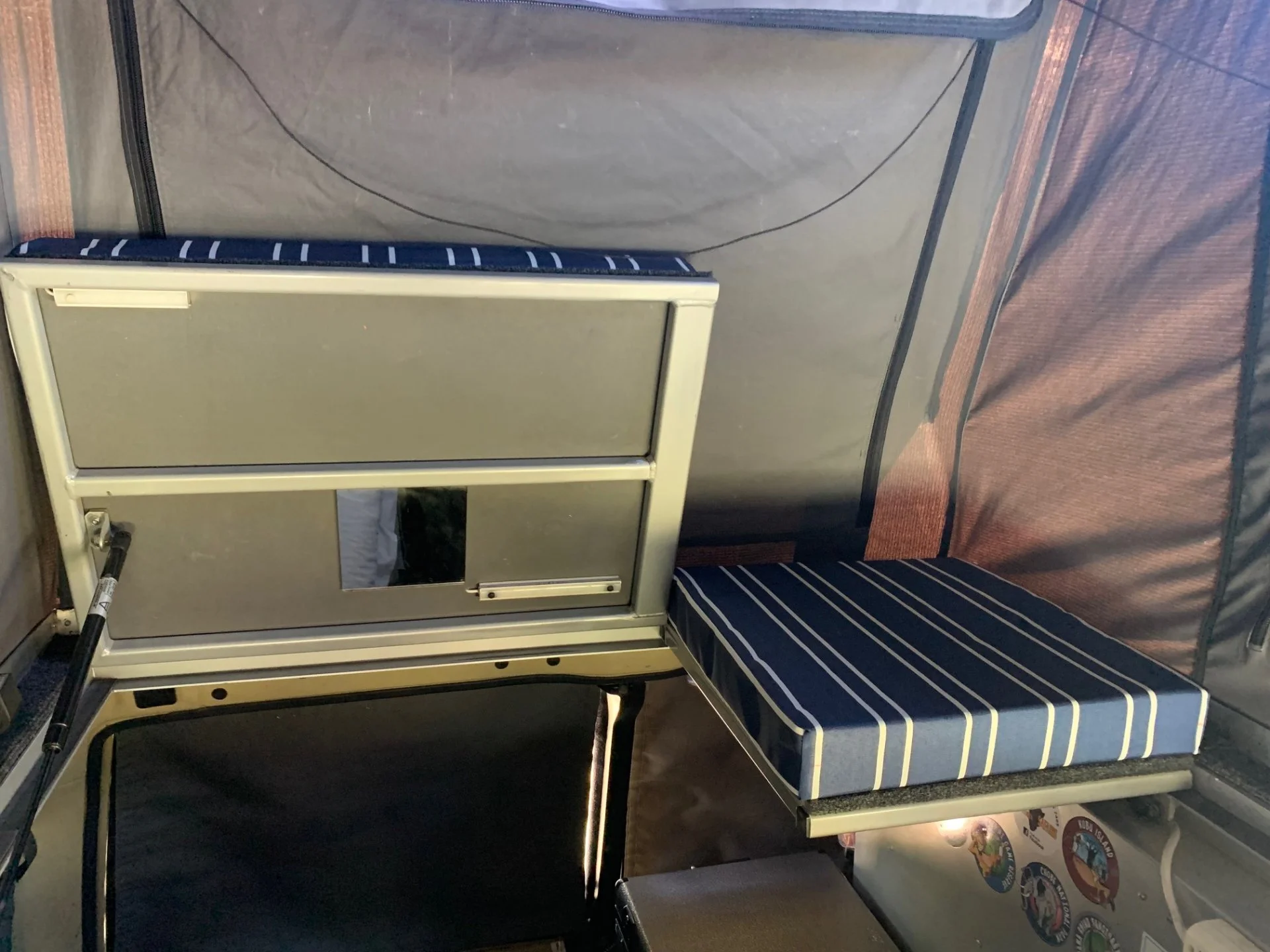

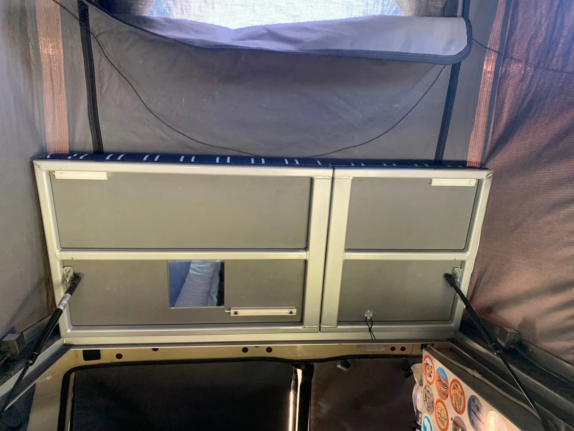

Hi folks,
After the disappointment that Alu-Innovations would not split my rear shelf, I decided to tackle it myself. I removed the shelf from the car, cut the marine ply and carpet with my radial arm saw then used a jigsaw to cut through the tubing before taking it to my trusty tig welding guys who added in new pieces of aluminium bar on either sides of my cutting. All of this was done while still attached to the aluminium frame. I then spray painted the new bars to match the rest before I added two new hinges and re-installed it back into the Troopy. To support the middle of the two halves, I attached a "tongue" on the crosspiece of the main bed frame. I cut the existing cushion in two and re-upholstered the two cushions before re-installing them.
I decided on about a 60/40 split, with the smaller "half" above my fridge, leaving the larger 60% where we climb up and down. I have to say this is one of the BEST changes I have done to the Hercules pop-top tent. It is such a small change for such a big improvement of practical use. I highly recommend everyone does it.
Cheers, Peter

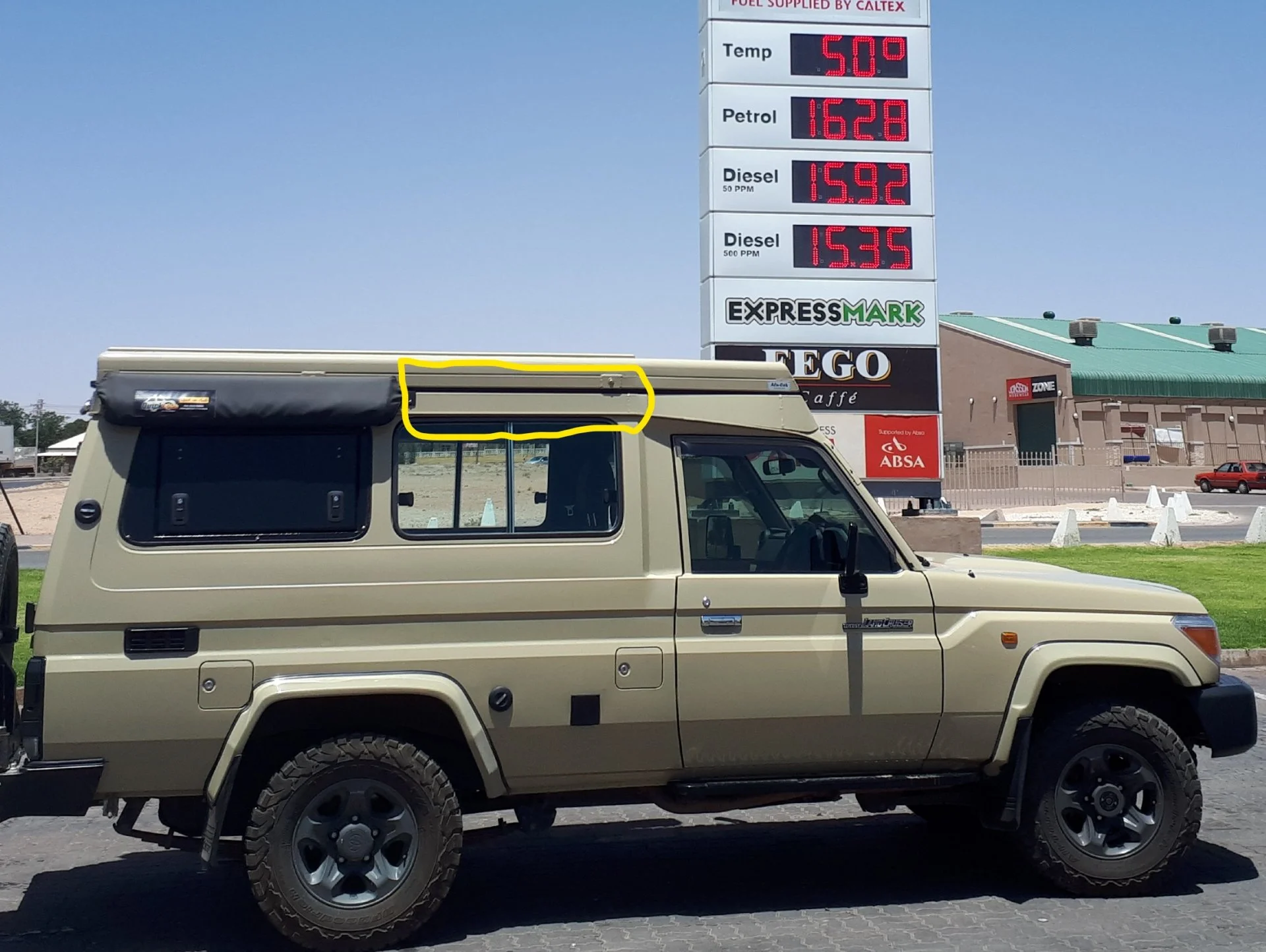

Love the build! I hope that 50' isn't in Celsius 🤒
It is Celsius 🤣 We live right on the edge of the Kalahari desert, but thankfully our house is next to the big Orange River with green vineyards right around us. Although it gets really hot in summer (aircons and water coolers running most of the day) we have the most amazing winters. We are also just 2 hours' drive from the Namibian border, which gives us easy access to some of the most awesome overlanding possibilities on the planet.
