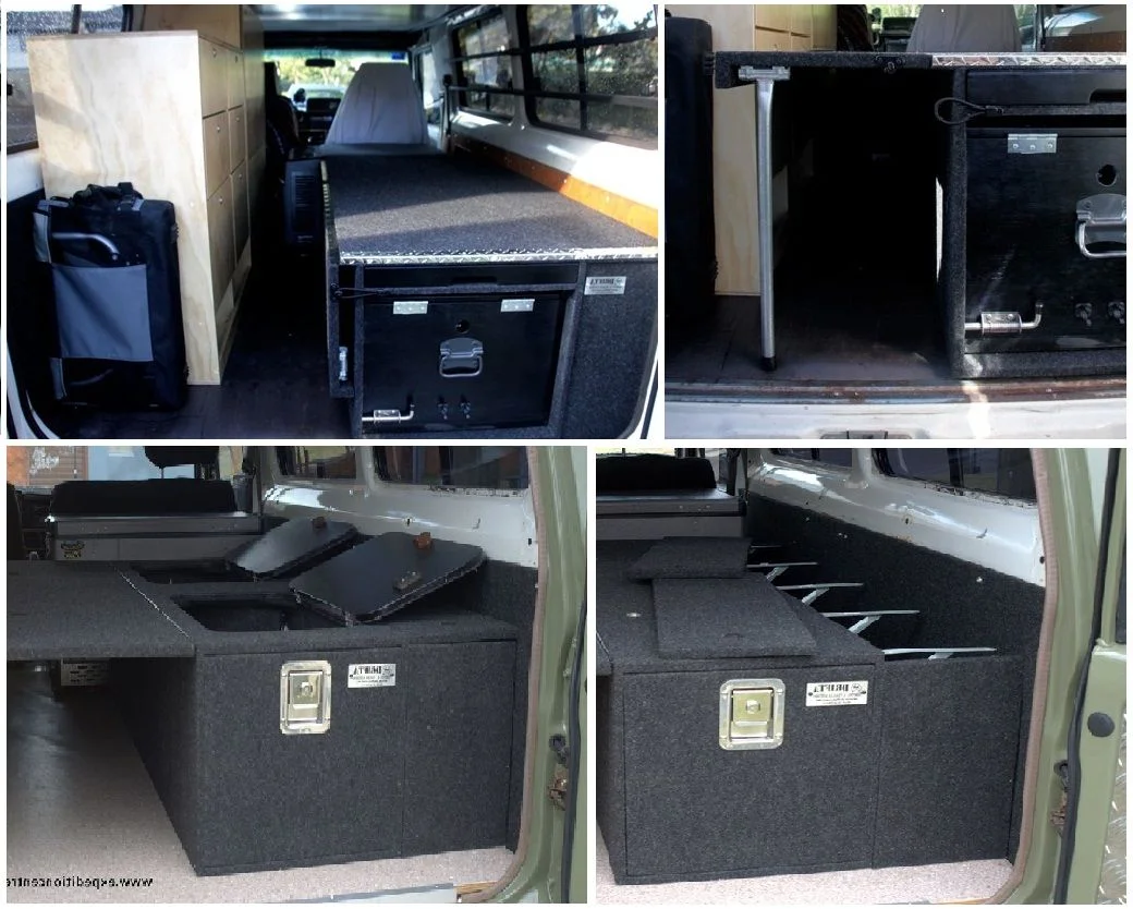

We started out our design with the cupboard on the right hand side, but then we came across the Troopy built by Drifta for the Aussieoverlanders.
We thought that the pull-out kitchen was a really neat idea, but decided to swop the bench to the barndoor side, so that the bigger door can provide shelter for the stove. We have since felt that this kitchen is just too much hastle for us, since we want to keep the whole setup as simple as possible, so we will now only be fitting a basin to the small door, and a drop-down table on the barndoor, with an electrical outlet on the side of the bench where the induction plate can be plugged into, should we need to brew something up next to the road.

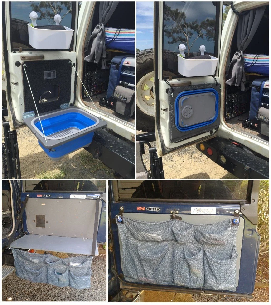

I found these ideas on the Troopcarriers of Australia FB site. Also our high cupboard will be 900mm high throughout, which will still leave a little over 100mm of window space open to let in light.
Since we are not doing the pull-out kitchen anymore, we will make the bench accessible from the top. Again Drifta has some very good ideas.
I like the fold-out and stand mechanism of the top two pics, but will put in the flip-open lids and extra storage behind like the bottom two pics.
The trick for us will lie in equal distribution of stuff in the cupboards on the one side, recovery gear and fridge on the other side, as well as the fuel and water tanks underneath.

Good ideas. I really like that pop out washing basin idea, and the neatly concealed tap. AluCab had a fantastic drop down table for the barn door - looked like stainless steel, and very neat. I also hear you suggestions about the bottom two picture "bins" and ability to store stuff behind them. I see what you say about having enough room for the pull out on the right.

I like the collapsible sink.
